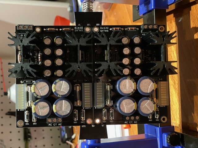

First post in this thread and wanted to say hello.. Started working on my DCG3 a week or so ago. Acquired parts and boards from Tea. This is my third DIY audio project and I def consider myself a complete noob with all of this! So far, I've built a whammy headphone amp (configured also for use as pre), and recently completed an Aleph J with the Zen Mod boards. Lots of help from pFarrell and 6L6..
So far, I have finished the DCSTB boards, and will be powering them with dual Antek transformers. Powered them up last night and measured voltages (Unloaded). On the left side I have 17.31 and -17.27. Right side producing 17.22 and -17.34. Close enough I believe.

Hi, welcome to the thread.
Your DCSTB is running very close rail voltages considering LEDS & JFETS tolerances. DCG3 is a single ended circuit that does not care for exactly symmetrical rail voltages about its DC offset, that is why there are no trimmers on the DCTB PSU. For even more reliability in the long run.
Regarding the output stage bias choice, if to regularly use headphones of less than 80 Ohm nominal impedance, 150mA gives less THD on such loading. On the other hand it produces more heat on all sinks. It calls for better ventilation measures. OTOH if your best and more regularly used set of cans is > 80 Ohm there is no THD difference with 100-120mA and you keep the preamp cooler.

I"m planning on using a piece of aluminum bar stock for heat sink. The dimensions are 180mm x 30mm x 10mm. Without some sort of airflow would this be sufficient to run 150mAh? Same aluminum sink that Patrick used, which is running 120mAh I believe..

Main requirement is not the size of the bar, its sufficient, but to have well breathing perforation on the top lid directly above the area of the DCSTB sinks and few holes around the bar on the bottom panel.
Ok.. Thank you Salas.. I'll make sure my chassis has enough ventilation holes above and below the heat sinks. I'm envisioning myself listening to speakers more than headphones. I'll keep reading and chewing on that before making a decision on bias. Thanks for your thoughts! I'm certain I'll have more questions as this unfolds, looking forward to hearing how this sounds compared to my whammy as a pre!
