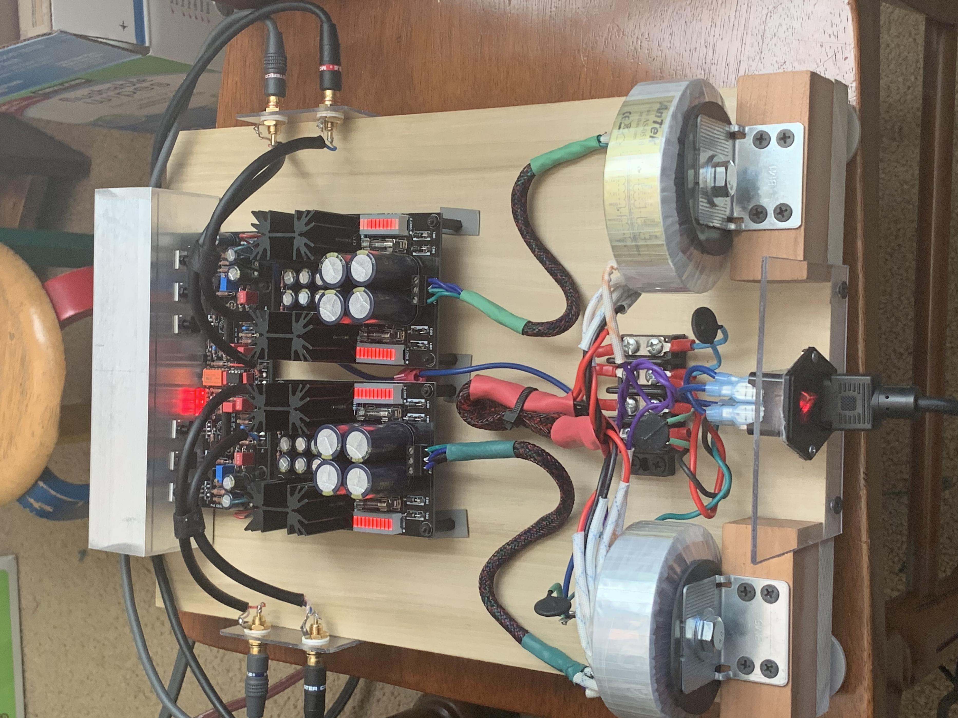

Hello,
I have a problem with my DCG3/DCSTB combo. It was working fine (for a week) then this morning upon switching on, the main fuse popped. Replacing the fuse and turning them on again I noticed that the the right channel Dref2 led bar is brighter than the others. Powering off, the same LED bar stays on a bit compared to the other 3.
Voltage measurements at output (V+/V-):
Left Channel: 17.28
Right Channel with the glowing LED DREF 2 bar: 0
I removed the DCG3 preamp connected.
Thanks for your help.

I suggest you first check the BC5xx transistor on the problematic side of the DCSTB. Then the MJE big pass transistor. For normal Vbe when still on board (0.6-0.7V).
Lastly measure the voltage drop across that side's 33Ω resistor pins (R1 or R2). Voltage/33 should result around five mA if the associated PF5102 is still ok.

Hi Salas, here are the measurements on the affected DCSTB side:
Q1 Vbe=.477; Q2 =___, Q3 = .772, and Q4 = .636

Yes, cannot measure Vbe of Q2 (pins 2 and 3).

You miss a plus polarity voltage rail, right? It's Q2 that has failed it seems.The only one not showing a Vbe reading. Try to replace it.
There can very well be random failures in small transistors.
On the other hand to actively kill some BCxx in a DCSTB it usually takes a rail output short. Even momentary.

I bought a transistor kit from Tea-bag. Replaced J2, Q2, Q3, Q4 and one LED Dref. The DCSTB faulty channel is now working. The replaced LED bar not as bright. On the repaired DCSTB channel, V (+) = 17.4 while V (-) is only 16.98. DCG3 is working fine, I supposed. Godspeed.
Check mV drop pin to pin on each polarity's 33 Ohm resistors R1 R2. mV/33=ImA. If the not as bright bar side has less mV across its 33Ω resistor then it also has less mA available to light up same Vf in Leds due to a new non matched J2 (J2 weaker than J1). You can equalize mA by smaller value R2. ImA=mV/R. DCG3 is working fine already, for aesthetic reasons you could try equalize led bias and brightness leading to bit more Vout also, as I described.
Thank you, Salas. I will check what you suggested. So the unequal V+ and V- output has no sonic consequence? I can't tell from listening to the DCG3. Godspeed.

No it hasn't sonic consequence as long as it is not widely different. Talking for this particular output stage. It's not a push pull. It's a single ended Mosfet cascode class A with constant current bias.
