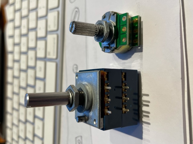

Question about using POTs.. 🙂
I'm planning to compare an Alps 20k (I know it's not supposed to be the best in this application) and China/Ebay 20k smd version. I'll be remote locating the pots from the inselect board and using an extention rod..
Anyway, few questions.. Anyone used this specific Chinese pot? It's labeled A20K on the back.. Secondly, as far as connecting it to the inselect board I'm assuming that the terminal locations on the Chinese pot are not corresponding with similarly placed terminals on the Alps? Curious if anyone has sorted that out?
I had tested that one in DCG3. Not vs an ALPS Blue but vs a TKD and a Goldpoint. I think its well clean and focused but bit treble pinched and not giving a very secure mechanical feel of course.
Its terminals order is conventional, normal.
Awesome.. Salas, which POT wound up being your favorite between the three?
The Goldpoint for its channels matching precision being a switcher but without harshness. Its expensive even at 24 steps though. This number of steps can be bit coarse if with efficient loudspeakers and a highish voltage gain spec power amp. At 47 steps its a very expensive pot.
The TKD although clean has some character, a more fleshed out but smooth portrayal. Reminds of classic audio tone like Sansui. Its also continuous being a track pot. No gaps. If without enough voltage gain in the chain you can even say its taper opens up rather late on the clock.

Thank you for the input.. I may grab a TKD 20k as well and see if I can tell the difference.. My speakers (Hersey's/Modded) are pretty efficient so the 24 step Goldpoint may not be a great option.. And I'm probably to cheap to pony up for the 47step version!

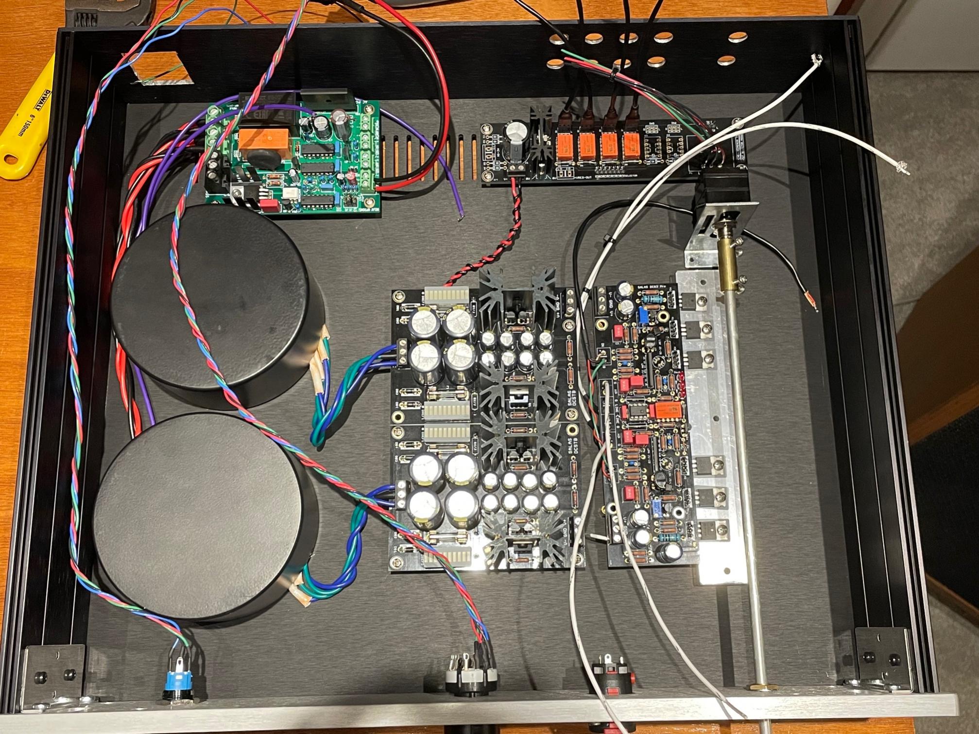

DCG3 all finished!
Another DCG3 is born!

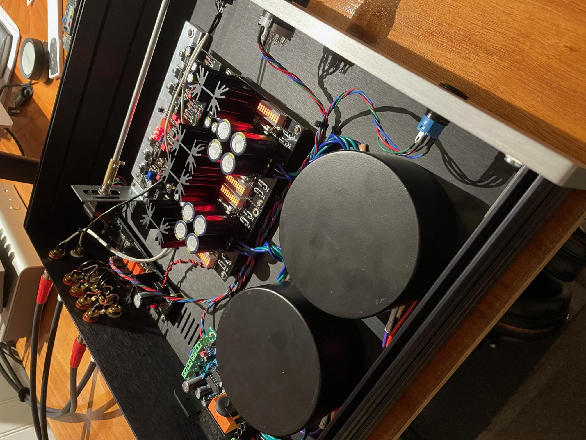

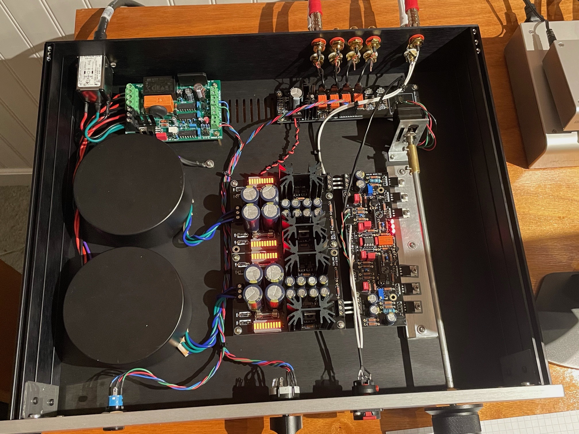

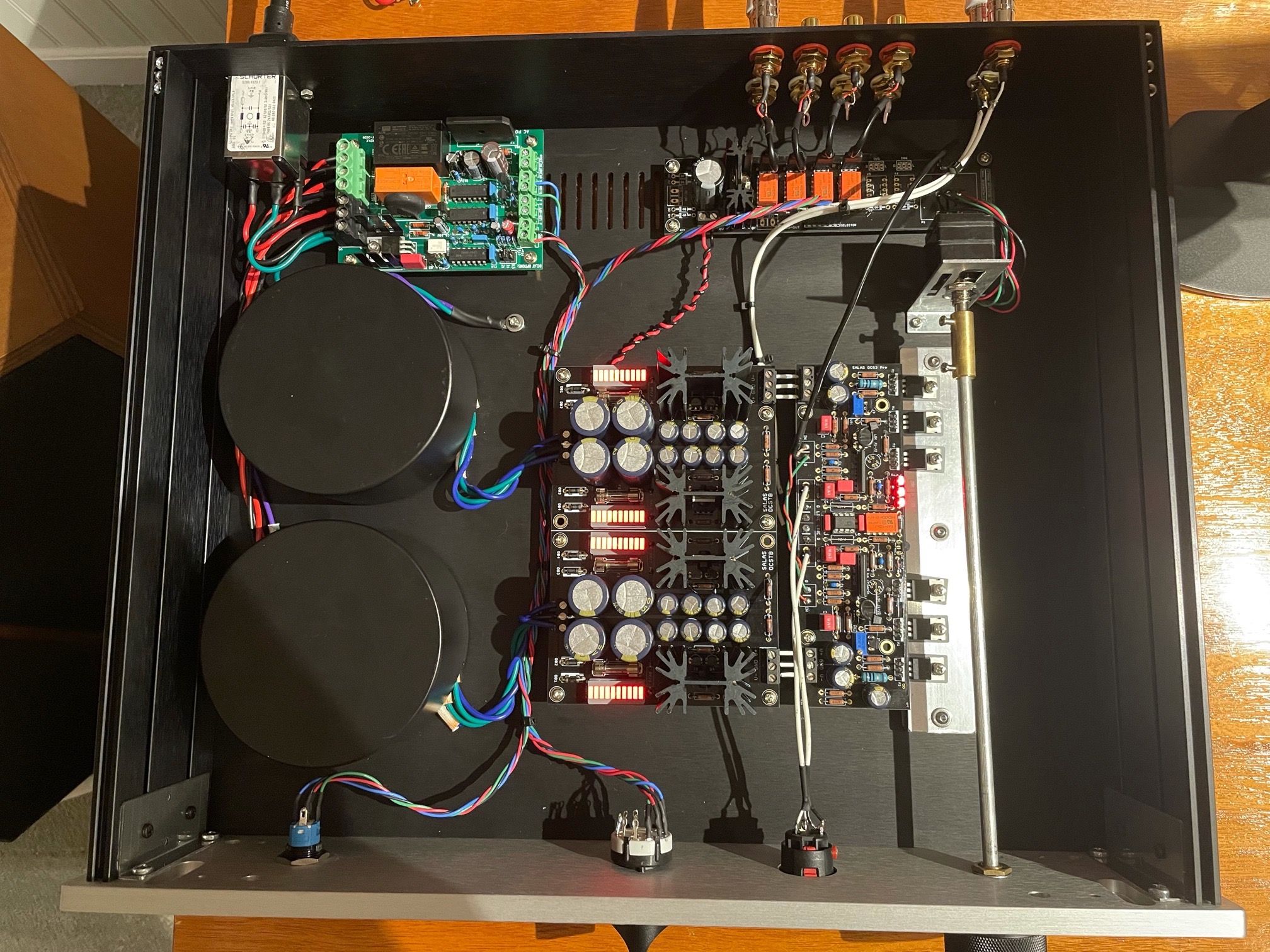

Finished up my DCG3 this weekend and couldn't be happier with it. Fairly generic build although I added Mark Johnson's power board. Thank you to Salas, pFarrell, Tea-Bag, and many others for your assistance in answering all of my questions. This is only the second 'pre' that I have any experience with, the first being the Whammy. The sound is simply fabulous. It's dead quiet via headphones and when paired with my Aleph J, it is slightly more quiet (It was pretty damn quiet before) than with the Whammy.. (No disrespect.. Love my whammy, and I'll be moving it to another location in the house to use)..
Surprisingly, my Fostex X-00's sound like different headphones.. Much more bass and fuller sound.. Very pleased with them and will probably spend more time listening to music via phones..

By the way, are those photos from a test phase when you used a mono input? Because I see only one input coax and a jumper (?) red-green twisted pair to the other channel's input. On the main dcg3 board.
Thank you Salas, for the kind words, and for all of your tech support!
Regarding the inputs.. Good eye.. Maybe I didn't make the connection properly? I used 3 wire mic cable (2 signal + Drain) from the inselect board.. Left channel and GND connected to left side, right channel crosses over and is twisted with a ground jumper.. Right signal (Red) is connected to Right IN and the two grounds are jumpered with the green wire. After our chat about the grounds all being on a common bus, I'm not sure I needed that jumper wire..
If I've wired it incorrectly, it still sounds great! Lol..
