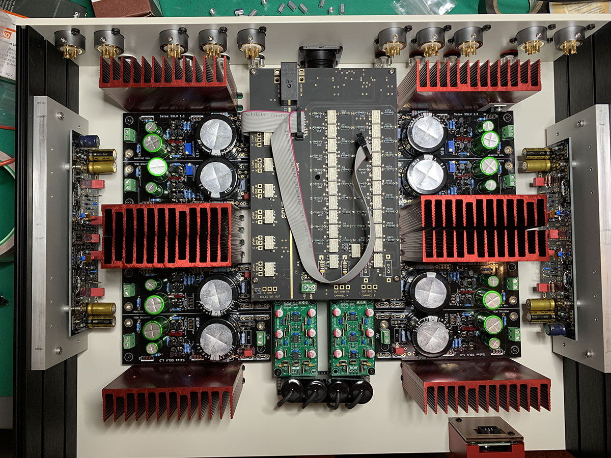

I've been super busy at work lately so haven't made as much progress on my new preamp as I had hoped. But it is starting to come together. I still have some work to do on the various PCBs (mostly installing the last transistors) and wiring everything up, but I did a test fit of all the circuit boards to make sure everything fit the way I had planned.
It's been a while since I posted, so as a reminder ,I am building a fully balanced two-chassis preamp.

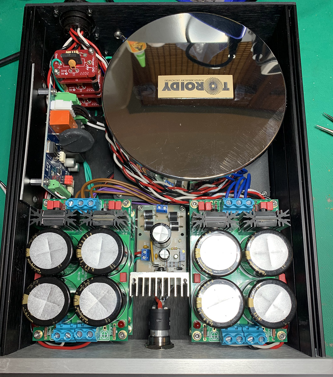

There is a separate Modushop chassis for the transformer, rectifiers and CRC filtering. The transformer is a custom 400VA Toroidy with nine secondaries. These feed four +/- supplies and one regulated 5V supply for the digital electronics (to control the switched attenuator). The four +/- supplies feed four pairs of UBib 1.3 regulators in the main chassis for +/- 12V and +/- 17V for each channel. I've included a photo of the power supply chassis below.

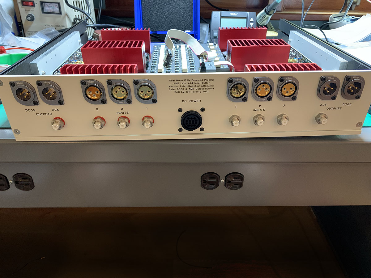

For the main chassis, I am using side panels from Modushop, but the rest of the panels are being fabricated by Front Panel Express so that I could use heavier aluminum and have everything powder coated.
The main chassis will use a pair of AMB.org A24 input buffers (after a 6-1 input selector) which feed a balanced switched attenuator (input selector and attenuator from Khozmo). The output of the attenuator will feed the balanced Salas DCG3 output stage (one 2-channel DCG3 board for each balanced output) as well as another AMB A24, so the preamp will have both DCG3 and A24 outputs. The primary reason for the A24 is to provide a single ended output for my subwoofers.
You may notice that the number 2 XLR input connectors are mounted upside down. This is intentional since I have some super-stiff XLR cables and this gives me more flexibility where the components are placed since the cables do not like to be twisted.
The bottom panel is not quite as flat as I was hoping so I'm going to have to add a clamp between the top and bottom panels to get a tight fit.
If all goes well, I'm hoping I'll have this fully operational in the next several weeks.
Be sure to have a fully vented top cover. Depending on your CSS setting you gonna have quite a lot of heat in the area where the two UBIBs heatsinks are facing each other, best is to have the bottom drilled there at least.
