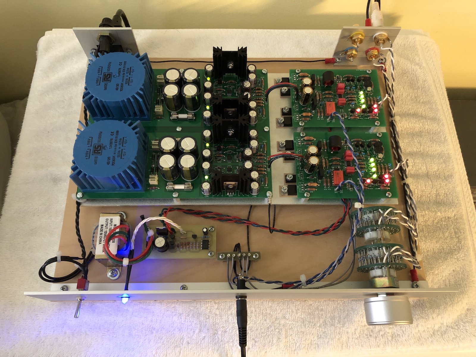

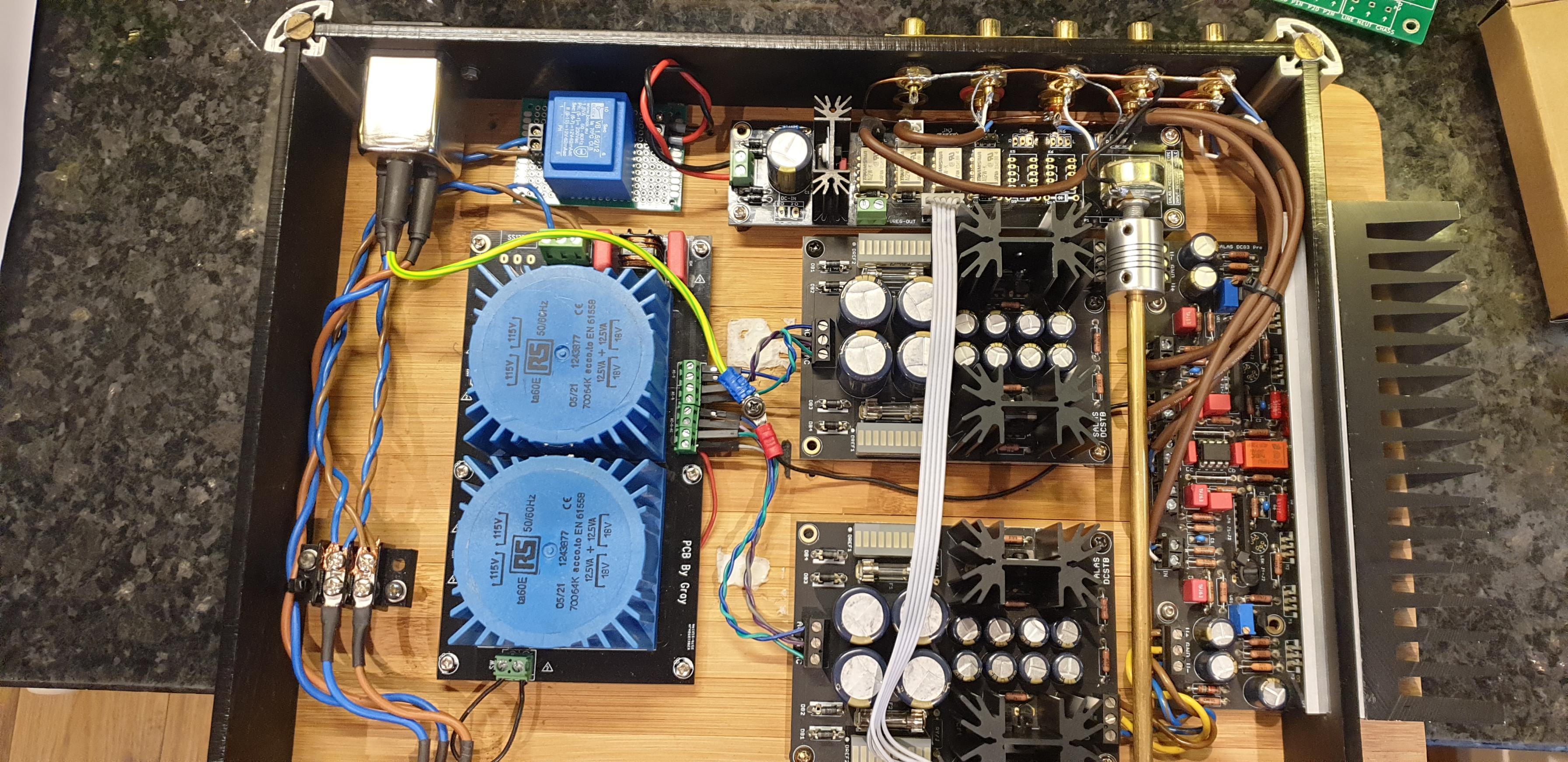

I did a little work on my DCG3 this weekend. Fitted the talema trafos and finslly added a small separate trafo for the In-select. I didn't like how I'd tapped off from under the DCSTB
Also I split the psu as the inner transistors do get a lot hotter than the outers. It does seemed to have helped.
And so far it has been powered 24/7 since for a couple or 3 days; trafos are warm but nothing more. Seem to be coping.!
I have improved my soldering since I first built this and I did have an intermittent dodgy channel. I've resoldered the signal wires to the rcas from the In-select outputs and thats cured that.
I am.aware my signal ground is straight to the safety ground and so I may look to improve that, although it is dead silent!
Edit....I cant find my heavy crimpers hence the horrible blue and brown wiring at the distribution connector.!

It looks neater. Congratulations.
As for grounding, if dead silent there's nothing more to improve by ear. Only with high resolution FFT analysis equipment. Like seeing some harmonic noise small spikes in the residual grass and experimenting how to push them down even more.

Didn't see this until now. I usually size transformers like this:
Raw DC = +-22V
Current = 175mA
Raw Power = 44V * 175mA = 7.7W
Derated by factor of 1.6 to account for rectifier inefficiency = 12.3W
Double that to be conservative = 24.6W
That leads to 25VA per channel. In my builds, the Talemas (15Vx15V) run only slightly warm. Good luck getting them, though. Seems like COVID hit the factory or something, because they're out of stock globally.

I've shamelessly attached an image to prove the point, but mainly to show off my latest work, LOL.

Yes, definitely agree. My first DCG3 is running the 18V transformers and I have about +-25V raw DC. Losing that extra four volts cuts my regulator dissipation in half. The pass transistors run hot in that unit. The one I built for Kevin uses the 15V parts and runs cooler. I decided not to worry about it because the transistors can take the heat. Die temperature should be well within limits even if the heatsinks are at around 150F, estimated by touch.
