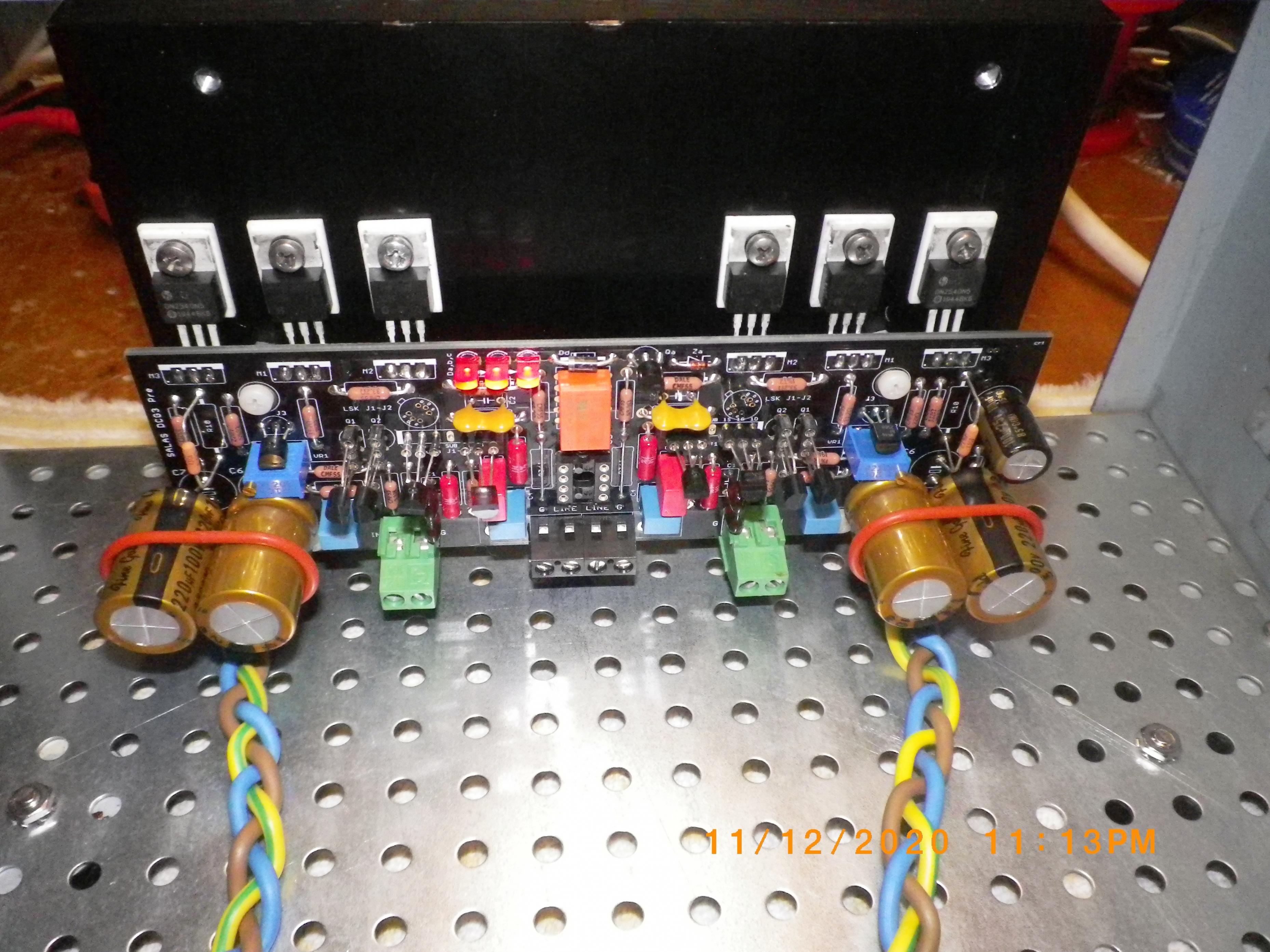

You were quick, are you gonna make A/B comparison with the transistors/jfets, I see bases in place of mirror transistors.
Good parts, it's only I don't like PRP resistors, FGs just fitted.

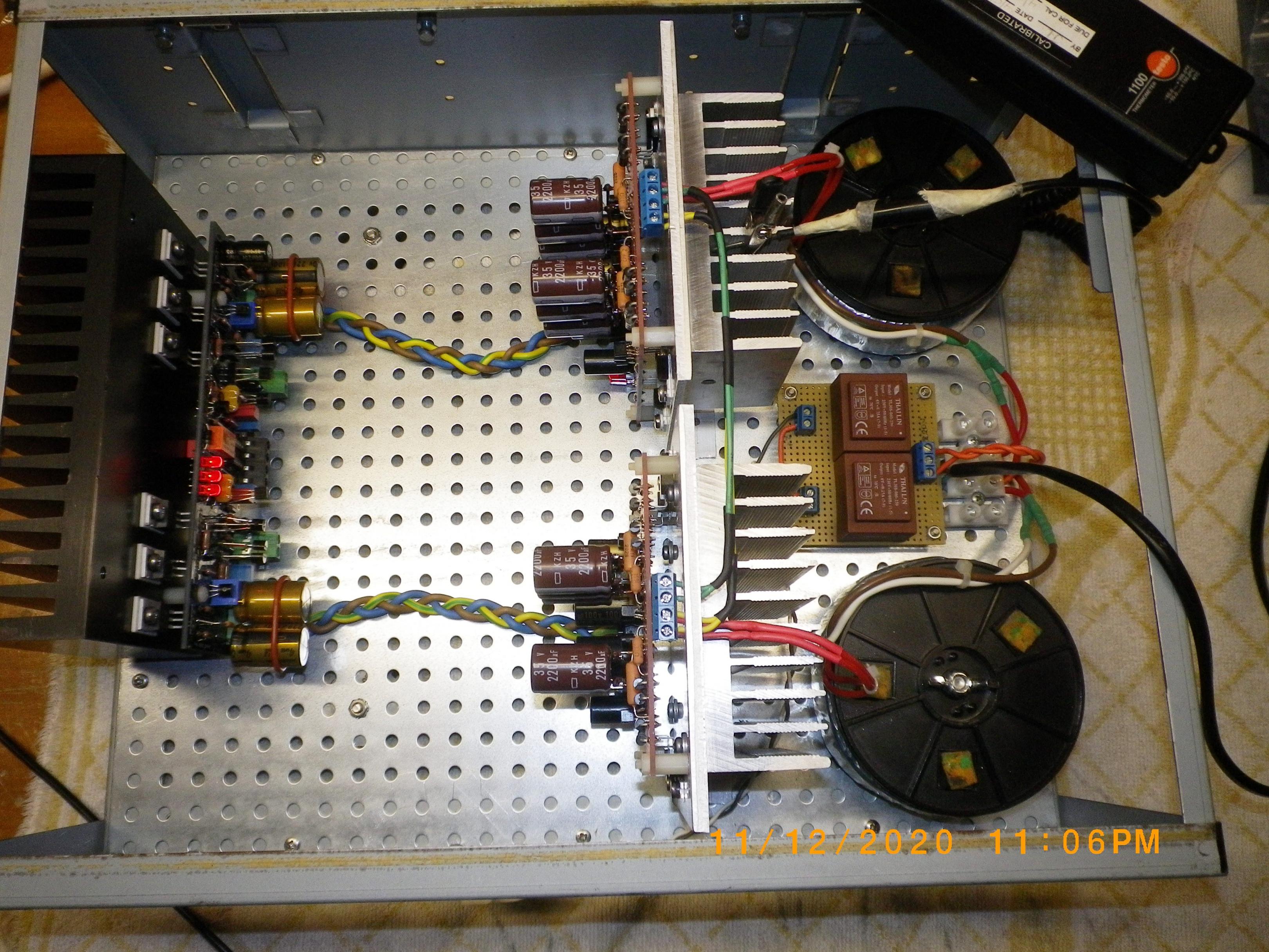

What psu you gonna use?

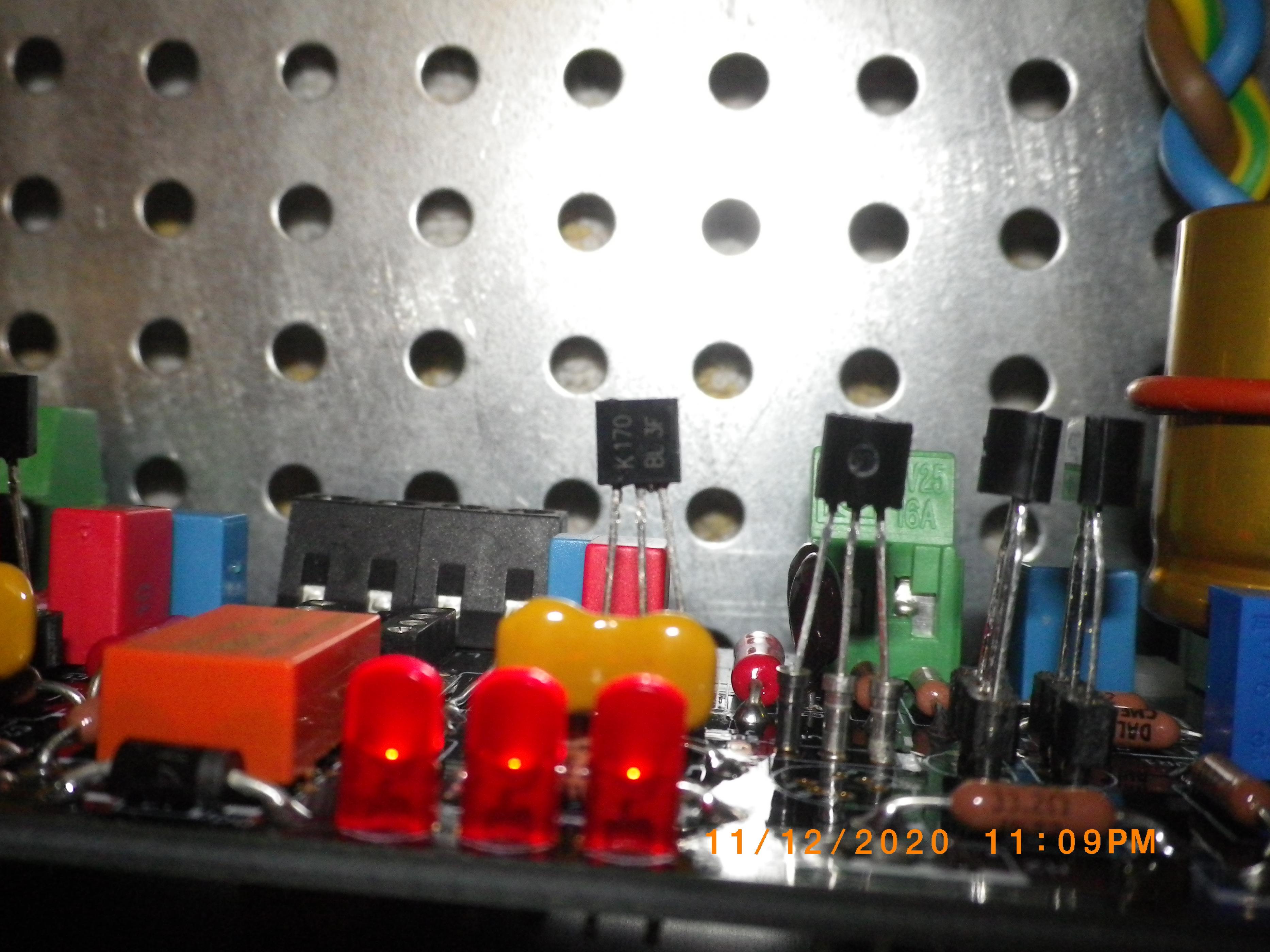

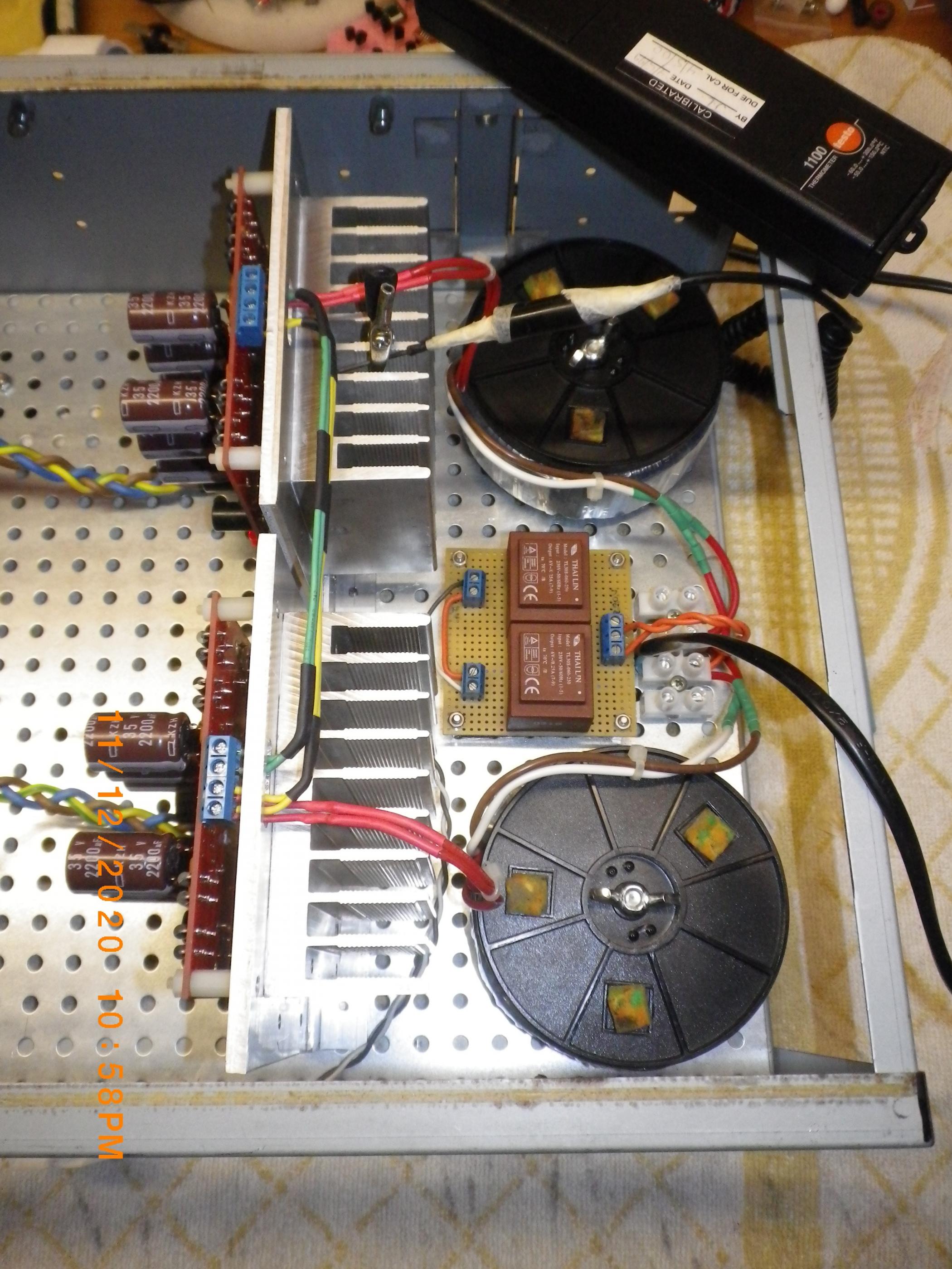

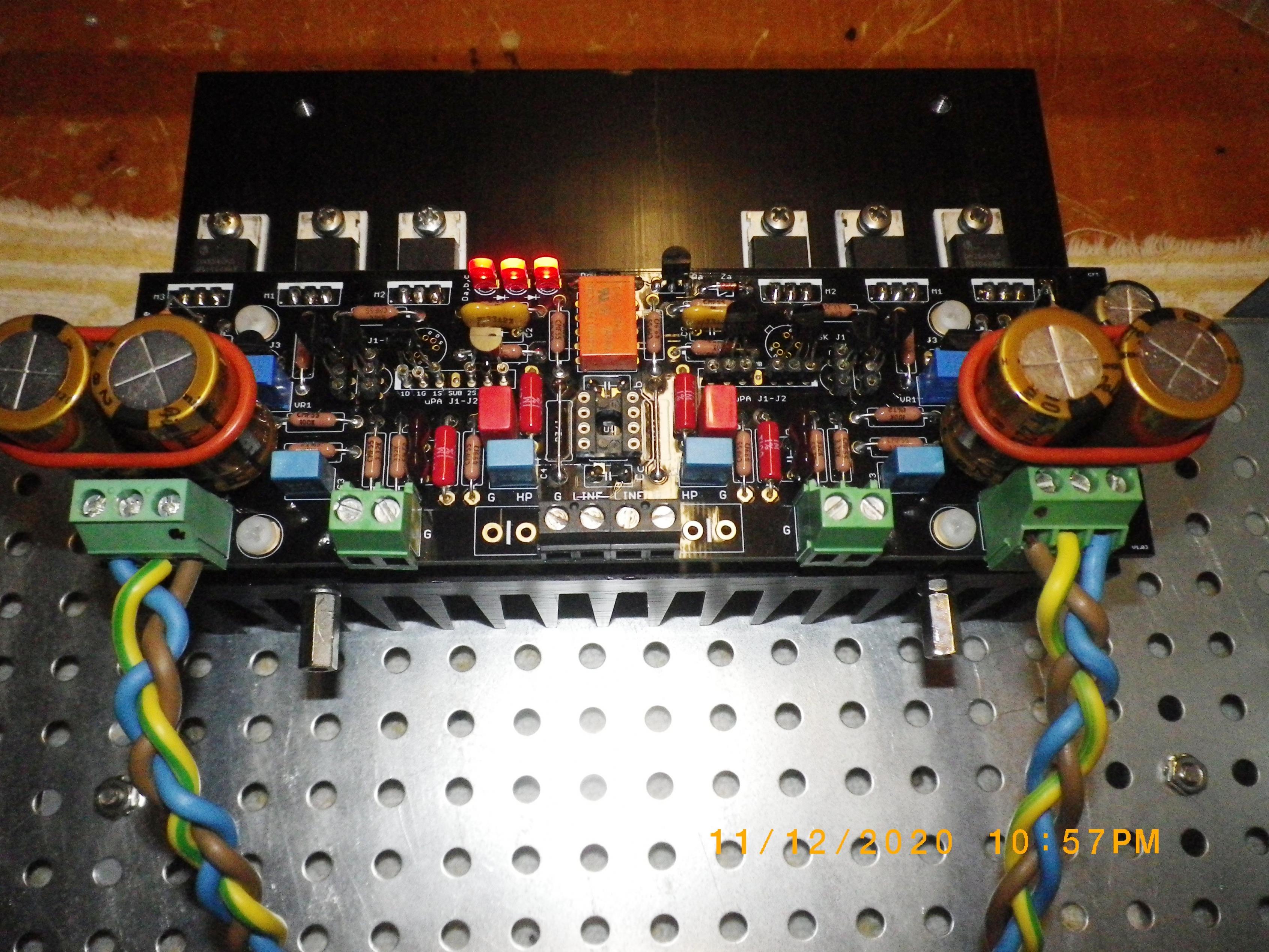

Well Savvas i have and Dale 1MΩ also but the PRP its Red color you see... im Olympiakos..... Hahaha i like the different colors. I will use Ubib for Psu are already ready for use 300ma bias 17V. I have matched Bc327 and bc560 ON Semi...
That explains it, now it makes sense🙂. Anyway, psu makes difference, hell, diodes and filter caps make difference. You have a nice pre (6V6) to compare to. Not far to go now.Well Savvas i have and Dale 1MΩ also but the PRP its Red color you see... im Olympiakos..... Hahaha i like the different colors. I will use Ubib for Psu are already ready for use 300ma bias 17V. I have matched Bc327 and bc560 ON Semi...
fire it up.....no problem at all.
10Ω=1.406V after matched DN2540
10Ω=1.396V after matced DN2540
On 220Ω bias bf256b 905mv about 4.2ma
On 220Ω bias bf256b 915mv
i have a quad chinese 2sk170 bl after ignition shows me 45mv each channel ,after two minutes goes to 2-3mv each channel . about 5-6Ω + on trimmer add.
with opamp opa2134 1-2mv ....
34 C on heatsink Ubib and 33 C on heatsink DCG3.

Σαββα i will do it , Nick told me the DCG3 it is a diffrent story ..... will see..

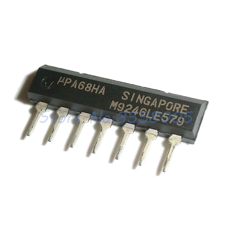

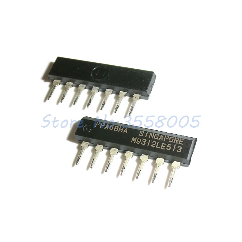

Nice DC measurements. Those are not 2SK170s you realize. I hope competent to some level as NJFETs in general.
Nick i expect this... Upa68ha
Are you sure they are not fakes? What make are they?
The NEC ones are made in Japan and look a bit different.
