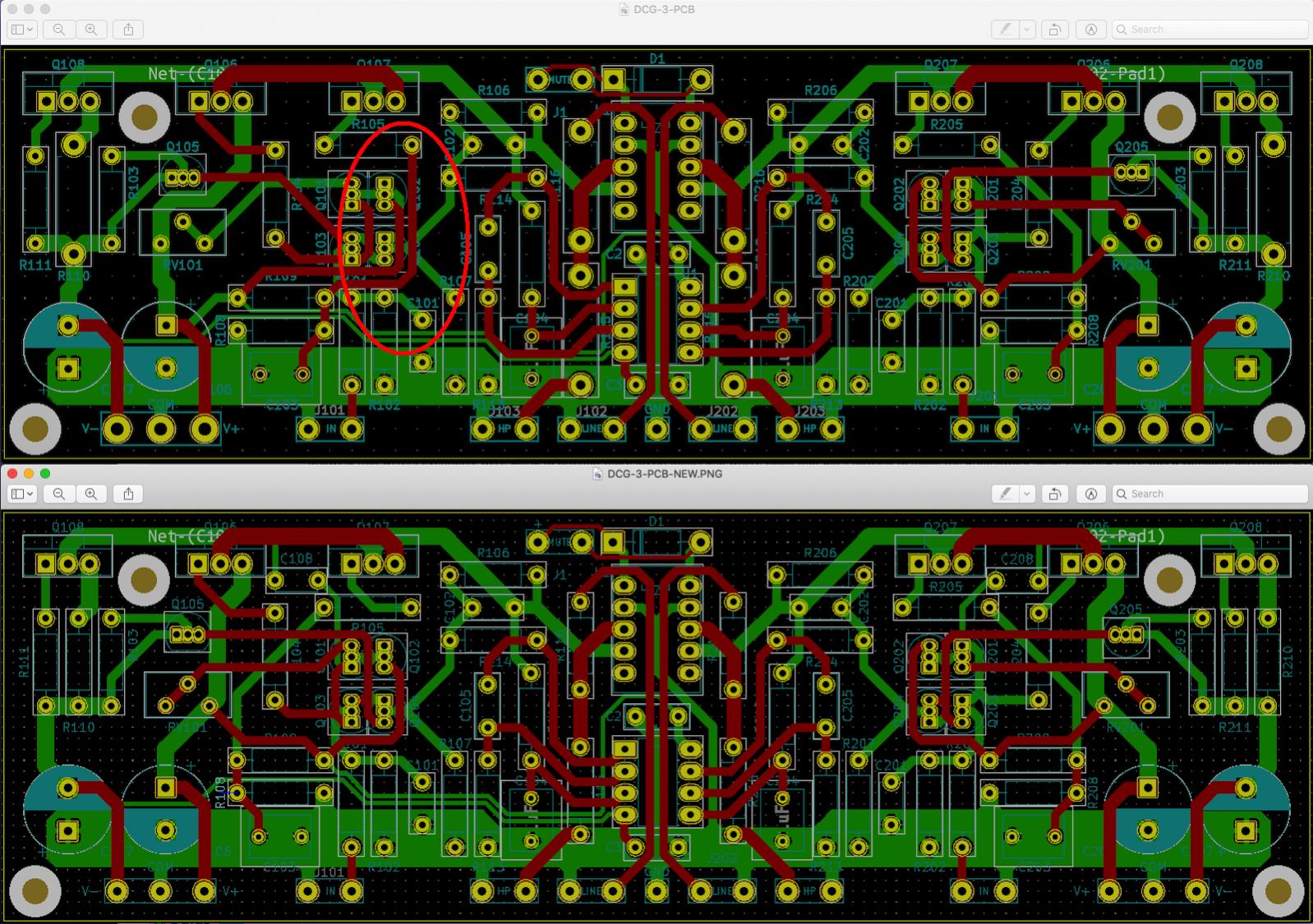

I didn't prove the cause of the instability, but I think it may be related to the trace from R105 (R5 on the official schematic) running right on top of the gate lead of Q104 (J2). The circuit was very sensitive to putting a finger in that spot. I found a way to reroute the board to make it more symmetrical and to get that trace out of the way on the left side. Hopefully that was the cause, but either way I like this layout better.

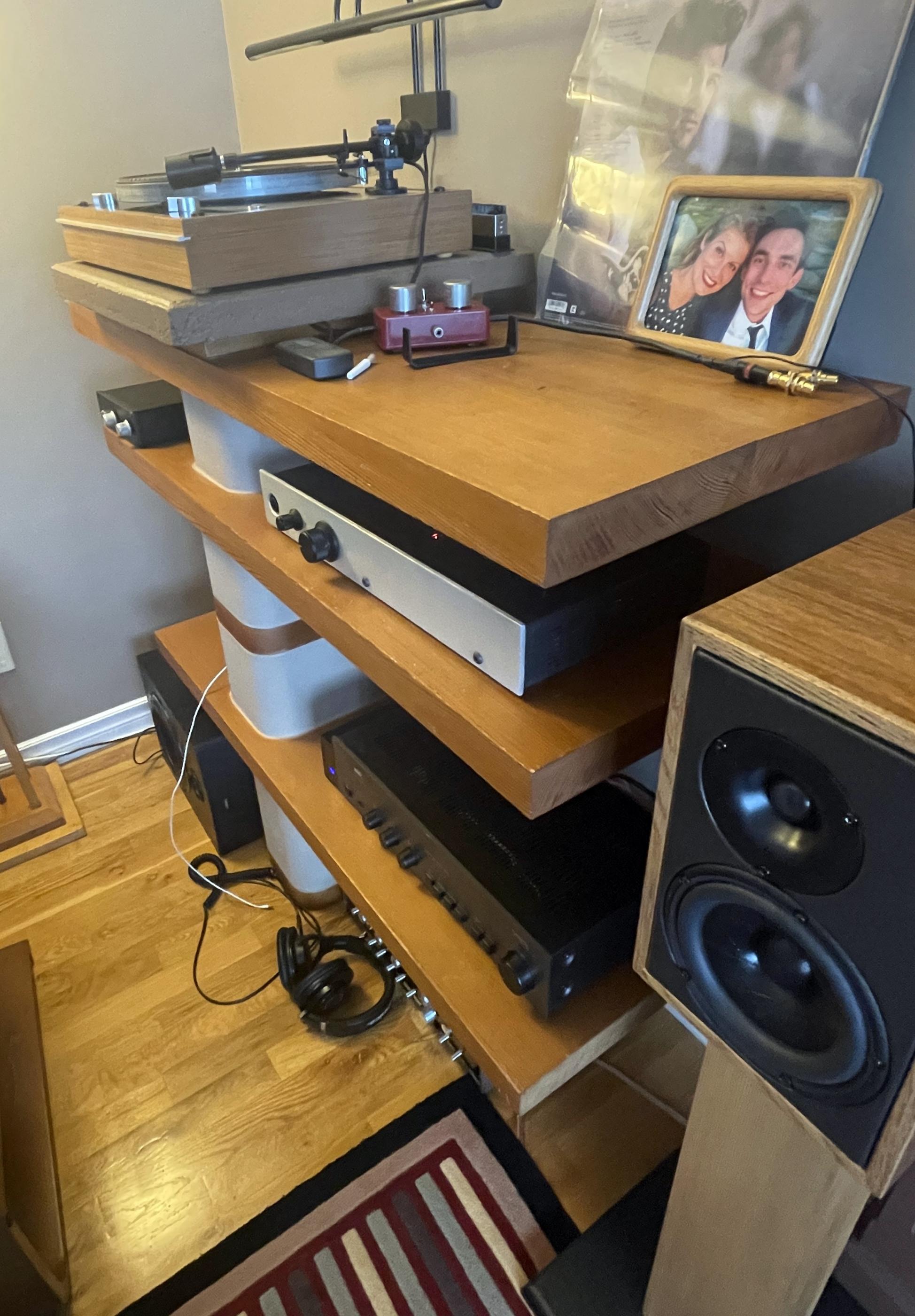

After three years of enjoyable listening with the DCG3 I recently feared that I had caused some serious damage, which resulted in distressing headphone noises. With limited troubleshooting skills, I feared the worst. While carrying the unit (sans cover) to my table in a dimly lit room I noticed that one of the led bars remained lit (from stored capacitance I presumed) and that its related MJE sink was cold relative to the others. I soon realized that while rearranging my audio components, I had inadvertently pressed down on the DCG3’s top cover, causing it to come in contact with the MJE sinks (and possibly other parts). A new BC550 and sink insulators made for a surprisingly quick fix, and I’m back in the saddle. Bottom line…those arrays are more than pretty lights
While I had the hood up I changed out the split bobbin transformers for quieter toroidal types, and rechecked offset. It’s now back in the center of my modest but enjoyable system. Thanks for a terrific bit-o-kit Salas, and for the work you do to make ‘the good stuff’ accessible to the rest of us.
