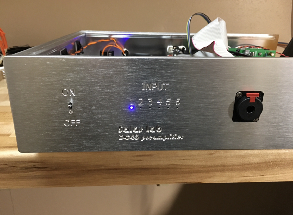

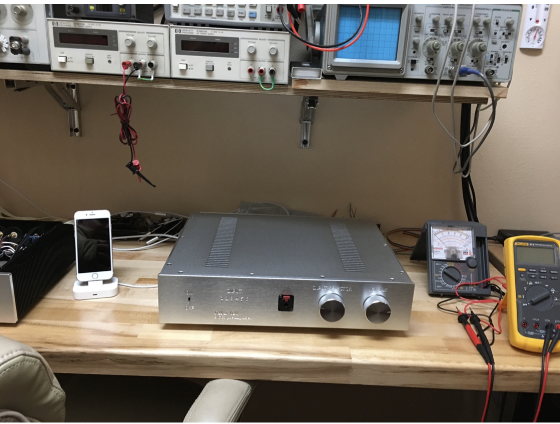

Maybe this one by Marra (post #1576)?
I would like to purchase this chassis from post 1576 with similar lettering. I will PM Marra but maybe someone can give some info. HI-Fi 2000 I presume!
My friend would like a chassis in a similar fashion to silver one posted but alexkosha.
Thanks!

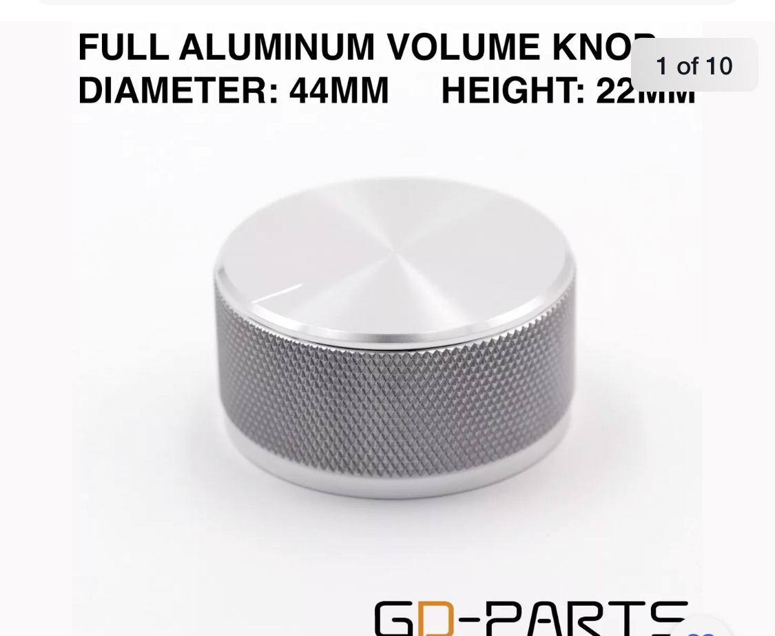

Yes it's a Modushop case with knobs that I Bought from RS in the UK. Just scroll down.
Buy aluminium knobs online from RS Components
Decals are press on vinyl from a company again in the UK who sadly are no longer in business.
