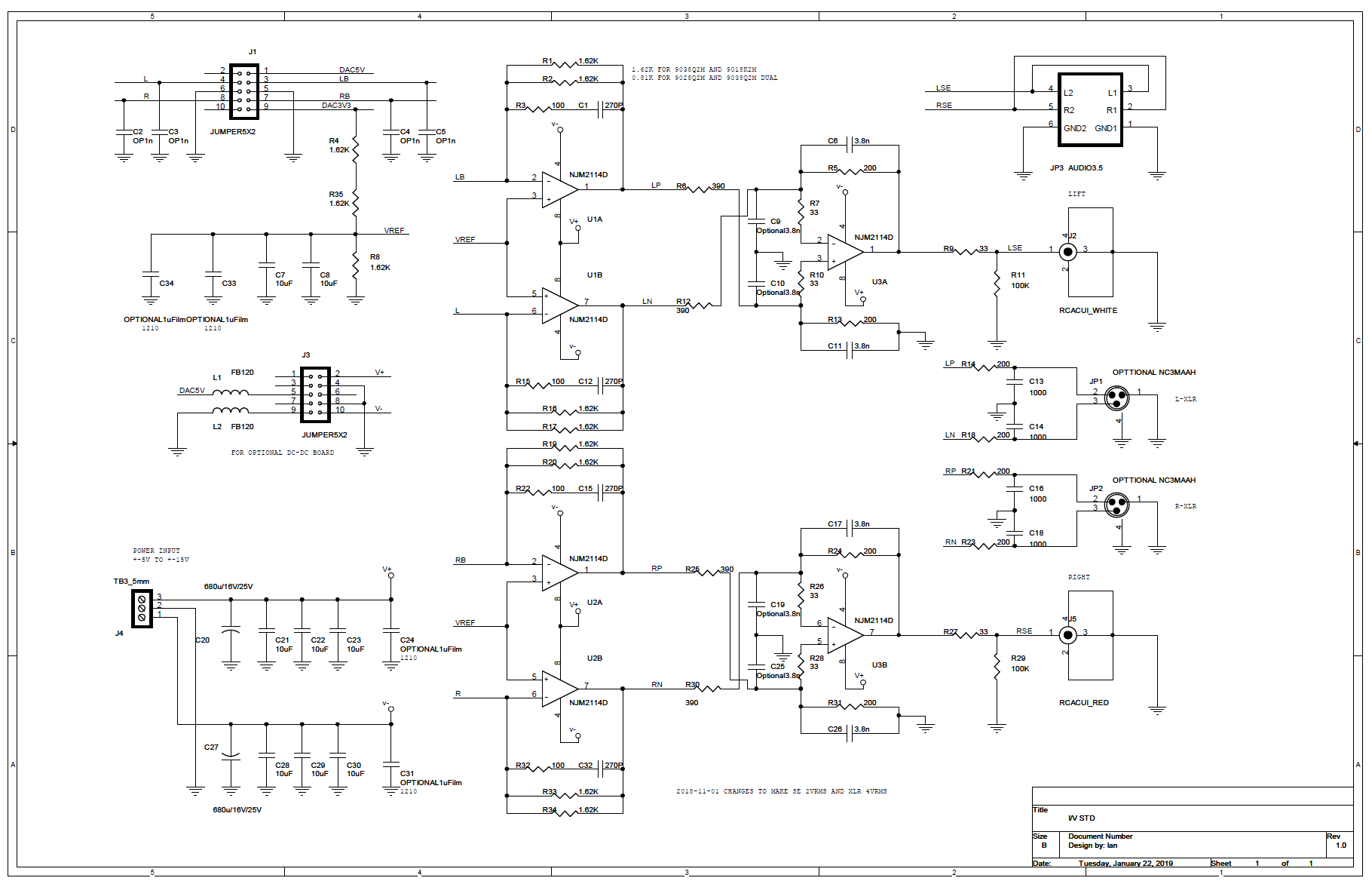

dcg3 as opamp for dac output bAL to SE output.
attached is the «IanCanada» dac output for sabre. The one in my topping d10s 9es3038q2m has the same topology but with different opamp and slightly different resistor values (about double the values for opamp network) and i would have to desolder the capacitors to know their values. The last opamp is the one i'd like to swap for dcg3. So the gain that opamp sees is between 2 and unity....could this be a problem? i will measure the already in there feedback cap soon... but i guess i could just extrapolate the value from dcg3 guide....
cheers and merry christmas to everyone of course 🙂
Has to be utilized like an op-amp cell with + - inputs, meaning open access to its feedback return node. Following established balanced to SE op-amp arrangements as described in technical articles.
I don't know if it would react badly or not, never had a reason to try it like that. In such a case I would have kept the rearranged networks impedance as low as in its standard application at least.

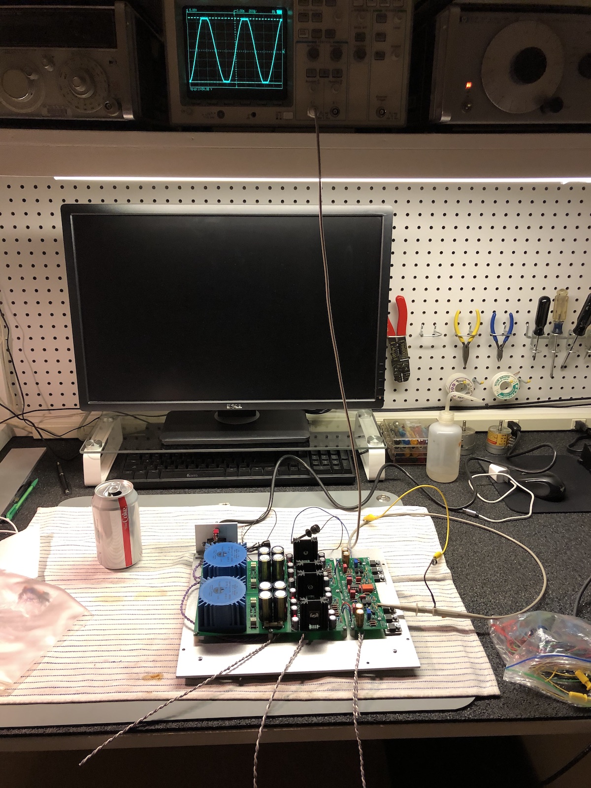

I've been on vacation for two weeks and have been working frenetically on packaging my preamp. It's close, but will be a week or two before it's finished. I think you will like the result.

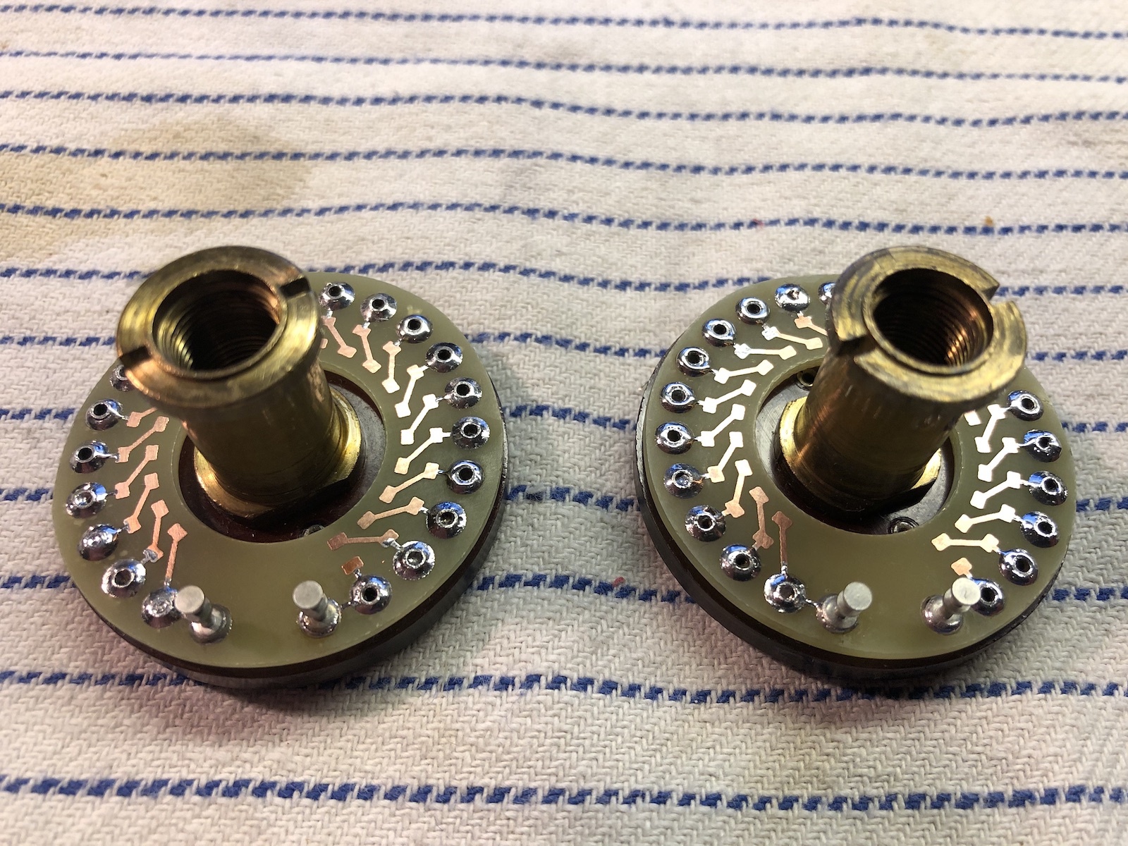

Here's a sneak preview. I'm building up a 20K Daven attenuator. I decided to use SMD resistors. I built this today; it was a lot of work.
-Henry
-Henry
Interesting and involving diy work. It will be nice to see the end result soon. Wishing a much healthier and luckier 2021 for all.

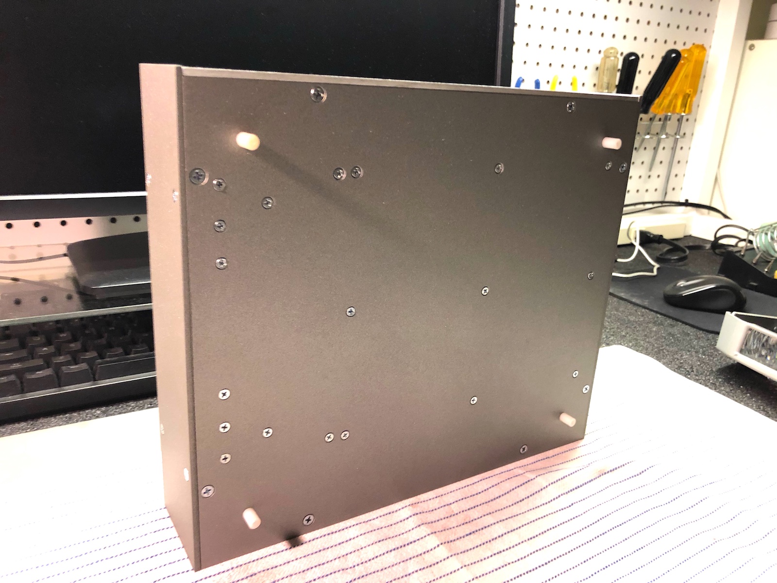

Thank you, Salas, and the same to you. I've enjoyed playing with your circuit. I must have over a hundred hours in this project by now. Everything always takes so much more time (and money) than I expect at first, LOL. I have limited machine tools, so chassis work is a challenge.

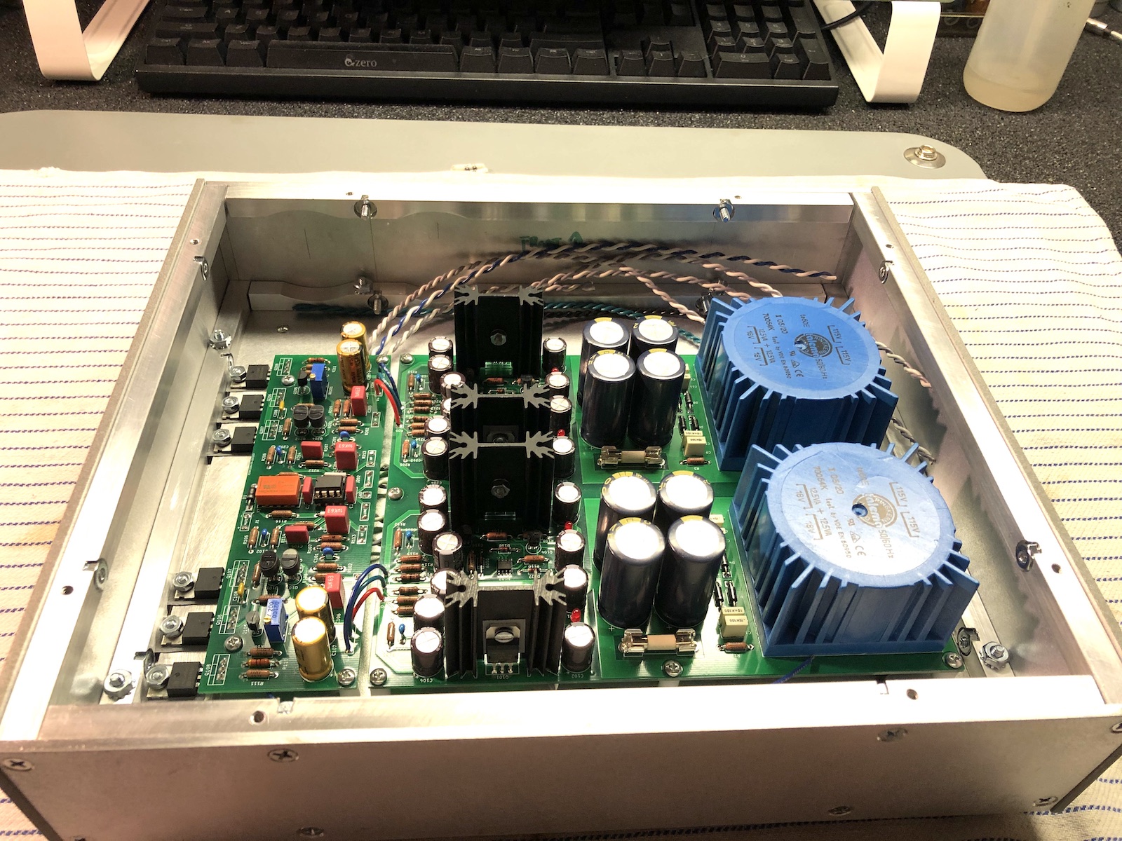

Here's a few more pictures.
It's interesting (to me) that the output can swing to the positive rail. I'm used to thinking in terms of bipolar cascodes so I was surprised the first time I saw it clipping at +17V on the scope. Not that it matters for headphone use, but I'm curious if you measured the distortion when M2 saturates.

I had but I did not keep it on file. It was something like a series of harmonics -80dB bellow the 1kHz fundamental when just before clipping. Clipping level wasn't exactly rail to rail but just a little below if I also remember correctly.
Nice heavy metalwork by the way.
