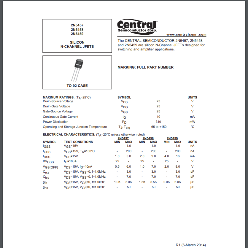

2N5457 can replace PF5102? Correct?
Maybe 2N5458 has the better ID range? What am I missing.
Maybe, but that old question was about what else I had in hand and tested successfully. I had few 2N5457 but not any 2N5458. BF256B is useful as a substitution too.

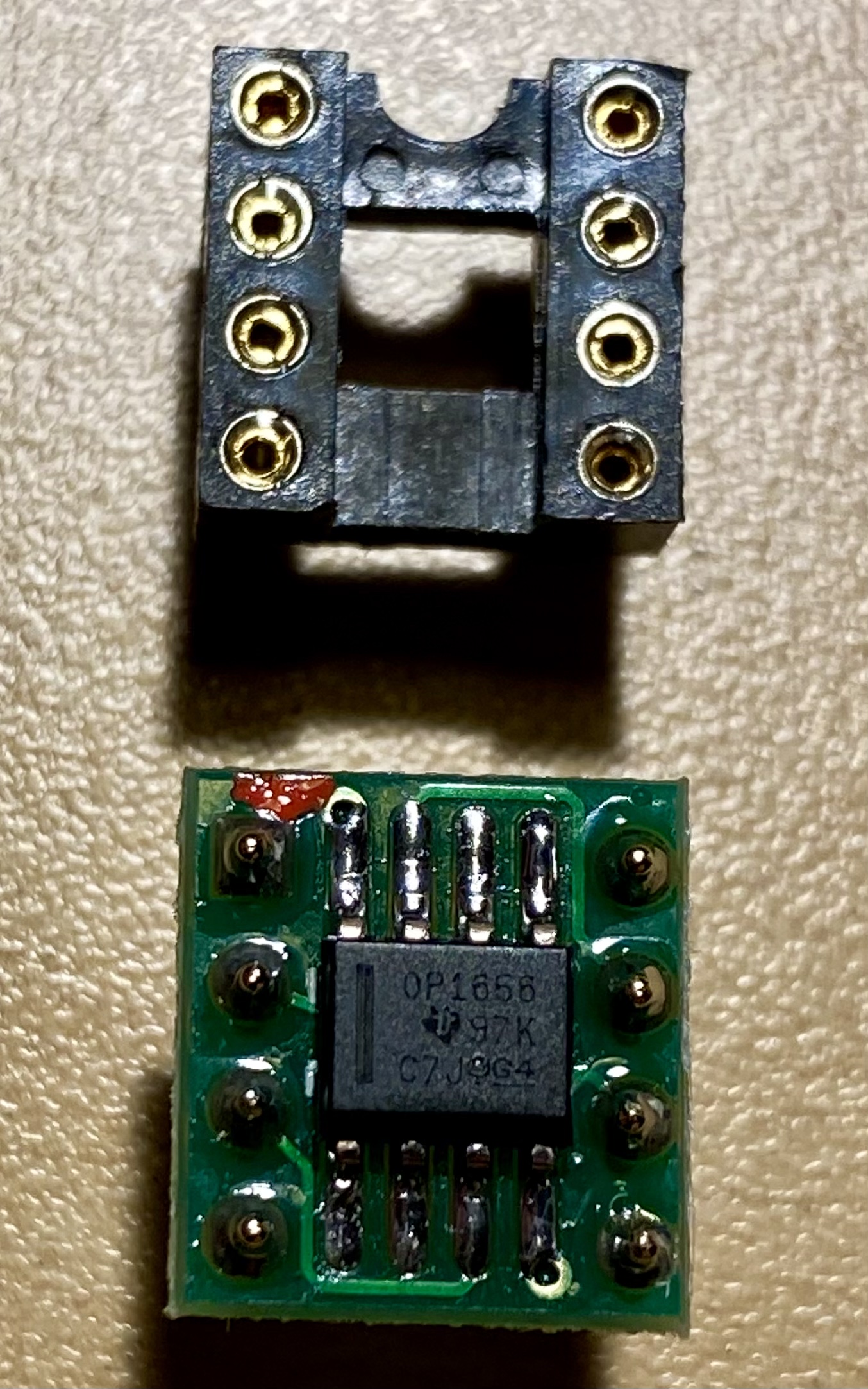

I don't know if opa1656 will be cheaper as i can't see a dip version. You need a soic to dil adaptor. 😕
PS ok even then will be cheaper...
To surely not be cheaper there is ADA4625-2 we have not tested yet. Costs much more than OPA1656 and needs an adapter as well. Hmm... 🙂
Thanks! So, should I order 2N5458 for those positions as the best choice when PF5102 is not available
Safer and cheaper than 2N5458. BF256B is 30V rated and raw DC with 18VAC Tx can reach about 25V or little more across those. Just before the three 100uF Vref filter caps across the LEDS charge enough. Very briefly though.
You will need about 150-200 Ohm bringing it down to 4-5mA instead of 33R R1,R2 for the PF5102 in the DCSTB. PF5102 or 2N5458 still have lower Vgs (OFF) and possibly little lower noise but BF256B is faster because it has less pF than those two.
*Remember: PF5102 pins are DSG when BF256B pins are GSD. So you have to reverse orientation.
