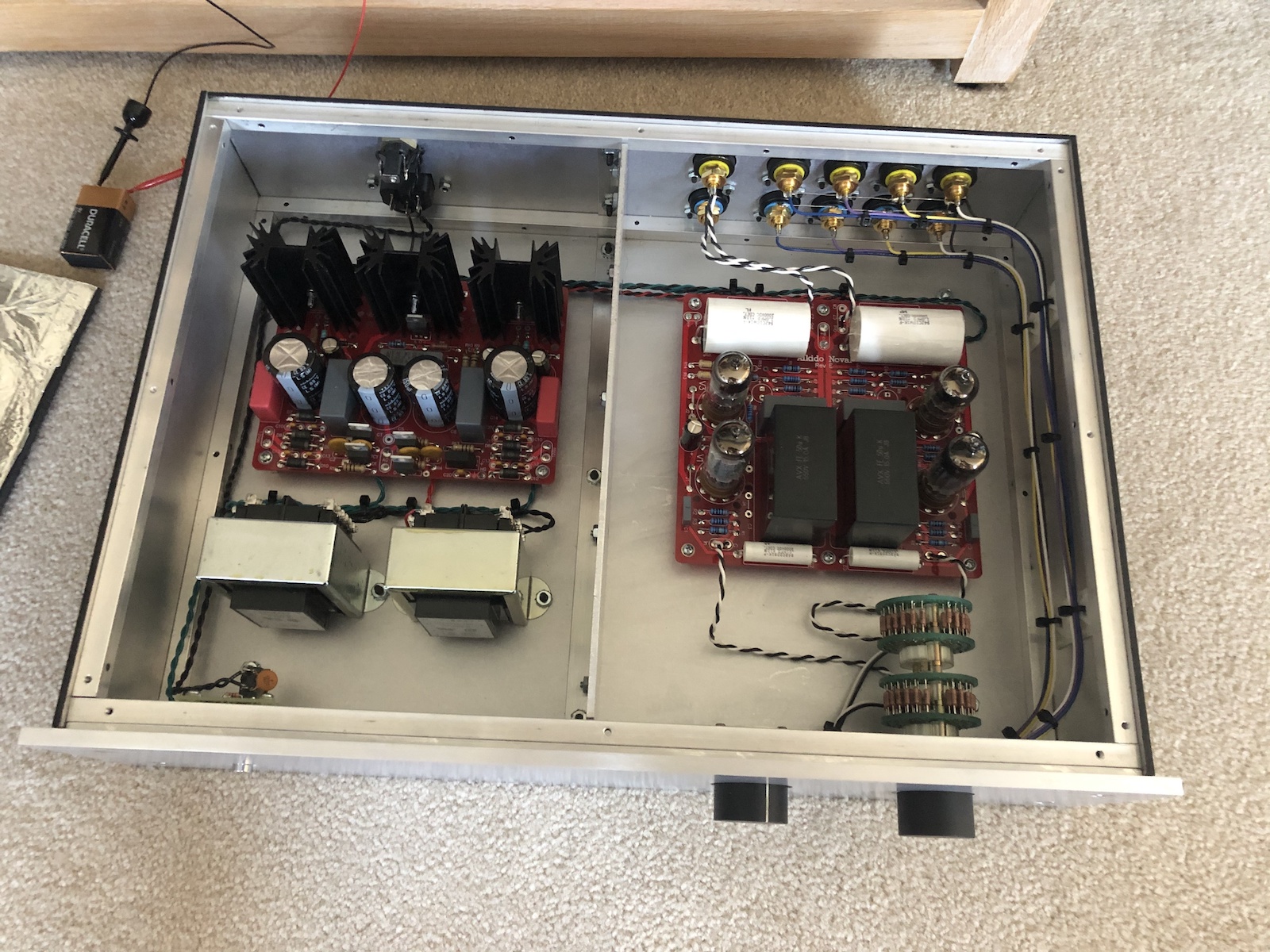

I played my balanced unit in SE so as to get a SE out and connected it to my AVC. I turned my stepped voulume attenuator at the DCG3 input to max where it is out of the picture. SE output connected to AVC.
Really surprised! I have to say that this has given me the best tonal balance and dimensionality from the DCG3, better than in balanced mode. I suspect the low output Z of the DCG3 suits the AVC.

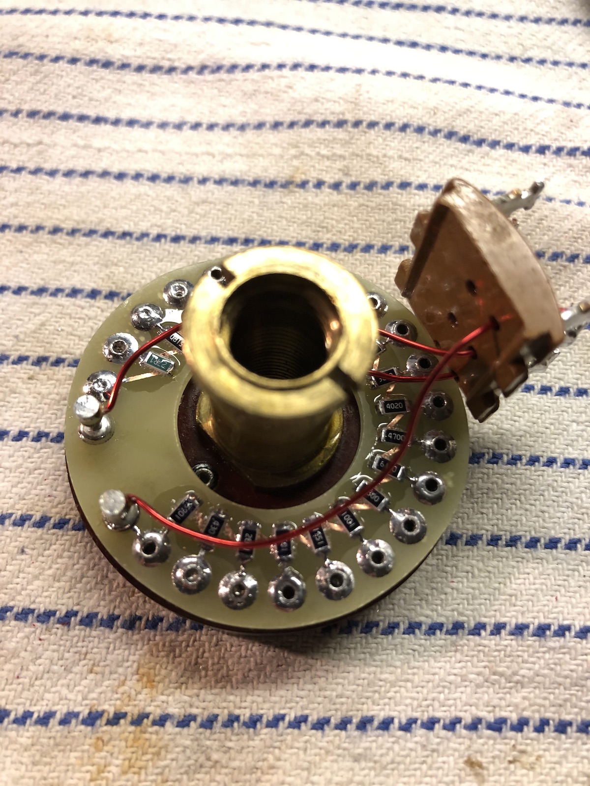

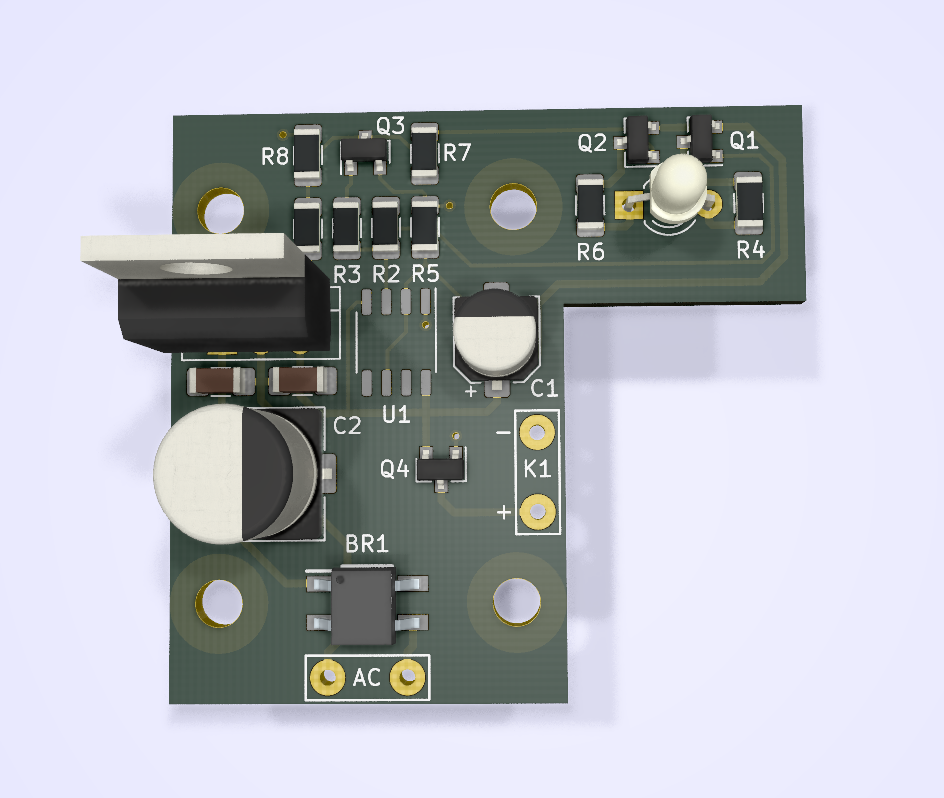

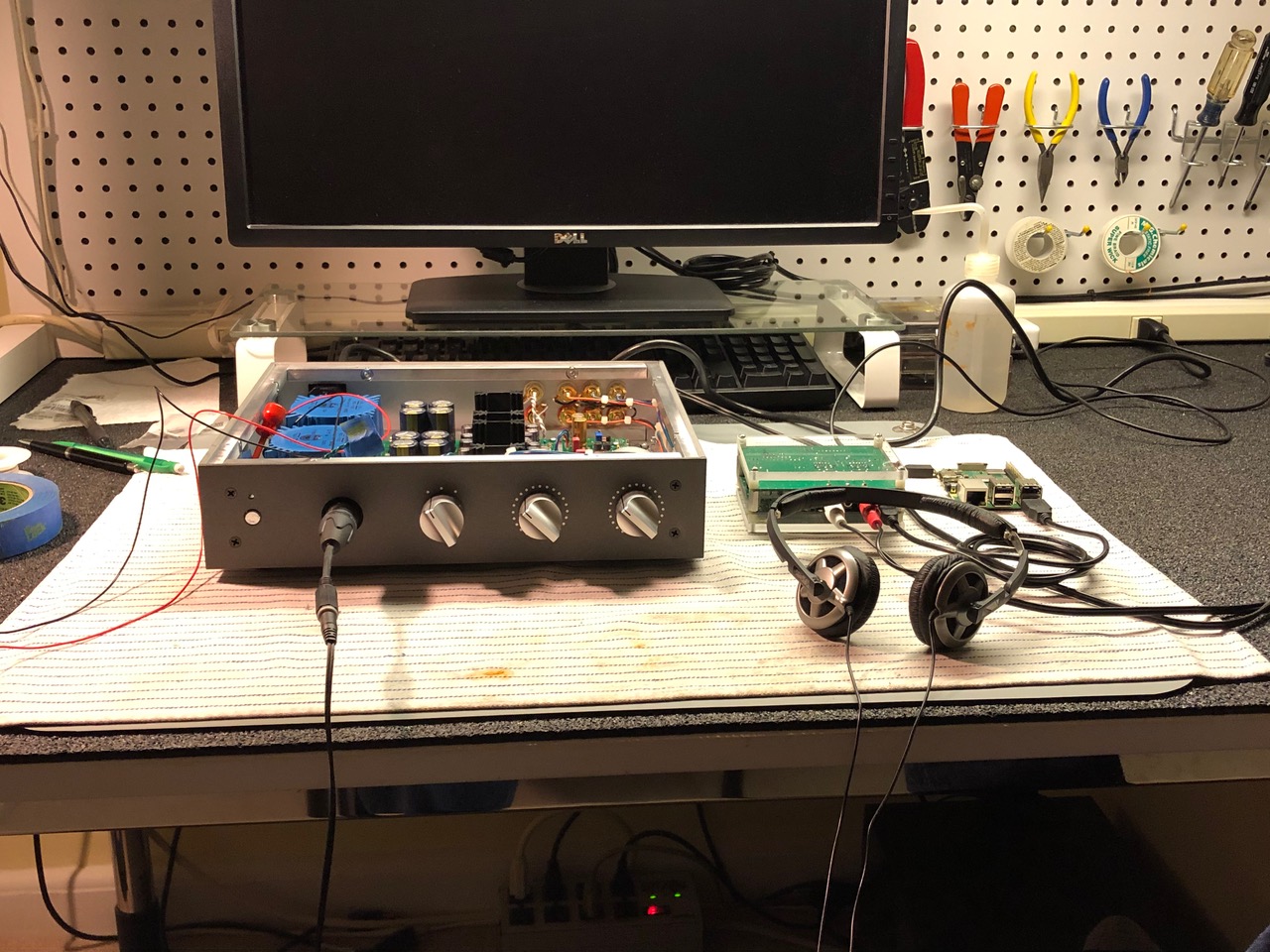

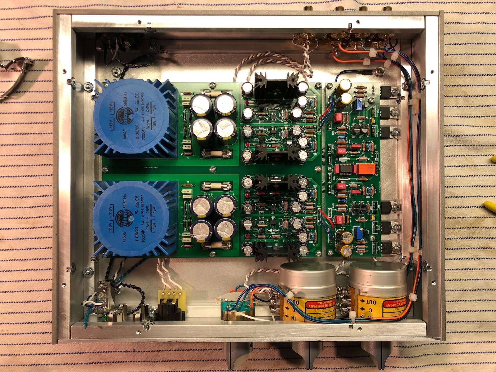

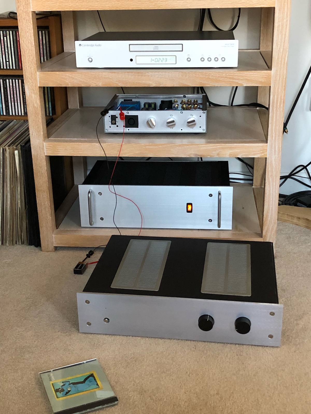

I got enough wiring done last night to hook the DCG3 up to the main rig this morning. I've designed a tiny relay/pilot light controller board that will mount to the front panel, but have yet to send out the files for fabrication. (I will use a bi-color LED for a nifty turn-on mute indication). For now, I energize the relay with a battery.
The left channel input wires are long to give me more room to work when the sub-panel is off the chassis.
Not to sound like a, um, broken record, Salas, but I'm very enthusiastic about the performance. Consistent with other people's reports, it sounds clean and transparent with strong bass drive and effortless handling of percussion.
In addition to the virtues of the DCG3 circuit itself, the Super Regulator and SMD attenuator seem to synergize well with this setup.
It's also so damned cute in this form factor.
My other preamp is an Aikido built with stock Broskie boards. I haven't done a side-by-side comparison yet, but the DCG3 seems like a real cut above the tube unit.
The power amplifier is an "AAK SymAsym" from diyaudio.com about ten years ago. This is also a very nice amplifier.
When I get the timer board done, I will install the decorative front panel. Though the bare front has a kind of cool industrial look to it...
