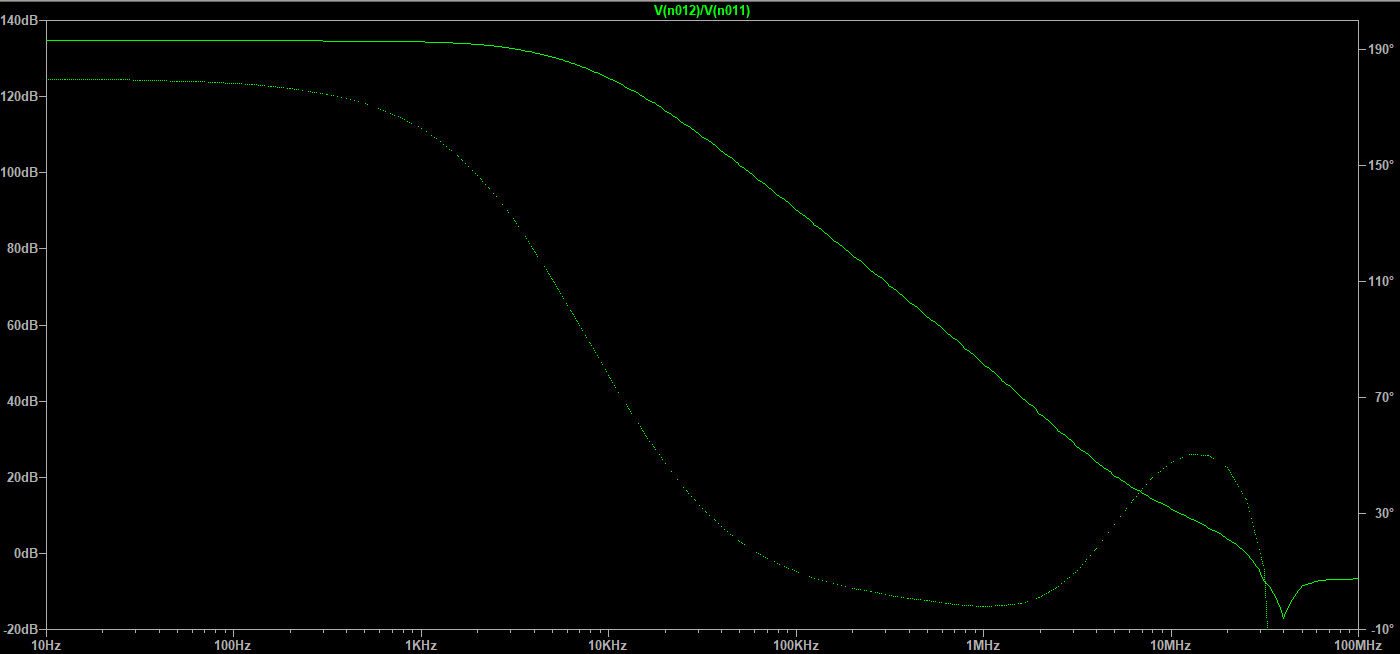

If your SPICE plot is to be trusted, you have two poles at around 10kHz and almost no phase margin. I don't think the high-frequency end of your plot is necessarily representative of the circuit in the real world.
Increasing the value of C2 doesn't help, as expected.
A lag network around M1-M2 should split the poles, but I've done neither measurement nor simulation to get an estimate of the effect. It doesn't sound any different to my ears with or without the compensation caps. But no oscillation, of course. I will try to get a SPICE model going tonight.
Maybe a more aggressive Zobel on the output would have the same effect, dunno.
With this high GBW, it makes sense compensation might be fiddly.

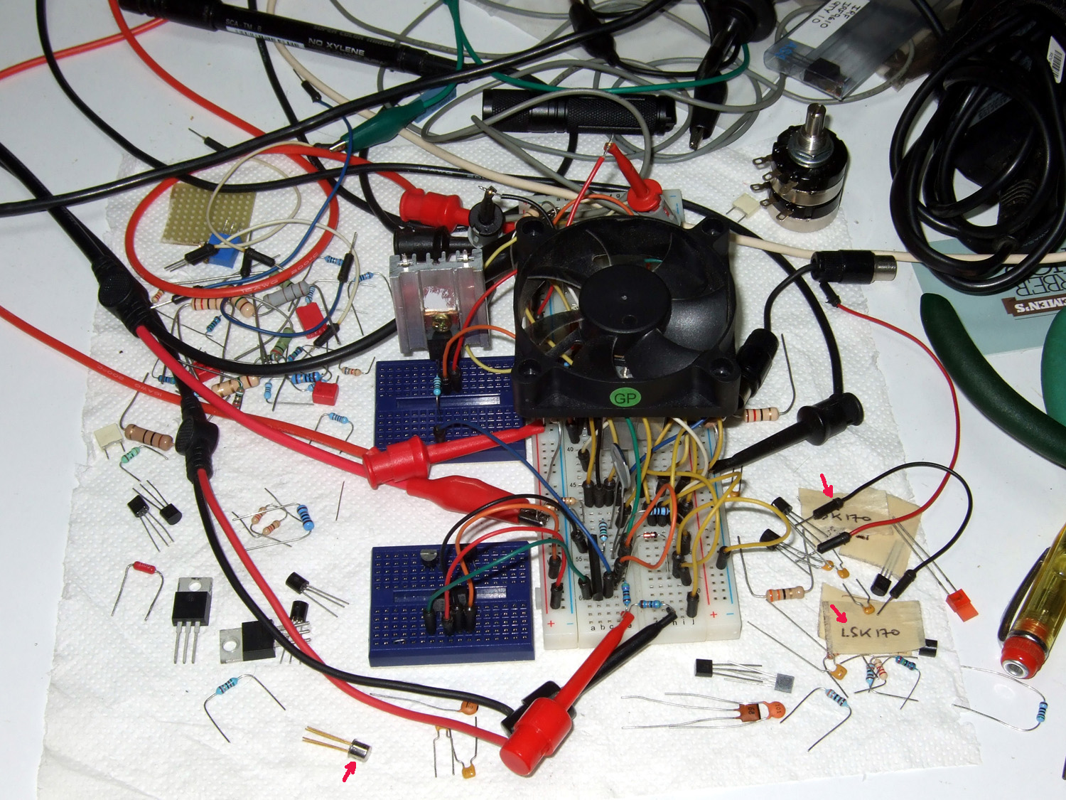

It's not a new development for me. Tested very well on its breadboard then on its standard board. Has been also built so many times by other people in that form without problems too that I am not inclined to change something because of Spice suggestions. It doesn't know what the board does to the circuit. You do well looking further into your implementation of course.
Having the experience of the development I suggest first thing is to try gate stoppers in your input JFETs. Spice would show a more degrees earlier than -1 (0dB) curve with 330pF C2 for instance but in practice I was only making it oscillate beyond 68pF. So it should be more reliably indicating around zero gain because it steals margin there in the sim too with more C2 pF.
I could try a Nyquist plot analysis too since -180 deg at G -1 is the instability point not just low phase points suggested along the phase line but I prefer the real thing experience since it was there before. Scoped, pulsed, loaded with cans and line gear etc.

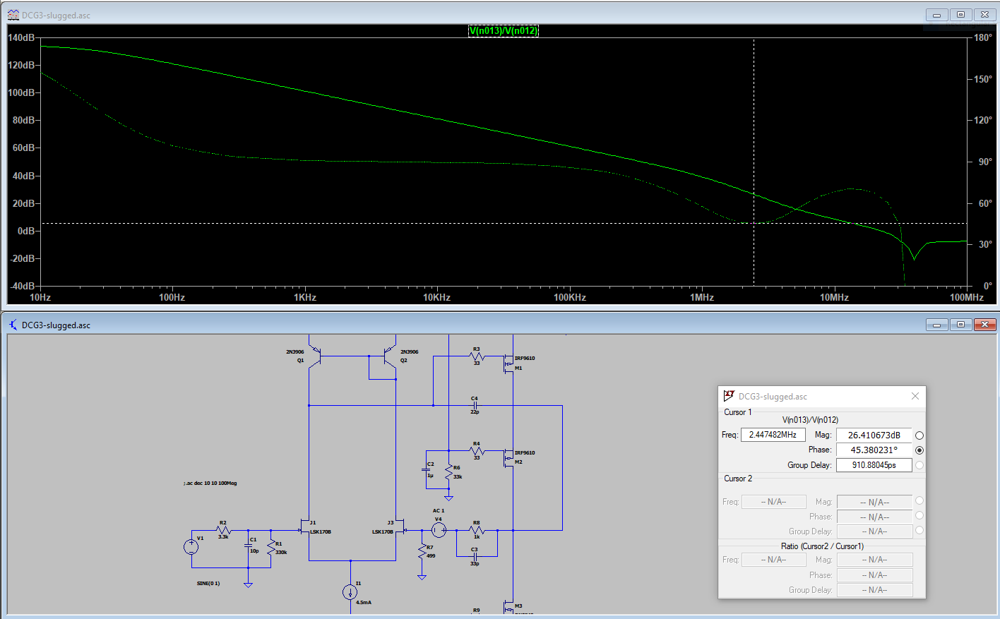

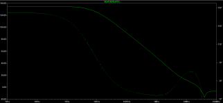

You probably will hate this, but I quickly threw together a SPICE model. The results match pretty well with what you posted earlier, including the alarming midband phase dip.
I then added my 22pF compensation capacitor. This happened to be the one reasonable value I had in my junk box. You can see it drastically splits the poles, increasing the minimum phase margin to 45 degrees. It's actually over 60 degrees at the unity gain crossover point, though the drop above 20MHz might be an issue.
As before, I'm not at all confident of the accuracy of these simulations at higher RF frequencies. But this is something to think about.
The downside, of course, is a significant loss of open-loop gain over much of the audio band due to the much lower corner frequency. Whether or not this is audible is another question.
-Henry

It will promote more treble distortion when losing open loop gain in the audio band. If audible it may sound harsher or brighter but compensate as you wish. Me I would have first tried gate stoppers on J1 J2.
Your design credentials are stellar, Salas, especially compared to mine, so please don't take this the wrong way. ASSUMING the SPICE simulation is at all accurate, even in my aggressively-slugged circuit there's still 75dB of loop gain at 20kHz. This is an absurd amount of gain and though it's possible, there's no guarantee the increase in distortion would be audible. On the other hand, again ASSUMING the SPICE is correct, the uncompensated circuit has a serious phase margin issue at low RF frequencies. And this could, in fact, introduce some hard-to-measure and hitherto unsuspected transient distortions that themselves would be audible.

I just soldered the 22pF compensation caps to the back of the board because I wanted to make sure it was the caps (or cap, since it's only one side) making the difference and not the two feet of wire clip leads. The board is stable, but I find if I put my finger on the gate end of R1 it breaks out again -- though it's oddly inconsistent. There's no sign of instability on the other channel.
One difference is I'm running 150 Ohms for R3 on both sides and the J3 on the "bad" side is weaker... So I have about 4.4mA total bias current on that side, and 6.6mA on the "good" side -- though I don't see how that would matter.
The board layout is as close to symmetrical as I could make it. I do think gate stoppers are a good idea. I need to see what SMD resistors I have lying around and do some more surgery.
