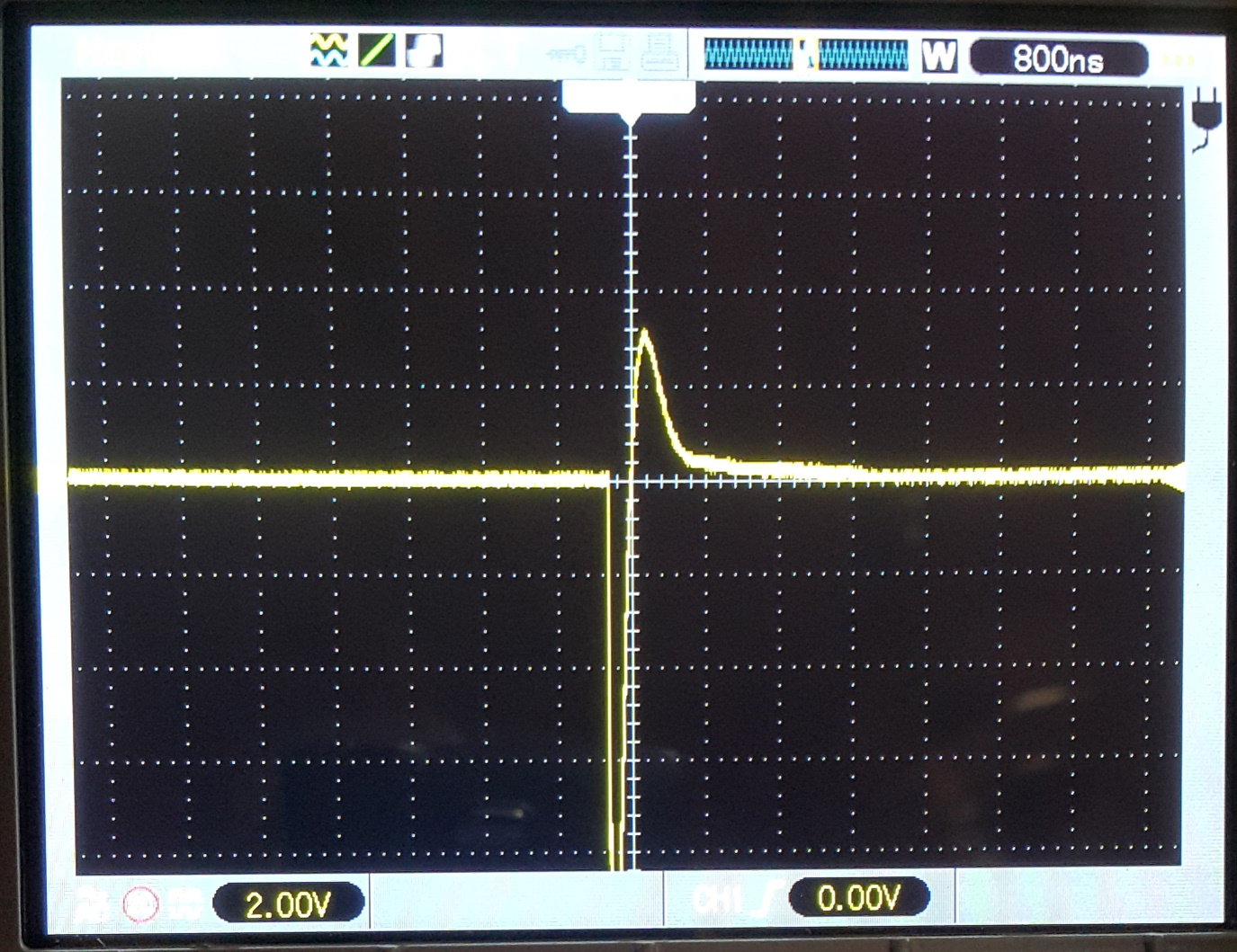

Transformers are 2x19V 60VA, because mains voltage is 220V in my area, so I have close to 2x18V with those 230V rated transformers. I’m sure difference to 50 VA transformers is small and same snubber values can be used. I have 10 nF, 150 nF and 16 Ω. For 50VA I would use 18 to 20 Ω. During Quasimodo test, it was almost the same with 16 to 18 Ω.

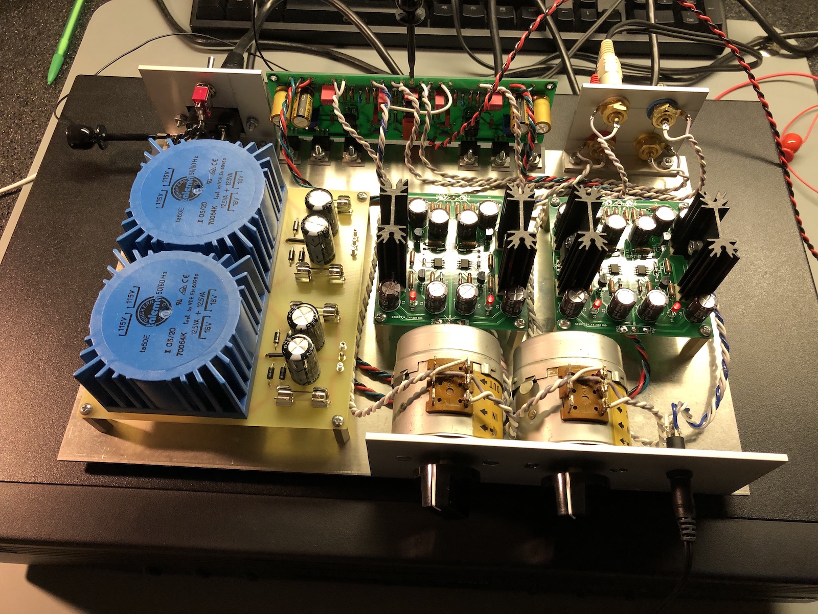

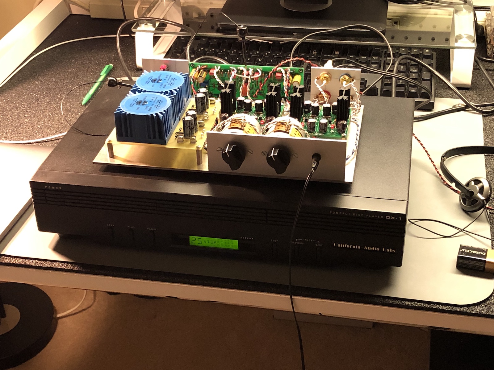

I built up a breadboard for testing and fired up the preamp this evening. I have an old pair of Sennheiser PX-100 headphones with no ear cushions (they disintegrated). The DCG3 sounds pretty good. It's very quiet and detailed.
I hooked it up to the living room stereo and had a sense of more speed and less distortion than my Aikido preamp. But it may be too much of a good thing in my system. I need to play with it some more.
I haven't built a relay timer board yet. For now I'm manually operating the relay with a 9V battery.
I have to decide if I want to leave it like this, or move forward with packaging it in a proper box.
Anyway, it's pretty cool. Thanks for sharing your design, Salas.
-Henry

Do you have any alternative PSU modules to listen it with?
No, this is all I've got for the moment. The raw supply is a little weak. I was planning on making a better board with more capacitance and snubbers.
I imagine the Jung-Didden regulator has a distinct sound quality. TBH, I don't build gear that often so I don't have a sense of how these things affect sound quality.
Just listening casually with my nude PX-100s, the "PRAT" seems really good compared to plugging into my laptop.
-Henry
The input JFETs are K170s you mentioned. What current mirror transistors type you use? What kΩ value and what model are those mighty double NOS looking volume pots?
I ended up buying a matched quad of LSK170s from the diyaudio store.
I used BC327-40s for the current mirror. I bought twenty On Semi devices from Mouser and built a test jig to measure hfe. They all measured close to hfe = 400 so I just punted and selected two pairs randomly. With the op-amp out of circuit I was able to trim the DC offset to less than 0.1mV and it seemed stable. So I think that's all working as it should.
The potentiometers are Daven stepped attenuators from an old RCA broadcast console. I stripped them and replaced the resistors with metal film parts. The impedance is 100k Ohms, which I know isn't optimal for this circuit. I have an Elma 24-position rotary switch that I plan to build up as a 20k attenuator.
