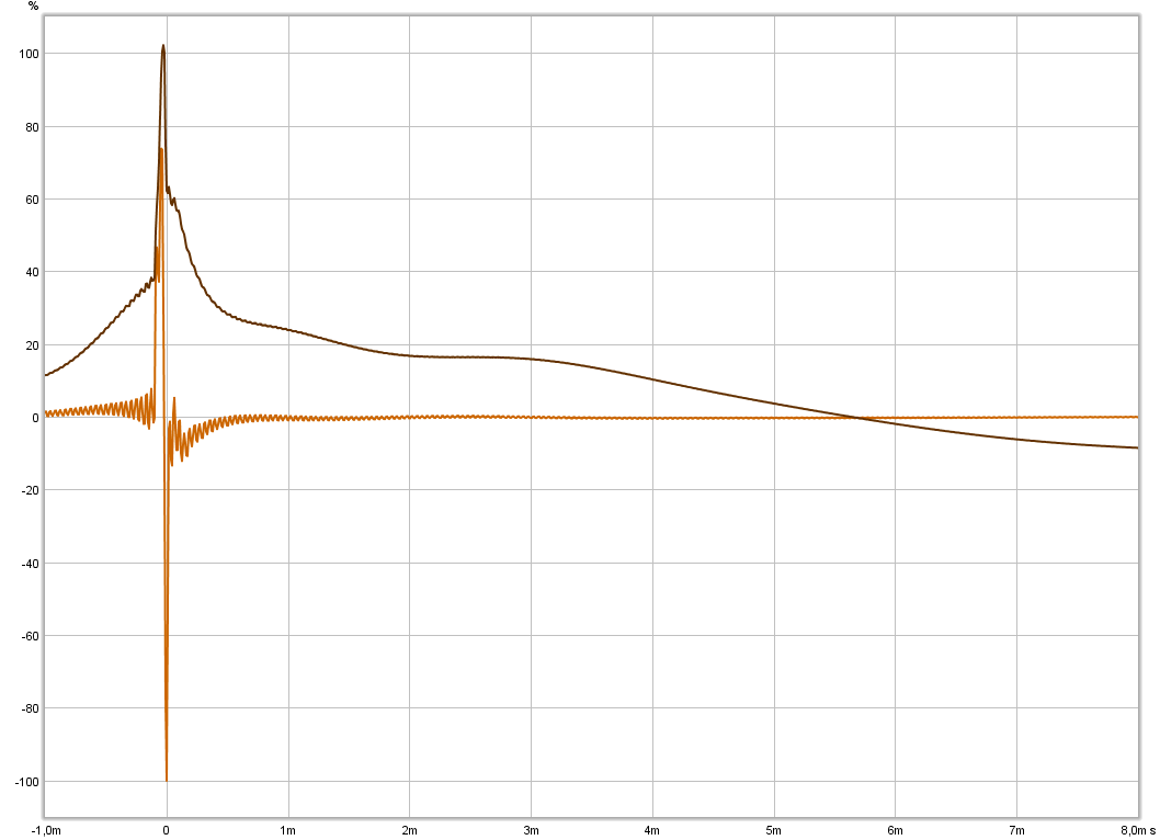

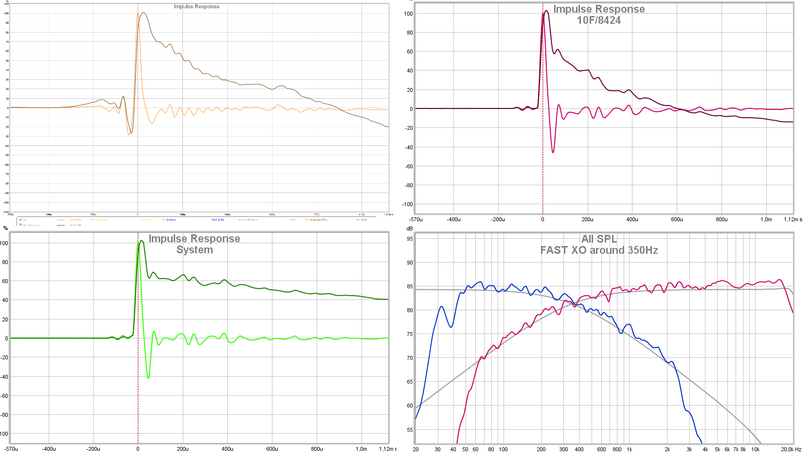

I found a setting in Najda for the "DAC interpolation filter roll-off" and changed it from fast to slow. I then changed the acoustic crossover from 500 to 800 (some weird dip at 400 not related to crossover made it difficult to measure what was going on) and dialed in a quick and dirty Harsch.
STEP goes to 900µsec now......
I also downloaded rephase so I might get some FIR-action going next week we'll see how that goes.
Happy Christmas everyone
Thanks, your new setting helped some.
For comparison found some old measurements that involve UMIK-1 microphone and tweeter 10F/8424 setup as FAST with first order XO and put those plots beside your last one.

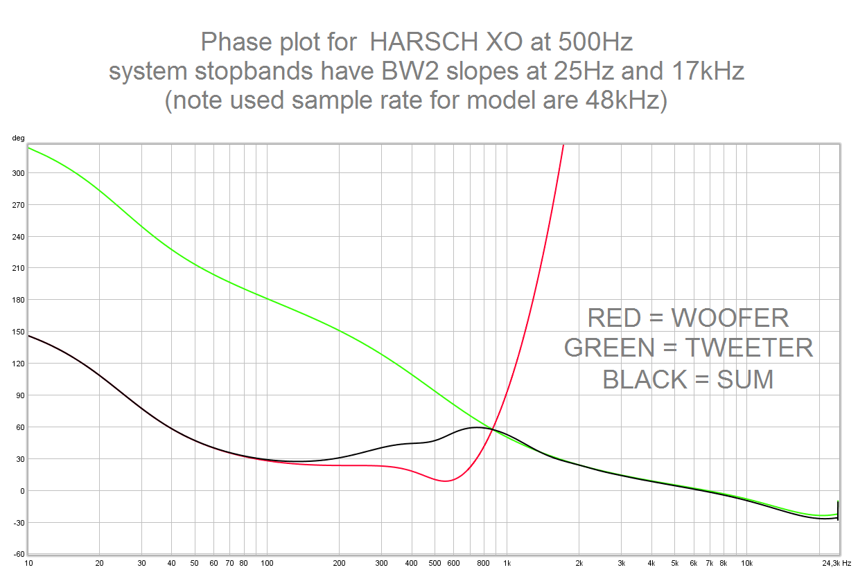

Speaker system stop bands are HP and LP of system and normal considered a BW2 slope, LP is f3 point of your tweeter and HP is room and placement dependent probably in area 15-40Hz (Woofer). I need those because with 3x IRR XO points (4x IRR band passes) inside audio band they push to each other slopes learned over at Rephase thread and Linkwitz website. Thoughts having XO out of sensitive region think is good thinking, example smooth or linear phase at your 120/400Hz XO points will give realism to sound picture is own experience where the 8kHz XO point is so high where speakers no matter what can't reproduce square waves in lack of bandwidth that then needs to reach up in 100-300kHz area as amps can do.
OK so just the f3 points of the speaker system. The woofer should be about 45hz in its sealed box, but I will most likely eq the low end down to an f3 of about 30hz. The f3 of the tweeter im guessing is ~25khz. It doesn't show in the datasheet, it cuts off at 20k :/

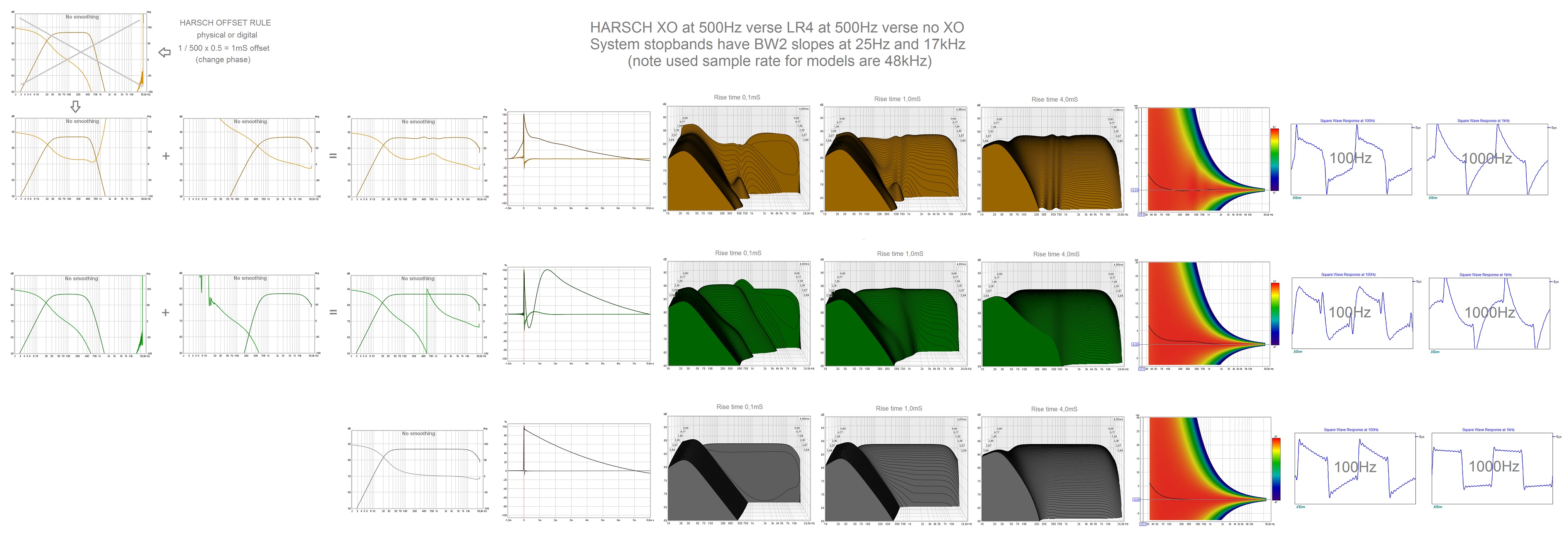

Harsch doesn't have phase wrap - it's almost flat linear with a 55deg rise and fall - not a 180 deg phase wrap. That means you have at least a hope of reproducing and square wave whereas LR2 and LR4 cannot hope to do so.
The percussion and plucked strings, piano all sounds more realistic with a Harsch vs LR. Phase is important - I agree and phase is better with Harsch. You have mild frequency response ripples but that does not equate to phase not tracking or not linear.

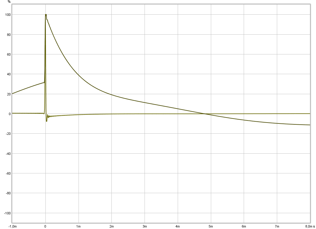

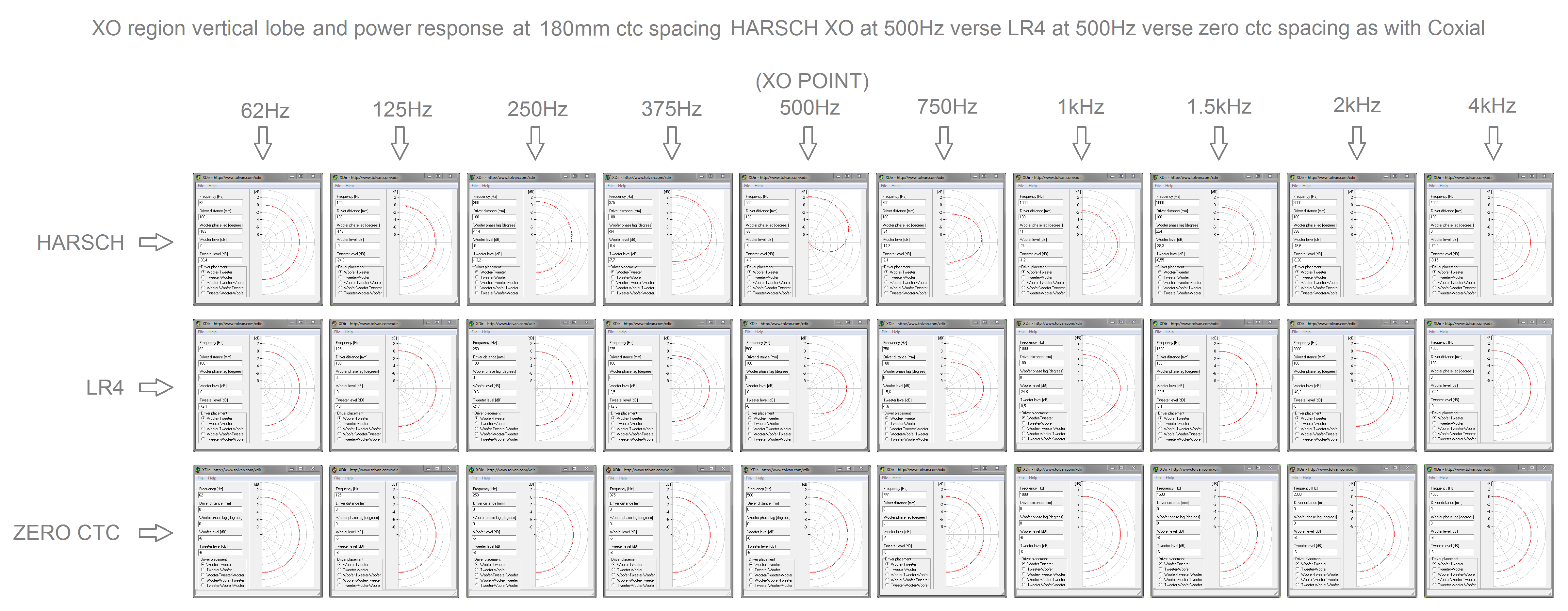

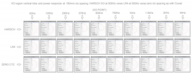

Because i had some theory models into REW close to Bob Brines FAST build ( http://www.diyaudio.com/forums/full-range/287478-what-i-am-taking-lsaf-6.html#post4739628 ) and ra7 after a beer down : ) question Harsh XO will share these visuals. Admit haven't listen to Harsch XO myself because have DSP engine with plenty filter tools to fully repair/correct amplitude or time domain, but think of Harsch XO as a clever compromise for builders who prefer or is limited to IRR filters combined physical or digital delay for driver offset.
Find below data Harsch XO compared to LR4 and no XO, for me it looks Harsch wins in waterfalls having cleaner mids as the no XO model. Being not in phase at XO point (see phase plot) as LR4 it has more complicated tilted lobe in vertical XO region as with 1st order filters but think power response in XO region looks be as relative good as LR4 perform.

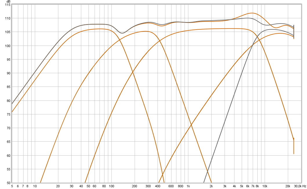

It is the target electro-acoustic transfer function, not the electrical only function. So it may require for example a first order electrical to get second order Bessel for high pass. The 4th order BW lowpass is usually one and the same for a woofer.
First EQ all responses as flat as possible with no filters and minimize use of boost eq.
On a 4 way it would go like this:
Subwoofer: BW4 LPF @ Freq_XO1, (optional LPF for infrasonic protection but avoid as it adds group delay)
Midbass: BES2 HPF @ Freq_XO1, BW4 LPF @ Freq_XO2, delay = 1/(2*Freq_XO1),
Midrange: BES2 HPF @ Freq_XO2, BW4 LPF @ Freq_XO3, delay = {1/(2*Freq_XO2)+1/(2*Freq_XO1)},
Tweeter: BES2 HPF @ Freq_XO3, delay = {1/(2*Freq_XO3)+1/(2*Freq_XO2)+1/(2*Freq_XO1)},
Typical Frequencies would be Freq_XO1=80Hz, Freq_XO2=800Hz, Freq_XO3=2.5kHz to 4.5kHz (to taste and to avoid tweeter distortion)
All drivers +ve polarity.

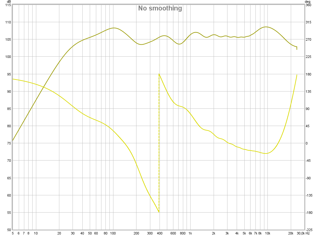

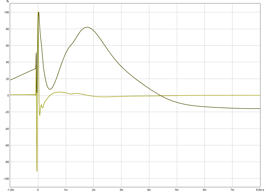

asked it because i did not received 2way harsch-like step response on 4way
You have tried it with a 4 way?
Do it in smaller steps. Tweeter with mid first get that to work. Then add mid bass and get that to work. As you add mid bass note that delays have to be applied to the mid+tweet combo together. Then add subwoofer and note delay has to be added to mid bass + mid + tweeter combo together. The delays are tricky because they don't include acoustic offsets that are native to the drivers. You can either measure the offsets via usual acoustic interferometry and simulation. Or guess what it is and fine tune delays by watching individual and combination step responses.
yea i have that xo still on my module list.
just asking has anybody else tried this on 4way?
my xo´s what ive done if alignment of tweeter and mid is correct step starts to seem ok, bass can be quite a lot wrong and it still look good step response.
...just asking has anybody else tried this on 4way?...
Not other than some theory modeling and think it gets into compromise chaos when following Harsch XO rules for summing so many narrow pass bands. Brown traces below is following rules and did quickly find that high pass tweeter BW4 (gray traces) instead of BS2 is better and some slopes can maybe get improved by smarter people than me, or by real world drivers inherent response that can end system sum better than this theory model. I'm not too optimistic to get it real good for multi-way in that think of Harsch XO type as a compromise way to TP as seen post 275. Picture 2 and 3 IR/SR is related to 4-way plot picture 1, and picture 4 is better data in Harsch executed as 2-way with same system stop band roll offs as the other two.
Sorry so late, it will make sound but think is some big compromise when run as theory model, although changing low pass slope for mid to BW4 will help as seen in previous post, and also maybe real world drivers inherent response and dispersion will show better than theory model.
