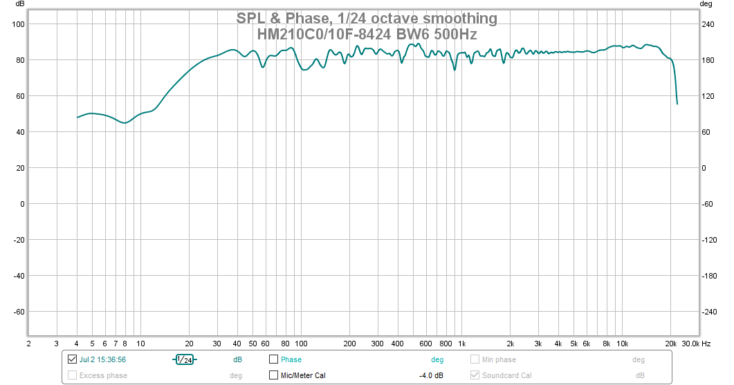

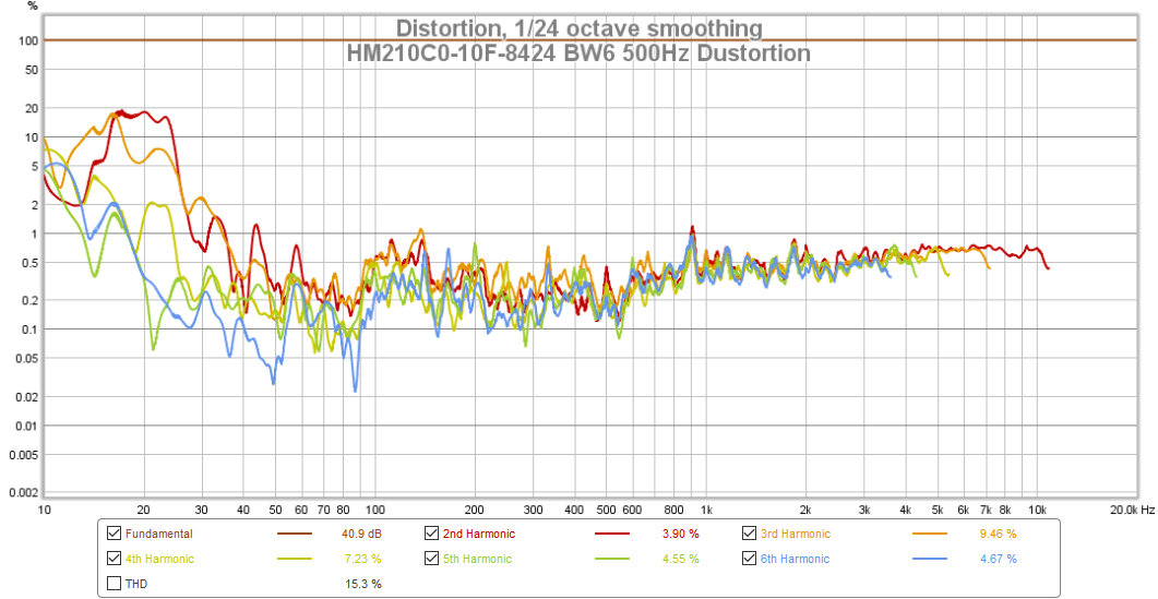

I did some more playing with XO's yesterday. Overall comment it is very difficult to get the perfect triangle impulse response, but easy to get an impulse with no ringing. The latter is good enough.
I did a comparison between a 500Hz Harsch and a 500Hz BW6. The graphs are quite similar, but the sound is worlds apart. The BW6 sound stage lacked depth, while the Harsch had great depth. I'm sure that you all have a copy of it , but I listened to the Vivaldi RV552 and with the Hasch, the echo violin was way back in the hall, while with the BW6, all four violins were in a line at the front of the stage.
I did not expect that much difference. It is all phasing.
Bob
Bob
