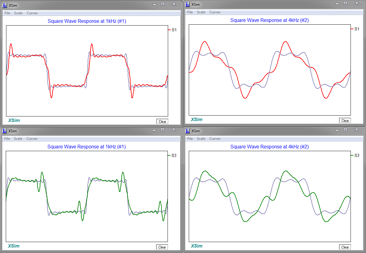

One general thing bout Harsch xovers tho, step response does not equal square wave one, and square wave response does not equal flat phase. The 4th order lowpass causes ringing, which impairs step response, does it not? Also, phase turn of just a lowpass, no crossover, is inaudible, because all we hear is its constant time delay. But if it rings, we can hear that.

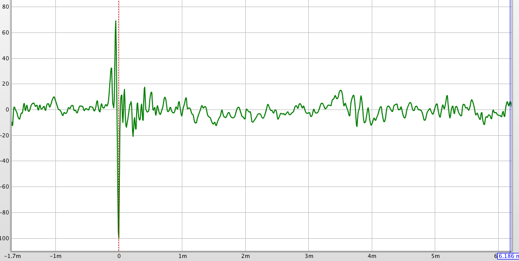

Well, color me impressed!
I have one of those rooms that are hard to dial in. I tried different approaches, different drivers, different positioning, different setups from closed, vented to OB.... I always had trouble... I could never get a clean impulse. It was always garbled up.
I recently got the miniDSP HD and figured that it would be the perfect time to experiment with Harsch XO.

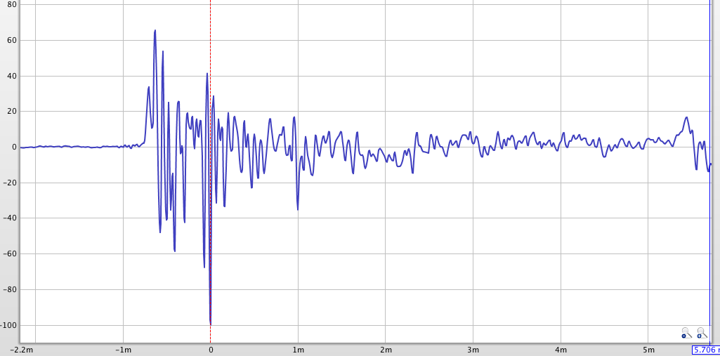

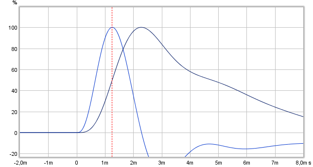

Now, this is usually the impulse I get in this room, which is about 4m x 10m and 3m high ceilings, cement open rectangle. I was never able to get rid of this double peak, and no amount of positioning of drivers or mic seemed to help, in fact, I've seen quite worse!
I applied a Harsch at 350Hz, and got this... now, there are a lot of artefacts before the impulse, which I don't know where they come from.
What I can say is that it does sound a lot cleaner! It's sharp, instrument location is great, it's quite enjoyable.
Also, the impulse seems inverted, but all connections are in phase, and positive is connected to positive everywhere... I checked all drivers polarity with a small 1.5V battery, and they are all fine. I'm not sure if polarity gets switched around within my mp, but that sounds pretty unlikely, wouldn't it be?

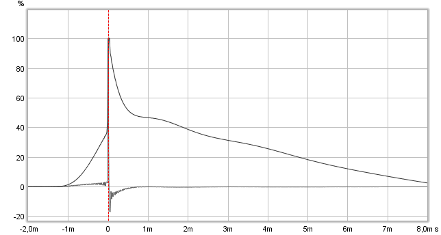

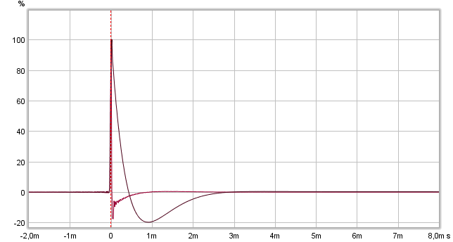

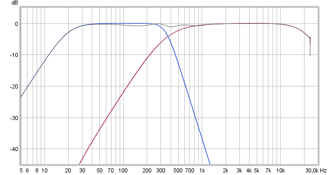

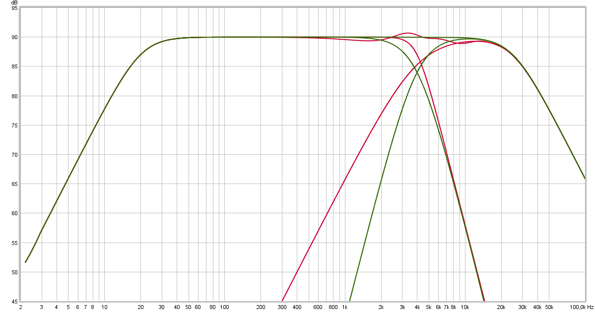

To help trouble shoot perceval find below synthetics for Harsh XO at 350Hz where system stop bands are set 20Hz and 20kHz inside a 48kHz sample rate window. First is IR/SR mid tweeter, second is IR/SR woofer, third is IR/SR system, then amplitude overlay. If you bench each band pass their polarity direction and overall look should replicate more or less to below and mid tweeter be 1,429mS delayed seen at SR for system.

Also agree Zonneschimmel that with particular hardware box and Rephase instead of using Harsch one can set also steeper symetric slope for mid tweeter and get away using either linear phase XO points or as last step linearize phase turn coursed by XO points minimum phase turn.
