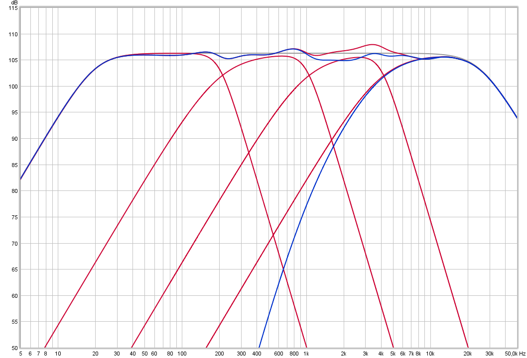

Try XO points at 200Hz, 1000Hz, and 4000Hz. I think most tweeters can handle 1st order electrical to get 2nd order acoustic of 4000Hz xo.
Although my feeling is that 3 way is best with B&O hole filler to which you make the upper 3 drivers have Bessel 2 high pass and subwoofer 4th order low pass with Harsch. So Hybrid Harsh and Hole Filler 4 way.
Because properly implemented 3 way as B&O Hole filler will behave as one big full range driver. To which we apply Harsch to integrate it with sub woofer.

Okay this got better after some more exercise and hard thinking 🙄 previous XO points was based maggieesnmacs setup XO points at 120Hz/400Hz/8kHz with BW2 system stop bands at 30Hz and 25kHz, X request XO points at 200Hz/1kHz/4kHz and was combined BW2 system stop bands at 20Hz and 25kHz. Previous model was based on 48kHz IR-wav files this is based on 384kHz IR-wav files and makes a difference, what the exercise and thinking was about is if its needed to build in slopes from other neighbor pass bands slopes too, and doing it for tweeter helped. That makes woofer/mid-woofer/mid is standard acoustic target slopes BS2 HP and BW4 LP, but tweeter HP slope have multiple slopes in BW2 20Hz + BS2 200Hz + BS2 1kHz + BS2 4kHz, and as seen below that helps smooth system sum looking at blue trace verse red.
Oh that looks much better - thank you, Byrtt.
This is actually pretty significant. I think this is the first time I have seen a Harsch XO demonstrated (via DSP loop back experiment) for a 4 way speaker.
Yes it looks much better and probably because those band passes is better distributed and wider than the one for maggieesnmacs, that said think we shall be fair and admit it ain't really smooth and studies seem tell that FR is king to have right, so stay two-way Harsch if possible or use FIR, unlesh drivers inherent response combined enclosure design can benefit XO summing is unsmooth.

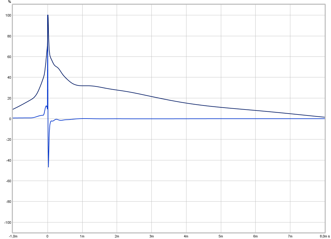

I did some more playing with XO's yesterday. Overall comment it is very difficult to get the perfect triangle impulse response, but easy to get an impulse with no ringing. The latter is good enough.
I did a comparison between a 500Hz Harsch and a 500Hz BW6. The graphs are quite similar, but the sound is worlds apart. The BW6 sound stage lacked depth, while the Harsch had great depth. I'm sure that you all have a copy of it 😉, but I listened to the Vivaldi RV552 and with the Hasch, the echo violin was way back in the hall, while with the BW6, all four violins were in a line at the front of the stage.
I did not expect that much difference. It is all phasing.
