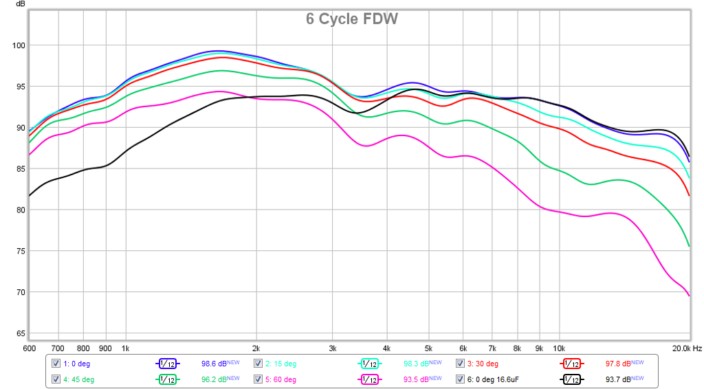

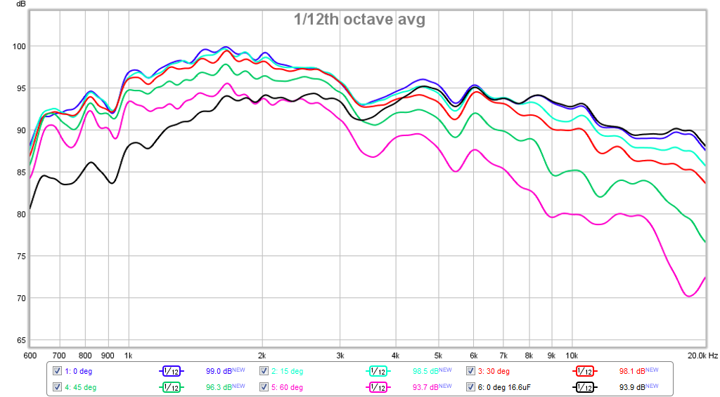

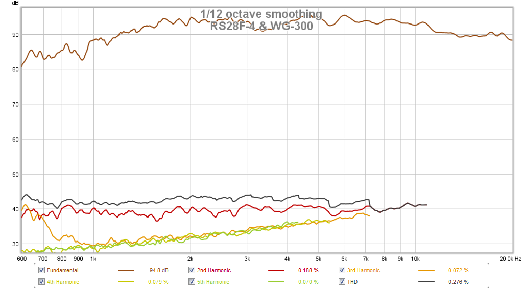

Waveguide fit makes a difference
I took measurements with the thinner waveguide adapter that now eliminates the small 1mm wide gap between the tweeter bezel and the waveguide throat. The new adapter was 0.025in thinner, exactly to account for the thickness of the foam gasket.
The new measurements look much better. I DC coupled the tweeter this time and ran it from 500Hz and up to reduce tweeter excursion. For one case I used a 16.6uF cap to reduce excursion and to also shape the response to show that it can flatten out nicely with 1st order high pass. You can see that the 5dB 3.7kHz dip, now is about 2dB and at 3.4kHz. Here are the (rough) polar measurements with 1/12th octave smoothing:
Here are the same polars with 6 cycle frequency dependent window smoothing to isolate just the effects of the driver and waveguide:
For the HD plot below, I AC coupled the tweeter with a 16.6uF film cap to reduce cone motion and limit distortion down below 2kHz.:
Anyhow, I think that this response is now good enough as a basis for me to make a passive crossover with it.
The polar response looks quite consistent and just has an amplitude fall-off.

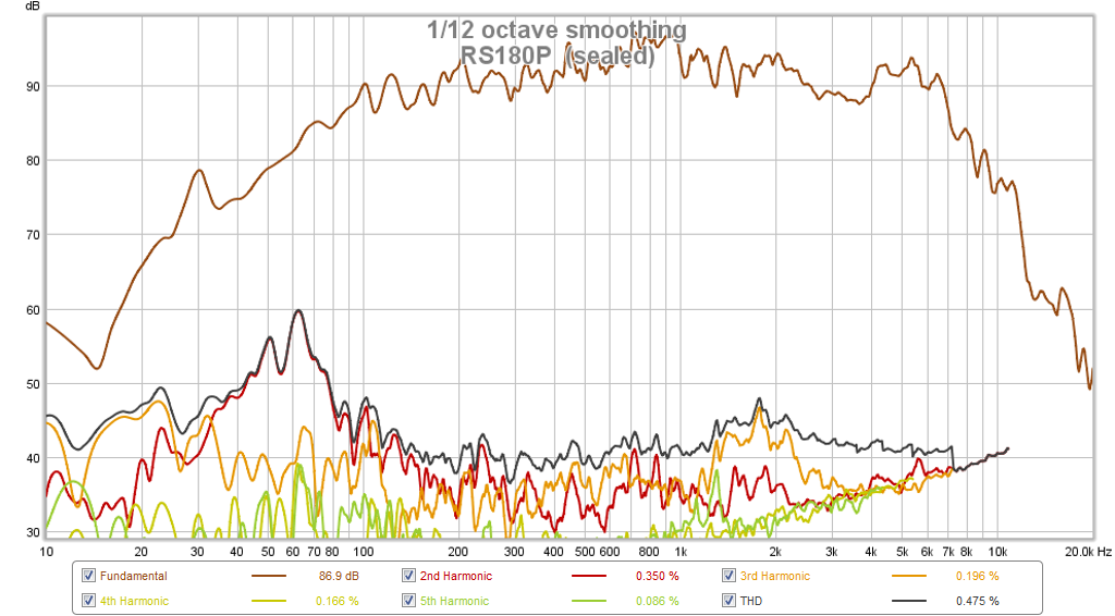

I couldn't resist, for grins, I took a measurement of the RS180P with no damping inside the cabinet with just the baffle loosely taped in place. It looks pretty good actually:
So we will see what all the box damping treatments can do for this...
