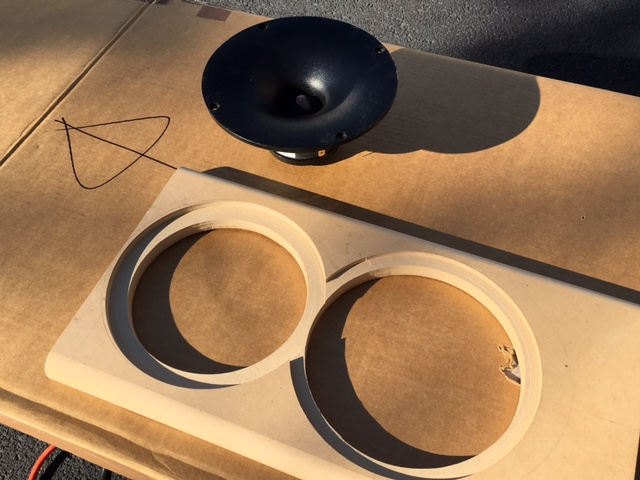

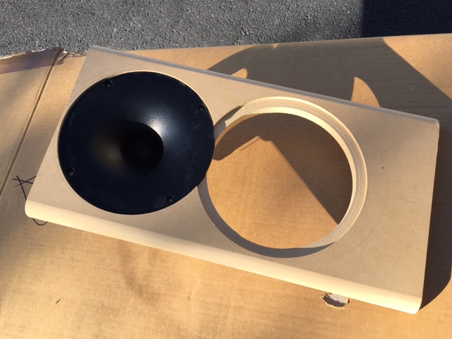

New WG baffle cut
More fun with a circle jig...
Now I need to trim the WG with a Dremel tool to fit the woofer bezel.

Trim WG to fit woofer bezel
A Dremel tool is your friend. 🙂
I also found that I have to reduce the thickness of the adapter plate by 0.025in (the thckness of the foam gasket in compressed state) to reduce the gap between the WG and the tweeter bezel to hopefully get rid of that pesky 3.7kHz dip. Re-printing will be needed.

Looks very nice for a hand dremel cut.
Thanks! ABS plastic was first trimmed with a hacksaw to get approximately close. The small 0.5in dia Dremel drum sander tool took it down rest of the way. Cuts like butter so have to be careful not to overdo. I sanded it inside a plastic bag to contain the debris. Worked well in that regard.

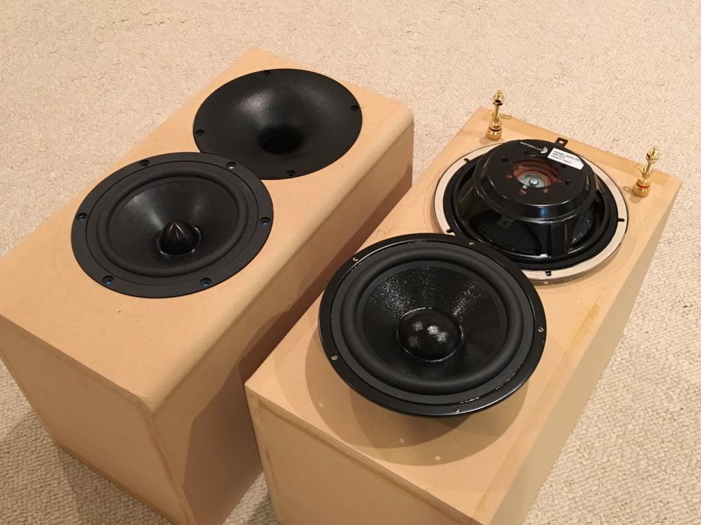

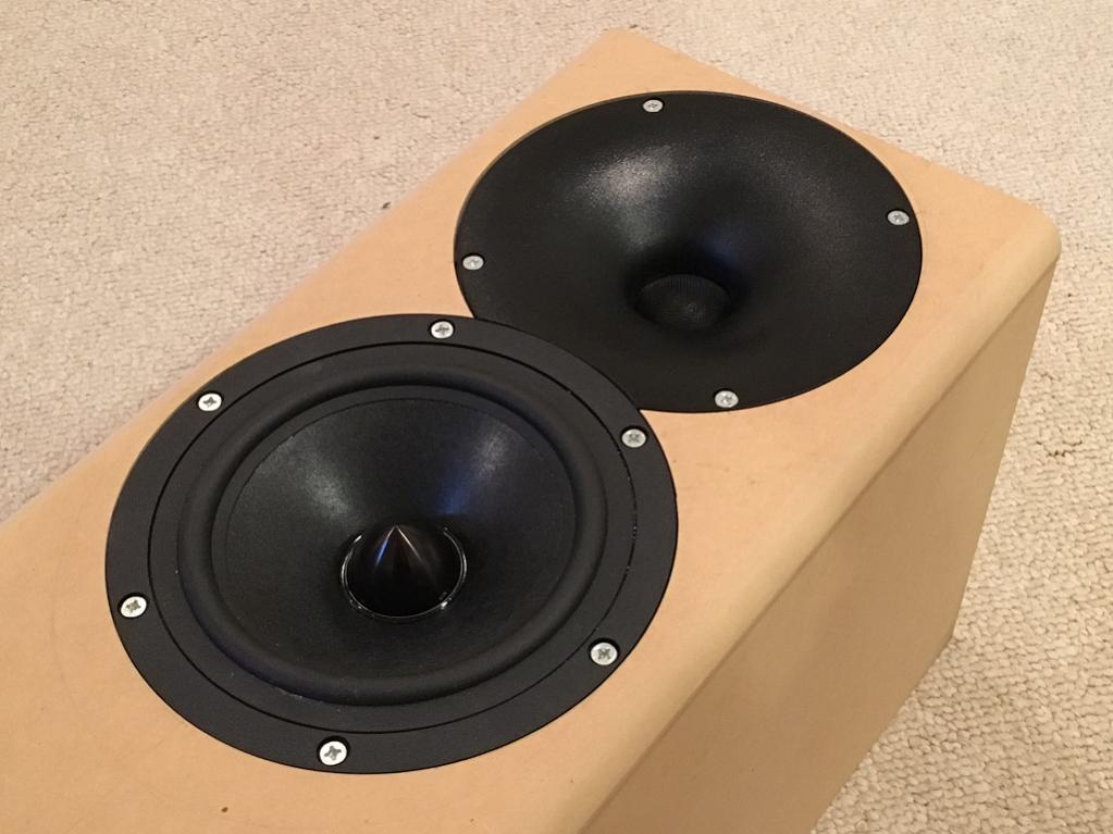

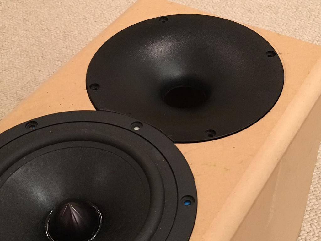

Drivers and WG fit perfectly
I installed the Spax drywall screws after drilling a hole in the MDF and agree it holds pretty well. If I take it on or off I will add glue to the hole as suggested to strengthen threaded fibers. The fit is perfect - not too bad for my first job with router and hole cutting jig. I made little trapezoidal sections of gasket using foam weather stripping to cushion and seal the waveguide against the baffle. Seems to work well. The woofer already had a foam rubber gasket under the bezel from the factory. Also, the new waveguide adapter plate, now 0.025in thinner, fits perfectly and pushes the lip of the waveguide flush with the rim of the tweeter edge. Hopefully this will make that 3.7kHz dip go away.
