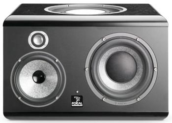

There's also a Focal 3-way with passive rad

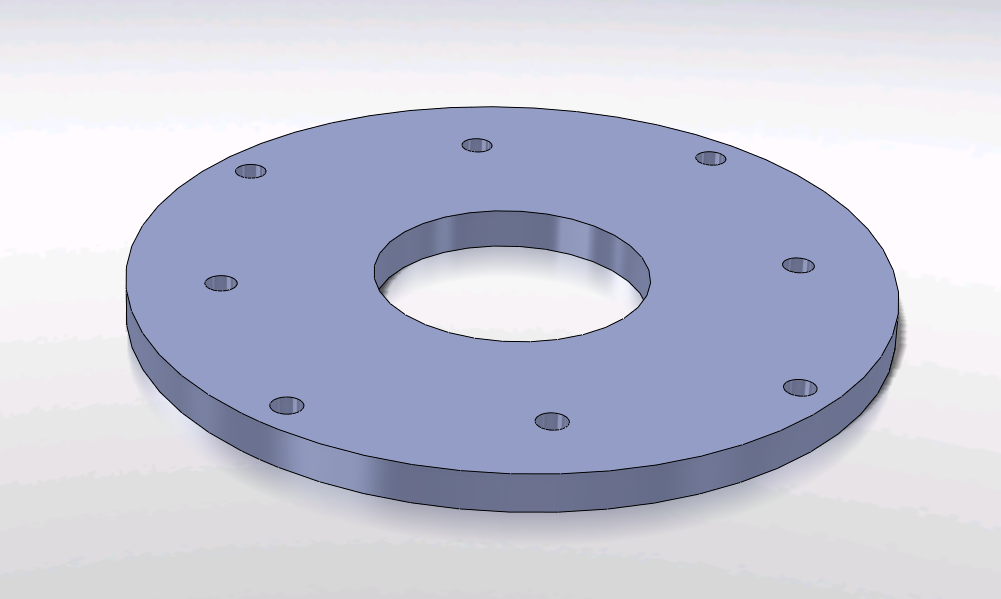

Progress is slow, but managed to make 3d model of RS28F to WG-300 waveguide adapter plate. Now need to print 2 copies. Also glued second flat pack cabinet together.

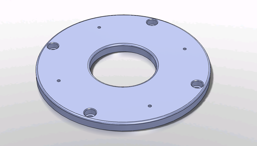

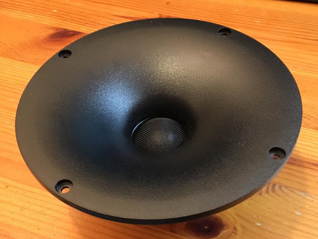

Some minor mods to allow adapter to fit better. Turns out the RS28F will have to be attached to the adapter last using wood screws so I needed to make holes smaller in print job. Added some rounded edges and chamfers and conterbore for flush mounting of M4 cap screws to WG. Good thing it was an easy print job and the power of a 3d real model to check fit.
Here is the new model:

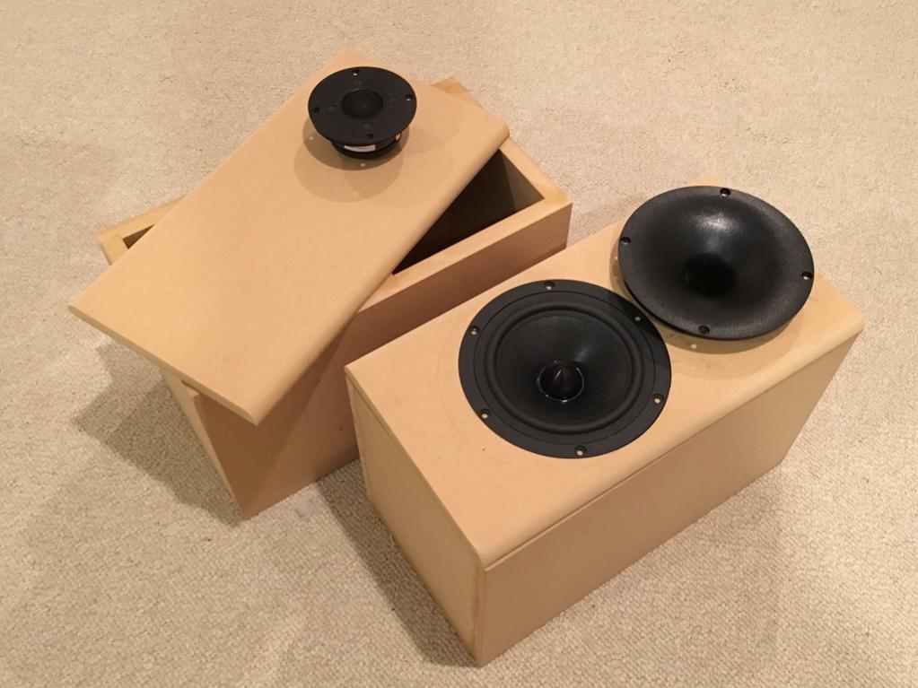

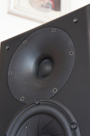

Here is progress on boxes - both glued up now. You can see how the WG sort of looks placed where the mid used to go:

A perfect fit

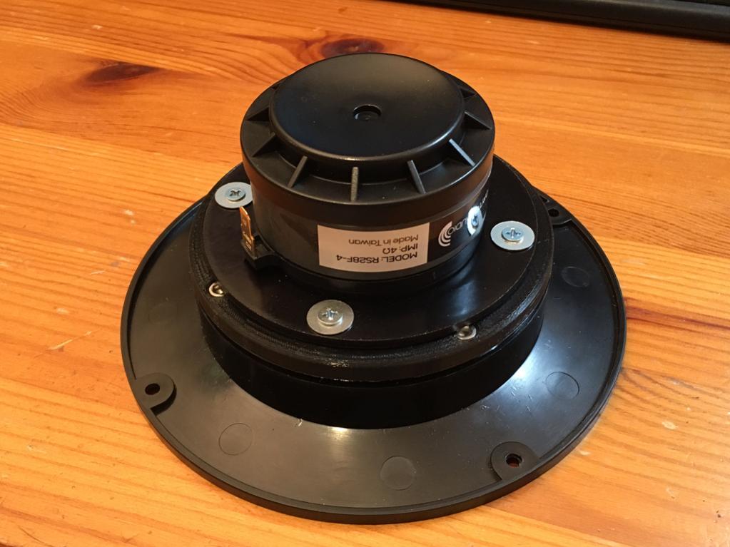

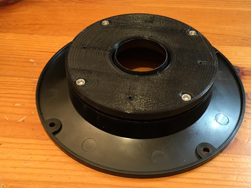

The 3d printed WG adapter worked out perfectly! Took 90min ea to print. I used an 8-32 tap to re-tap the M4 brass threaded insert on the WG-300. As I have lots of 8-32 socket cap screws on hand. The screws hold the adapter perfectly in place on the WG, and then wood screws with washers clamp the RS28F faceplate down onto the adapter using the supplied RS28F foam gasket for a tight seal and to dampen any vibrations. It all fits together in a neat way.
Adapter screwed onto WG-300 with 8-32 hex head cap screws:
573068d1475732224-rs28f-rs180p-b80-hole-filler-3-way-rs28f-wg300-adapter-assembled-1.jpg
RS28F mounted onto adapter with wood screws:
573069d1475732224-rs28f-rs180p-b80-hole-filler-3-way-rs28f-wg300-adapter-assembled-2.jpg
Finished waveguide and RS28F:
573070d1475732224-rs28f-rs180p-b80-hole-filler-3-way-rs28f-wg300-adapter-assembled-3.jpg
I hope this setup measured well...
