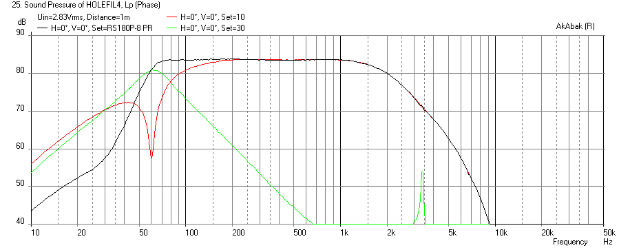

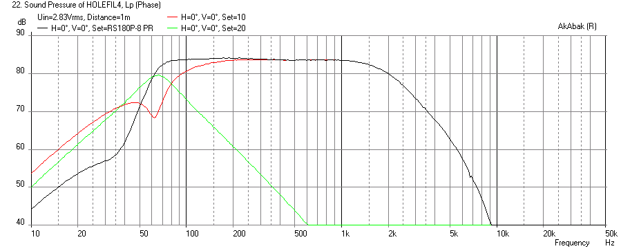

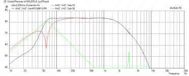

I could use a low cost woofer like a DC200-8 as a passive radiator (just because I have it already). Here is how it models - it avoids having a resonance peak out high from the vented option:
Here is the vented option, both should be able to get an F3 of about 60Hz:

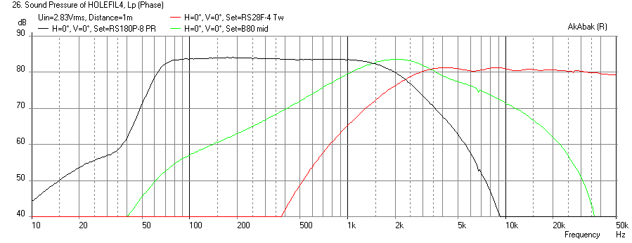

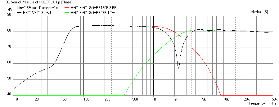

Here is all three drivers firing:
Here is the "hole" without the B80 mid:
Here is the "hole" filled in with the B80:

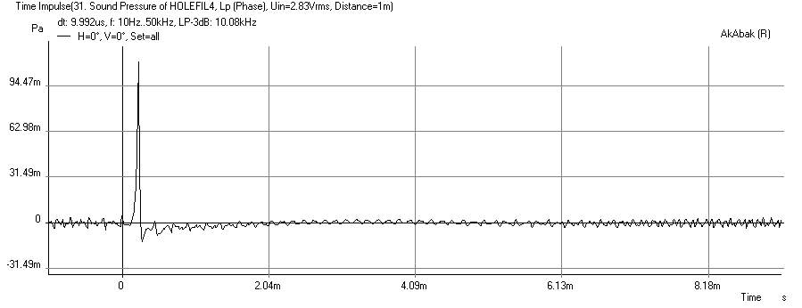

Here is the time-aligned IR with a passive radiator (it's rare to see a 3-way reflex speaker with an impulse response that is this tight and clean):

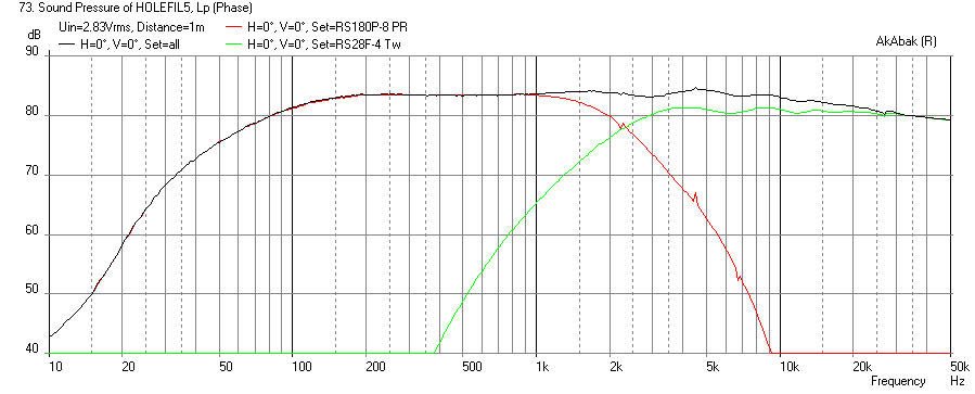

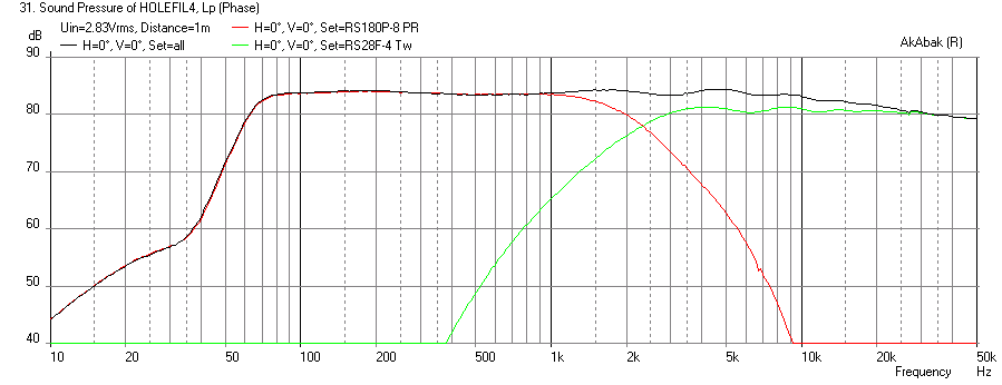

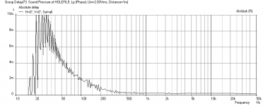

Using two of the SD175-PR passive radiators, I am able to extend the bass extension more gradually with a shallow fall-off so that the group delay is only 6ms at 50Hz. This should should a lot better for transients. Ultimate bass impact may not be as hard but overall balance should be better.
Here is frequency response with hole filler mid turned on and dual PR's active:

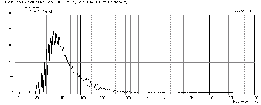

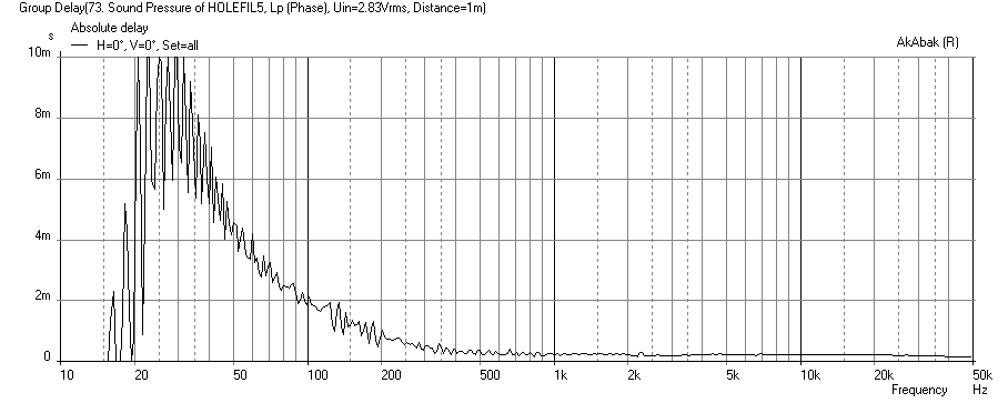

Here is group delay of the dual PR with 10grams added mass :

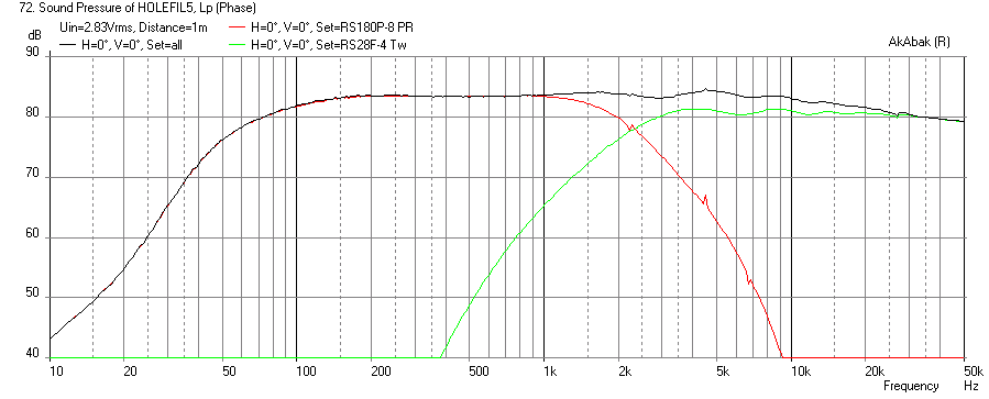

With 50 grams added mass, the FR looks like this:
And the GD at 50Hz is about 4ms now:

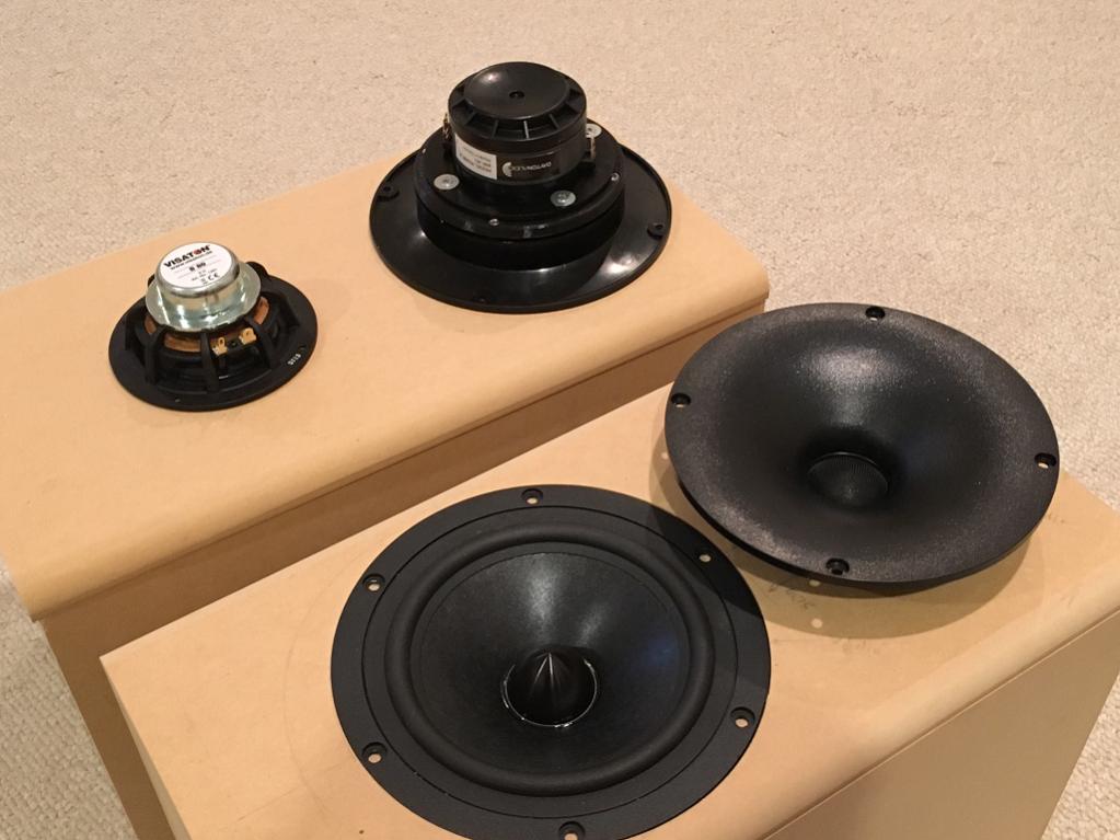

Both waveguide assemblies now completed and ready for mounting. I ended up using a ring of putty to make the interface between the WG and the 3d adapter plate air-tight. The interface between the tweeter faceplate and the adapter are sealed with the tweeter's pre-cut foam rubber gasket. This is needed to prevent blow by from the woofer going through the waveguide output and modulating the tweeter dome.
Despite the fact that the B80 mid will be on a separate mini baffle on top with room for time alignment via translation back and forth, I think I will need to give it a small waveguide as well - sort of like a round-over waveguide just to boost the output a bit. According to the simulations, a 3-way hole filler with one frequency for all filters (HP for woofer, LP for tweeter and LP and HP for mid) will cause a substantial attenuation to the mid amplitude due to the shallow 1st order slopes applied to the mid. In fact we know what this is by definition a 1st order filter is defined by the -3dB point at the filter frequency. In this case, a band pass with both centered on the XO frequency will cause a -6dB peak attenuation on the mid. One way around this is to space the XO so that it is defined by a lower and higher frequency window rather than a singular point.

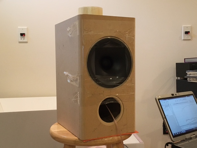

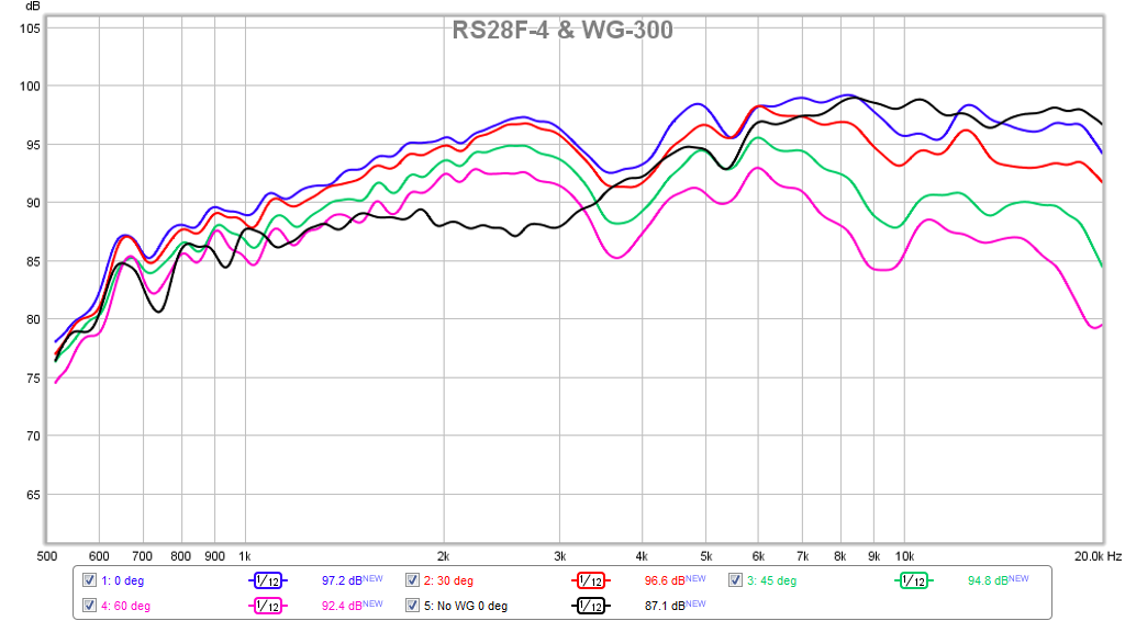

As a quick test, I taped the RS28F and WG-300 assembly into the cutout for the RS180P just so I could take some initial measurements. I used a 10uF 250v MKT film cap in series to block DC and using the Ranchu/Aksa quasi MOSFET amp with CS4398 DAC.
Here is the rough polar (+/-5 deg by eye) showing the performance of the WG and relative to the same RS28F mounted flush in same cabinet in the B80 cutout. Measurements at 0.5m.
There is a curious 5dB dip at 3.7kHz in the waveguide. That corresponds either a 0.9in 1/4-wave or 1.8in 1/2-wave reflection cancellation somewhere. It might be the small discontinuity between the WG throat and the tweeter bezel. The no WG curve at 0 deg does not have that dip but then shows a rising response. I will have to sort out that little dip.

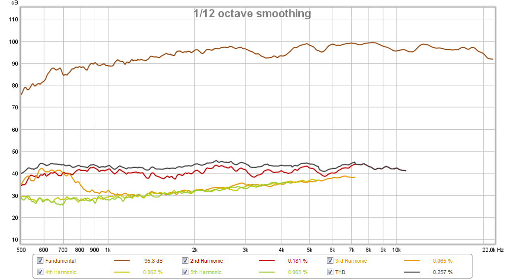

Here is the distortion, it's very low for this tweeter:

Does anyone have an idea where the 3.7kHz dip is coming from? Or is this normal and to be expected from a waveguide line this?
