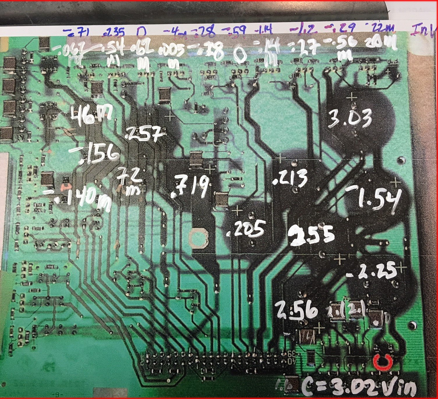

So I'll connect Lab PS at the bride rectifier, I'll hook probe minus to the
neg bridge and then probe along the traces back to the vReg.
I think I got it. If that doesn't do so well, I can probe minus on the
vReg and probe back to the bridge too.
I'm getting there. I have the three bridges with wire extensions.
Did a dry run on it and I'm going to print off three of the pics i made
and write the data on them.

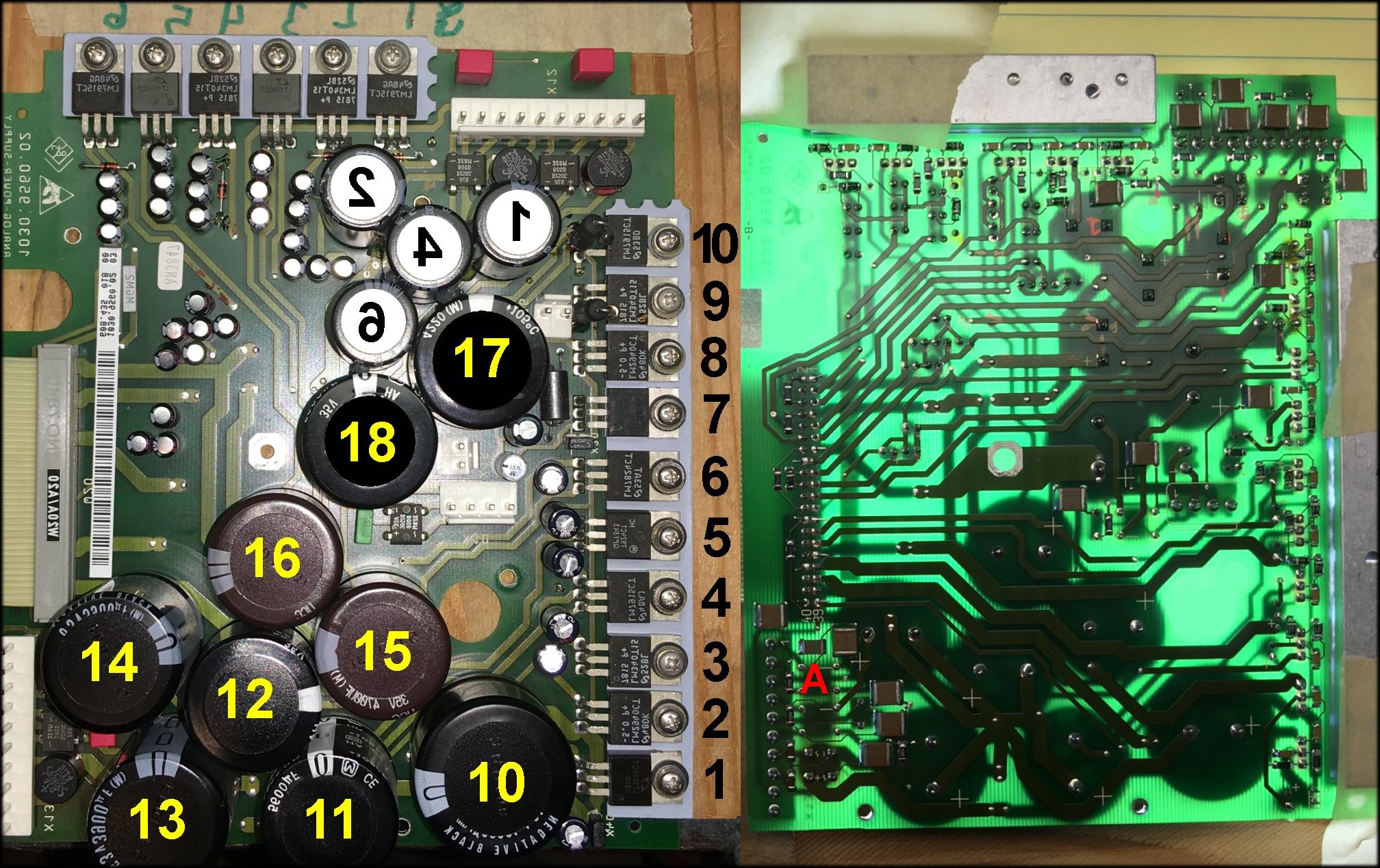

The referenced pic is in post#78, with left board mirror imaged.
Otherwise I'll get lost in all my scribble especially if it on one page.
It kind of tricky because the Bridges feed something farther away then
I would expect. These are the 7 large caps numbers 10 thru 16.
I'll post data when completed, one at a time.

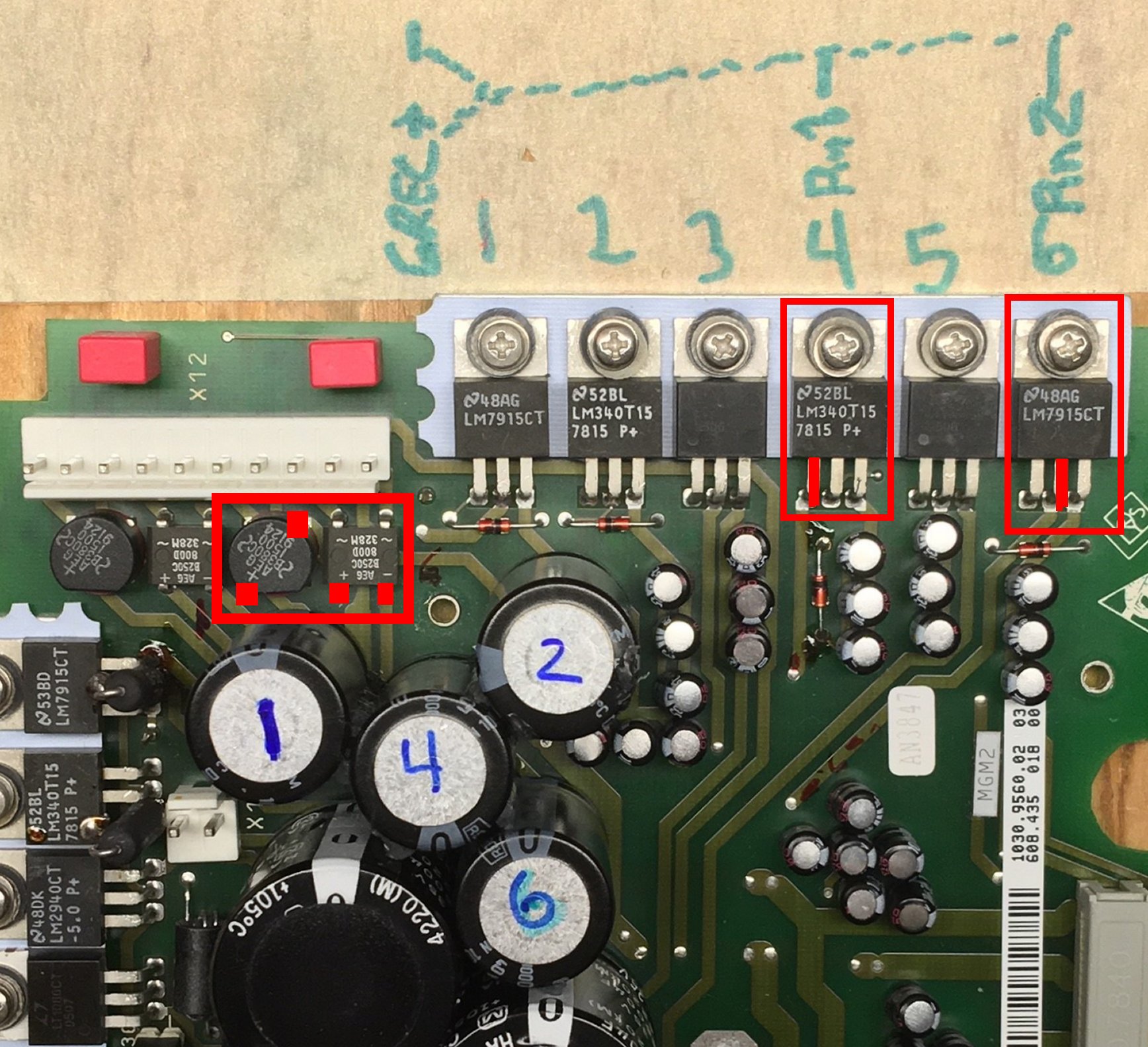

The first pics shows the boards.

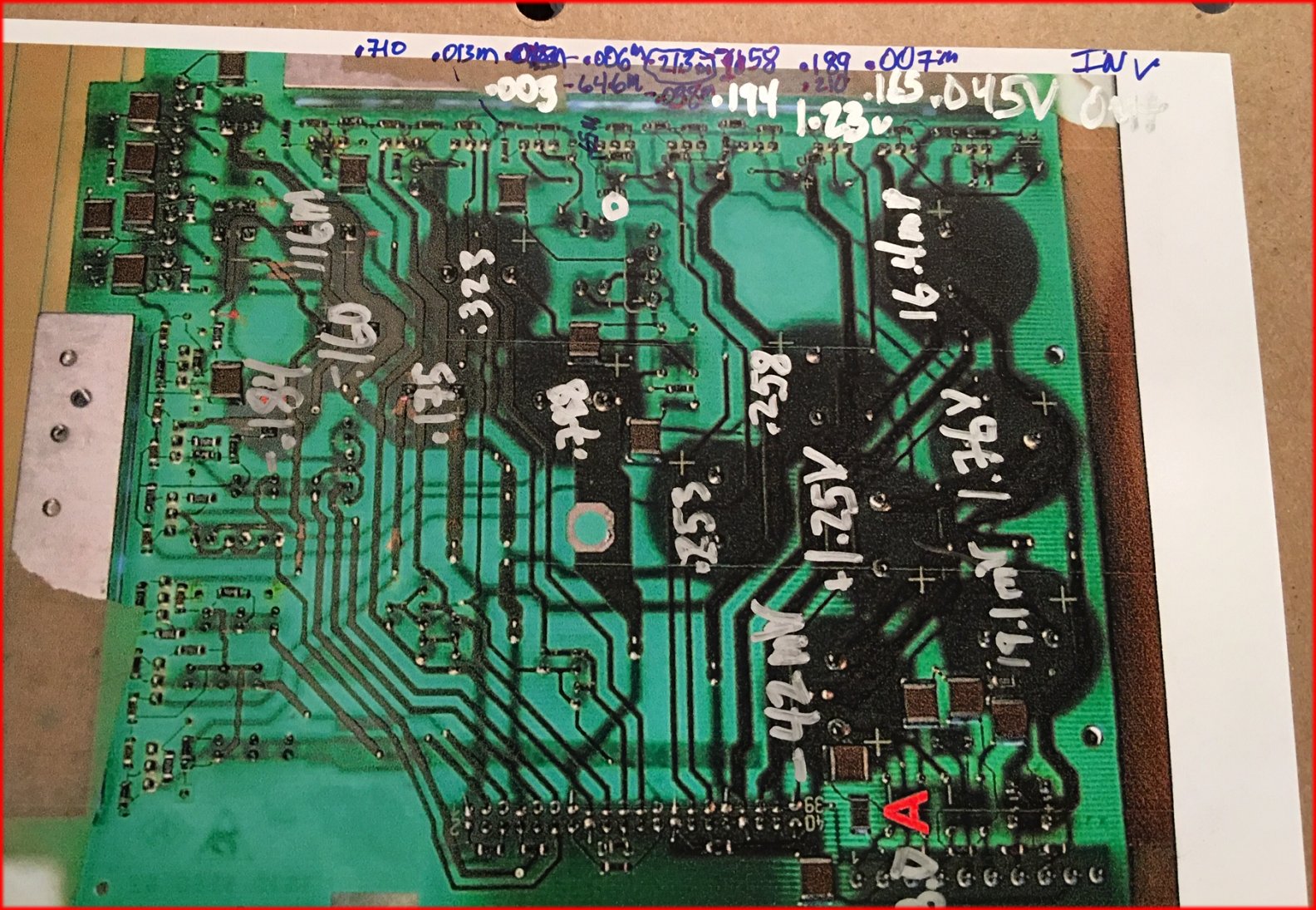

In this case the second pic will show A bridge 3.0V through the power supply.

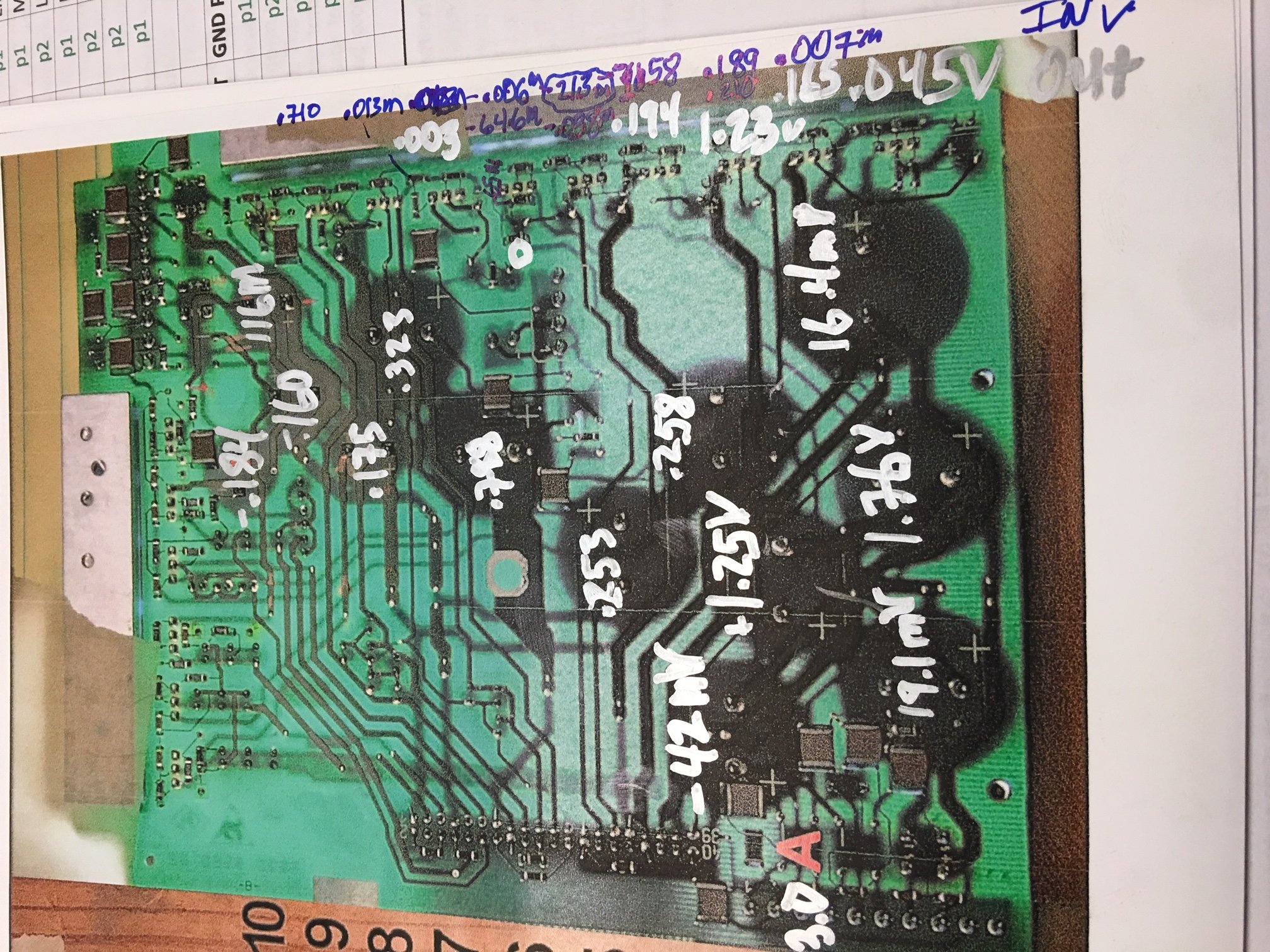

Here is the Abridge Test.
We have a kid crisis that I have to take care of.
All are voltages, except those with m or mV
depending on space. 2nd is harder to read than I thought.
That same diode is fried. Unsure of cap.

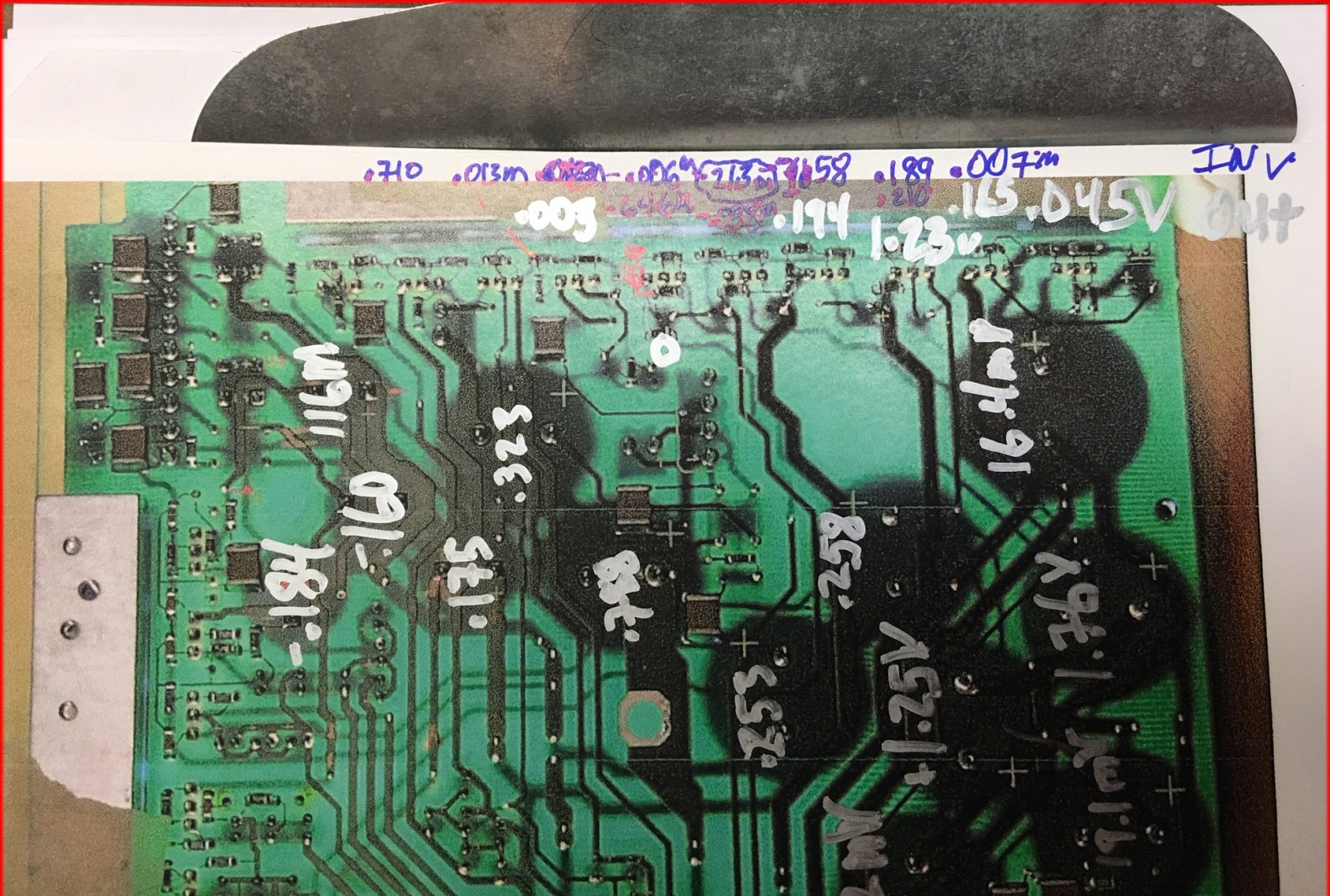

In summary O in the upper middles is the only diode that
always tests as shorted.
Two electrolytics have been replaced, they are in the lower right
where the Bridge A had 3V on it; those caps meaured - 42 mv
the other 19.1 mV.
Bridge A feeds the next to caps, 1.25 v plus 1.76 v equals 3.01v
the full voltage of the 3.0v Bridge. Note there is no amperage reading
from the lab supply, it's dialed up from zero but since this thing is loaded
there is much going on. I guess it's at its equalibrium for lack of the better
term.
I assume those two caps smooth out the voltage to the vRegs on the top row.
inV in blue, and outV in silver. And about 1/2 way through checking vregs
I realized pin one is on the right and pin three is on the left.
This board gets funny in the middle, trying to get measurments the 'voltage
is bouncing around a lot. Maybe oscillation in the few mV level or I'm just
reading the probes and not the devices.

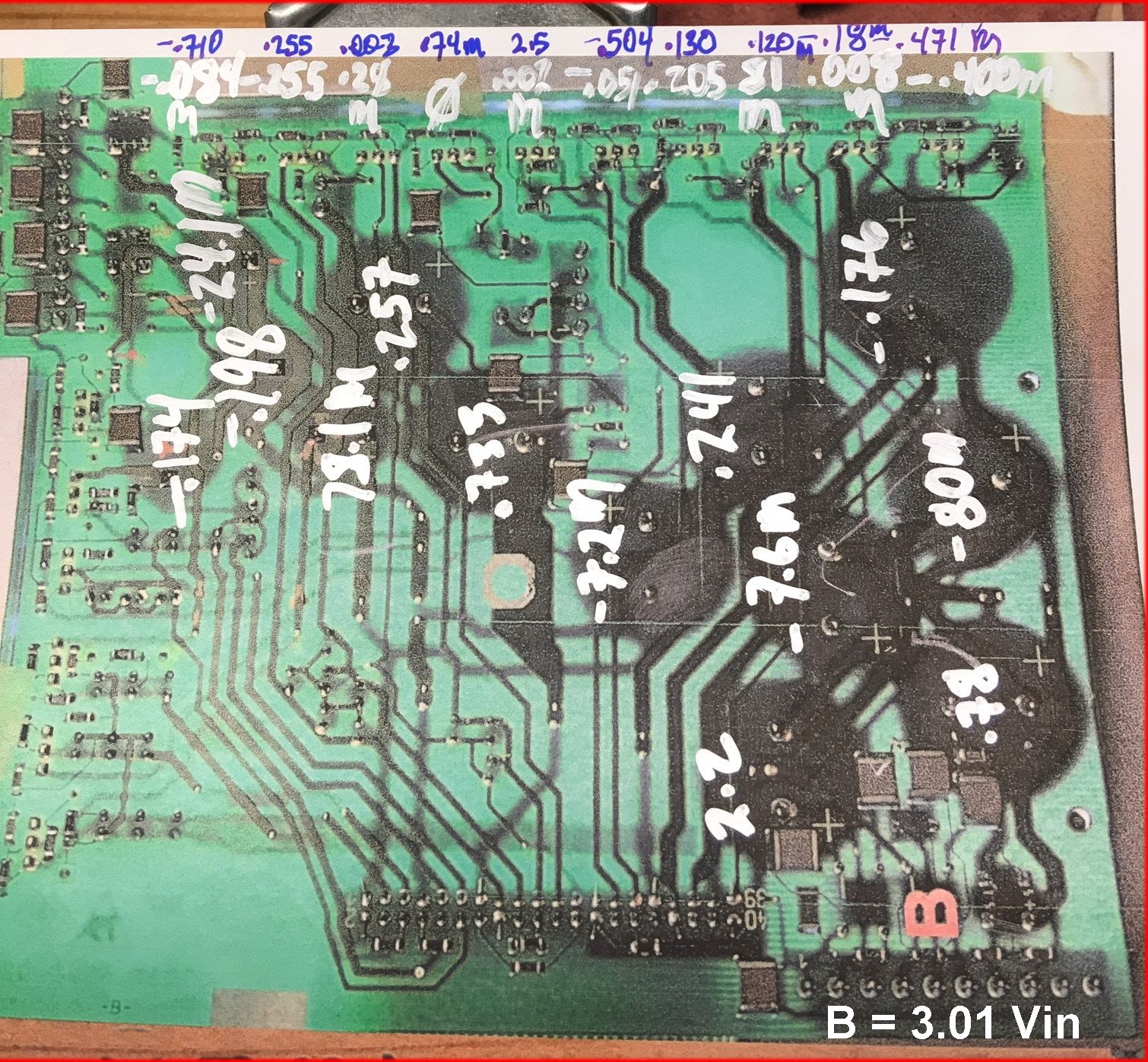

Bridge B and bridge C should be illuminating. I think Bridge B feeds the two caps
that are replaced. '

Here is the next image, Bridge B.
Not much different other than voltage
feeding the first two large caps that
the A bridge didn't feed.
Next up is the Bridge C.
Let's see where that takes us.

Here are the measurements from Bridge C, 3.02 Vin.
We have voltages on most of the 'lytics.
Voltage on the 5 chip caps by the Bridge C.
Next up are the four Bridge Rectifiers in the upper
left corner. Starting from the heat sink will be
designated D, E, F, G.
Note the lower two large electrolytics, that were replaced
The are series connected and show -2.25Vdc and 2.56 Vdc
these now appear to be functioning normally.
This is now one section that was repaired.
That is all for now.

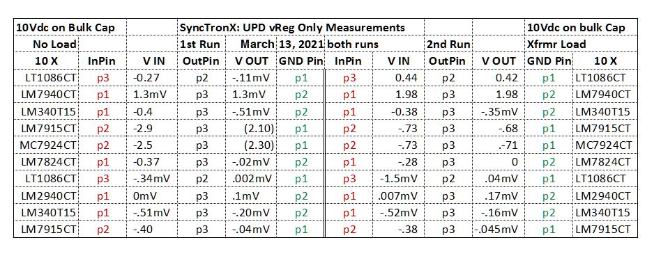

Not much has changed, along the way I've upped the voltage to 10Vdc on the large
bulk cap.
1st run no load
2nd run Xfrmr load
Now in easy to read format.
I'll have to rig it up so that the transformer center connector
are connected to the board for another measurement run.
Thinking I can go higher in voltage, as there is no current going
through the board or very little. 15Vdc, 20Vdc, higher?

Elevating voltage should be OK as long as you don't exceed cap's or IC's max voltage rating.
18VDC should be enough to make a 7815 regulator deliver.
Curious that with 10V, applied you're not seeing voltage at Vin pin of associated regulator???
That bulk cap goes somewhere, maybe to the motherboard
flat 40 connector at the bottom or side of the power supply board
and connects to some other caps also.
It's the 16V 15,000uF cap that I'm powering to.

I observe that there are 13 "bulk" caps but 16 three terminal regulators, so some of the regulators must share caps. When transformer powered, do all caps show DC voltages measured across their soldered terminals? Are there any that do not and why? Some DVM/continuity probing would resolve some of these quandaries.
Since so many regulators don't seem show regulator output, and because there's such a multitude of connections at the ribbon connector, I speculate that regulator ground sensing is established at the destination modules--- sort of remote sensing, at least for the regulator ground terminals. If this is the case, some regulators may not behave until the ribbon cable is connected to destination cards.

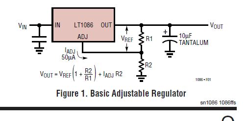

Found a recurring error in the10X line up. The cap after LT1086
is the LM2940, not LM7940!
And as Steve mentioned there are plenty of 1N4002 diodes providing
protection, even in the data sheets.
I just wish the data sheets had the various resistor values for setting the output voltage. Yes, it's shown following. And not needed but from out to in
the 1n4002 diode goes over the top cathode band to in.
Standard values are out there somewhere.
I'll google in a minute.
I did and with the LT1086 it develops a 1.25V reference voltage
between the output and the adjust terminal. I can check on the math.
If I recall there is a 10mA required basic current to keep the vReg
stable. Then there is the Iadj at 50uA
121Ohm
---------- = 5V
365 Ohm
124Ohm
---------- = 12V
1070 Ohm
Now I can have a look and see what the LT1086s are set up to deliver.
