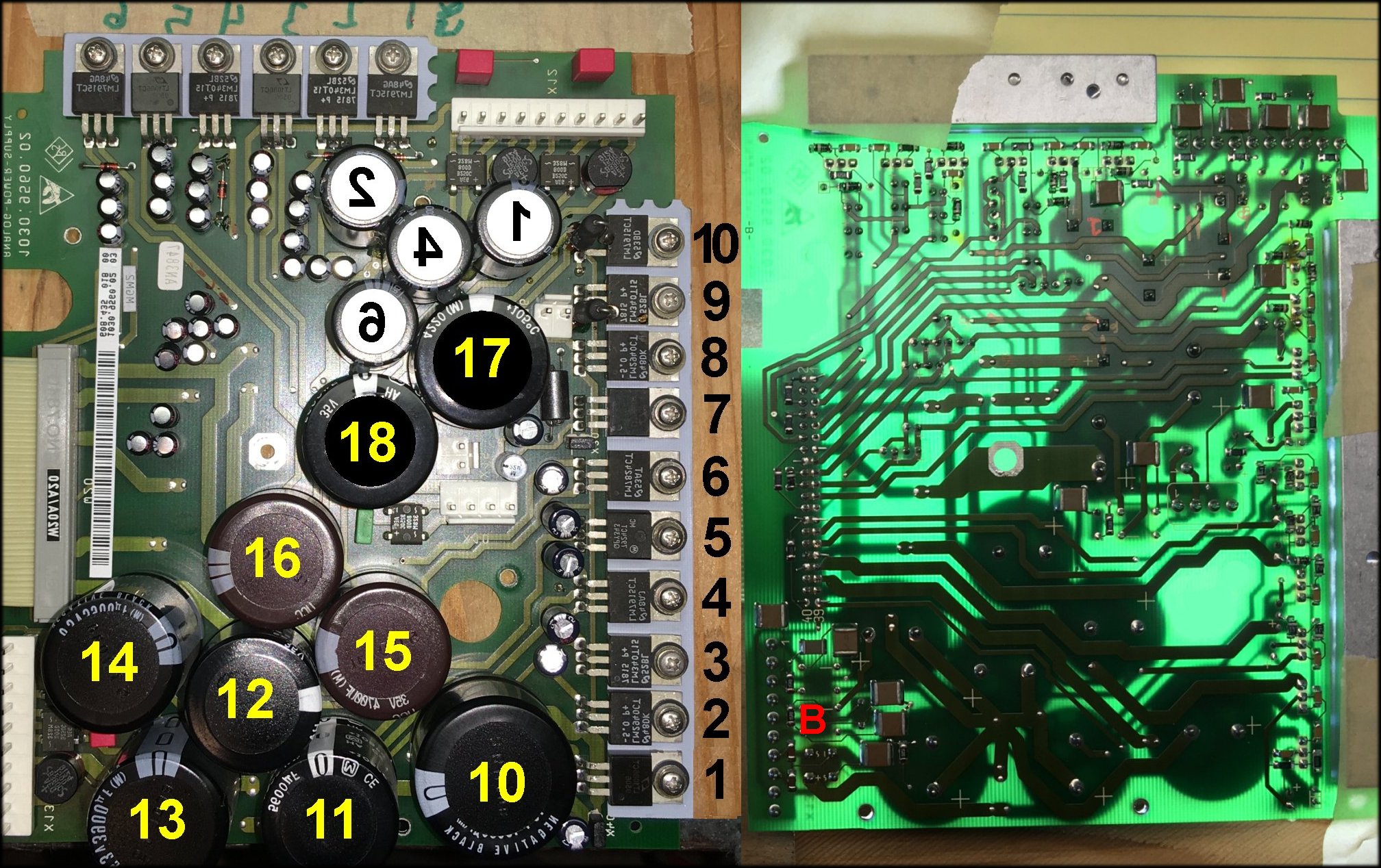

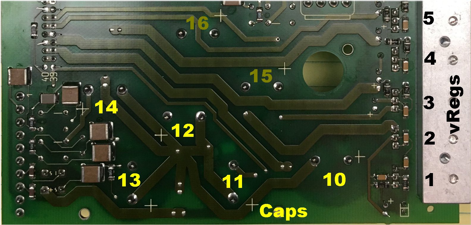

UPD Focus:
This is strange to me.
This chart shows which vReg In pin
has continuity with one of the bulk caps.
Not all do and some are kind of funny.
They connect to most of the bulk caps
then nothing. I'm guessing some of the caps
charge? Or the smaller SMD caps charge up
and stop the continuity test voltage.
Yes, every bulk capacitor had voltage across
their pins when powered up through the transformers.

I presume that you have located the ground points for every analogue and digital circuit - and measured R between voltage rail and GND? This is an old machine and there is every chance that a decoupling cap (or other item) has lower R than it ought to. Very important! Forgive me if I already suggested this!
thermionic, No, I haven't located the ground points for every analogue and digital circuit.
and have not measured R between voltage rail and GND. I cannot do it with any accuracy
at the moment as I don't know where the rails are, I don't have a schematic either.
While there might be clues...I'm doing what I can at the moment.
I'm getting closer though and starting to envision the analog power supply as
many different power supplies configured in a multitude of different ways,
using two transformers, parts are series connected with eight bridge rectifiers
supplying 16 local voltage regulators. And they are a cluster f o f capacitors
all series-ed paralleled with all kinds of SMD caps, resistors and diodes in and
around the vRegs.

Now, I'm not sure how I'd measure low r from cap to the rail or cap to the ground.
I drew out some of the common configurations of the vRegs and what the data
sheets describe as how to beef them up for lack of a better term.
With diode from output to input, along with additional capacitance wired in
from ground/adj to output, some have resistors also.
That is about what I'm thinking for now.
I'll see if i can find one of these and draw it out a bot more.
Maybe it's also drawing out the bulk caps even if i don't know
which or what they are filtering and how all the other caps fit in.
It's unsettling to see the nine bulk caps all connected together
in seeming mish mash of connections. But slowly the circuit
is starting to unveil itself the more I go through it.

On one of our UPVs, there is a short between -15v and 0V on the analogue board. This has taken out the PSU rail, and I haven't had a chance to work out yet if it's just the VReg that's got the issue (most monolithic VRegs have short protection), or - more worryingly - if it's damaged a Trafo secondary...
I will either have to borrow a thermal camera or spray suspect items with freezer spray, whilst gently powering the board from a lab PSU, in order to locate the failed component.
The greater worry is whether the transformer is damaged...
So, the point I am making to you is: don't get caught in the same trap. If you rebuild the PSU and it's tickety-boo, you don't want to induce a failure due to a shorted cap somewhere. There is no guarantee that a fuse will go, or Vreg short protection will trigger - there is always a risk of damage.
You can easily work out where +V and -V points are by looking up opamp pin-outs. You may find that some hover on 'virtual rails', decoupled from other circuits, so look for commonality and patterns before making a judgement.

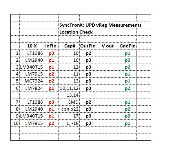

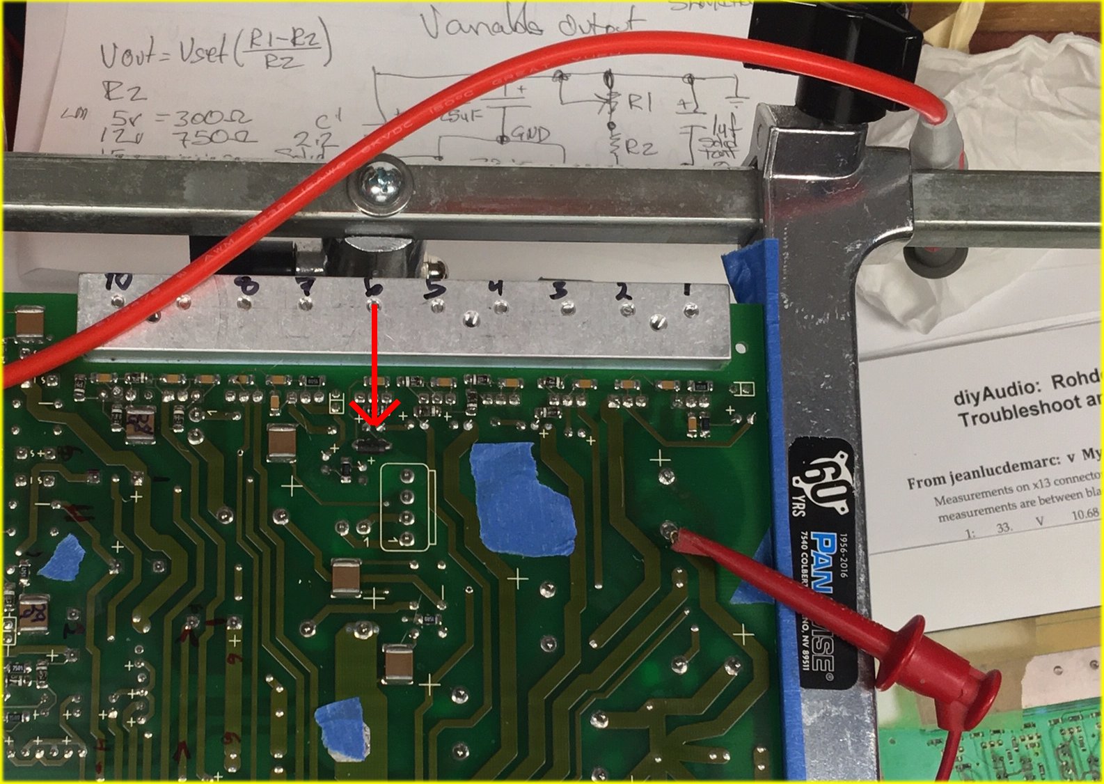

In an earlier post you asked about powering regulators with bench supply from between reg's ground to Vin terminal. I think this has relatively low risk if you use a current limited supply ( about 20 mA) and have ribbon cable disconnected. Raise supply voltage slowly and watch for the unexpected. You should see Reg output rise with increasing applied voltage until it reaches its expected output.
In the case of the "adjustable" regulators, use the normally grounded end of the feedback resistor divider as the connection to the bench supply. Eg.the ground end of R2 of the thumbnail in post 100.
That might be the plan Steve.
I'll take a shot at it and see where it leads.
This is in line with lab supply to vRegs vIn and jump the vRegs ground to the
bulk cap ground terminal watch and check the output.
Configure for pos or neg vReg output.
I'll provide results in a bit.
I have some measurements.
vRegs 1, 2, 3 track the input voltage nicely.
vReg1: 3Vin 3Vout thru 17Vin 17Vout
vReg2: 5Vin 4.5Vout thru 25Vin 25Vout
v Reg3: 5Vin 4.3Vout thru 17Vin 16.2Vout
Unsure about the connections on the Neg vReg.
vReg4 the Neg reg,
p1- gnd Supply Pos Volt red [Meter 2.5V]
p2- in Supply Neg Volt black [Supply 3V] Meter Neg (black)
p3-out Meter, Pos Red. [Meter 1.1V]
I should switch meter leads then I'd get the negative voltage from them.
It didn't seem correct for some reason.

Steve, I chose not to try to solder a 2mm wire on the ground end of the resistor R2.
If you look at pic following, next to the vReg 1, that would be the SMD resistor paralled
to the SMD Cap sticking out toward the cap number 10. I think it would do more harm
then good. So for these tests I just hooked it up to cap 10s negative terminal. In the
lower right corner of the pic.

The W20 flat cable is soldered to the analog power supply board.
This is shown partially in the pic in post #111, the upper left
corner. Let me find the full pic and post it here so we don't
have to run around and look for it.
I've selected the mirrored version, the left side is the mirror
of the trace side on the right half of the pic.
As shown, the W20 connector is left center in both halves.
We can see both sides of the board.
Recall I've now replaced three components, that 2nd diode at vReg 6,
the diode farthest away from vReg 6 pins.
Then Cap 13 and Cap 14 were replaced. I don't think it will be an issue
reinstalling the original Cap 13 and Cap 14. I can do some additional
measurements when reinstalled and see if anything changes.
