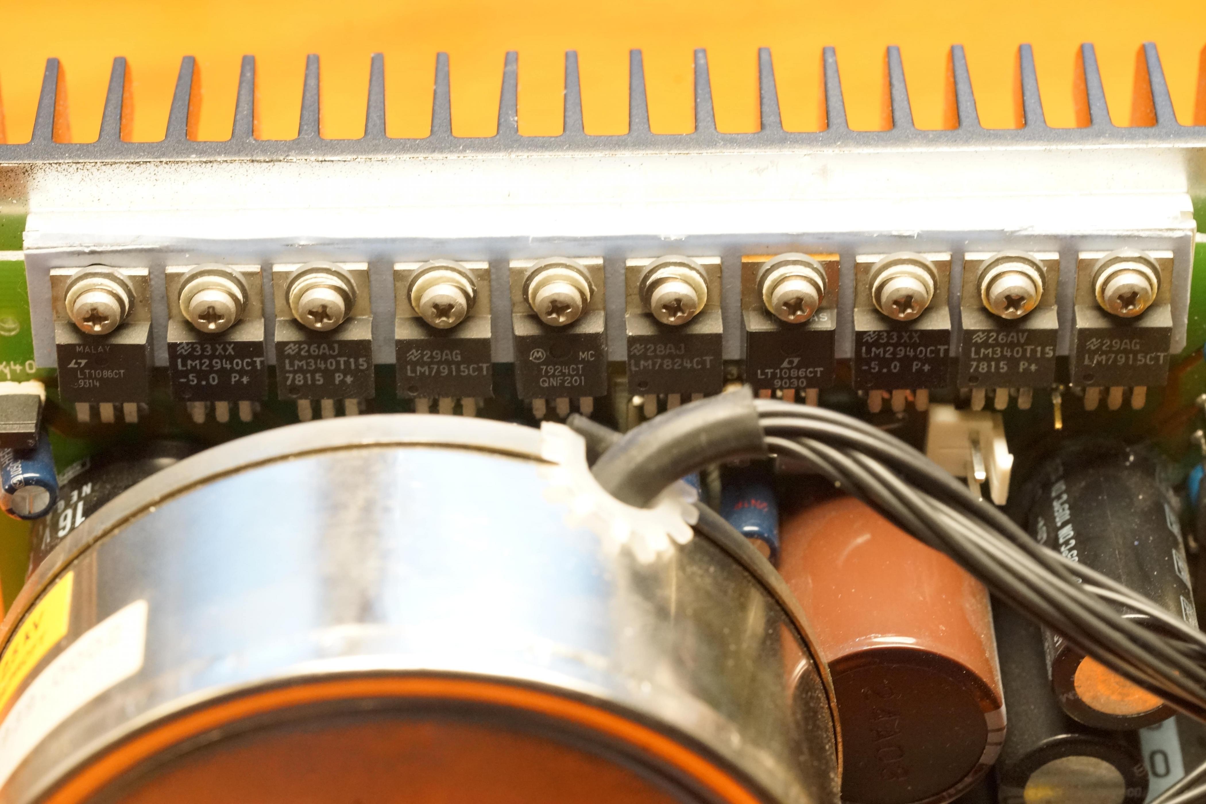

If your UPD is anything like the UPV, you will be able to test the PSUs in isolation. That's your first port of call.
Next, I would locate all power rail test points on each PCB, and measure their resistance to their relevant ground (if anything like a UPV, it will have multiple isolated grounds - so be sure to reference the right one). We have a UPV that has a short to 0V on an analogue rail, and I think we will either have to get a thermal camera, or maybe try freezer spray (after using a marker pen to highlight all parts that connect to 0V that could short).
If a PSU rail is out, then it's likely to have a root cause somewhere, so that'll need tracking down. From what I can see, these things can go wrong like a stack of dominoes - and it'll be rare to have just one fault (although one hopes it is!).

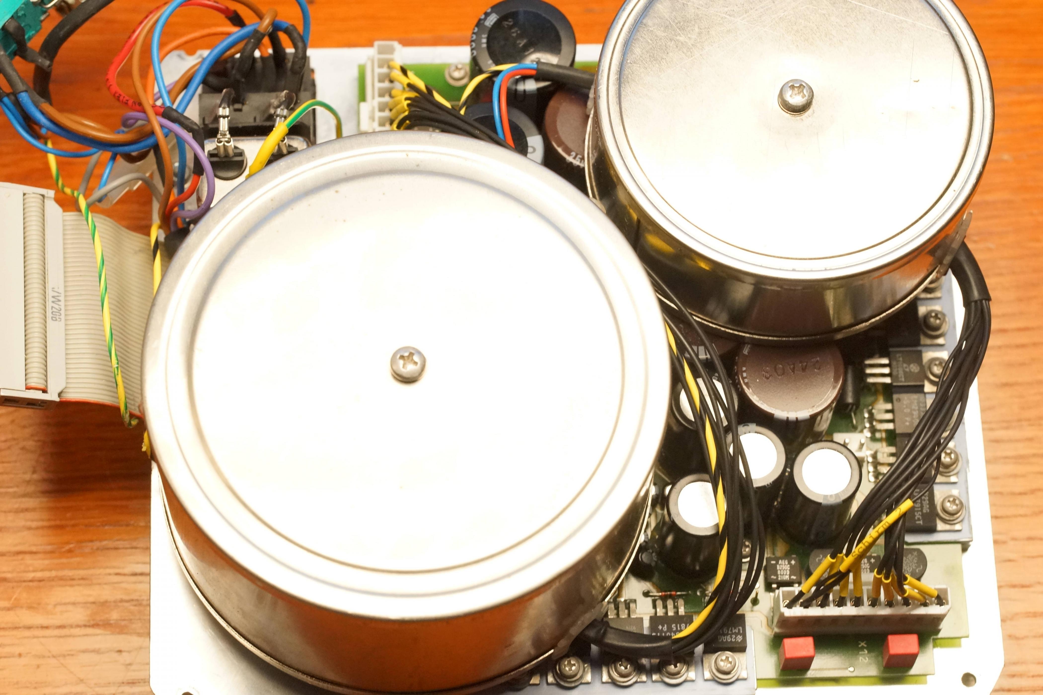

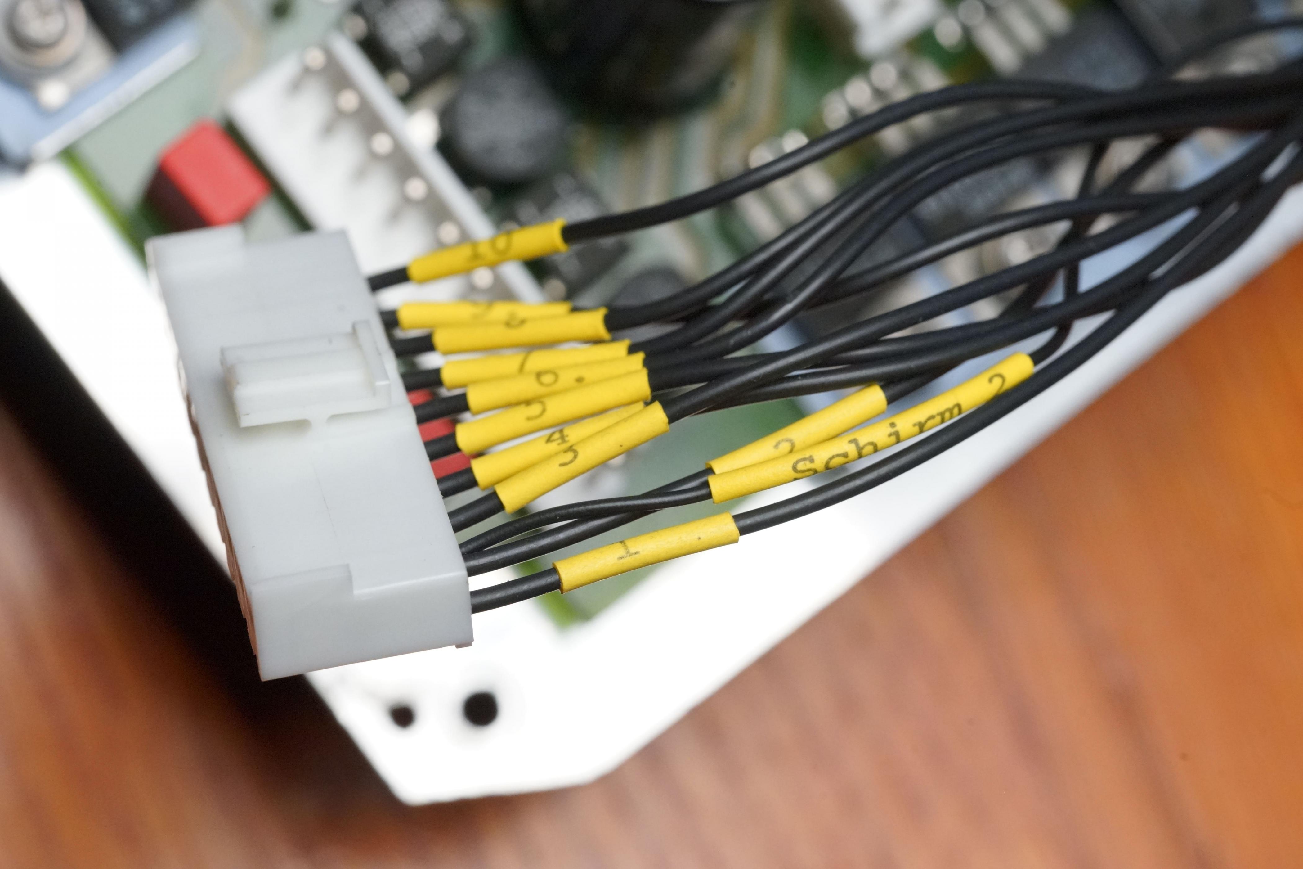

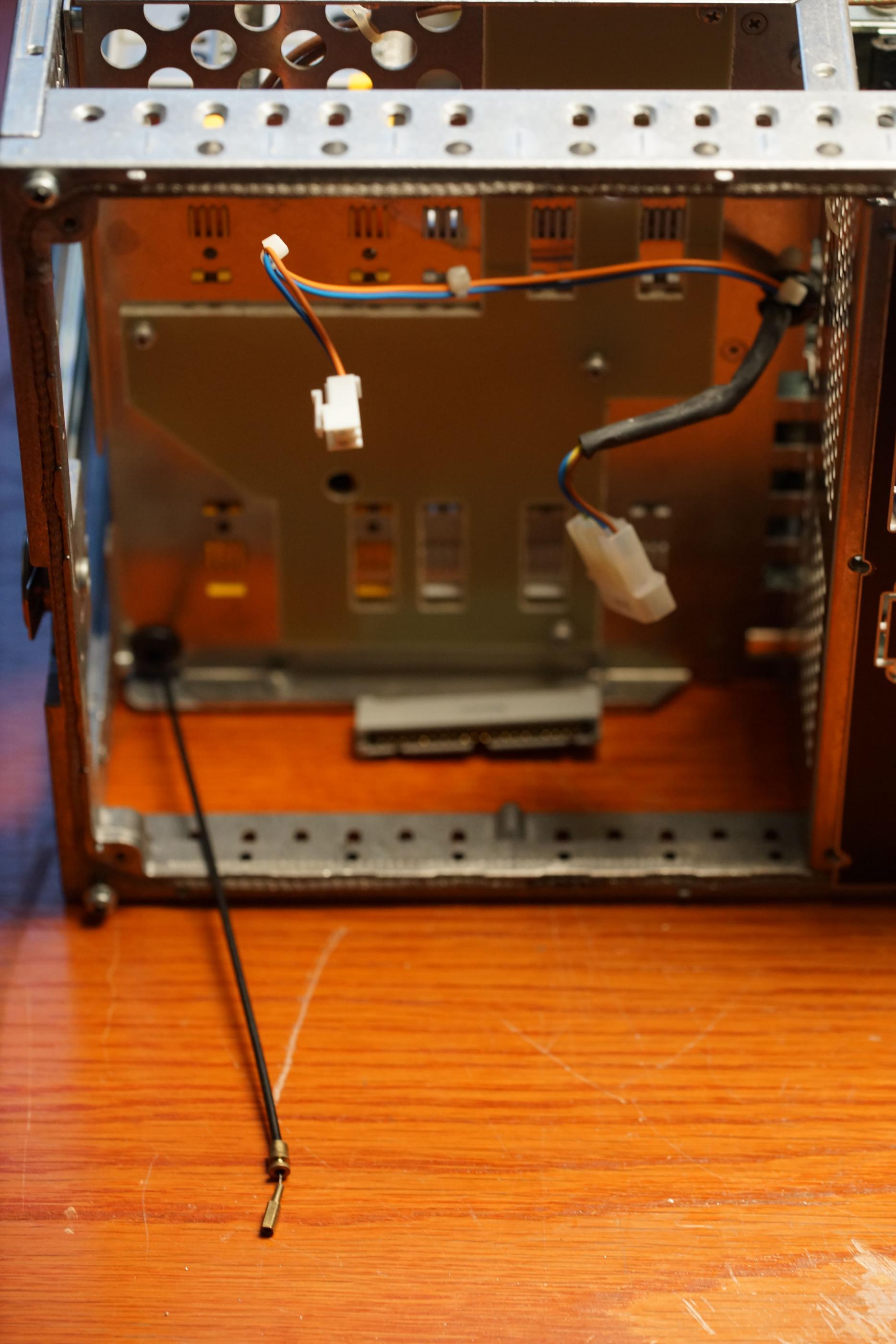

upd linear power supply
Some pictures of Power supply

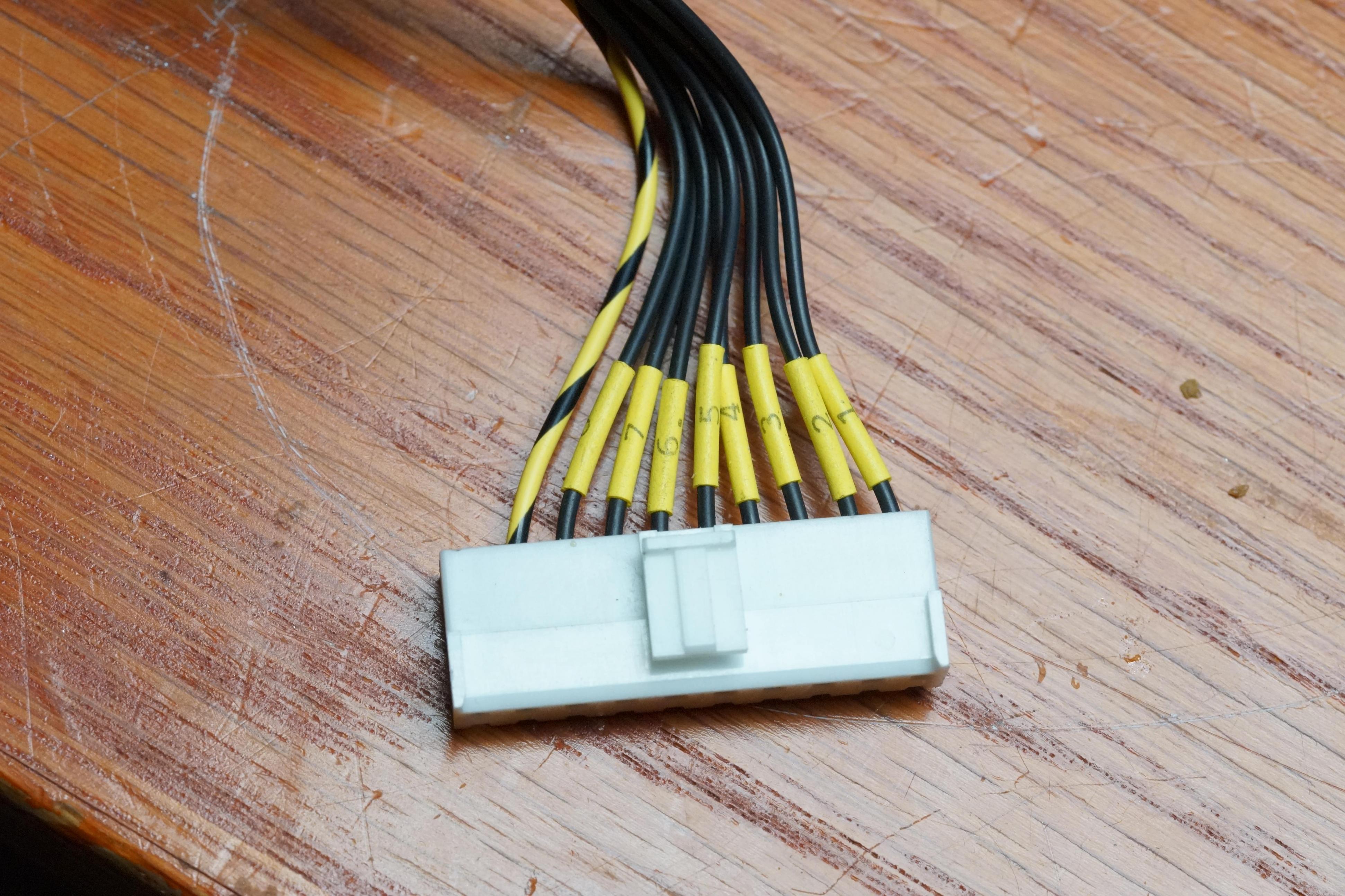

upd-transformator
measurments on x13 connector and input voltage 238.5V
measurments are between black -yellow 1-8 pins
1:33V
2:12.75V
3:7.67V
4:38.1V
5:7.22V
6:23.68V
7:16.43V
8:6.7V
measurments on x12 connector
measured between 1 and rest of pins.
2:26.39V
3:52.64V
4:19.7V
5:30.65V
6:1.3V
7:21.77V
8:42.45V
9:15.92V
10:24.65V
I didn look any schematics just quick measurments.

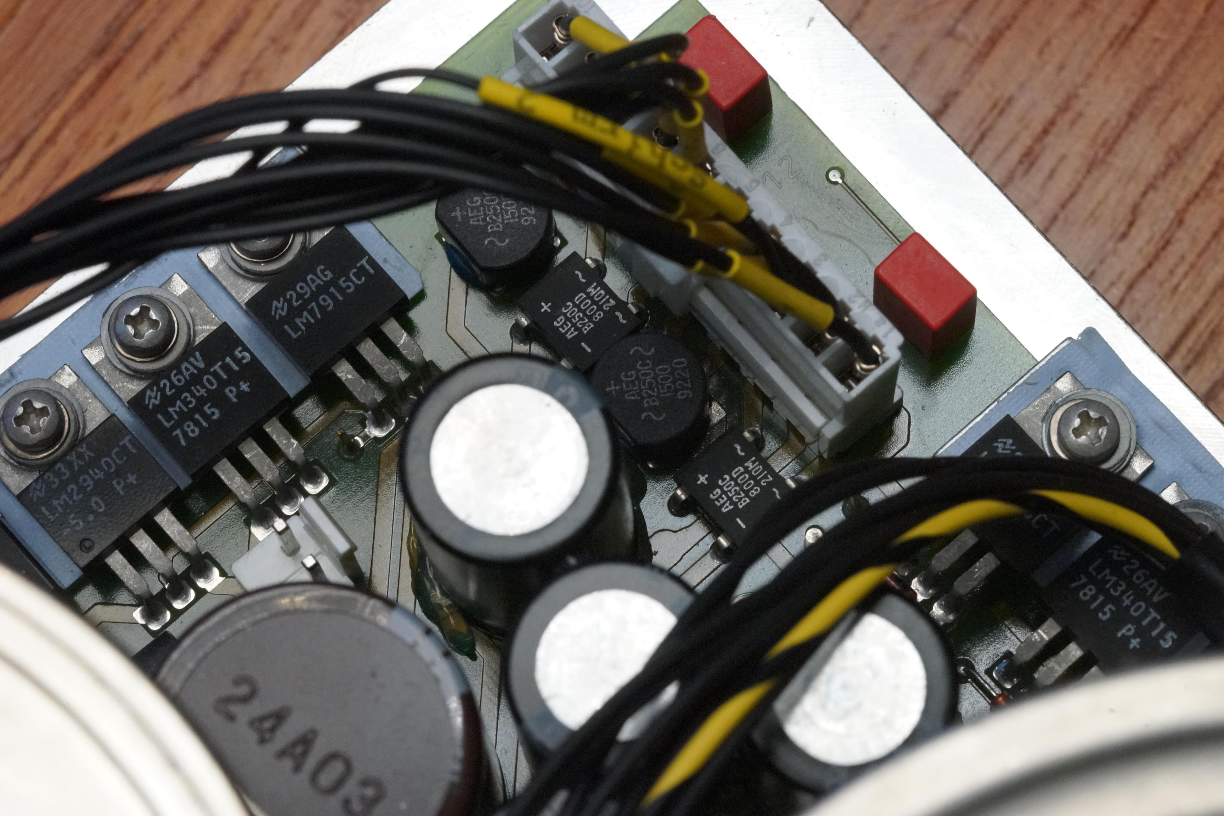

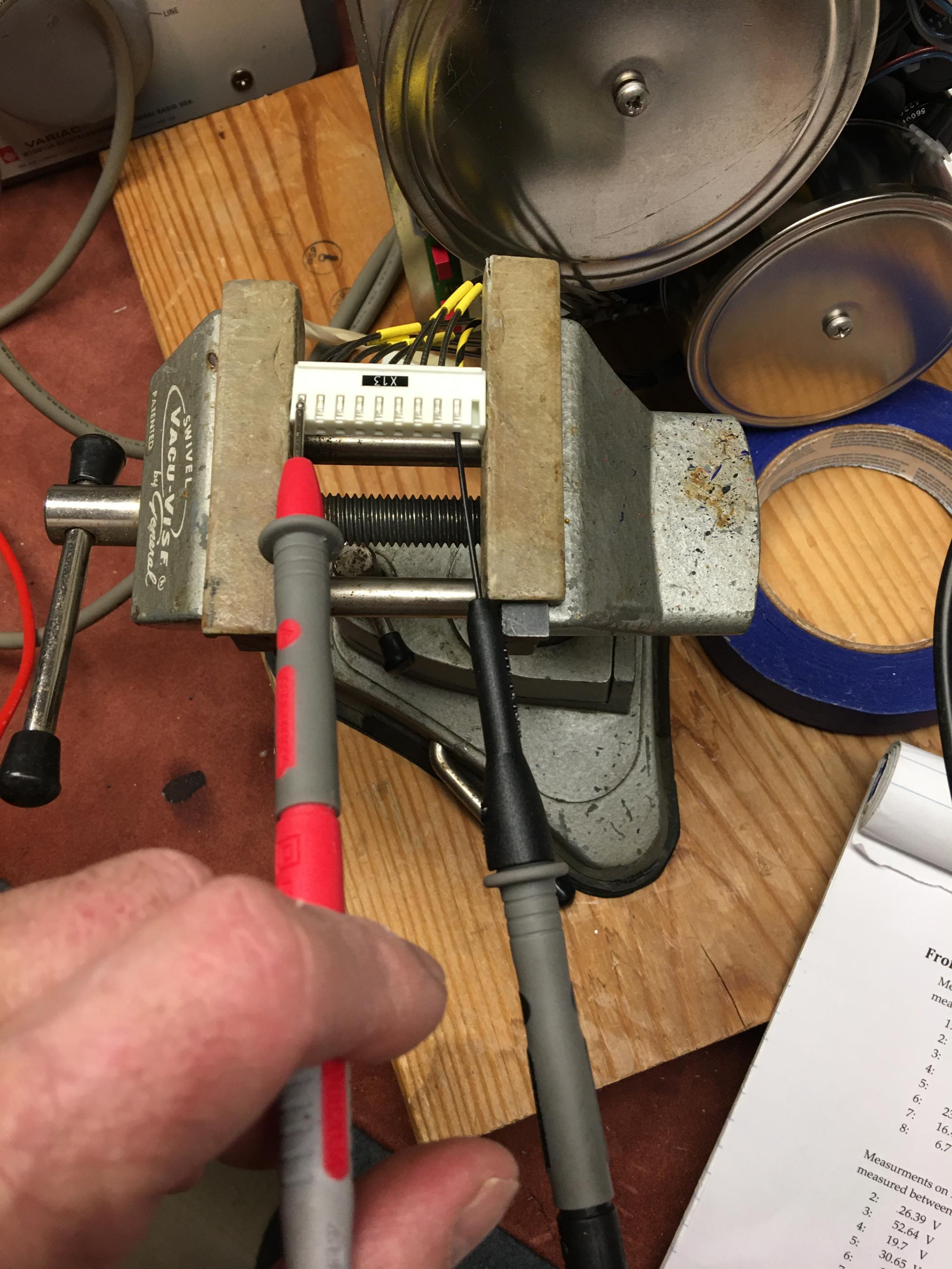

jeanlucdemarc's measurements on left side, on x13 connector and input voltage 238.5V;
SyncTronX measurements right side, with input voltage of 120.0V.
measurements in VAC.
measurements are between black -yellow 1-8 pins
1: 33V 10.68V
2: 12.75V 1.74V
3: 7.67V 7.20V
4: 38.1V 18.56V
5: 7.22V 1.69V
6: 23.68V 15.0V
7: 16.43V 3.0V
8: 6.7V 0.412V
measurements on x12 connector
2: 26.39V 27.10V
3: 52.64V 54.38V
4: 19.7V 11.87V
5: 30.65V 18.39V
6: 1.3V 0.499V
7: 21.77V 5.37V
8: 42.45V 10.28V
9: 15.92V 3.81V
10 :24.65V 5.79V
jeanlucdemarc: "I didn't look any schematics just quick measurements."
Obviously this former working unit has power supply issues.
Are these related to parts baking when the unit didn't "turn on" no fan and no screen?
Are these related to capacitor failure mode of almost every cap in the main power supply?
Are these failures of the correlating power ICs?
Or a combination of the above?

Spent about an hour trying to get the gunk out of the mother board.
On the left is the "measuring jig," on the right my little girl making Freckles into Peter Pan.

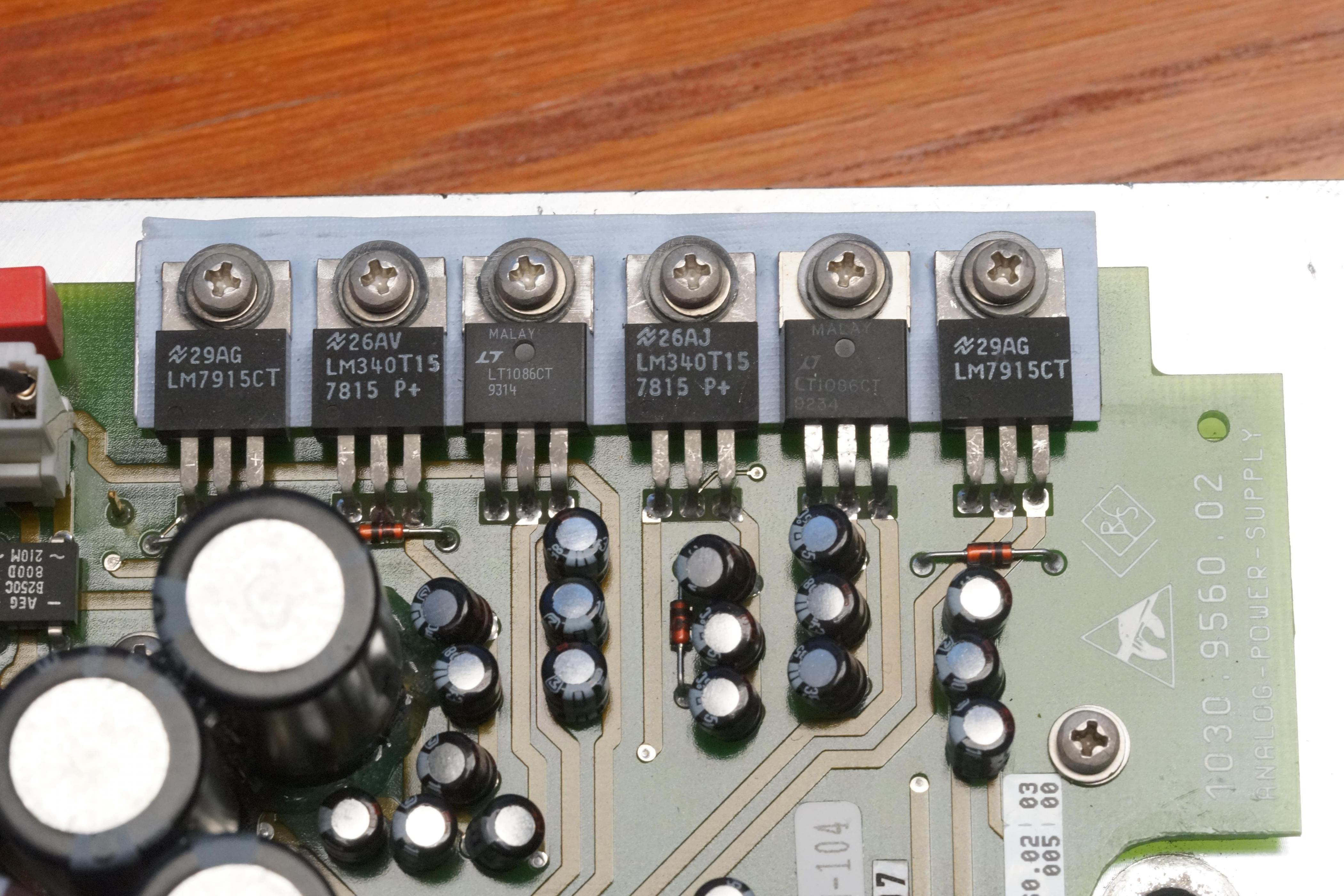

So order of checking the for each power supply IC:
1. Check the power regulator IC
2. Check its diode.
3a. Check the smaller caps, ESR in circuit
3b. Pull them out of circuit and test again
4. if there are failures, then I replace all the
small caps on the power supply board.
QUESTION: Standard electrolytics or the solid polytype lytics?
Will the regulators tolerate the lower esr of those?
5. Leads me to contemplate the larger capacitors on the power supply.
Test them, or just spend 10s or 20s of dollars to buy new even if they are good?
To save time, instead of buying one lot of caps, then another, then another and
so on.
Then I have the individual boards to test and consider.

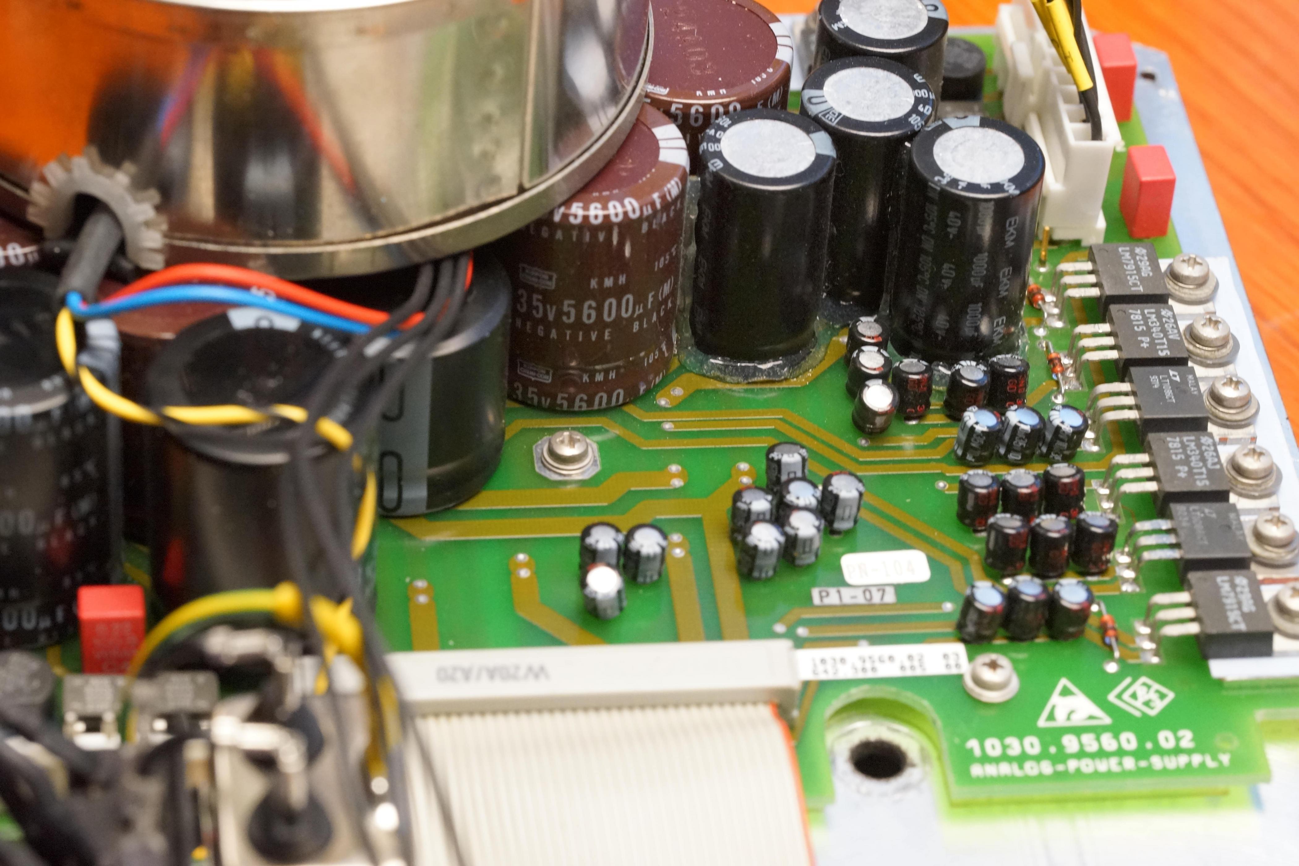

I would stick 100% to the type of cap, as well as value that R+S have chosen. Larger electrolytics will have higher in-rush current, which could blow rectifiers. They could also have other effects, if it means that the PSU takes longer to stabilise on turn-on.
The voltage on the trafo secondaries may be a little higher when they aren't loaded, but the voltage at the VReg outputs should be correct, so you ought to be able to test a psu in isolation.
If you are worried about a component shorting from 0V to a power rail, then you need to locate the power test points on each PCB, disconnect any cables to / from other boards, and measure resistance. You want to see a very high reading that's symmetrical between rails.

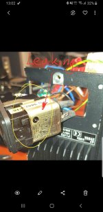

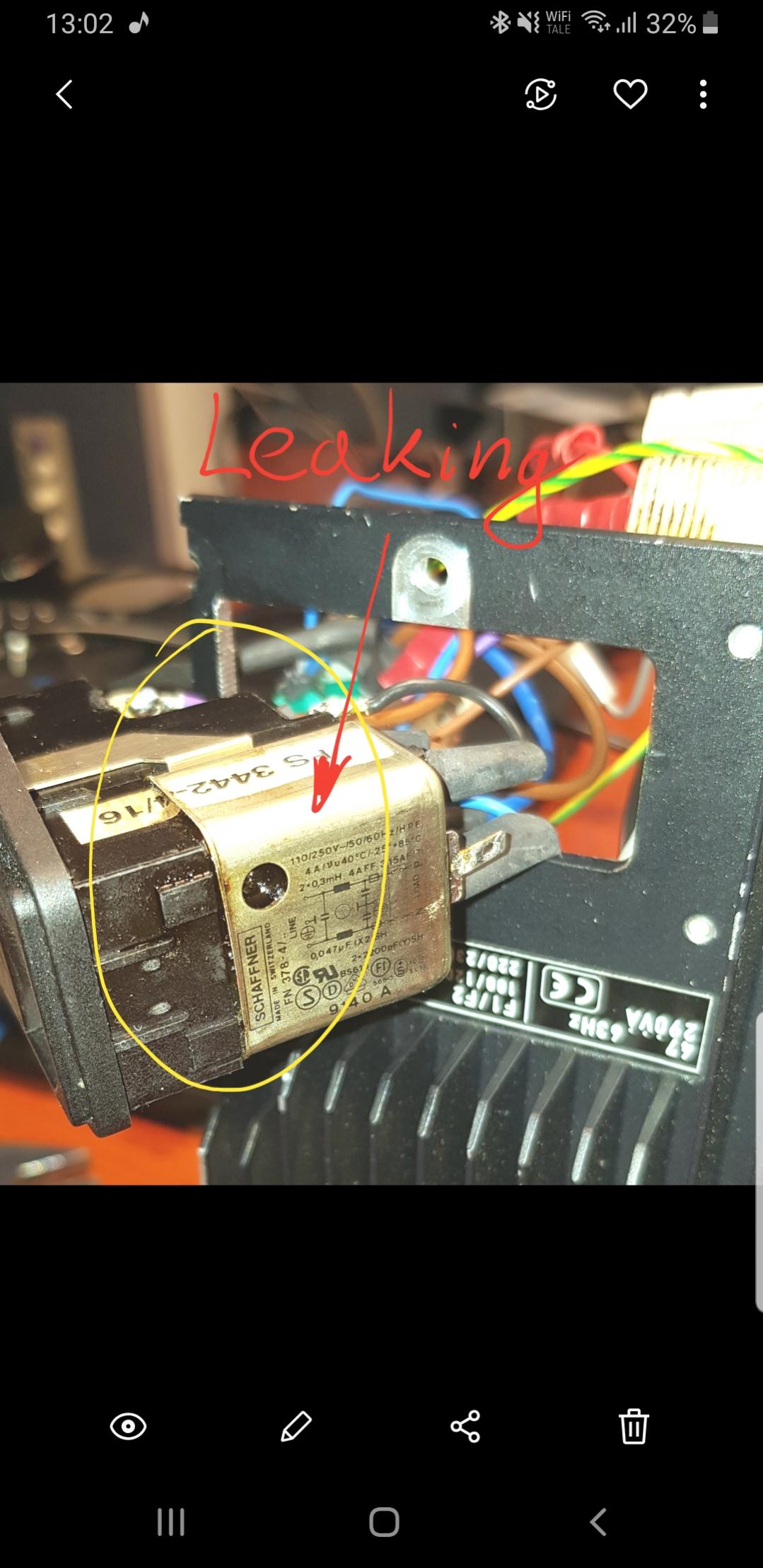

I had EMI failed (se attached picture) and replaced with FN378-4/21 that is all that i had to do with my Linear power supply. Seller said that my power supply is new and I belive that.
One thing i change : I switched from 230 to 240V because we have all ways more on 240V.. And i tasted that with varijak so.. the voltages should be correct on uloaded transformator.
SyncTronx my be someone overloaded your transformer or check what voltage you have selected on Eu plug connector.
Dont change kondenzators R&S made very good power supply (only on highest end you will see enclosed transformator). But if you want to improve Output U on linear rails should be addicional filters ..but dont :)
I could say there is no need.

thermionic -- yes, I had the same thoughts about this, keeping the cap values the same,
and the type of capacitor if needed. The whole PSU is removed from the UPD and
tested the same manner as jeanlucemarc did. Most of my voltage reading were
about 1/3 of his. Puzzling, as this is a USA unit that that had undergone calibration
at some point and didn't need further calibrations. Basic guidance for now is what
I need and it helps me focus on what I need to do and not think in overly complex
terms. Knowing that I should have very high resistances between rails is a good think. Thanks, and yes it's helpful.

I will double check the EMI filter and verify the voltage setting should be
set to 120 VAC as this was and is a US used analyzer.
