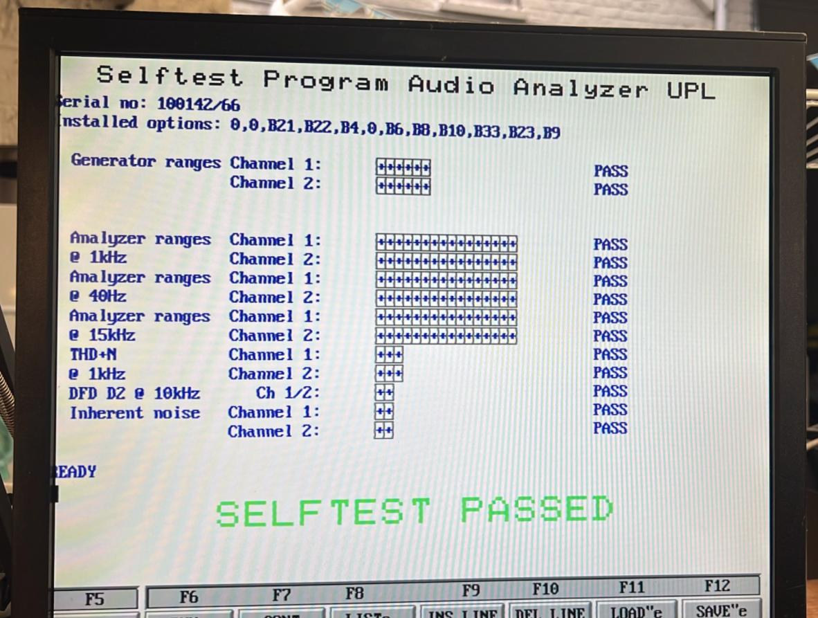

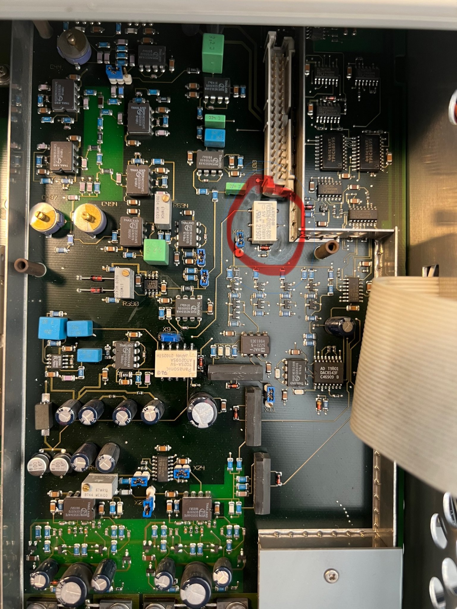

I was able to repair my faulty UPL Analyzer. The issue ended up being relay K240 that switches between the Low distortion Generator and the Internal one. After probing several test points I was able to find stable signals before this stage. A good method of finding if relays are your issue is to slightly tap them, if the issue is in the contacts you will see huge swings in the readings.
Relay type K240: V23026D1021B201 https://www.mouser.be/ProductDetail/655-V23026D1021XB

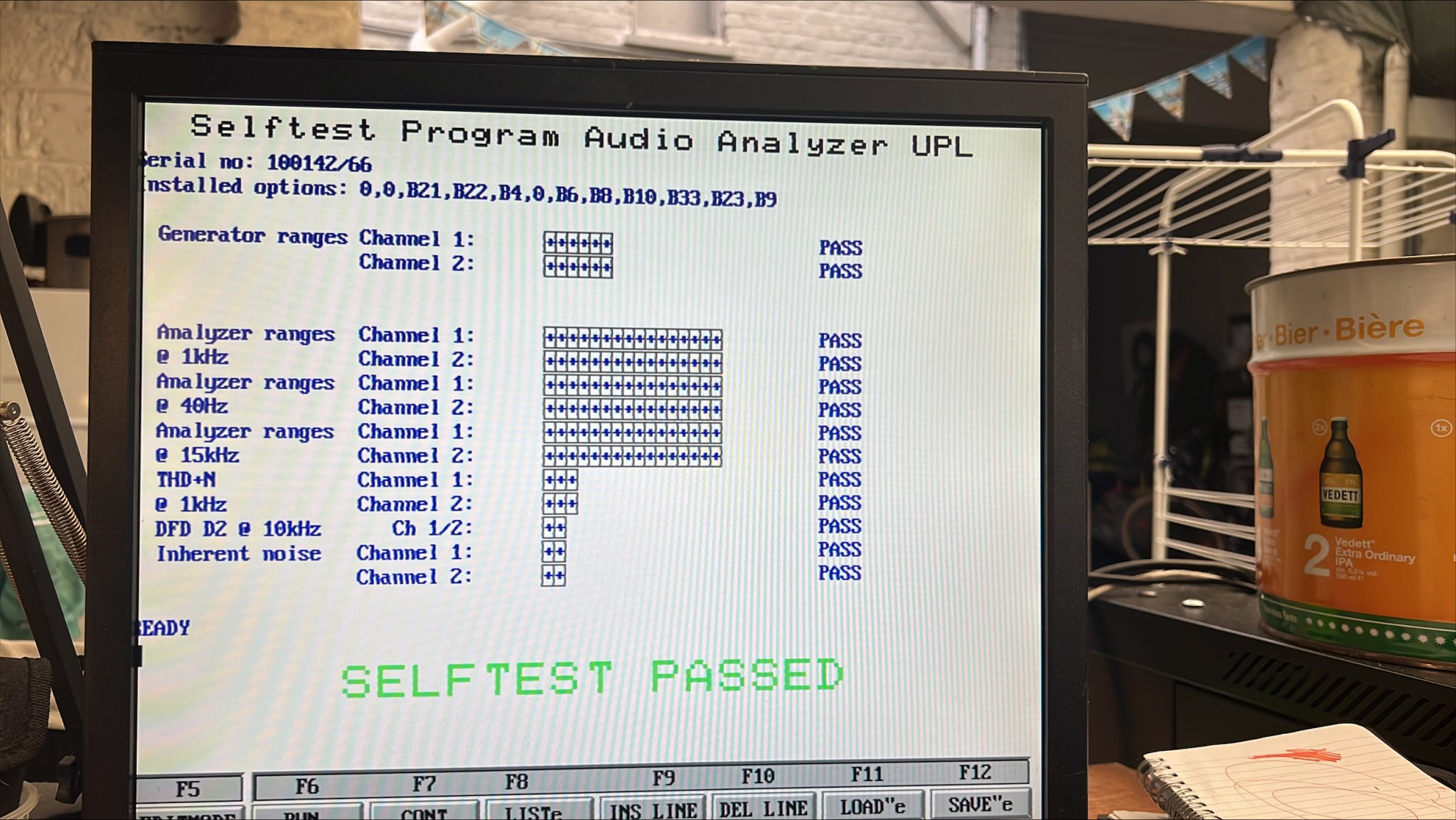

After replacing this relay, all readings were back and selftest passed immediately without issues.
Thanks to @astx for the relay suggestion, you were right!

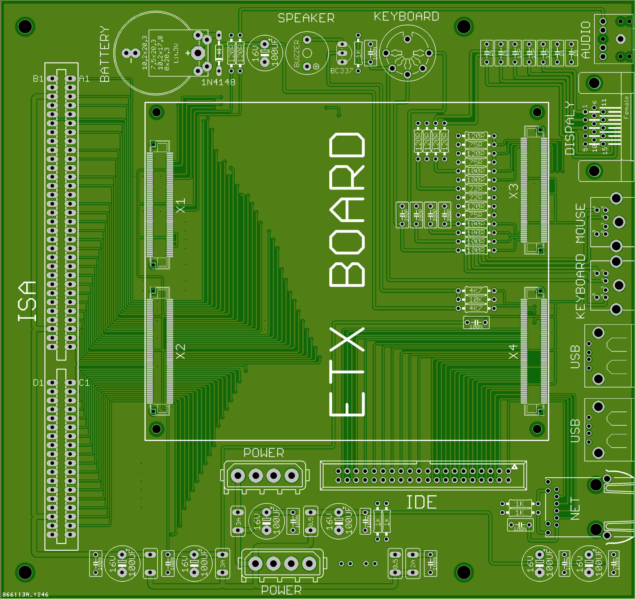

I can replicate the system using a 2G IDE solid-state drive. But if I want to test whether the self check signal is normal, my machine often experiences OVERLORD! The yellow indicator light is illuminated. So I would like to ask everyone how to call the SELFTEST command! You can view the fault location.
