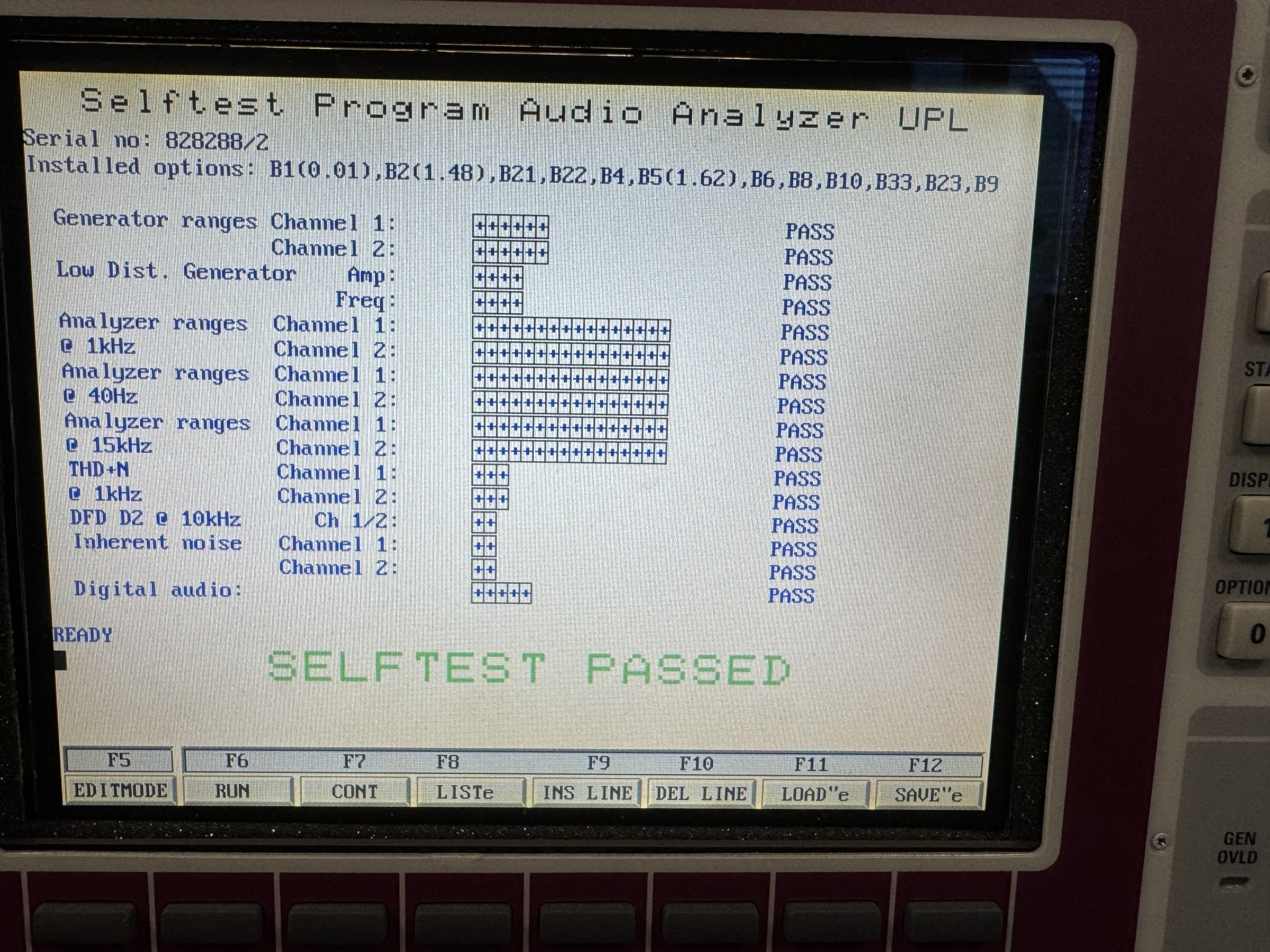

Please find the measurements on my analyzer, it indeed does not seem right on your analyzer.
Have you ran the selftest? That's where i would start.
  1. Ensure you have the B10 module installed
    1. if not, send me a private message with your serial number (or picture of the label on the back) and i'll generate all your license keys.
  2. If installed, go to options and execute macro
  3. go to C: - UPL - USER and select SELFTEST.BAS
  4. Follow the instructions
  5. Type Ctrl-D on your keyboard to enable the measurement screen at the top of your display.
  6. Hit F3 to go back to the BASIC environment to see the output of the selftest script (since the output goes away quick)
This should already give you a hint if the UPL passes or fails this test and where exactly.

I uploaded the SELFTEST.TXT file

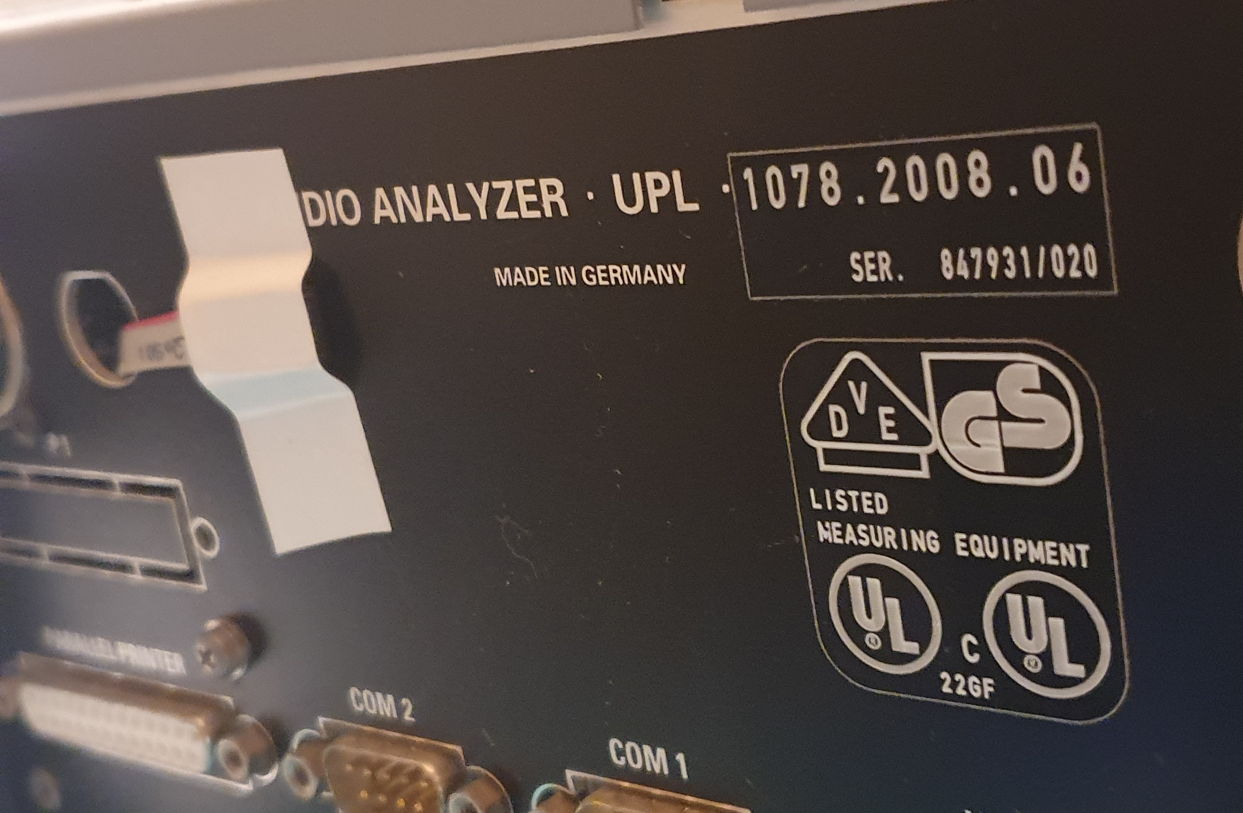

Hi Bjirre,
I am a happy owner of UPL. I would like to perform the selftest but my module B10 is not activated.
Would you be so kind and create for me the path / instalation file that will activate it and all other software features please?
I also have low distortion analyzer module installed.
In the attachment I share the serial key.
