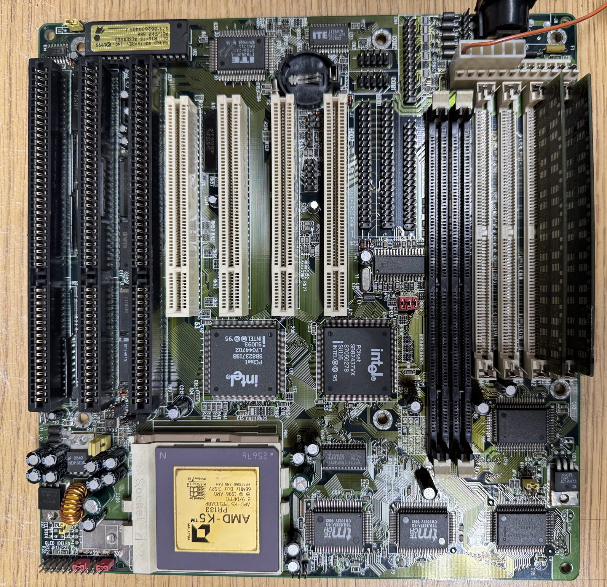

My hope is that the issue is with the PC motherboard itself. It appears to be a Shuttle HOT-555A v3.0. It does not appear to have any bulging/leaking caps. It has an AMD K5 PR133 processor, 8MB ram (2x 4mb Simms). I attached a PC speaker to the header on the board and I was getting a beep --- beep --- beep (continuous). I did try reseating the SIMMS, booting with only 1 SIMM installed, reseating the CPU, etc - no luck. I also tried powering the board up directly on the bench, but unfortunately don't have the proper video card on hand to test with. I can't reproduce the beeping all the time which to me is strange (in the unit or on the bench)
I found someone selling a HOT-555a v3.2 mobo, bought some EDO Simms and a Pentium 166 MMX CPU, as well as a video card to test with. I hope that if I can get the PC motherboard working on the bench, displaying the POST on the monitor with a PCI video card, chances are good the UPL will work again.
I sure hope the main digital board that contains the video card, ide/floppy controller, serial ports, gpib etc isn't causing the problem, since there's no chance I'll find a spare of that. I guess we'll find out.
The seller did advertise this as working, but did a very poor job at packing it (no packing material other than extra cardboard and empty plastic bags stuck inside) so maybe something got finished off on the trip from Belgium to New York. The only thing I did when I got it was change the power selector to 120v from 240. I left the smaller 2.5a fuses in the power inlet connector for now as I don't have 4a on hand, but they did not blow so that's not related to the problem. Unfortunately it did work for 2 days after I got it, so I think I'd have a hard time getting a return...

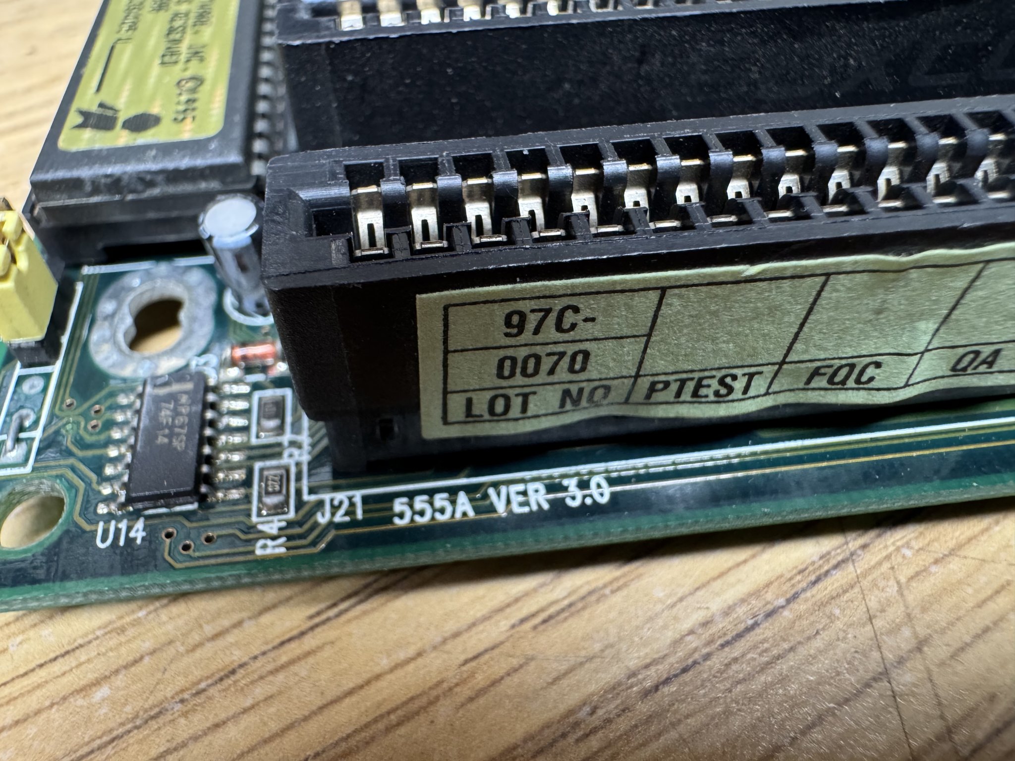

Interesting, in that case here’s some pics for the record. This is a UPL66, maybe they used different boards in them, shrug.
(Yeah, the battery's missing at the moment since I was playing around with clearing the BIOS, etc, as a last ditch effort)
This motherboard has some atrocious looking early lead free solder joints on the capacitors as well. Fingers crossed...

Thankfully I got it working again. That was a stressful couple of days. I bought one of those ISA/PCI motherboard analyzer cards (Kingpin CMBA-4)
The old motherboard was just displaying some dashes across the LED's (when powering on the bench). Not sure.
The new motherboard came in today and was displaying some codes but then would go back to BEEP -- BEEP -- BEEP -- BEEP and hang on this code C6C1 code on the analyzer.
As far as I can tell both 4MB SIMMs in the original motherboard are no good. I had a 32MB PC66 SDRAM stick laying around and I was able to get the new motherboard to boot on the bench. Unfortunately you can't use a regular DIMM in the UPL because the position of them on the board causes them to hit the metal shield on the UPL digital board. I found in one of my retro gaming PC's an "OCZ" Pc166 SDRAM (256MB) - it was one of the first SDRAM DIMM's with BGA Chips on it and much lower profile. Part of the PCB hits the metal shield a little bit but I was able to install the board all the way.
It boots!! It only detects 64MB of RAM from that 256MB stick but that's ok. I have some 8MB EDO SIMM's showing up later in the week, fingers crossed that those work.
The new motherboard appears to have leaky capacitors but it does not seem to have the horrible early lead free solder that the original one did (the joints are nice and shiny) so chances are good I can recap it without any issues.
I'm not super happy about the current root cause, but I'll play around more with the old board/ram/etc when my new test CPU and ram show up later in the week.

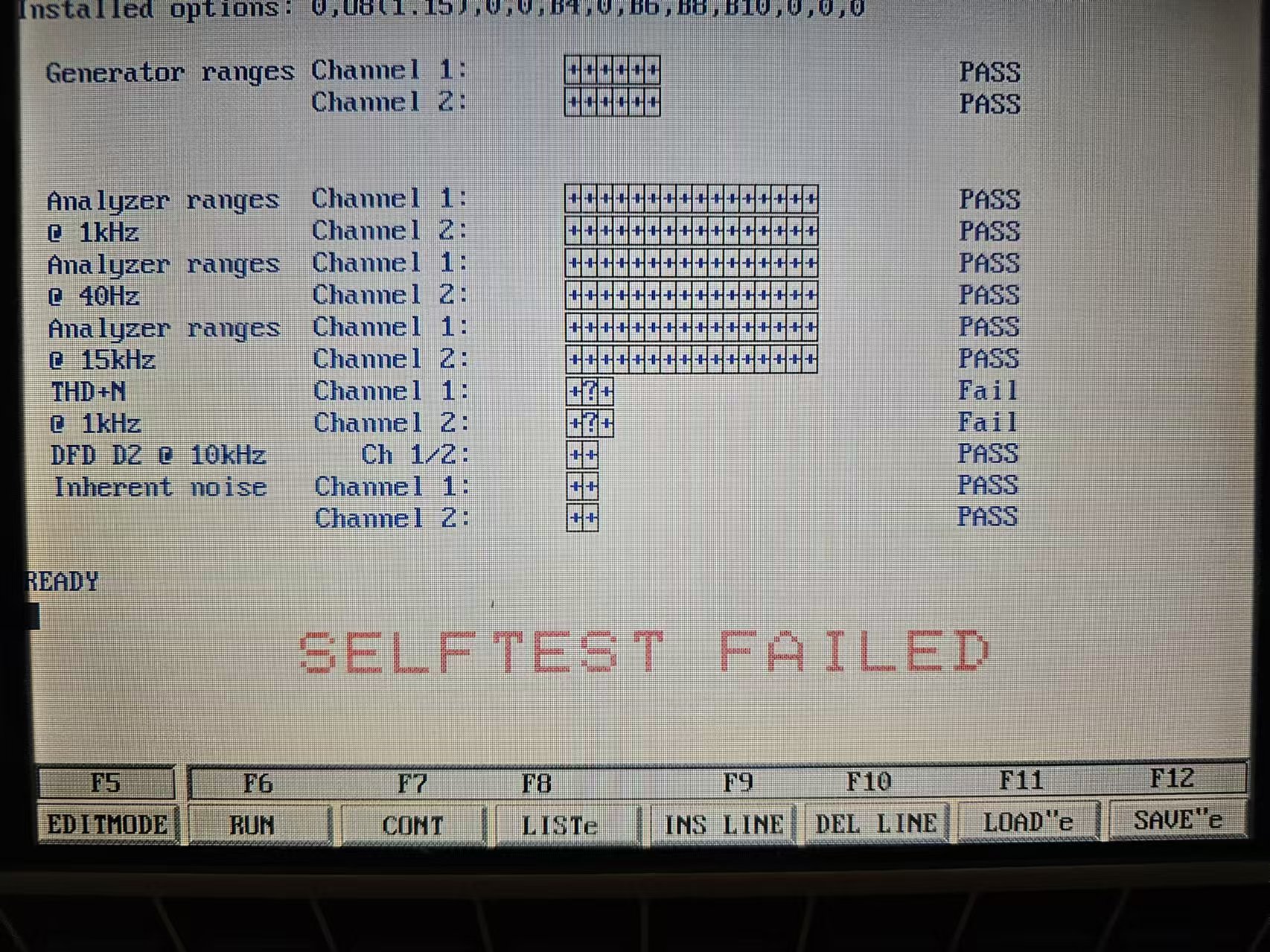

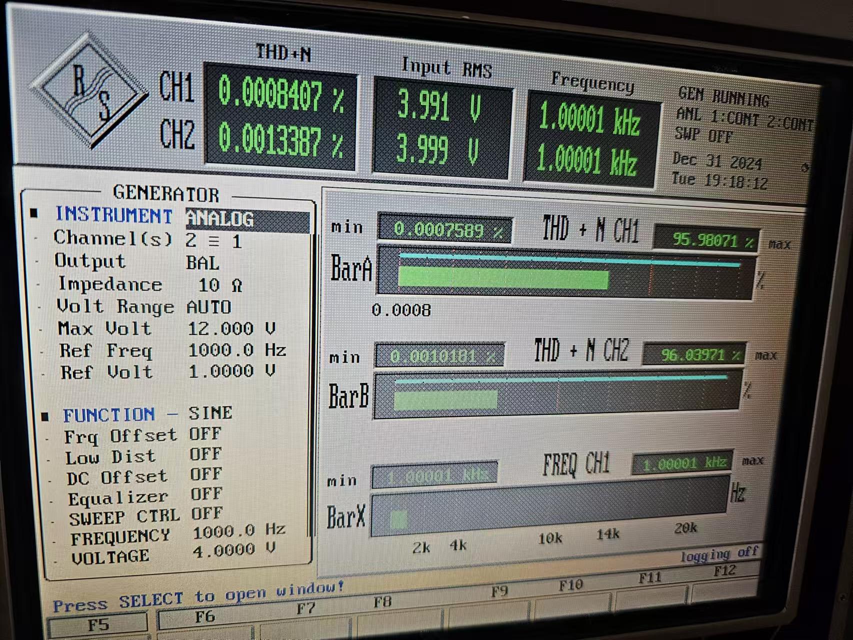

Thank you very much Bjirre, but I found a new problem in UPL. When the output level is above about 3.5V, the THD+N of channel 2 is different from that of channel 1. When it is below 3.5V, the values displayed by the two channels are the same. After many attempts, I found that it should be the problem of analyzing channel 2, so I would like to ask if this is normal?

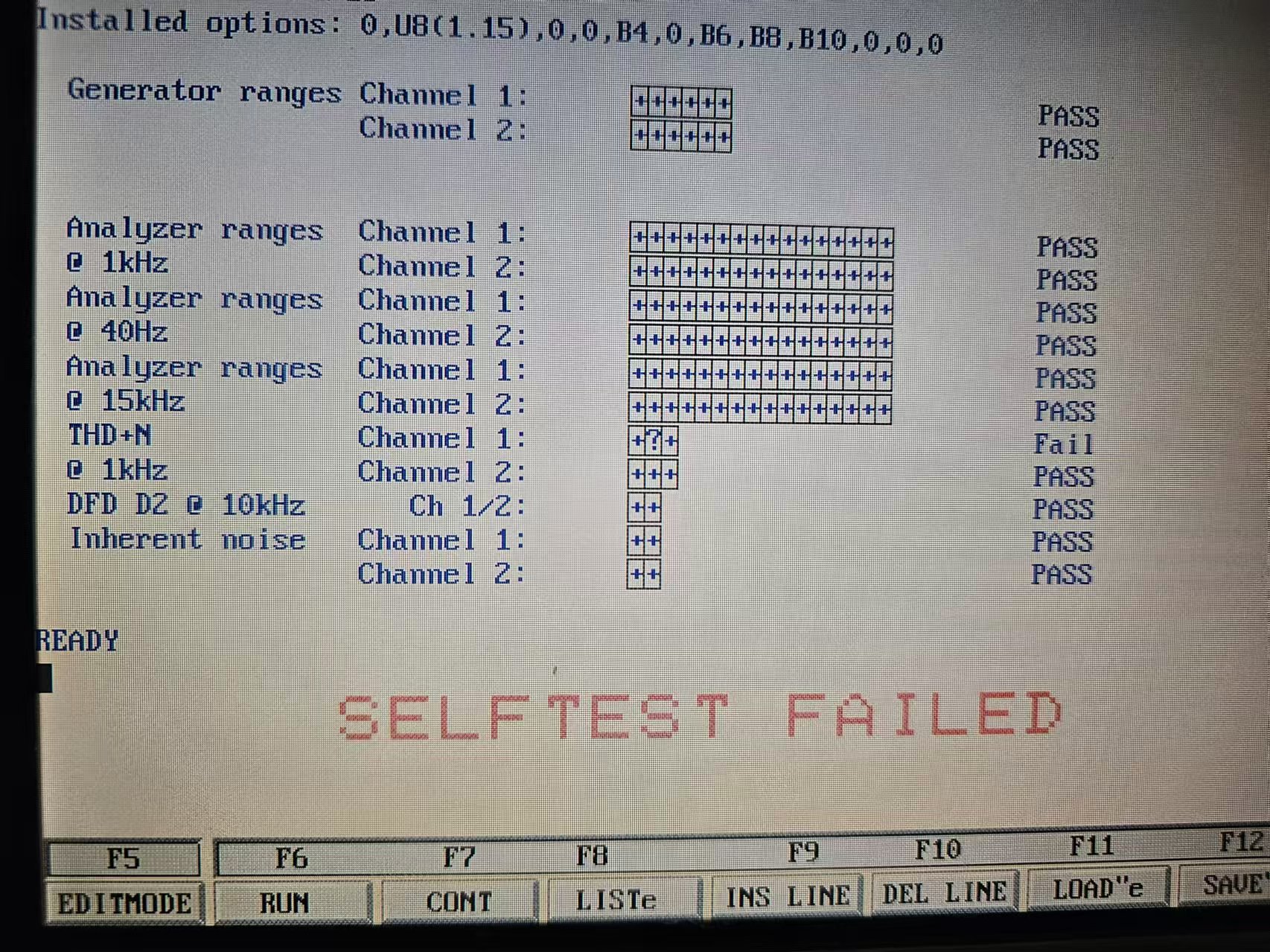

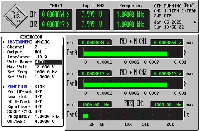

Please find the measurements on my analyzer, it indeed does not seem right on your analyzer.

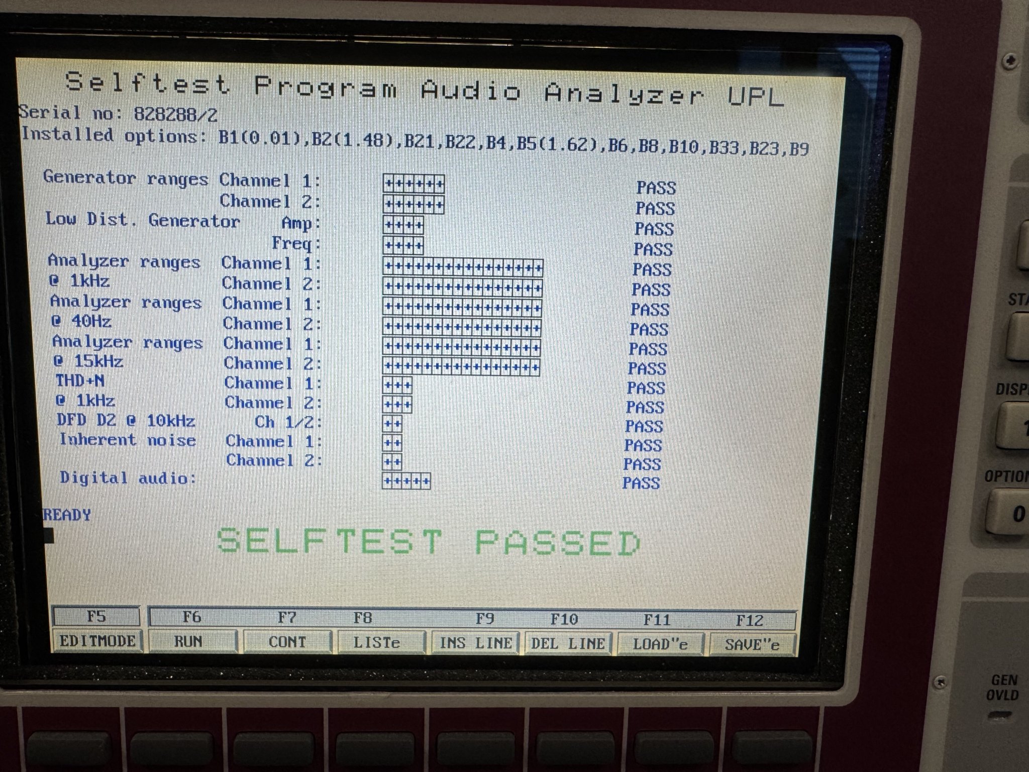

Have you ran the selftest? That's where i would start.
  1. Ensure you have the B10 module installed
    1. if not, send me a private message with your serial number (or picture of the label on the back) and i'll generate all your license keys.
  2. If installed, go to options and execute macro
  3. go to C: - UPL - USER and select SELFTEST.BAS
  4. Follow the instructions
  5. Type Ctrl-D on your keyboard to enable the measurement screen at the top of your display.
  6. Hit F3 to go back to the BASIC environment to see the output of the selftest script (since the output goes away quick)
This should already give you a hint if the UPL passes or fails this test and where exactly.

@Jok3r7 I've added 2 txt files that show the program source code, the other is the test report (you can find this after the selftest program ran on c: UPL USER.
Off the top of my head here are some suggestions to further dig into:
  • Measure externally with another THD analyzer (if possible), figure out if this is coming from the Generator or Analyzer section
    • Alternatively insert external voltage into your THD, and focus on the analyzer section.
  • Figure out from which voltage this pattern occurs, from that information you can look into the schematics if you can find an amplifier section / attenuator section related to your voltage.
I'll keep on looking for some other clues in the schematics but this might get you started.
Kind Regards,
Bart
