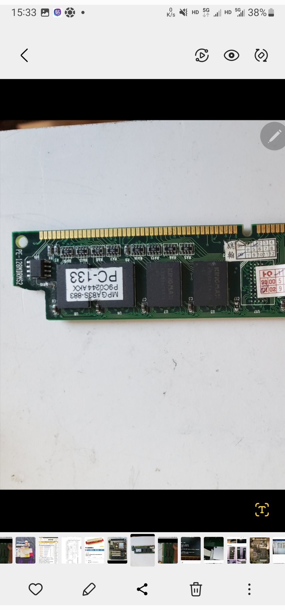

Did anybody here increase the RAM? My machine has 32MiB in 2 72-pin SIMMs. I don’t know if that’s stock, or that I installed that. But I did find 3x 128MiB DIMMs in Pandora’s box. They are PC-133 memory, where PC-100 is required, but I don’t think that’s a problem. What is a problem, is the SuperCap on the R&S board right where the DIMMs are, and the heights of the DIMMs themselves.

SDRAM 128M !
If there is a digital board, there will be a conflict between the position of the memory module and the digital board. My solution is to choose the shortest memory module and polish off the ROM chip of the PCB a little more, so that it will not be affected.

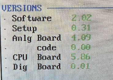

Hi all, i bought a UPL a couple of years ago, in fully working order. After reading about replacing the floppy drive with a usb i ordered the part and installed it fine. Now, i would be very interested in using the R&S attached setups. So i downloaded Bart's Disc1 and Disc2. Unfortunately when i try inst.bat there is an error in the filecheck and shows its corrupted. My upl firmware version is 2.02.

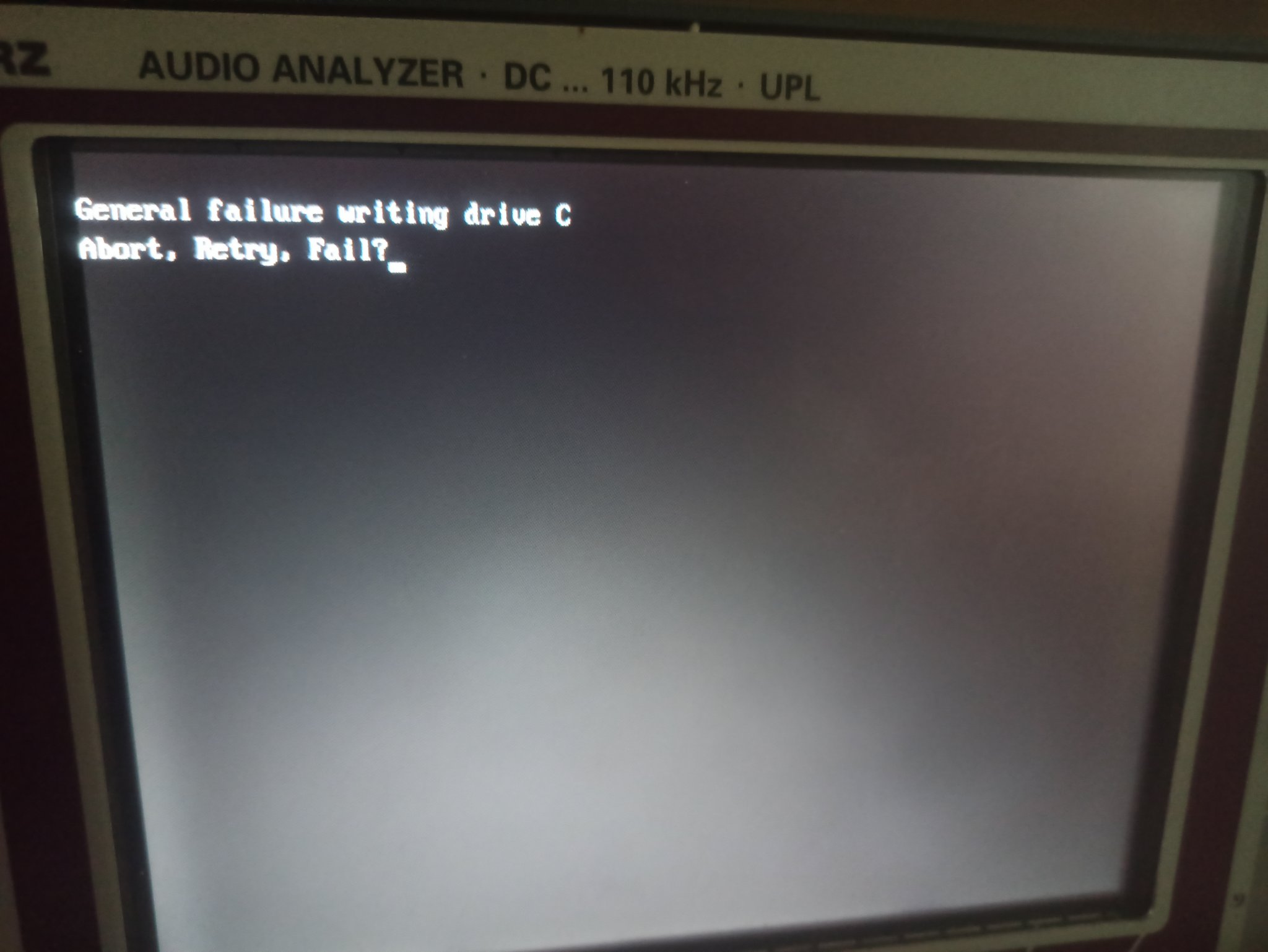

Two photos below
The first photo after loading DOS. After pressing "r" several times, the program loads without a problem and does not report errors. My disk was replaced with a 4GB CF card divided into two partitions. When the computer works for a longer while and then is reset, after reloading DOS, the problem with the CF card does not occur.

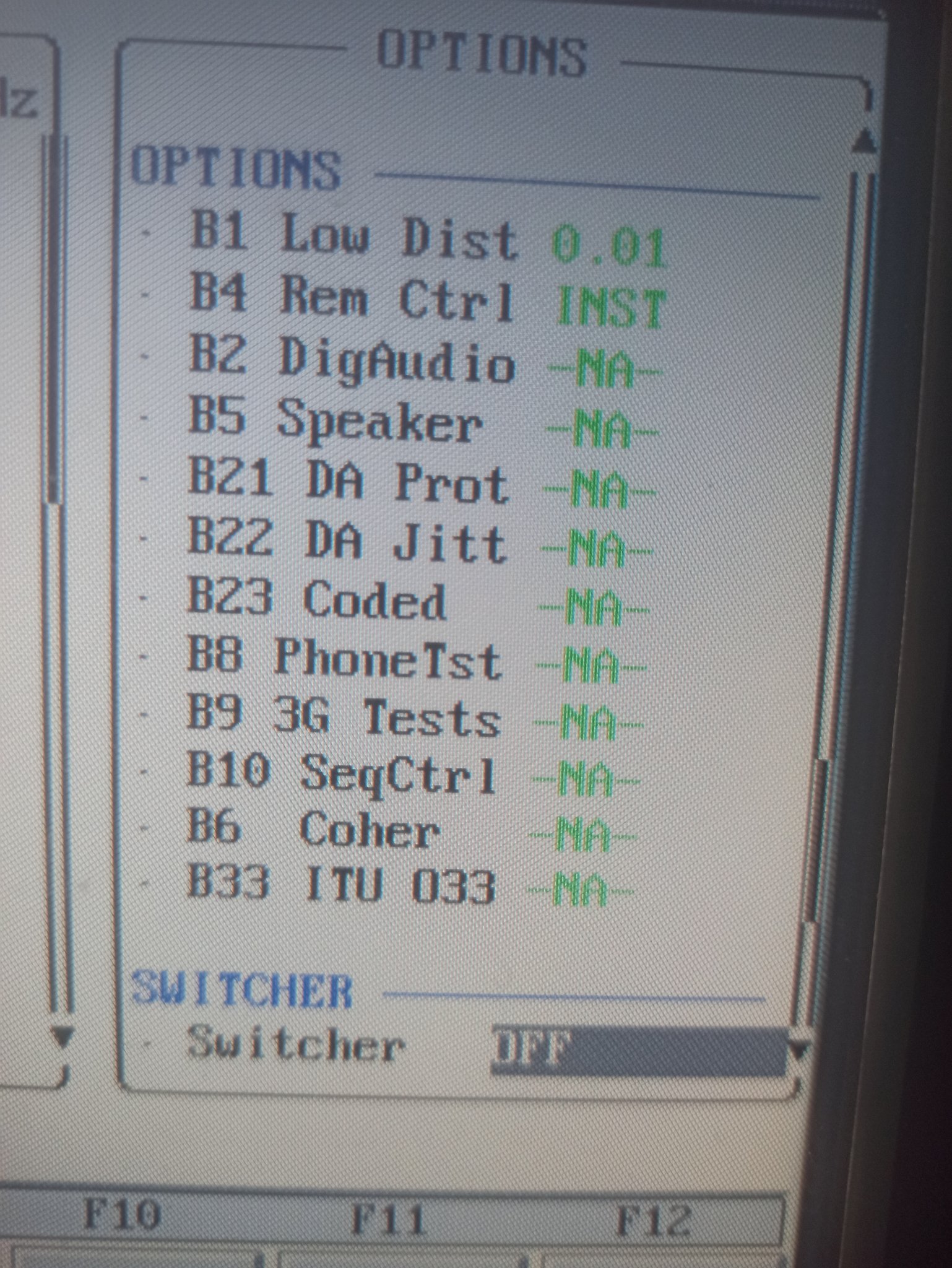

The second photo: "options" of my device (you can have less 🙂 )
