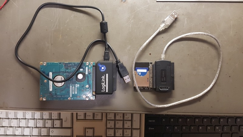

It's probably a compatibility problem, between a BIOS not fully supporting LBA mode, and an SSD no longer having CHS addressing mode properly implemented. There must be plenty of similar problems among retro-gamers.
I have even tried idediag.exe, to figure out which CHS geometry is reported by the drive, without BIOS assistance. This program reported a geometry of 255 cylinders, 15 heads and 63 sectors (per track), a total of 240975 sectors. And a logical geometry of also 255 cylinders, 15 heads and 63 sectors (per track), a total of 15466575 sectors. Entering this into the BIOS produces a 39MB drive. I didn't even bother to try that.
I'm sure that this is not a size issue; I found few of my posts on the EEVBlog forum from early 2018, about upgrading my spectrum analyzer drive to an SSD: The 2GB and 4GB Transcend industrial grade SSDs I tried didn't work in either my spectrum analyzer, nor my UPL. Hence my deja vu. Perhaps it's just not possible. Or a Transcend-specific problem...
Why not try CF card? As you have checked retro-gamers know-how, you know not all CF cards are bootable.
I used transcend CF100i industrial CF card for my UPD, though UPD is a intel 486 system, it works fine.
Even industrial CF cards used one are cheapo today. I had tested other 2 Generic CF cards, but both did not work well.
Reactions: 1 user
I forgot to mention: I already tried all 6 CF cards in my box back in 2018, and none of them worked.
I use now 8 GB SD cards with adapter in my two UPLs . The original HD I cloned with HDClone and it works with no problems .

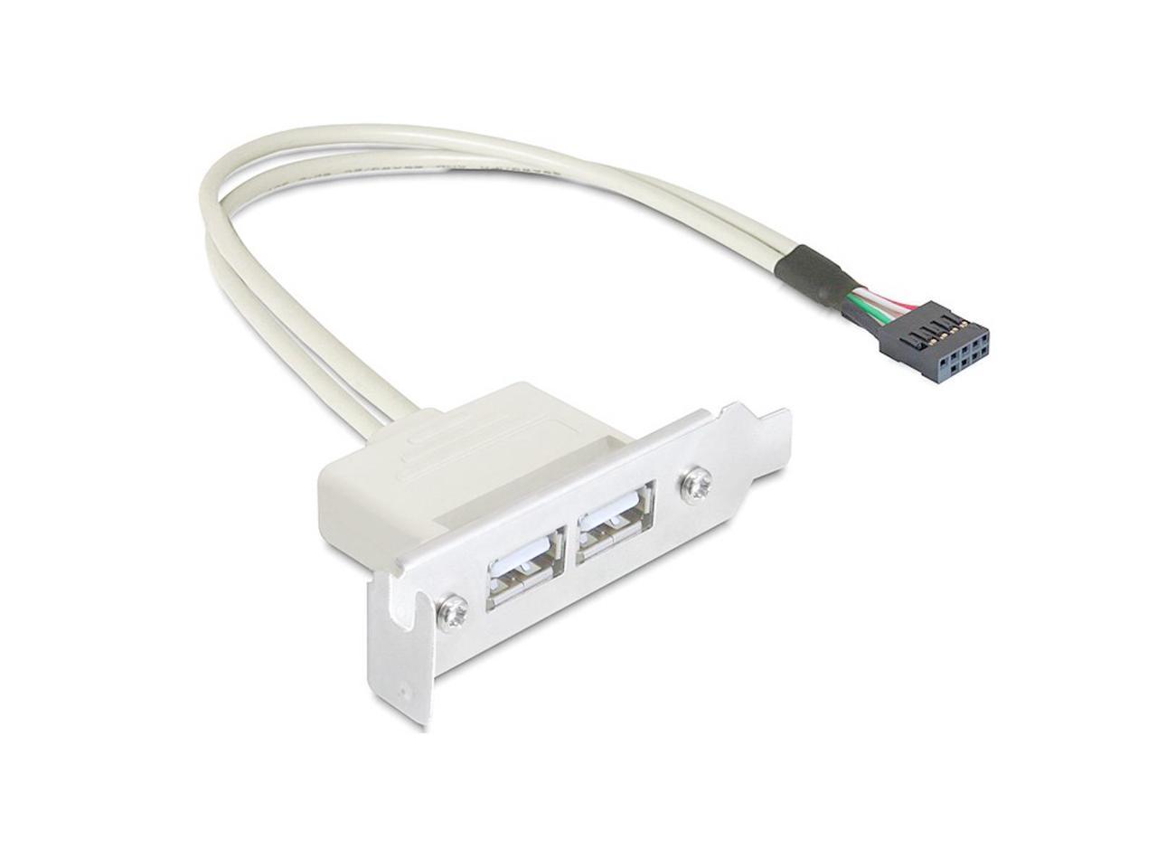

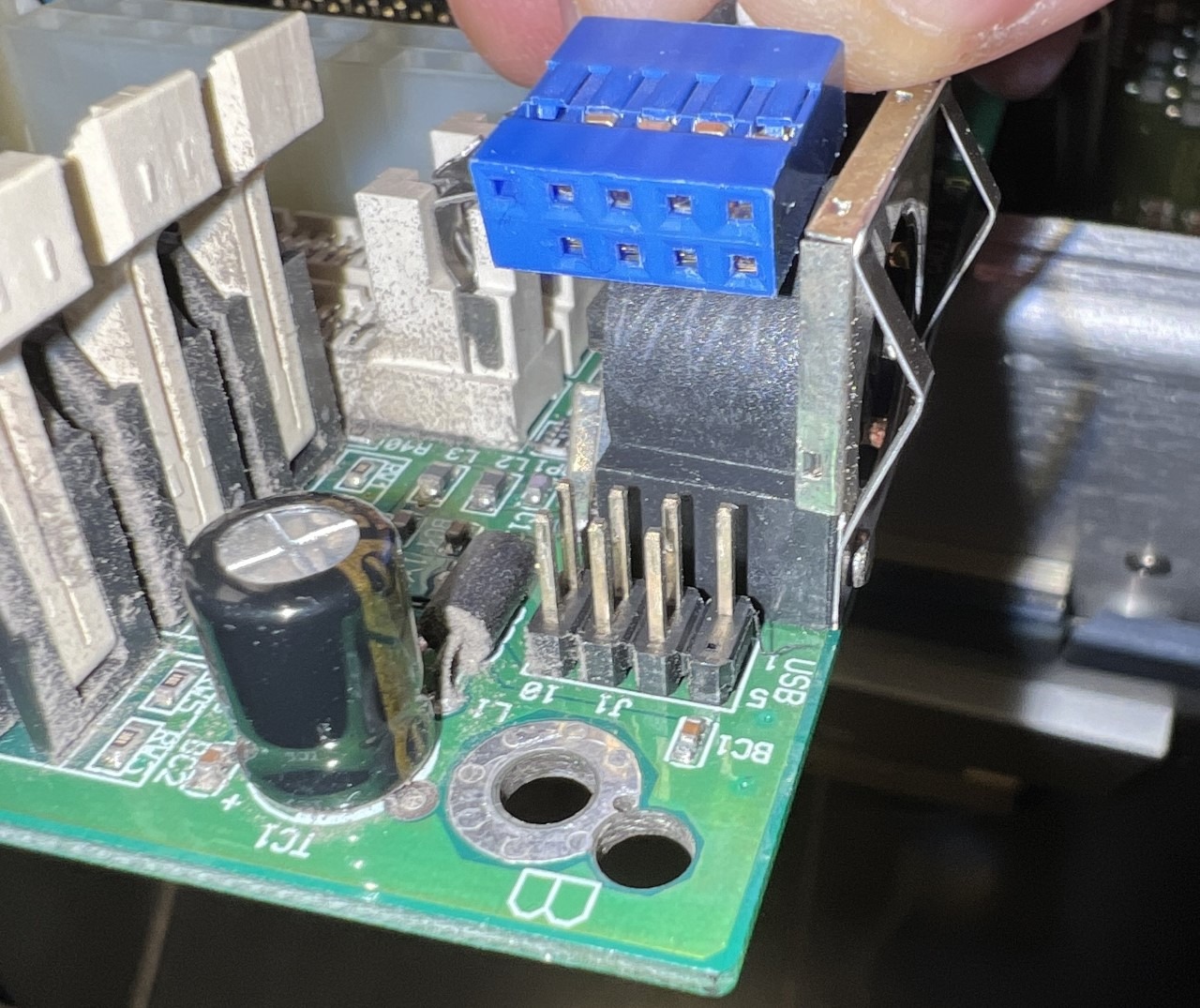

It may be handy to know that this main board has a USB port. It is disabled, but it can be enabled in the BIOS. And specifically these may very well fit the optional P1 port on the back of the UPL:

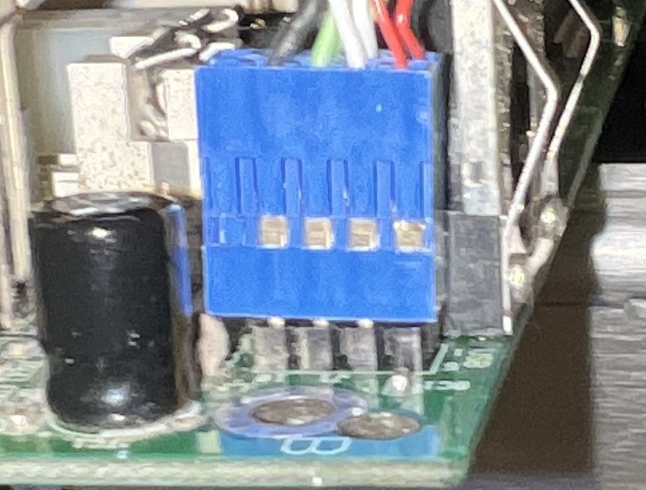

Caution to anybody trying to make use of the AI5VG+ motherboard USB connection: The USB header pin-out is non-standard. It misses two pins, and hooking it up as what intuitively seems right, will reverse polarity on both the USB power pins and data pins. Ironically, when plugging in a device, Windows will detect this event because of the way USB chirping works, but no device will be found. While you are wondering why, your mouse's power is reversed, burning it up on the inside, as there seems to be no current limitation on the mother board. My mouse survived, but is smells like burned circuit board now.
The correct way to hook up a converter in the post quoted above, plug it in as shown below:
Note that in this case only one of the two USB ports will actually work, because the missing pint on connector J1 is +5V for the second connector. When splicing both red wires on the illustration above together, both ports will work.
