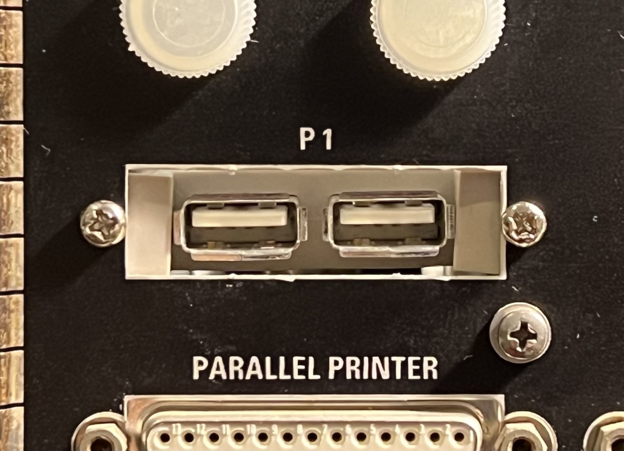

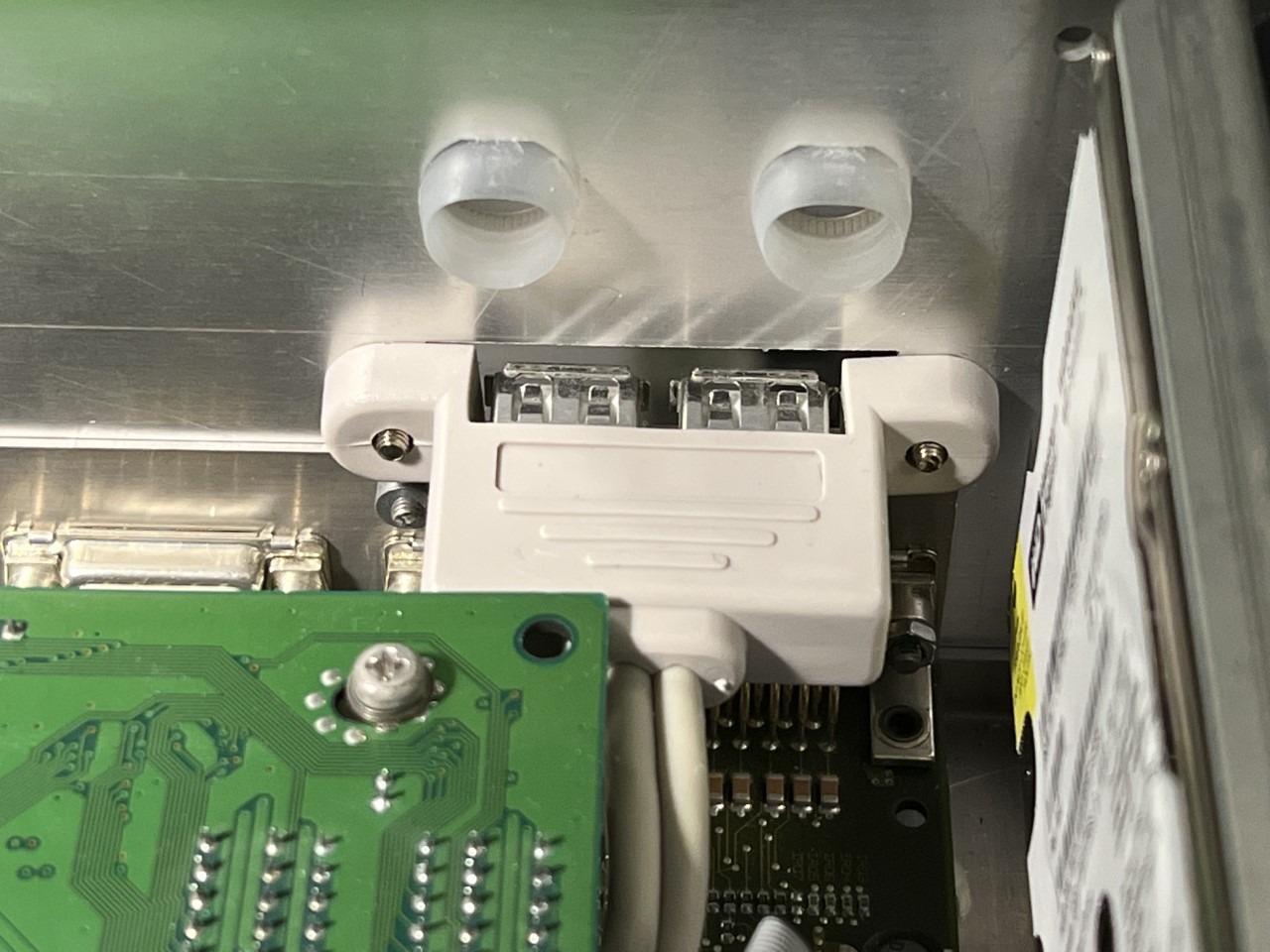

Here's how I added external USB connectors:
One is intended for a USB Ethernet dongle. Sub-ideal for performance, but more than good enough for getting files on and off the instrument.
The other will be connected to a hub, for a mouse and a flash drive.
I have considered to replace the FlexiDrive with a floppy hybrid drive, that contains both a floppy drive, various card readers and a front panel USB-A connector. I may still do that, if I can find a beige one. Together with this 'splitter', which are actually 2 internal 2-port hubs, everything could be connected simultaneously.

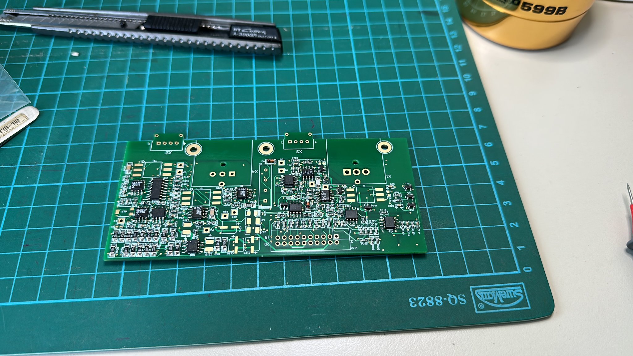

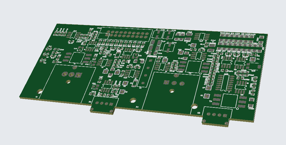

I got the board measurements from (Bart I think) some time back, and am currently working on a cloned PCB for the digital outputs. The board is deceptively complicated as there's not much space to fit it in the instrument, and there are actually a lot of components on itOk then in such case and if you are familiar with PCB design I think that this front panel is not so complex to clone.
You need to ensure that you can source all the parts on it or find equivalent as they are a bit old but it should be doable.
The front panel is relatively simple.
I've managed to source the completely obsolete parts from various obscure corners of the Internet, let's hope I can get it going!
I've gotten the preliminary (unrouted) board layout from a local guy who does PCB design, it's currently off to JLCPCB for production so that I can mount the front panel components to check fit.
As you can see the board is really dense due to the ability to adjust output levels etc. so it is non-trivial to build one without a PCB.
I have the nagging suspicion that this is going to be quite an expensive project, but it should be worth it as I'll then have a practically fully loaded UPL with the (seems to be extremely rare) B29 96kHz option.
Looks really cool! Let me know if you need anything from my side.I've gotten the preliminary (unrouted) board layout from a local guy who does PCB design, it's currently off to JLCPCB for production so that I can mount the front panel components to check fit.

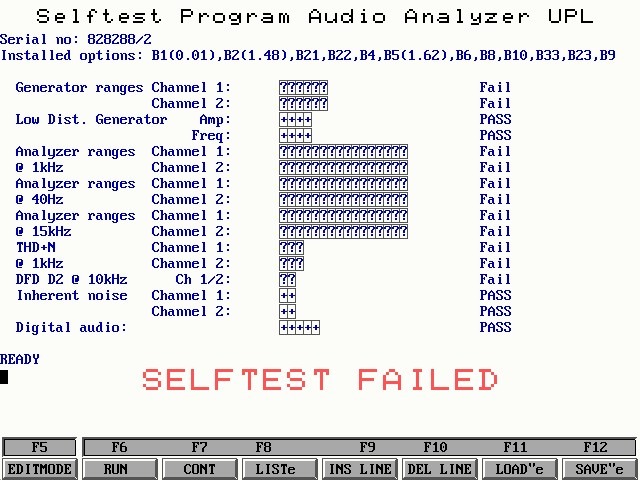

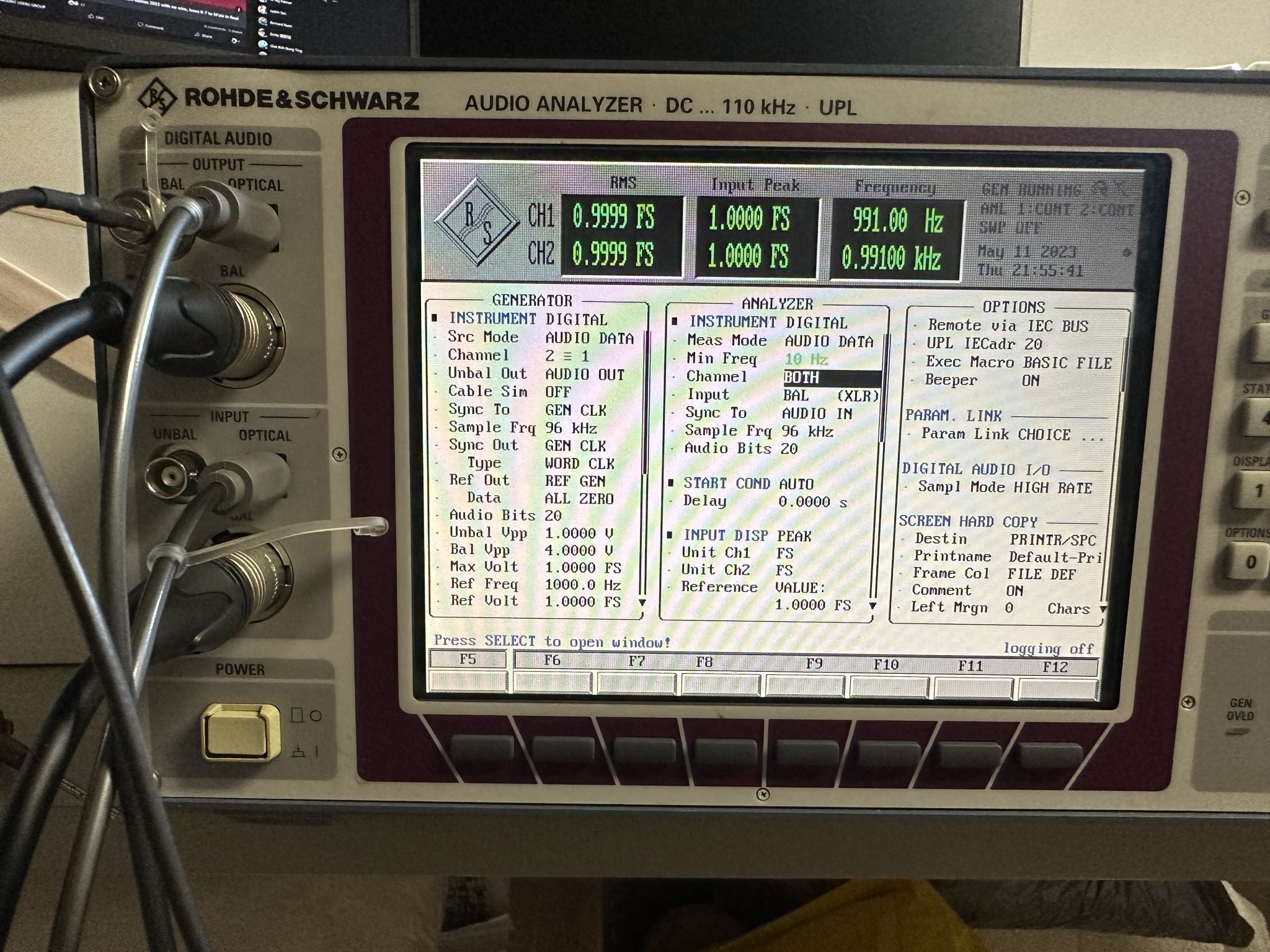

I have an UPL on my desk that is failing it's selftest quite dramatically. I'm hoping anyone here could help point in the right direction.
I'm suspecting a gain amplifier chip or something that is common for both channels.
See the failed selftest image as well as a passed and failed test result.
Any help is appreciated!,
Thanks,
Bart
Thanks,
Bart

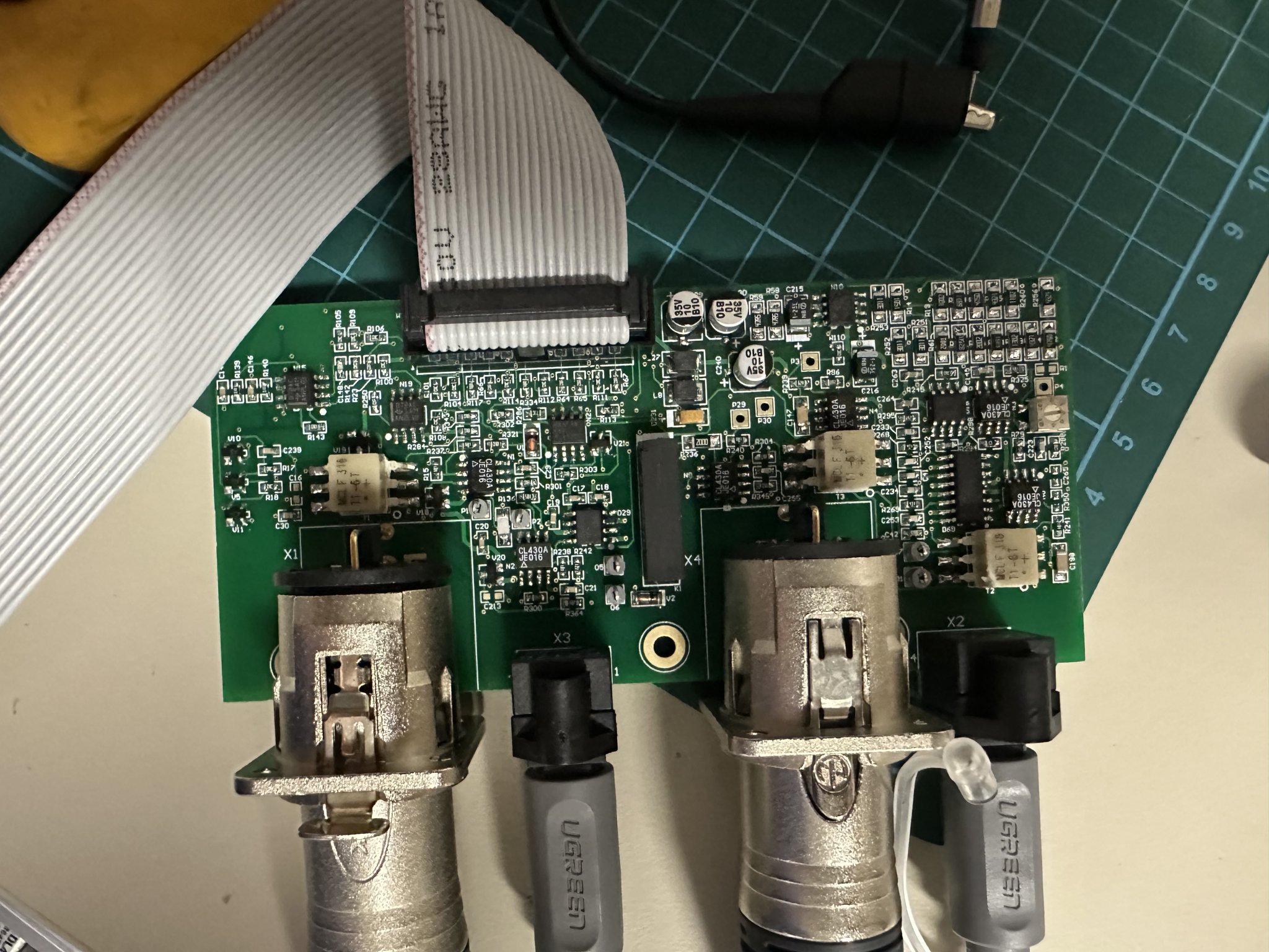

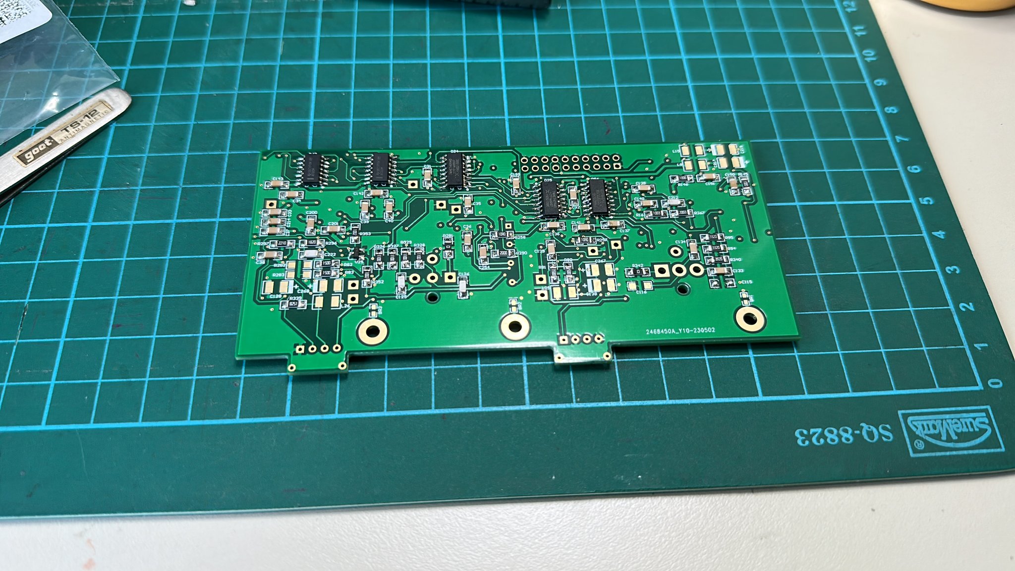

Well, after much pain and some money, I now have a front digital I/O for my UPL!
I had a local guy “clone” the layout of the board as best as he could, based on photos of the original board and the original schematics.
That many components took me the better part of 2 days to solder, not to mention having to trawl through sellers of questionable merit to locate all the obsolete parts.
Seems to work fine, apart from some teething problems caused by oxidation on the pins of the (really old stock) CLC430s.

Thanks for the suggestion, but the issue is happening simultaneously on both channels on the board. Each Channel has their own relay and no relay is shared for both channels. Having a double relay failure would seem odd.Maybe a relay failure on the analog board near output stage. The relays control output gain and they are known to fail. I have had such a problem.
Open for any other suggestions though!
Thanks!
You have a built in low distortion generator: if all output levels at different frequencies are correct, then the output stage gain and attenuators are ok. Check the DAC outputs sheet 25+ section B1-B5 (service manual volume2 page 122-123).
Reading the results it seems to be a frequency related gain error in N79 and N80 opamp circuit?!?
Check the DACSIG amplitude at different frequencies be4 and after relay K238
