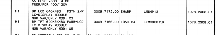

Just stumbled about this thread, please forgive me if ask something already answered. Who is manufacturer and how is the part number of the integrated color LCD?

I have pictures on my drive (the first link of the thread) that shows 2 possible models that i came across off.

See Screenshot of Page 7 of the volume 2 service manual.
I have Rev5 (UPL) and a more recent revision of UPL66. My LCD is a Toshiba one.

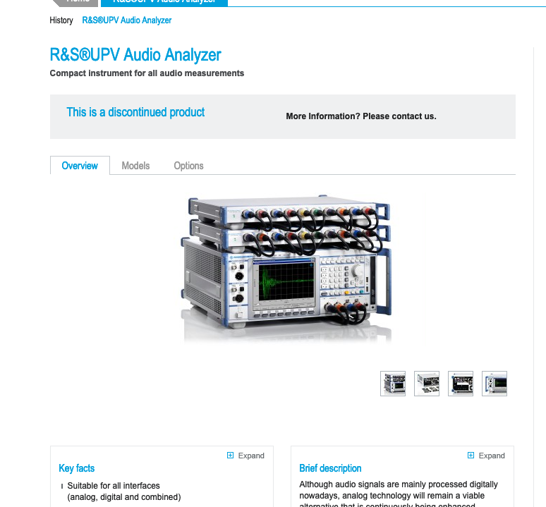

>UPV came after, which will be discontinued in a couple of years as some components >inside are NLA as well.
Do you know which components? May I ask where you got this info?
Thanks,
Seems I was right. UPV is discontinued.
A bit sooner than expected.
