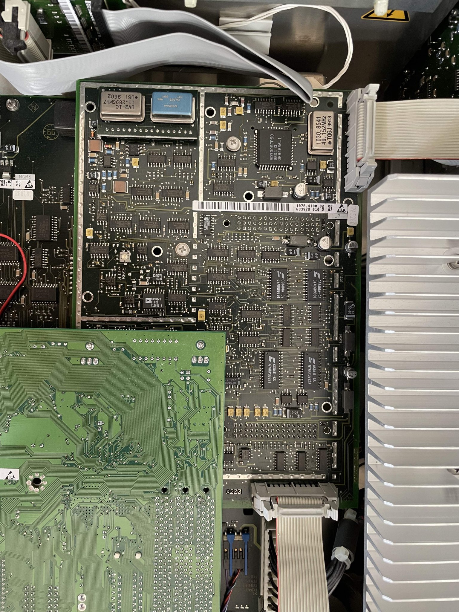

Just a quick update on my UPL, I hope I can somehow do my little part to contribute to this treasure trove of information on this legendary instrument.
Even the story of how I picked up a UPL with the B29 option is interesting... bear with me, please 🙂
When collecting the instrument from the seller, I noticed he had an entire pile(!!!) of them at the back of the shop. I kid you not, he has at least another 10 of them in his storage. Some factory must be mass upgrading them!

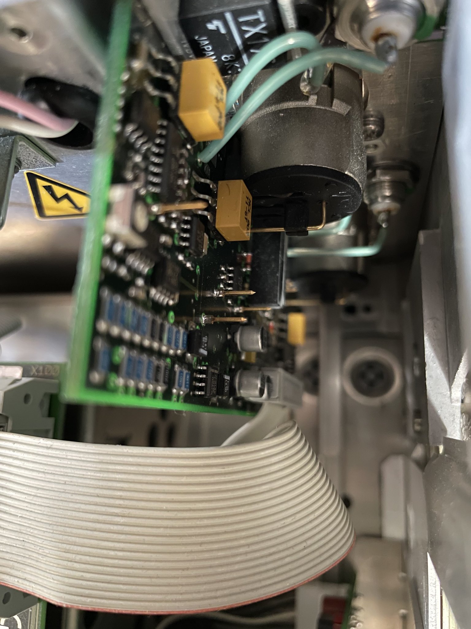

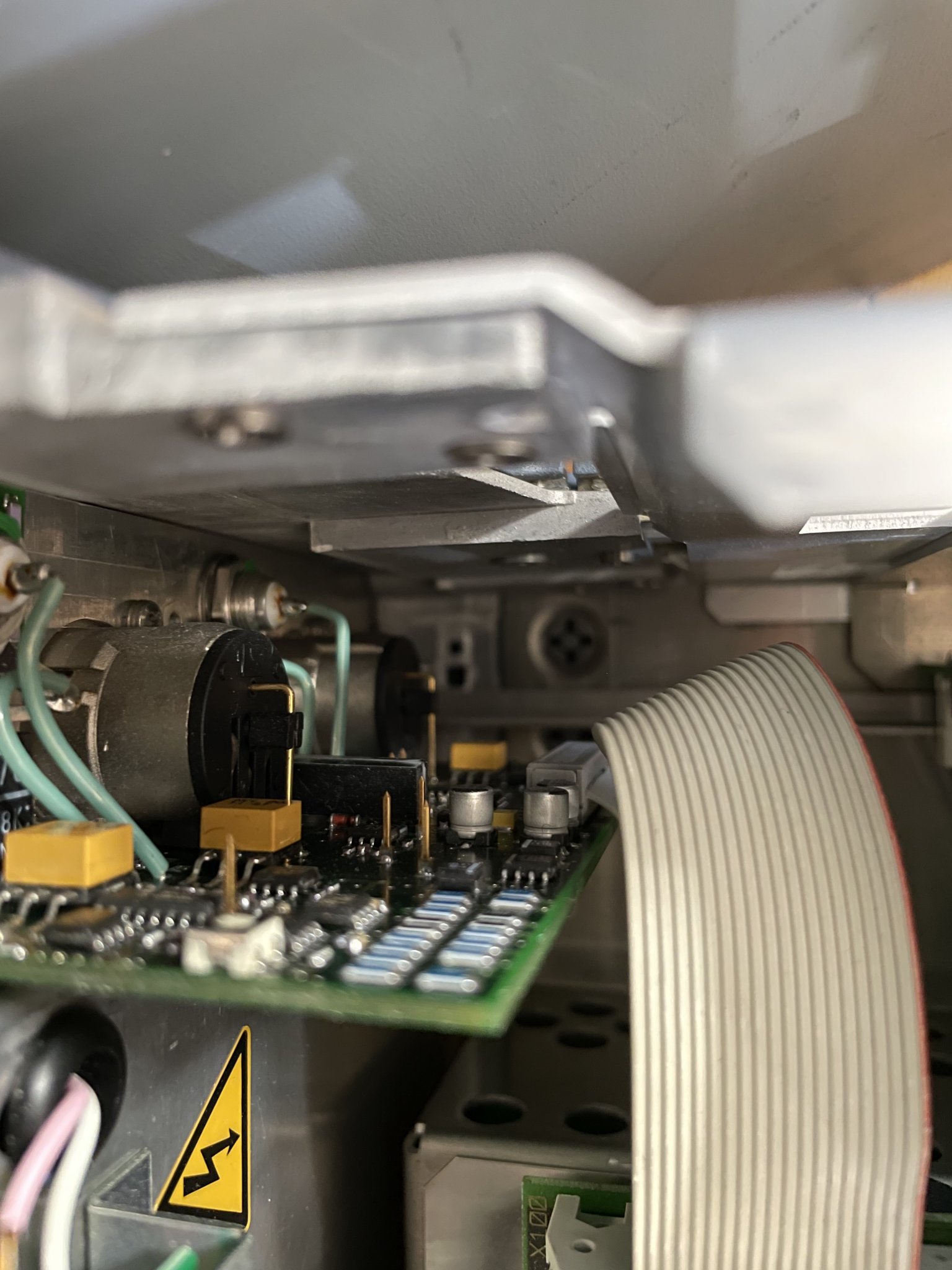

So, I asked, could I have a look at them to see if they had any internal options which I would be interested to acquire. I was looking for the B1 low distortion oscillator option.
Sure, he said, go ahead.
From the photos here and my first unit I knew the location of the oscillator, so I shone my phone's flashlight through the side of all the instruments.
And lo and behold, as luck would have it, right at the bottom of the pile was a unit which had a B1! It was the only one in the stack which had it, I wonder why...
The intention was to pay the seller's asking price for the entire unit (very reasonably priced!), just extract the B1 module so he could still sell the rest of the unit as "Parts Only".
After doing an intense physical workout to retrieve the unit, I opened it up, only to find a mystery board where the digital interface sits. The front panel was still the standard part, with no digital audio jacks.
The part number on the board read "1078.4300.02". Strange I thought, Googling it doesn't produce any results. The UPL user manual states part number 1078.4000.02 for the UPL-B2 and 1078.5107.02 for the UPL-B29. It however had the Sync and Ref sockets on the back of the board, so I didn't think it was the UPL16.
In any case, it was a much newer unit (~2004 vintage) than mine (~2000), with the small CPU board and a power supply which was in better condition, so I took the entire instrument anyway.
When I got back, I quickly realized why the unit had the digital board but no digital jacks... the signs were that the display, keyboard and floppy connector were all disconnected. Someone had swapped out the front panel for one without the digital output, but left the rest of the instrument intact! This was confirmed by plugging the display into my working unit, to be greeted with a blank, black screen. I would later find out that the backlight was completely broken (literally, the CFL tube had turned to dust) and the LCD was not working as well.
I could find no other information about the B2 or B29 on the 'net, but I noticed that the board layout and components were not quite the same as that in the service manual posted here.
However, I did spot 2 CS8413 AES interfaces on the board, that I knew were good for 96kHz. Could it be...?
I set out to determine how to make the instrument detect the board... studying the schematics of the AES board (page 234 of Volume 2 onwards), I saw a 74HCT165 (D38), which looked like it was how the instrument identifies the board (no pesky EEPROMs here!). It looks like the UPL software sends an ID command through the serial bus into these shift registers, which will then spit back the version number (somehow...) via the binary code present at their inputs.
Furthermore, I saw the FP_DATA_OUT signal, that was kinda the Eureka moment. It goes to the front panel! With a missing front panel, perhaps the shift registers were not getting clocked, therefore the instrument would not detect the board. Further analysis of the front panel board schematics gave even more hope that it just needed the correct number of shift registers to be present.
It was still not a given though, as I would not know if the B29 option would have a different front panel board (again, zero information on the Internet).
Well, why not give it what it's looking for? I decided to build the part of the front I/O board around D24, D25 (74HC4094 shift registers) and D54 (74HC153 multiplexer) as I saw the possibility of the internal loopback of the AES signal.
A quick (well not really, it's still a 1+ hour round trip not including shopping time) trip to the local electronics market and about 2 hours of point to point soldering on perfboard later, and... well you can see the photos 🙂
The digital board sprang to life, version 2.16! It was also detected as a B29 Dig96 option! How about that. Even passes all self tests and if I select internal loopback, everything seems to work.
Now to really recreate the rest of the digital I/O board... the parts are still more or less available from China, let's hope they're legit.
I've also included photos of the B29 board, just in case anyone wants to reference them.
Sorry for the excruciatingly long post, I hope this helps with anyone else who wants to know more about this lovely instrument!
