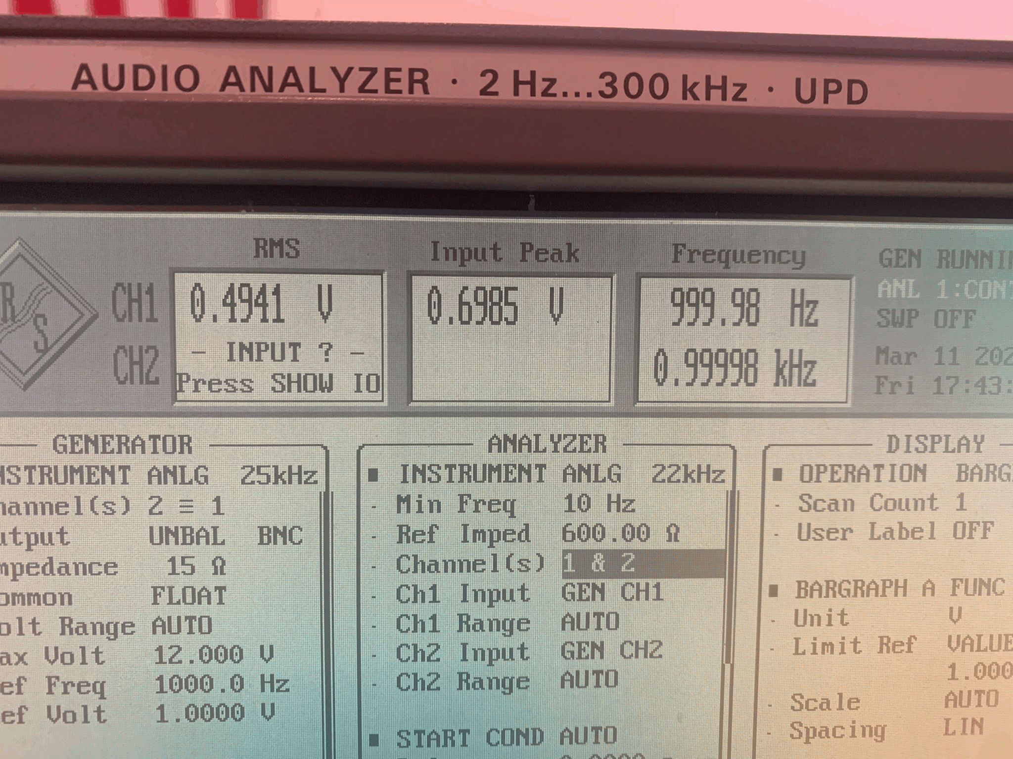

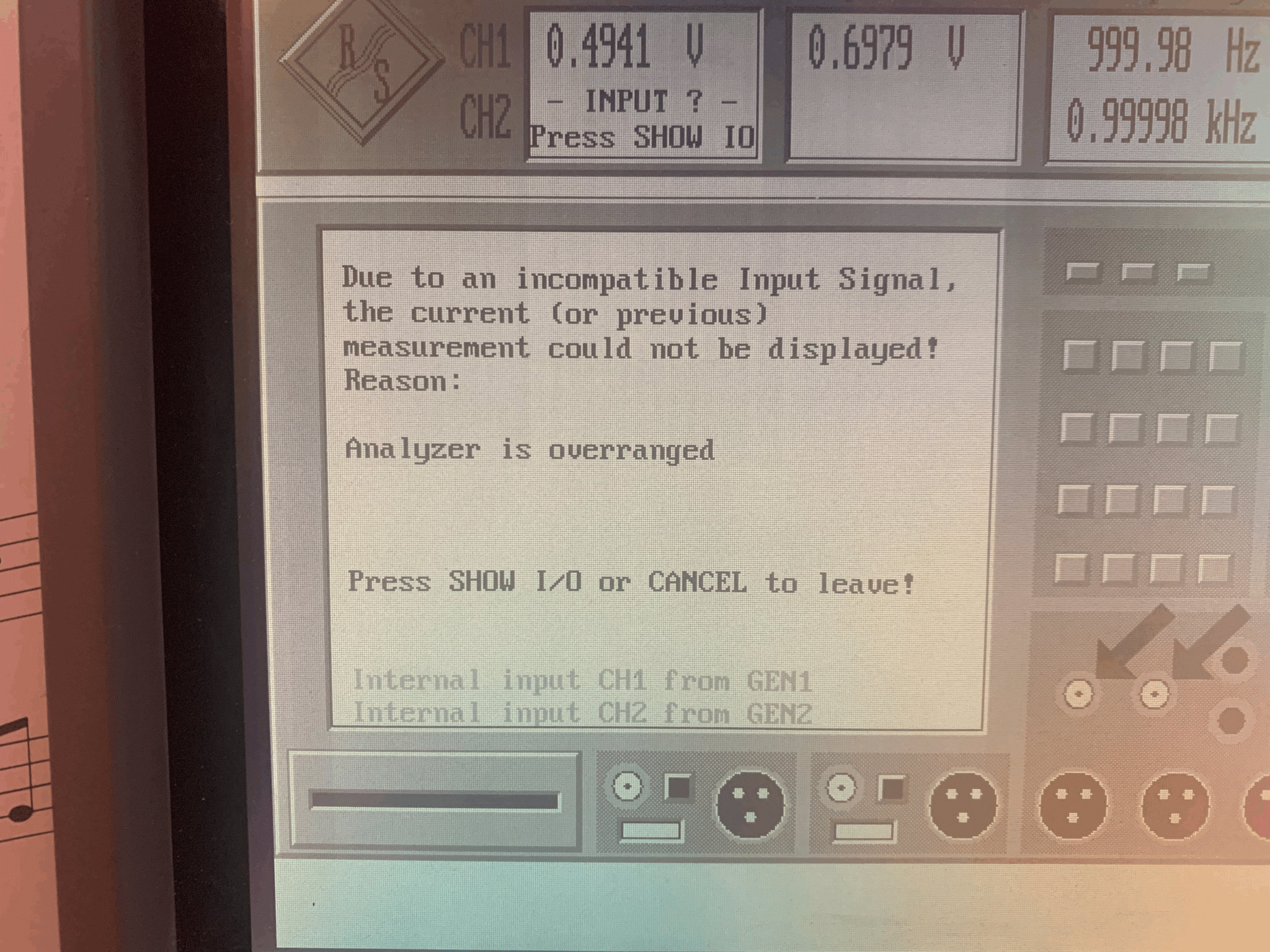

Hello Community,
I recently got my first audio analyzer, its an old R&S UPD (with black and white display), after some setup huddles everything now seems be working fine except that one of the analog analyzer card always has overrange error status no matter what setting I tried.
Does anyone have an idea what could be causing this problem and how to fix it.
I will appreciate any suggestions

I can’t imagine that the input stage would be too much different from the UPL, maybe use the schematic as a starting point? If the other channel is working you could use that to compare voltages etc.

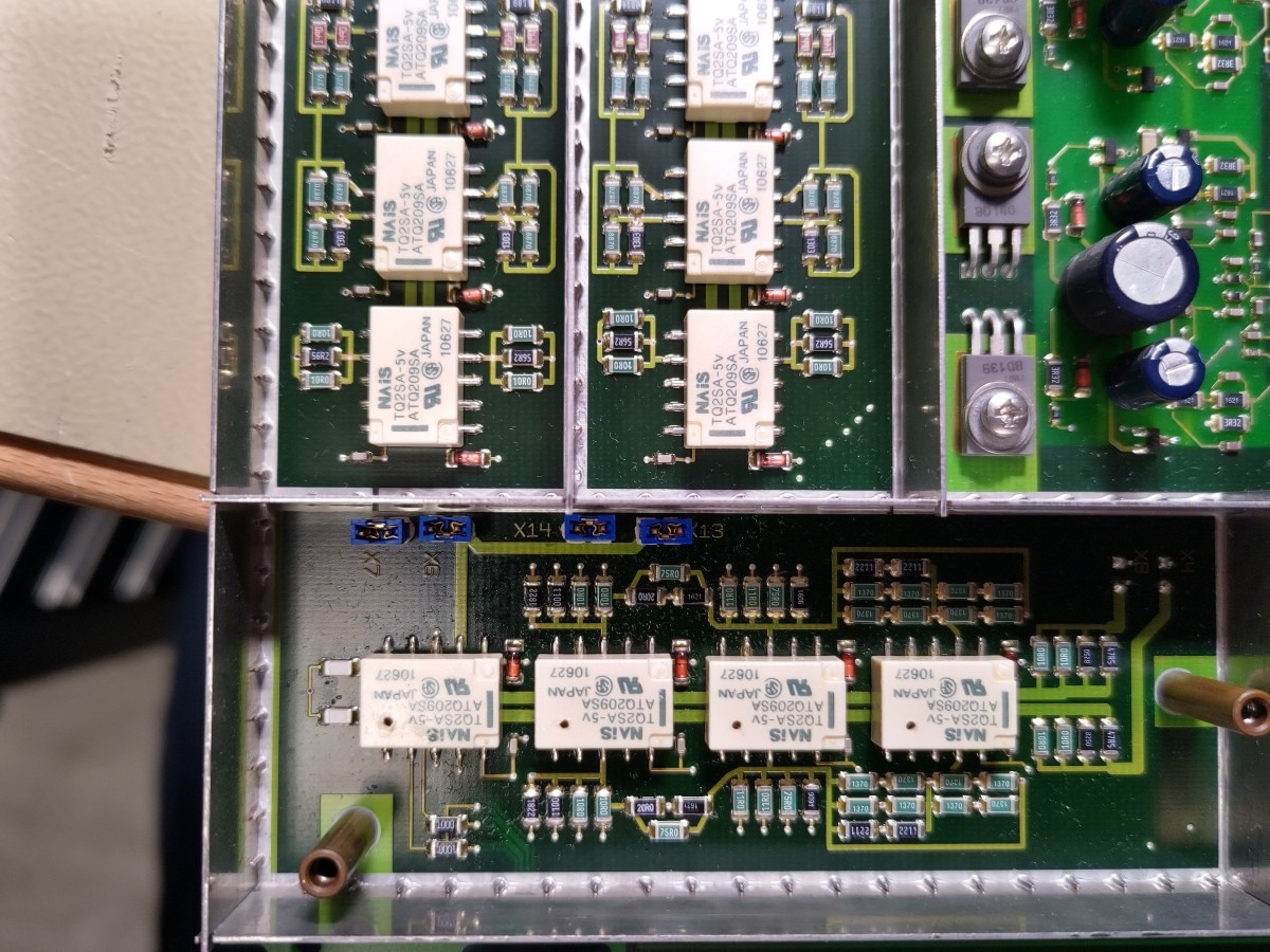

Maybe an UPL expert can help me to identify which part may be defective:
After some days of normal operation my UPL Analog generator in Mode "SINE" or "MULTISINE" stopped working in "AUTO" output level mode. If I set "Generator / Volt Range" to a fixed value the output level is as expected. Otherwise it is 42 dB higher as expected. E.g. SINE set to 0.003V output level I get 0.381V RMS - factor 127...
BR, Toni
Joined 2011
Above problem solved - one of the generator output attenuators failed - see attached pictures.
There has been a repair try - left picture you can see holes in 4 relais. The right one hang in "ON - position". The generator output voltages have been to high.
The relais have been filled with oil-like fluid. Never have seen such a "repair" method. Old Oil tends to be loose viscosity...

Of course replacement preferred. The relays are hard to get. Hopefully the TQ2SL-5V are working as replacement for the TQ2SA-5V. Specs look similar - only case is a bit higher...
If someone knows different replacement types for TQ2SA-5V please let me know.
BR, Toni
For replacing just several pieces - I use regular THT relays and just bend and shorten the pins, e.g. https://www.diyaudio.com/community/attachments/20210126_183700-jpg.915498/ . There are a number of relays in that same footprint with THT - e.g. A5W-K, TQ2. Otherwise TQ2SA-5V are readily available on ebay (presumably new, e.g. not from China https://www.ebay.com/itm/144222633912). I have used ebay-sourced signal relays for prototyping, never had any problem.
