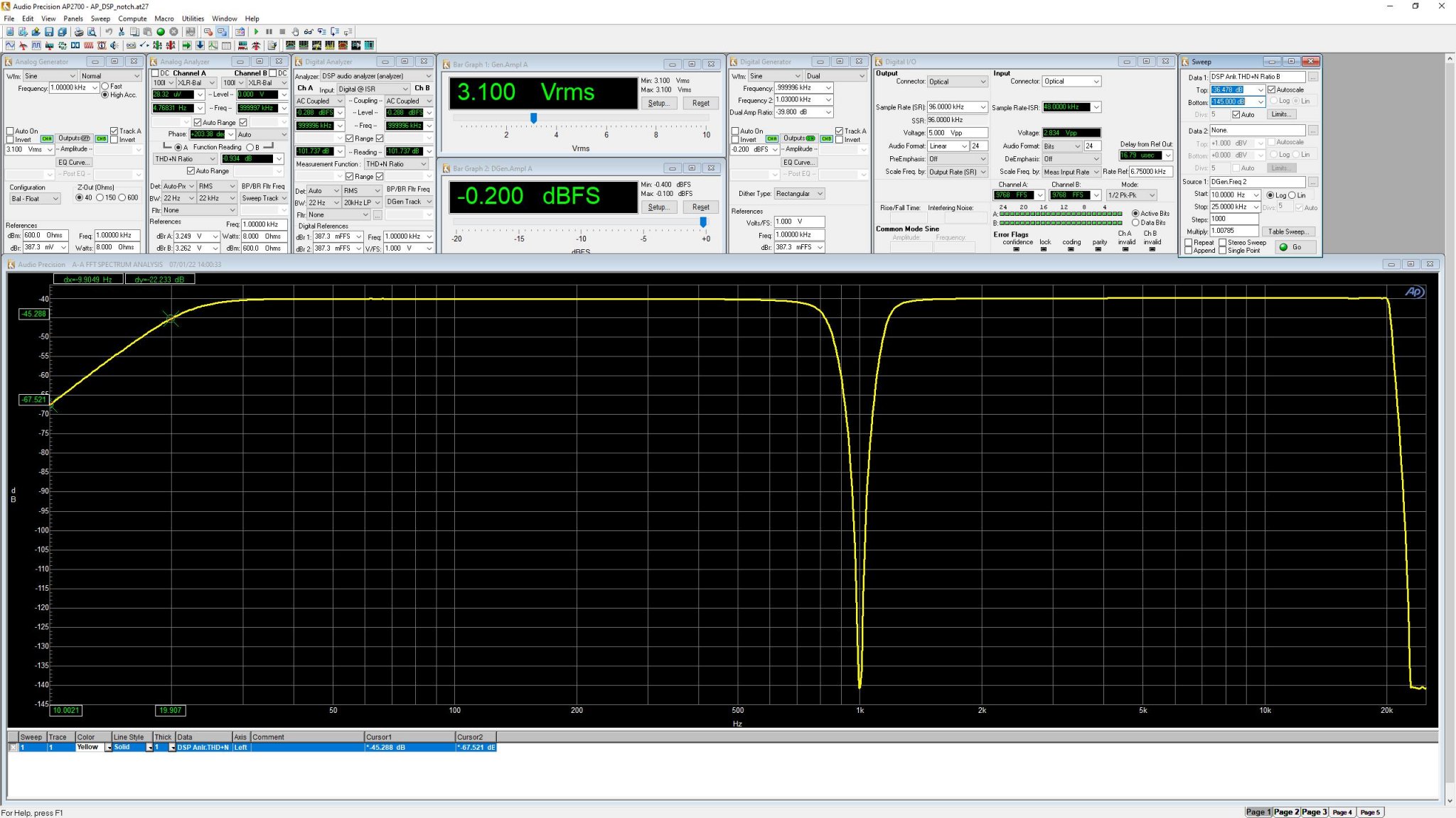

I made some tricky test to disclose the AP's DSP THD+N analyzer notch and BW limits. It looks a bit strange to me because 20k BW limit seems Butterworth 64ord(maybe FIR) but 22Hz BW limit is Butterworth 4ord. The notch itself isn't simple ignoring out of H1+/-40%(like REW does for instance) but rather a close copy of AP analog analyzer notch. Could you please perform the same test at R&S to see how they handle BW and notching H1?Assuming that the analogue spec for the UPL-B1 is the same as the UPV-B1 (which it is, to my knowledge - despite claims to the contrary), then the loop-back 2VRMS @ 1KHz 20-20K THD+N for the UPV-B1 is -113dBV. My SYS-2722 gets -115dB under the same conditions. If I feed the 2722 oscillator into the UPV inputs, I get the same -115dBV THD+N.

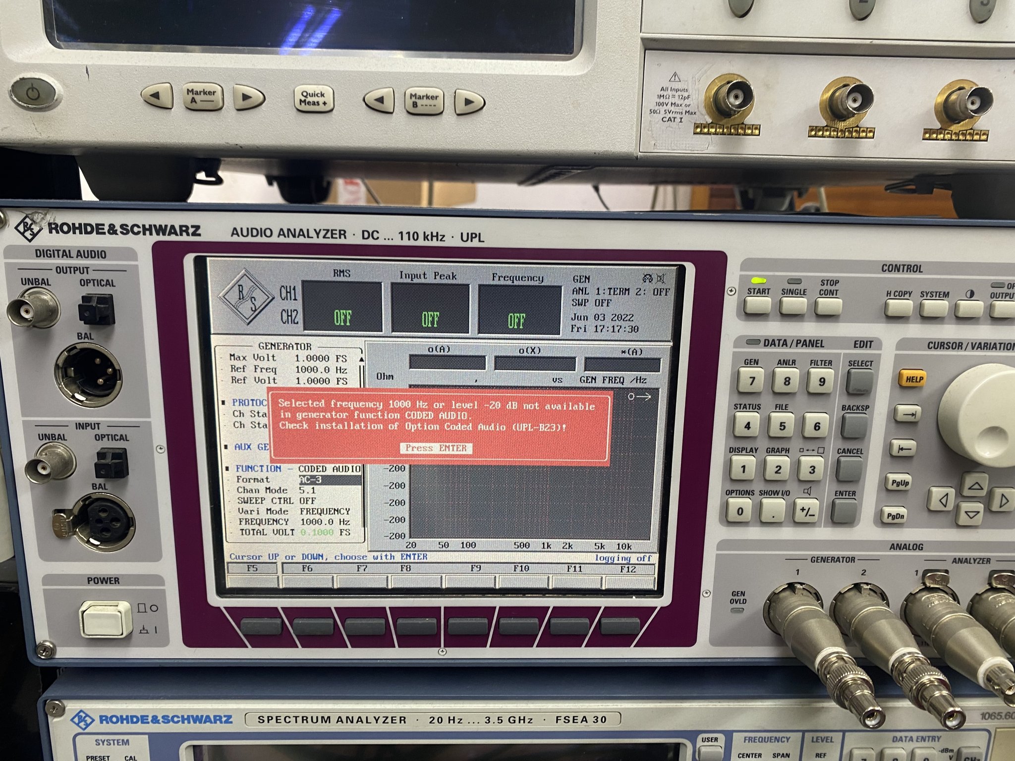

Hi,HELLO GOOD AFTERNOON EVERYONE, COULD SOMEONE HELP ME WITH MY UPL, I HAVE INSTALLED THE B23 BUT IT GETS ME AN ERROR BECAUSE YOU HAVE TO INSTALL SOME FLOPPY DISKS AS THE MANUAL SAYS
Maybe you can reinstall the UPL software disc 1&2 provided at the first page of this topic, this may solve your problem.
HI, is your issue with activating or using the option? Can you share a picture of the error message? Thanks, BartGood morning, thanks for your response, I already tried to reinstall the disks and I still have the same problem
Hello, I was thinking that your system might be not installed properly but if it is not the case then in theory there should be no issue related to the activation of the B23 as long as you have the key to enable this software option.
Can you write the error message you are getting?
I have replicated the same problem on my side. I also think we need the supplement software for this option. Or I'm using it all wrong.thanks for your answer, if I have the option activated, the message that comes out is the one in the photo

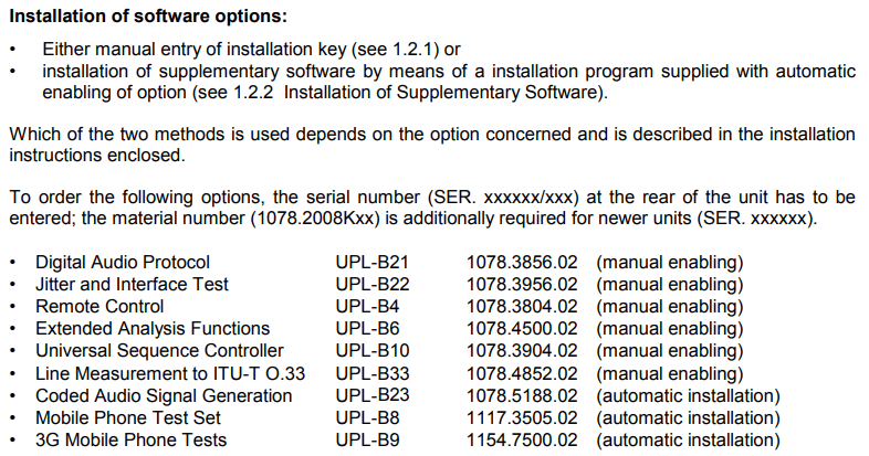

When looking in the manuals I also find a reference to software for B23. If anyone has this supplement software or knows contacts at R&S, feel free to share.

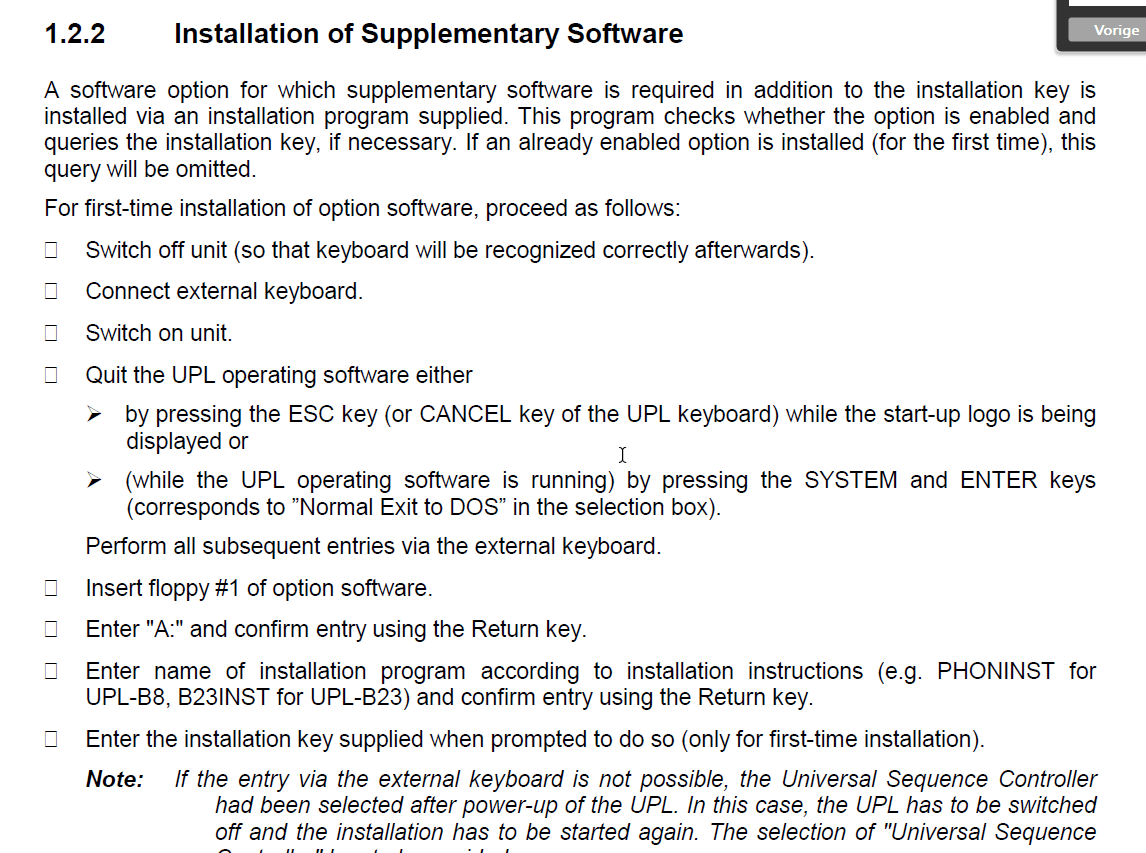

If I already saw in the manual that it says that you have to install some disks but it does not explain it very well, if you go to disk 1 you will see that there is an exe called compress.exe in the tools folder, according to the manual that program is to convert sound files to be able to use them in the opt b23, my question is, if this file could be the necessary files for this option b23

So indeed there is an installation disk for B23. I just requested to my local R&S agent in Taiwan but I am not sure if I will be able to get it as I understood that the B23 installation disk is also enabling the B23 option, which means quite certainly that they will refuse to give it to me if still available and I don't pay for the option. Let's see, anyway I asked already...

NVM, I emailed R&S and they sent me a copy of the filesHi,
