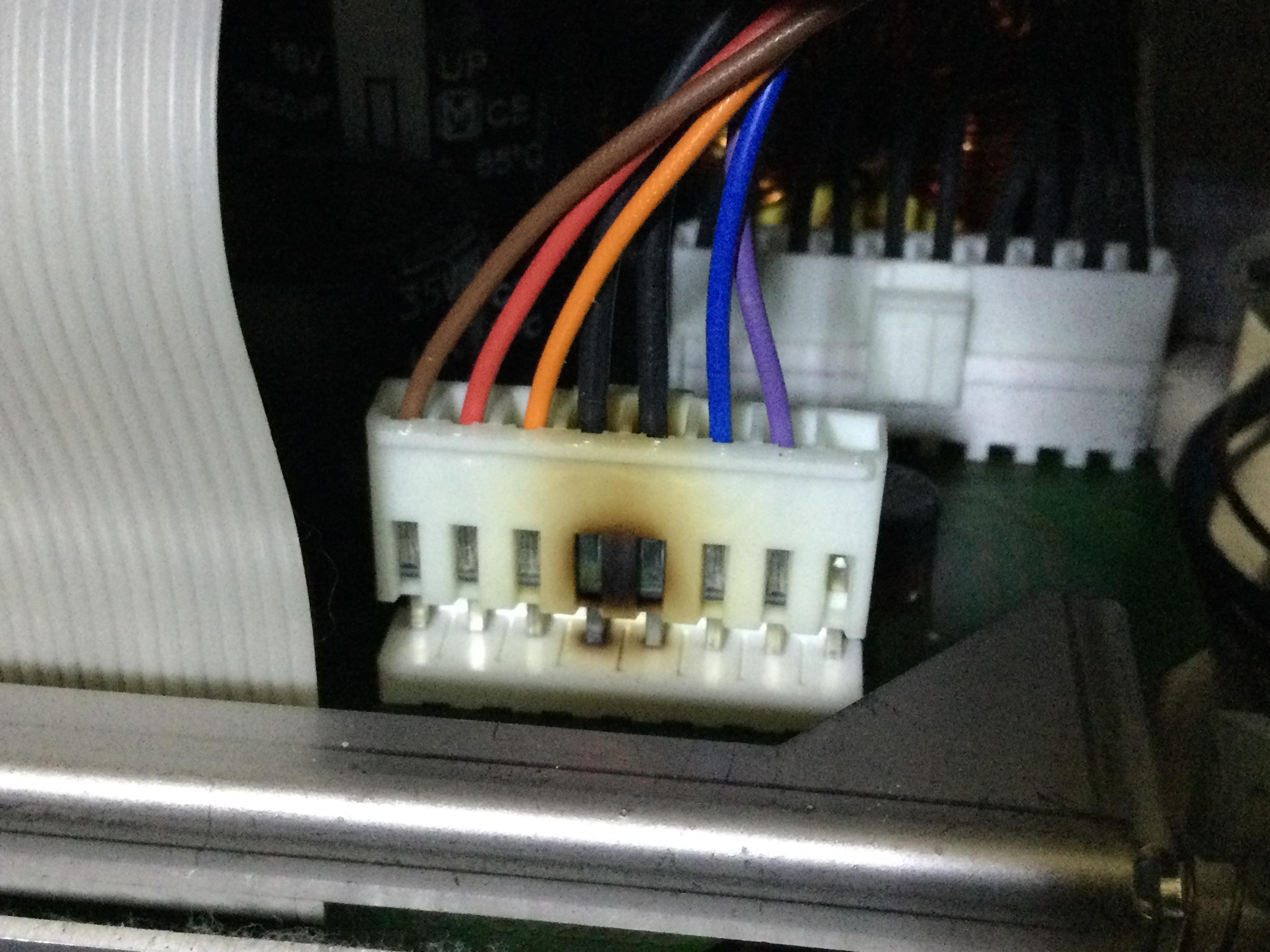

A new problem UPL

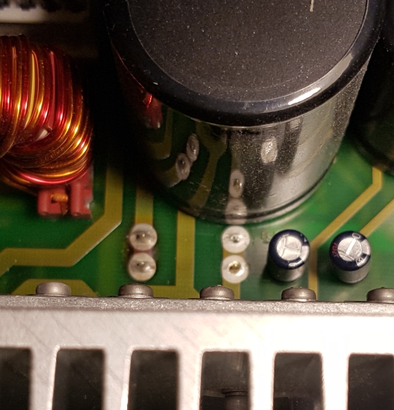

Gentlemen Techs,
I just have received a cosmetically good later UPL, the unit powers on, the fan and LCD come on, but it’s an empty WHITE SCREEN. No boot, no beep, nothing. There is a burned connector in the middle of the PS Board. Has anyone removed the PS Board to check fuses (9) and regulators (10) and cap ESR of the many 24 yr old caps on the main filters before and after the various Voltage refs on the heat sink?
Suggestions on what to do and not to do first!
I suspect the +5 is out, but there are so many voltages, it’s gonna be a tough dog!
Thanks,
Steven

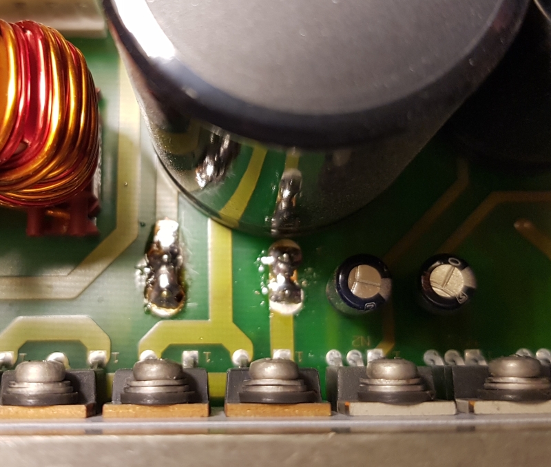

Hello Steven ,
I had a similar problem in my UPL many years ago . By using it , there was smoke on the left side of the unit . The 5V/5A fuse holder was desoldered and the pcb was burned .
I installed a new , better and stronger fuse holder and resolder parts in the power supply and the UPL is still working .
Kind regards , Alexander .

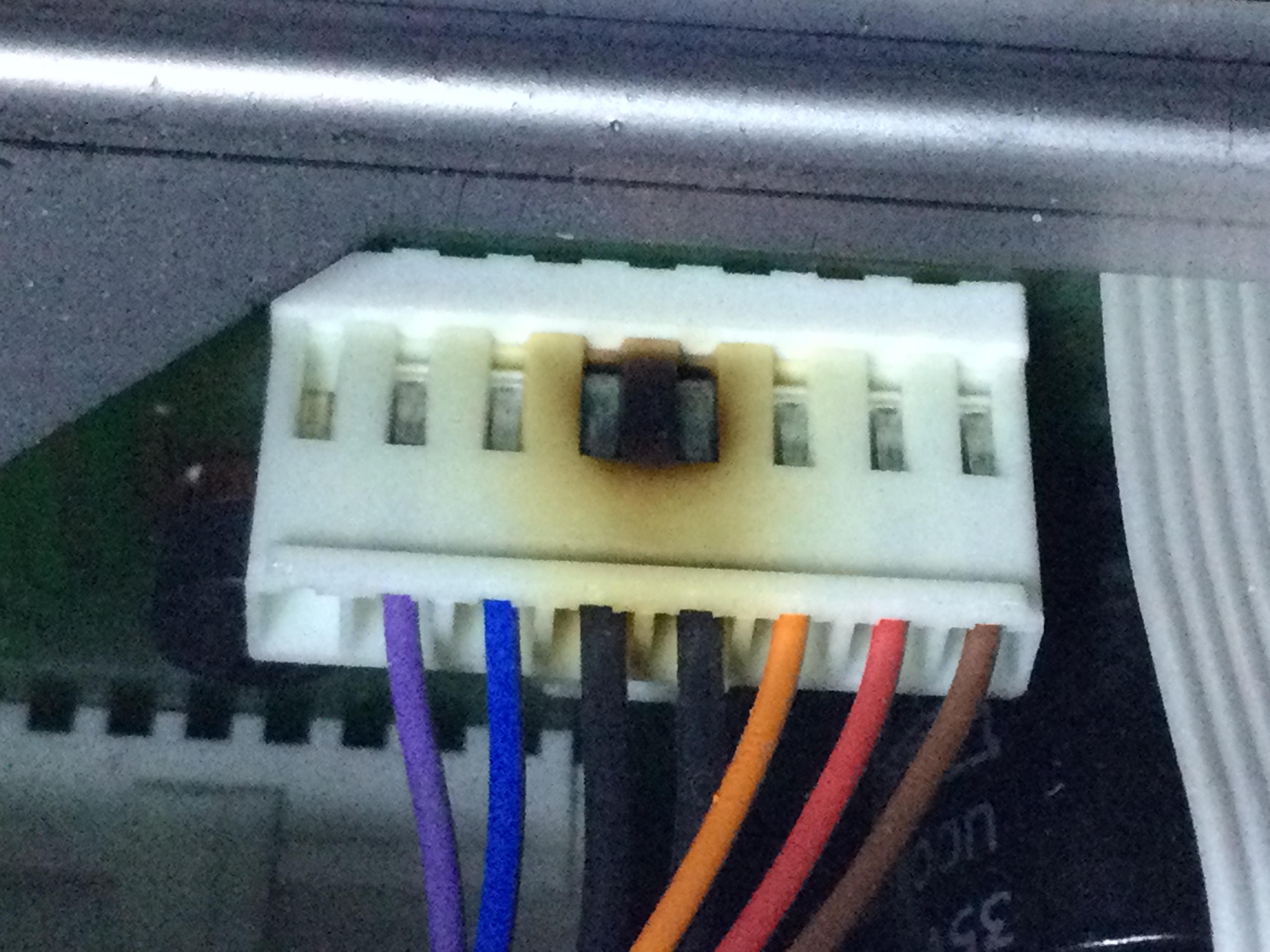

It seems that the burns here are at the two ground wires, yes this set is full of boards, but no other items seem burned (at this point).
Steven
I would start with checking the power board for any anomalies (fuses or rectifiers that are damaged or loose) and any regulators that are getting too hot.
Replace all questionable components and make sure you get your stable voltage rails and start from there.
If things still get hot, unplug the PC, hdd, analog board and build your way up.

Unplugging the hdd is a good start as you should always see the bios screens. Additionally check with an external VGA monitor for any activity.

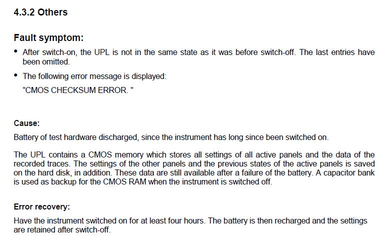

Steven if your UPL is like the UPD, somewhere in Ch 4 troubleshooting
that R&S Doesn't include to the general public, it states the battery in the
black container that is wire wrapped and velcrowed to the chassis, if it is dead,
the unit will not start up.
Find, open the case, order a new battery of the type listed.
It might help. Or this from the UPL Manual, lte it run up
for four hours if the battery died (i.e. no run up).
After you fix the burned out connector.

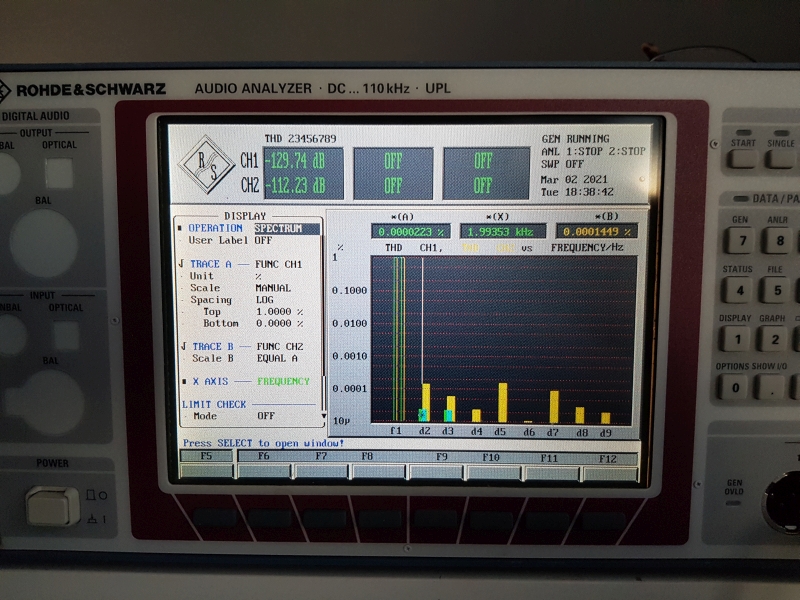

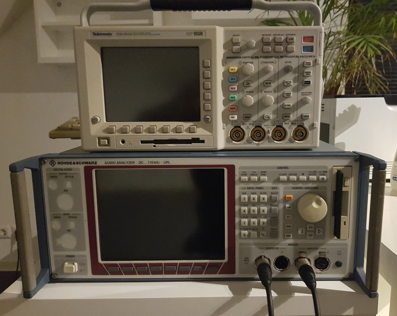

Hello ,
yesterday I got an UPL and a scope from a friend . The UPL is in very good optical condition but channel one is not working in the correct way . Signal is distorted and fluctuating . Input relay with bad contact ??? and which is the right one , K3 ? On the analog/analyser pcb are no designations for the parts .

Hi Alexander,
First thing i would check is the selftest, if you are able to run it, it requires the B10 option.
Perhaps there you could find more clues to what search next.

Hello Bart ,
thank you for your answer , but the UPL made a selfrepair 😀 . Very important is , to resolder the fuse holder from the 5V / 5A fuse . I had smoke from my older UPL and it was the fuse on the pcb .
I measured channel one with the Victor 1khz generator and channel two with the UPL .
Kind reards , Alexander .

The 5V fuse holder is a place of excessive heating as I posted a while back.
Having some extra solder will help a bit more with dissipation.
My suggestion is also to replace the glass fuse with a ceramic one. Just in case.
