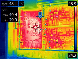

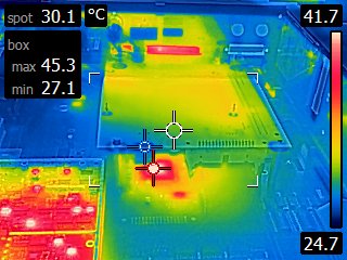

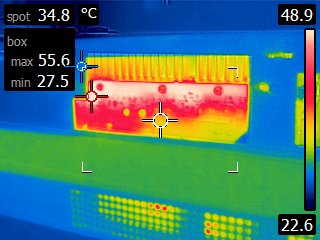

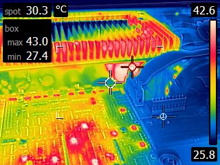

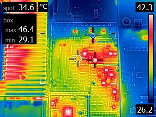

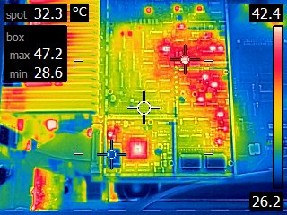

First of all I would like to thank for this thread, especially Bart for the job done and the sharing, this is simply amazing and motivated me a lot to buy one UPL.
I found one in a refurbished equipment shop in Taiwan with options B4, B6, B9, B10.
I was a bit worry when trying it at home as one channel was showing weird measurements, so I disassembled everything, made a deep cleaning and found out that my XLR on the analyzers were having very dry solder joints and broken with an average contact. Few soldering later the UPL was working perfectly on the 2 channels. I took the opportunity to change both fans and on the way to replace the HDD by a CF card, thanks again Bart for the tutorial here.
So this is to give some hints on my side, if the input signal is not stable or fluctuating, this is maybe one direction to look at with the age of those equipments.
Then I was looking as well for the B1 option and without finding it I was starting to look at the schematics to clone it when I found another UPL on eBay broken, to buy for parts with the B1 option. It was a bit of gambling here but I negociated a low price and took the risk.
Happy to find when he reached my place that the only broken thing was the 5V fuse likely due to a misconfiguration of the PC motherboard jumpers as everything was wrong here.
Setting right the motherboard and changing the fuse I got another fully functional UPL.

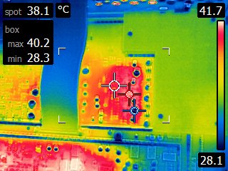

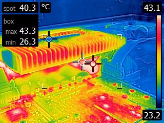

My question here is regarding this fuse. I read that this area is dissipating a lot of heat and I am wondering if the fuse is properly dimensioned as it is the heating source.
The first UPL have a 8A fuse while the second one had a 6.3A, is there any reason for this?
Is it because not all UPL have the same computer / different consumption and then different fuses?
The schematics seems to tell that 6.3A is the right value.
Just to know if some of you have 8A.
Another question is how do you identify the age of the UPL? I cannot find where to read the date.
Last, does anyone have the B5 option schematics? I am thinking to clone this one.
Thanks.

Thanks for your kind words! Happy to help out! Nice scores and repairs btw!
I've added some more pictures of a spare Power supply I have showing the fuses in detail.
Additionally the B5 option schematic is not in the service manual, only the part list is there. I have taken some detailed pictures of mine as a starting point. But having a schematic would definitely be interesting!
B5-Audio Monitor - Google Drive
Power Supply - Google Drive
All the best!
Bart

Right, as promised. Newer thermal images
These are looking down at the DSP board.
Please NOTE this is the newest version /w 300MHz board.
One disadvantage of this configuration is the DSP IC getting pretty hot after 10 minutes. On previous revisions with the Pentium CPU, the processor cooler was indirectly cooling this DSP IC as well.
Can be addressed by using an IC and a side vent fan.
The digital board option I believe it's obsolete, gets pretty hot and draws significat current.
Component side of the PSU is marginally hot
Not sure it is worth having it installed.
Bottom part, representing the Analog stage (Analyzer) and back side of PSU.
Things get hot here as well.
