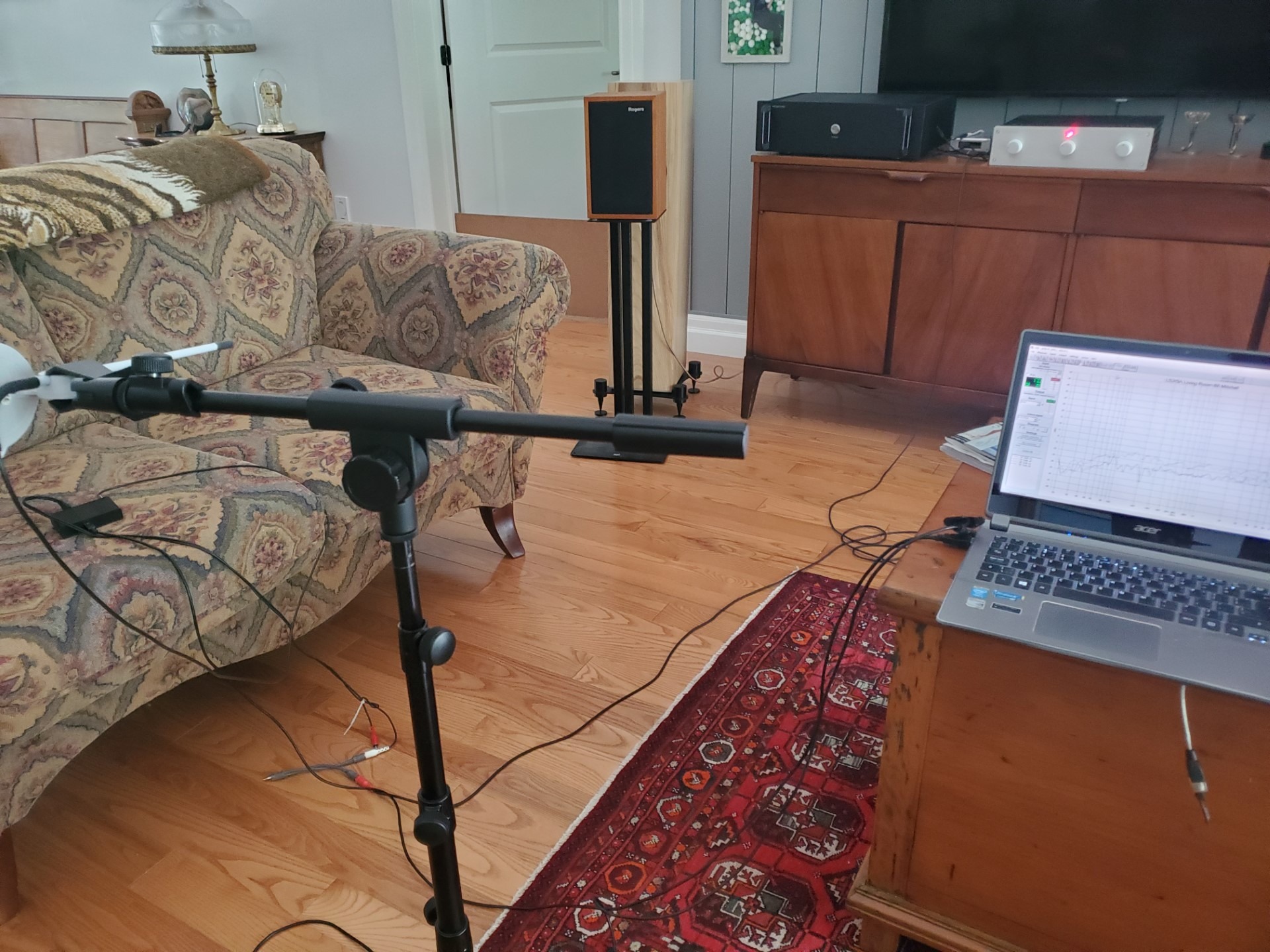

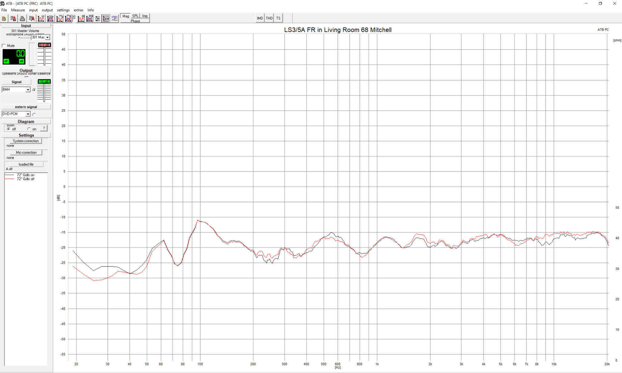

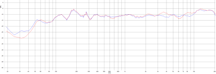

This graph is for FR at 72" on tweeter axis with 1/6 octave smoothing. Black is with the grills on, red is grills off

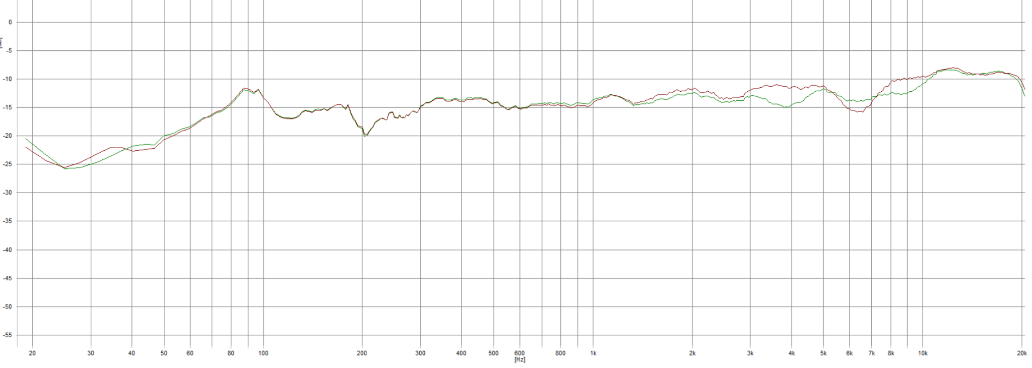

Yep, green has less diffraction.
If you could move the speaker in another location like one third into the room and take one at 1m away on T-27 axis it would also be interesting as to how much the room differentiates the bump. Now the couch could be absorbing some upper bass energy. If away from it that may change a little.

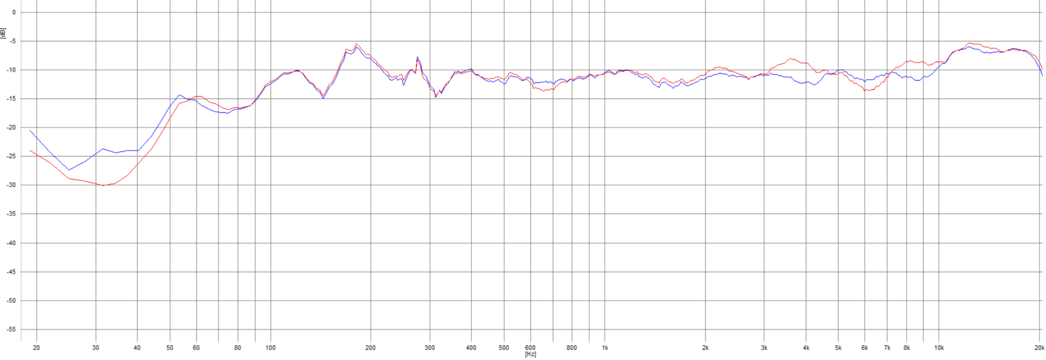

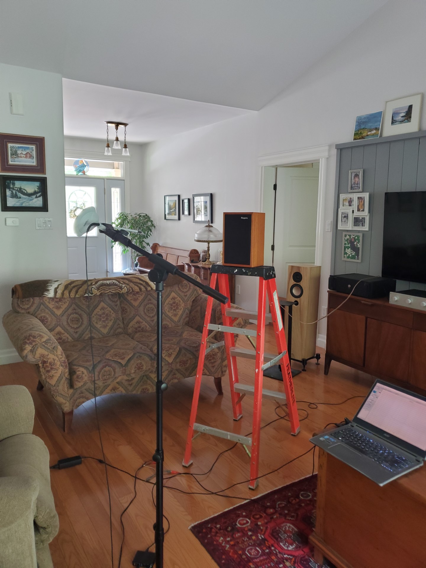

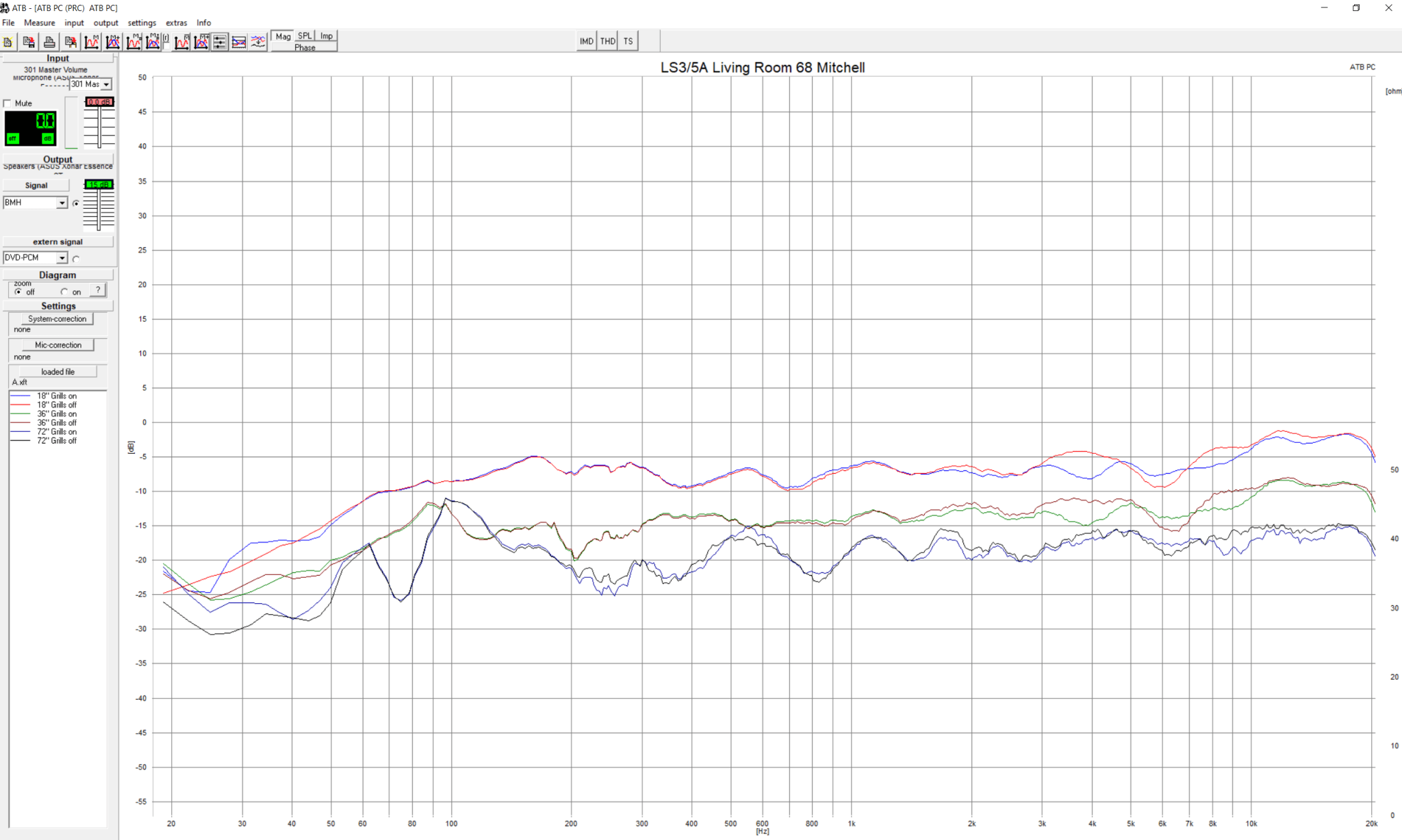

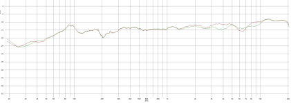

On ladder and moved into the room. 36" on tweeter axis. Huge improvement with the grilles on.
Now I'll have a good listen(tv) tonight, grilles on of course..

@ Joel Wesseling: could you make high resolution,single point, 1 meter 5dB div measurements of the woofer and tweeter separately? This will require disconnecting.
Notwithstanding the BBC pedigree, so far I have not seen different make LS3/5A measurements that were very similar. So I am curious what yours look like.
