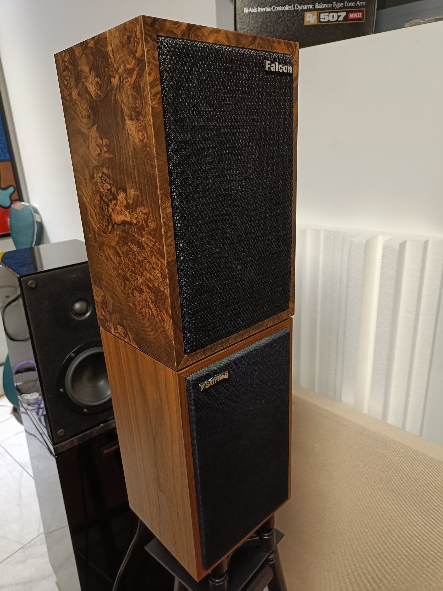

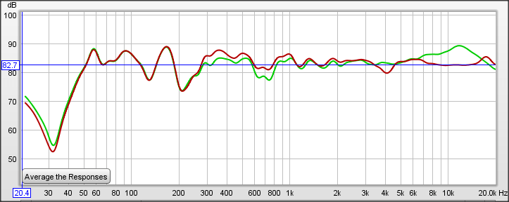

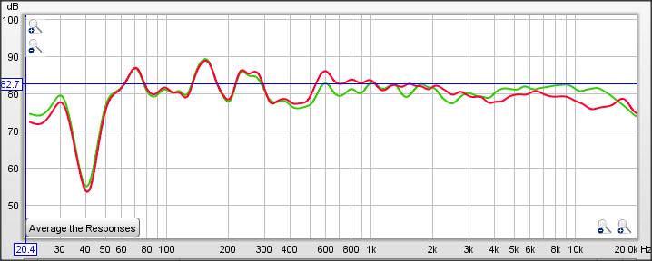

Some measurements I took at a friend's rather small listening space today. Between Falcon Gold Badge and Stirling V2. First graph is for single speaker with mic at one meter distance at tweeter height. Second graph is for a pair of same version speakers playing with mic at two and a half meters distance listening position at ear height. Green line is Falcon, red line is Stirling in both graphs. Grills on in all cases. Smoothing is per one sixth octave.
In a small room any REW, ARTA etc.etc. measurement below 1000 Hz is highly unreliable. Get the speakers at least 2 metres from the nearest surface and try again..
Oops, meant to say :could you redo the measurements with at last 2 meters from speaker to nearest surface?

Certainly up to 300Hz those curves match perfectly, thus the room is fully dominant in that range. Although I didn't get the chance of measuring them in my own space and leisure for making better arrangements, we can still see how they deviate in higher frequencies. In other words circumstances and time allowance were poor to properly characterize the two speakers individually but able to see how they differ when all other things are equal. I also later noticed that my stereo pair curves generally follow the Stereophile room averaged trends for the particular LS3/5A editions. Mostly above the first few hundred Hz.In a small room any REW, ARTA etc.etc. measurement below 1000 Hz is highly unreliable. Get the speakers at least 2 metres from the nearest surface and try again..

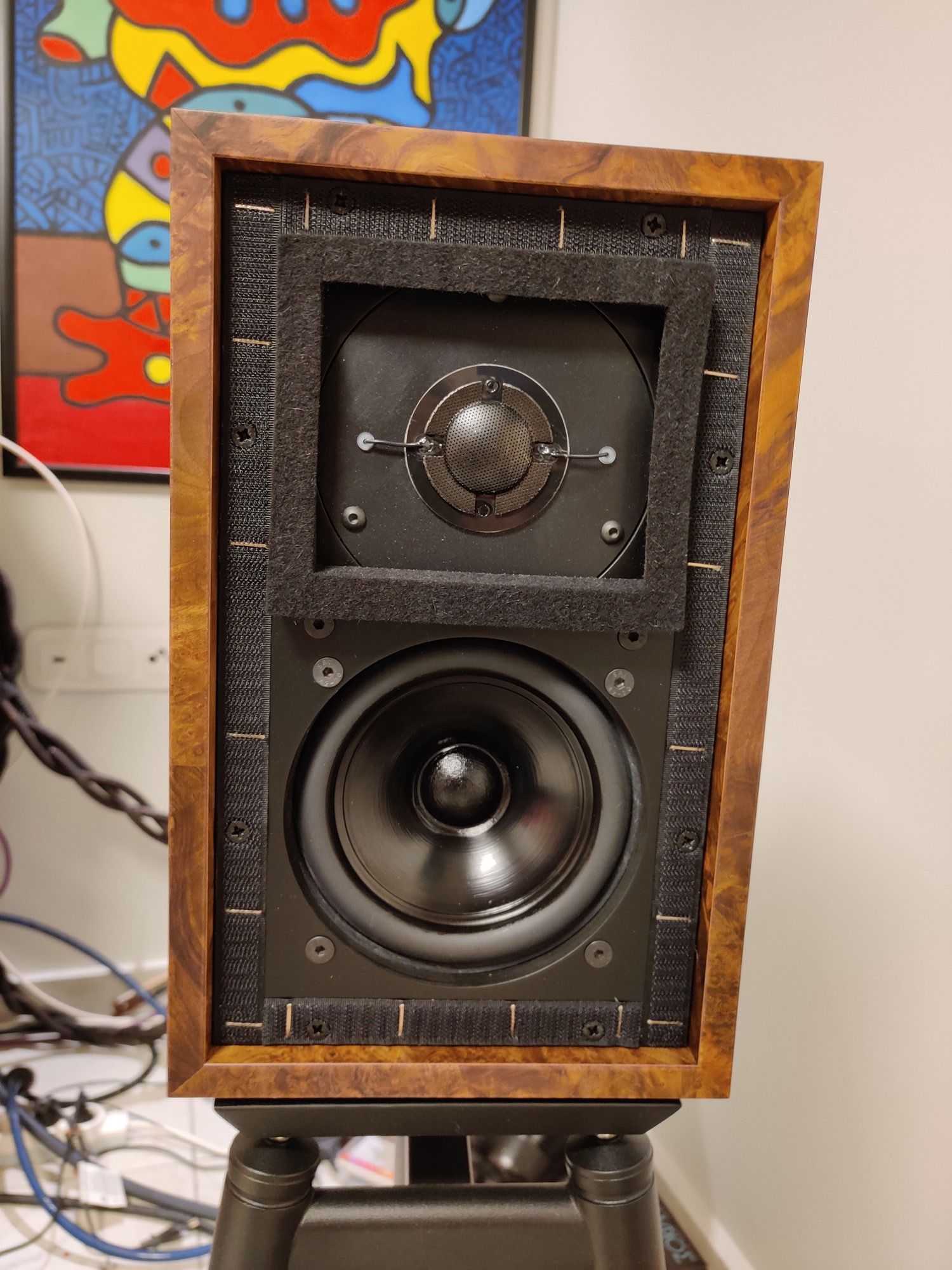

By the way, here's a picture of that Burr Walnut Falcon with grill off. The tripod stand that it sits on is Italian, Solidsteel brand.
Unfortunately no. The space they belong to doesn't allow for that. Maybe in springtime with long cables in a small yard located next to that mancave.Oops, meant to say :could you redo the measurements with at last 2 meters from speaker to nearest surface?
Does anyone here know what cone that Falcon midwoofer uses? It looks like a coated paper job, or is it coated bextrene?
And what tweeter is used? It does not at all look like the usual suspects, but rather like a HF 2000 remake.
