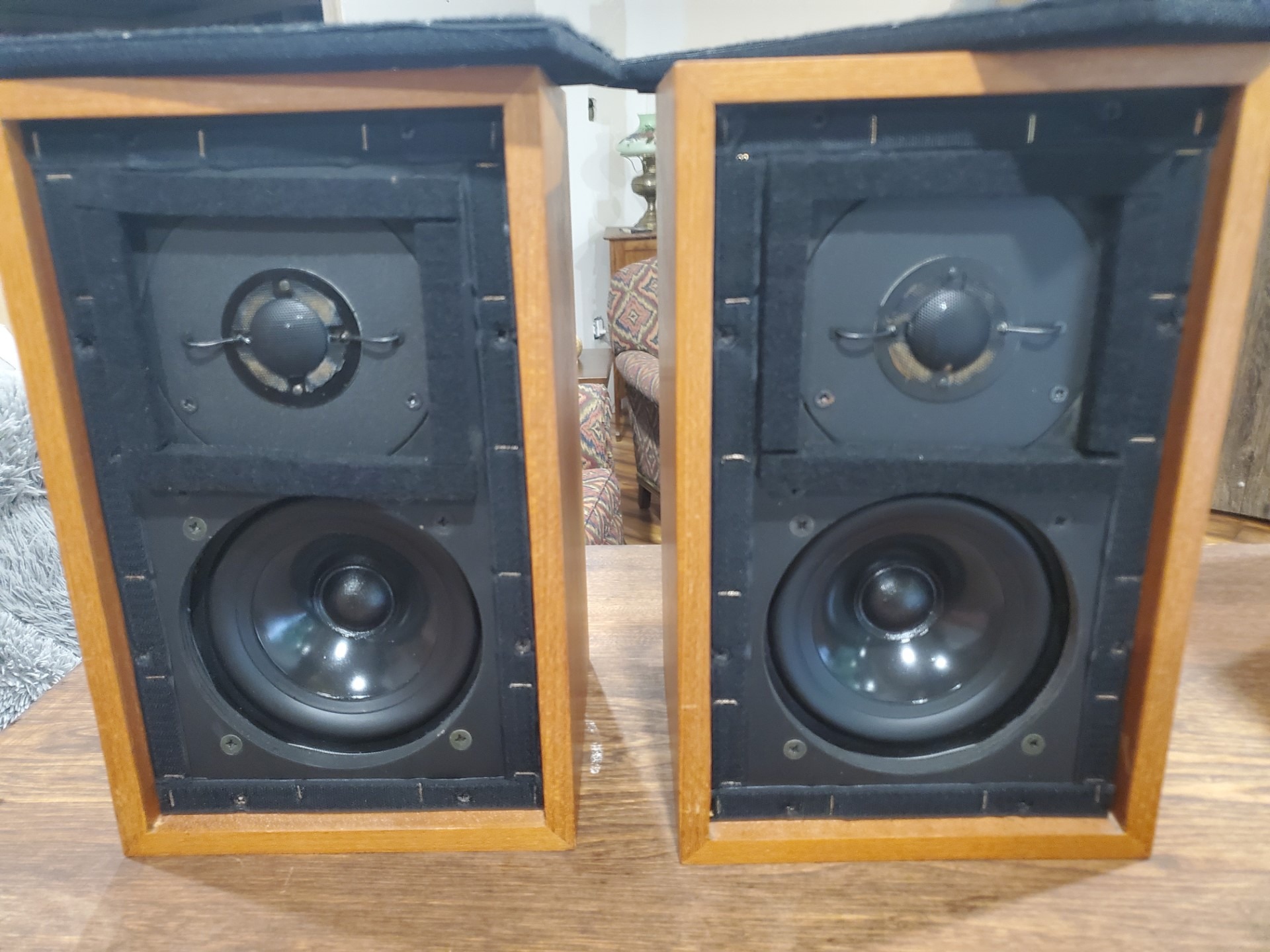

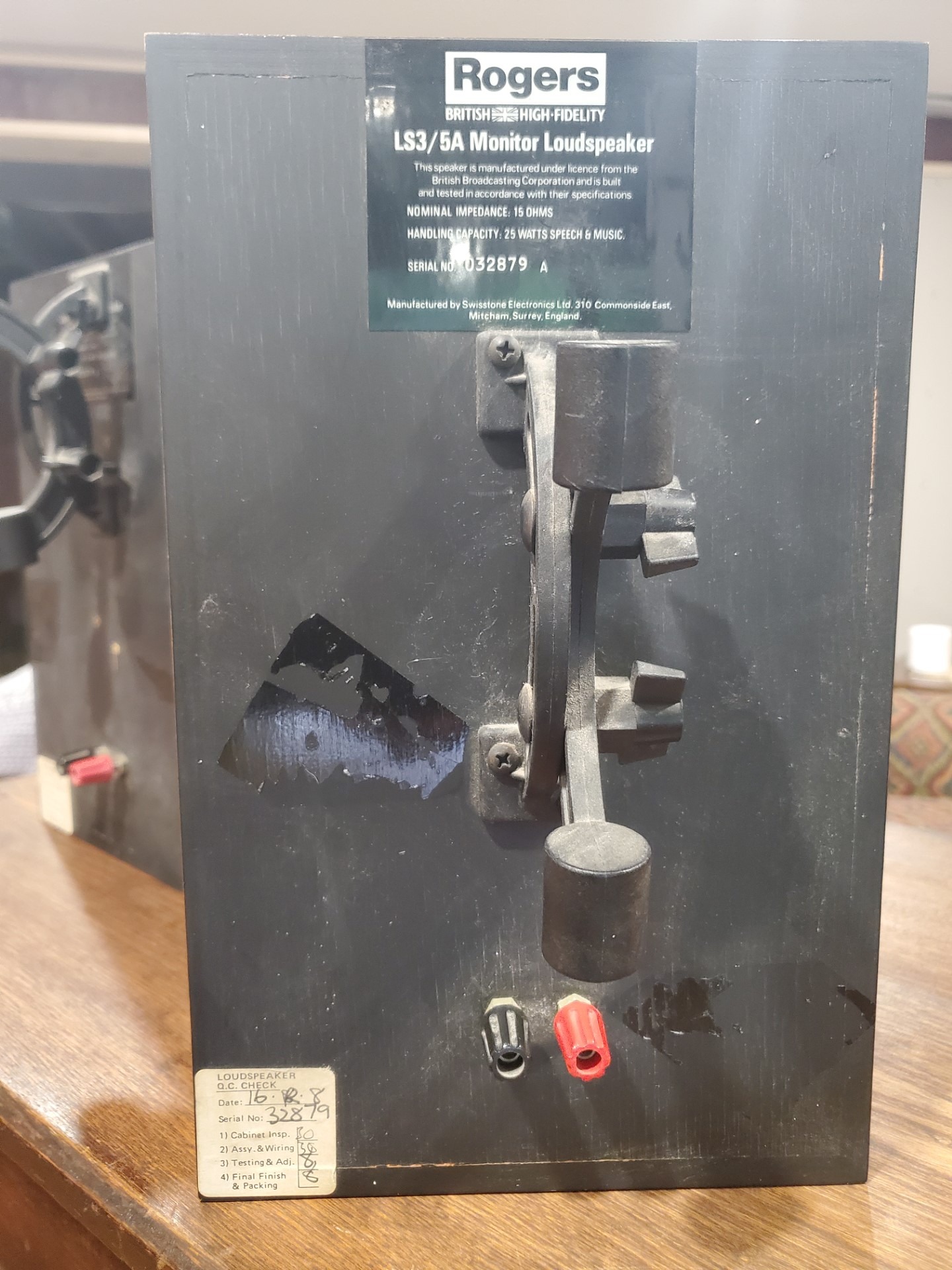

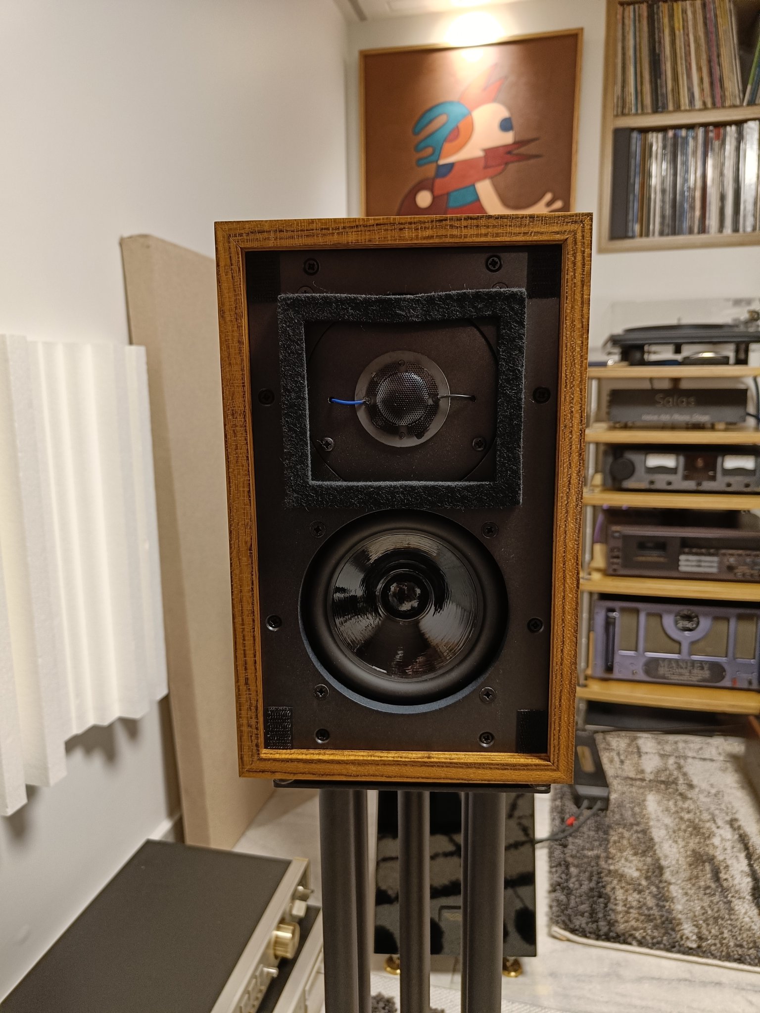

2 days ago a neighbor handed me Rogers LS3/5A speakers along with a Quad 805 amp and pre and FM3
The pieces came from England when He moved here and were stored in boxes for many years
He would like my advice on what He should do with the pieces.

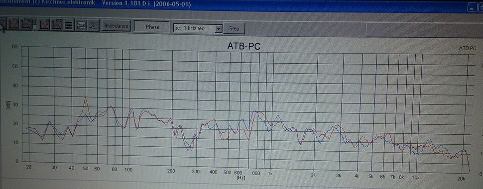

I hooked up LS3 immediately, listened and made some acoustic measurements indoors. Indoor response shaped is upward tilted toward spectrum extremes
They sound amazing and are generally accurate speakers but tilted upward. The bass bump isnt bothersome
Superb detail and smooth. Bass does not color or mask the midrange. Low bass lacking on some recording but not so much on others - Low to medium volume listening.
Could be bias as my interest/passion is cemented in a preference for only direct radiators!
For me these speaker show that accurate speaker designing has not changed for many decades. Marketing concepts of new and different produced grossly inferior speakers through 1980's and beyond.
Conservatively the LS3 sells for $3,000
Planning to integrate these with bass cabinets for active 3ways.. 300Hz cross could work nicely.
Or, I simply build him 3way's as $3k+ will go along way towards that option.. - will see

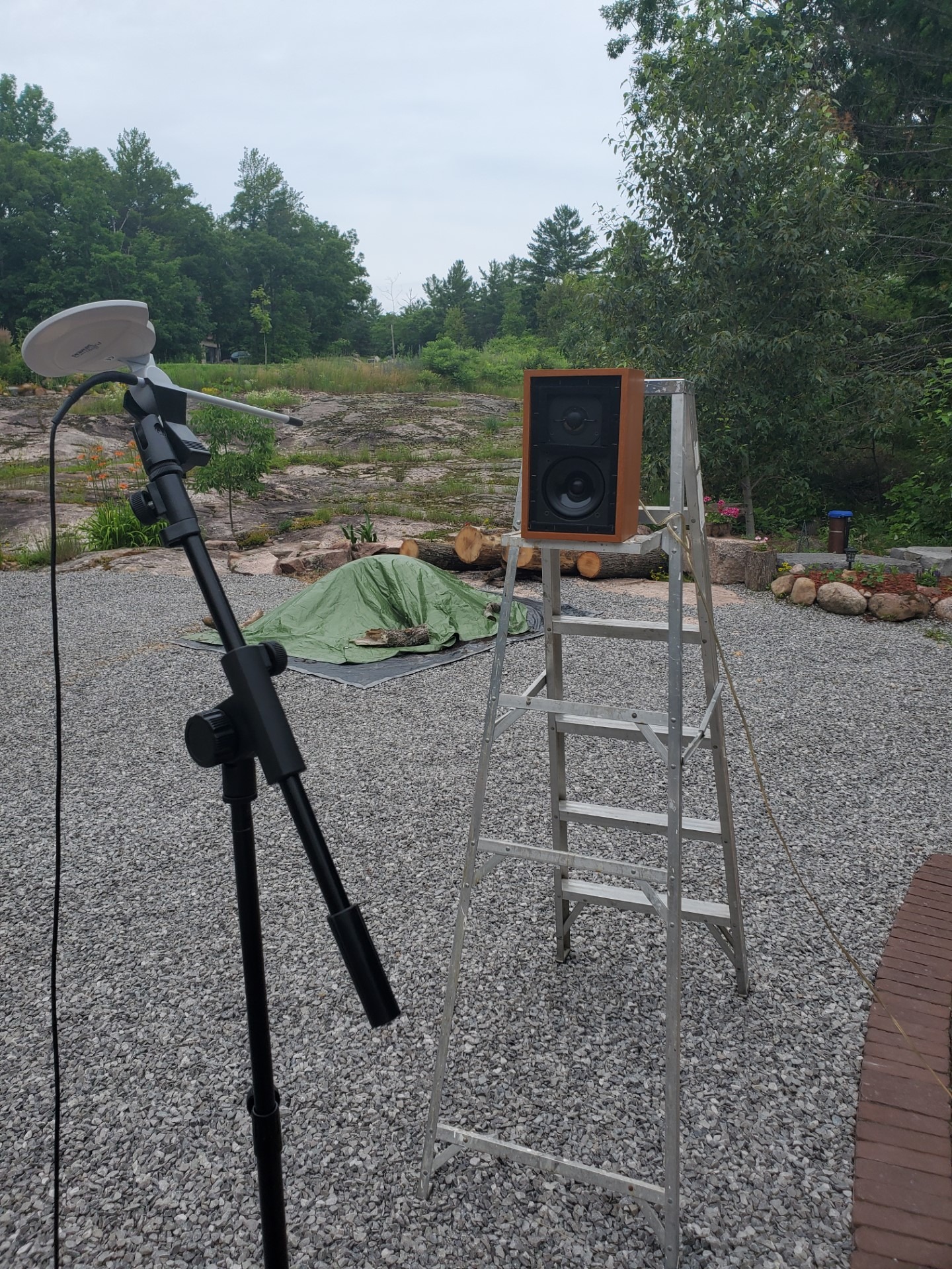

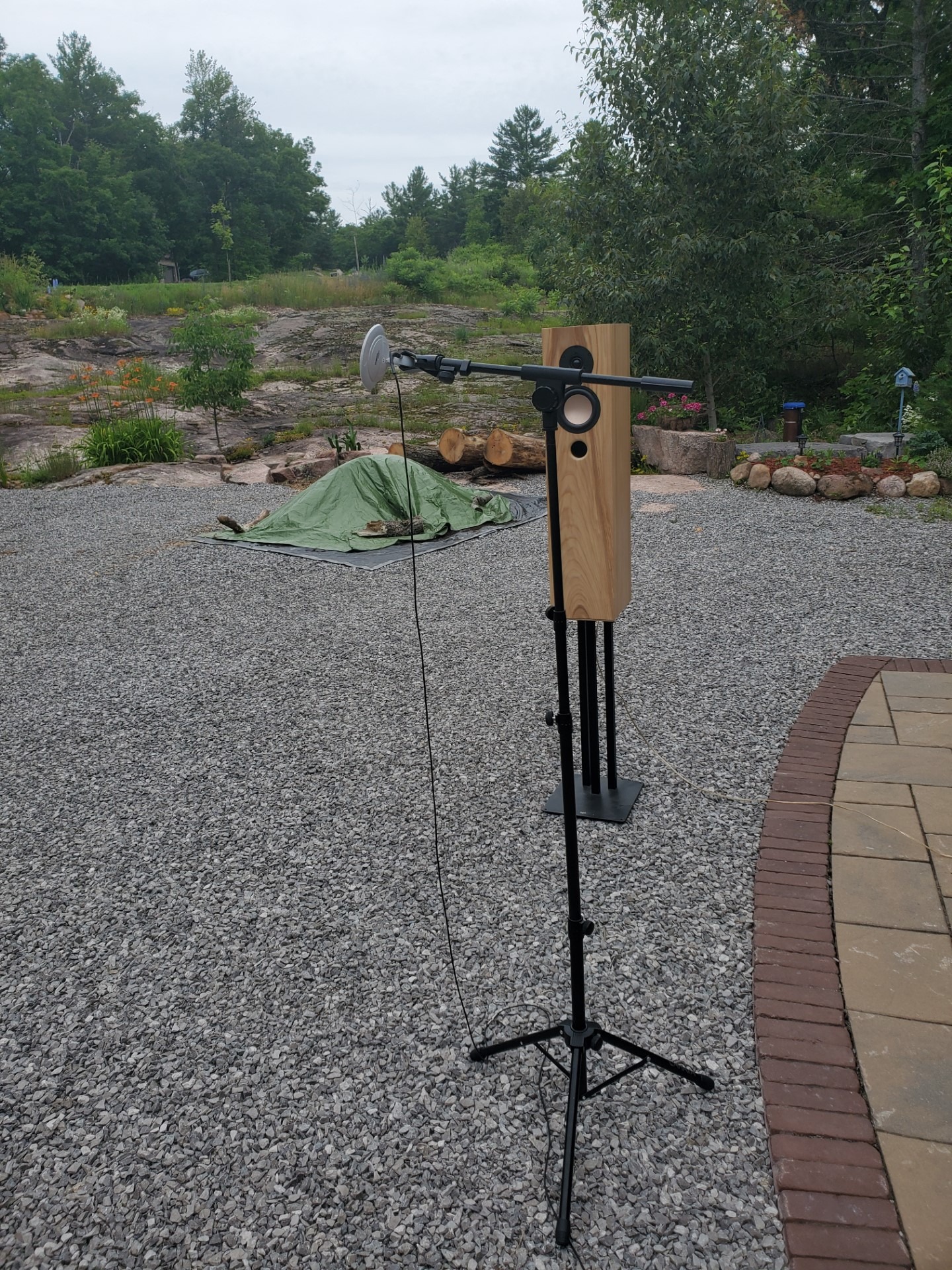

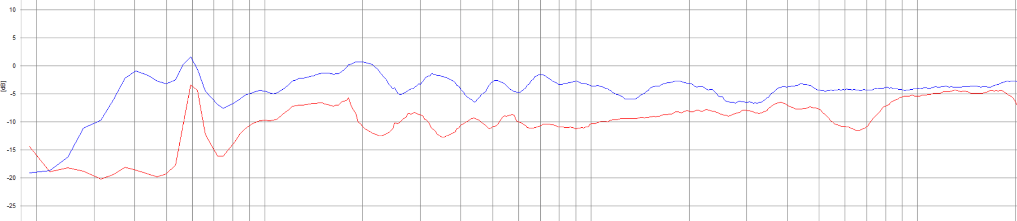

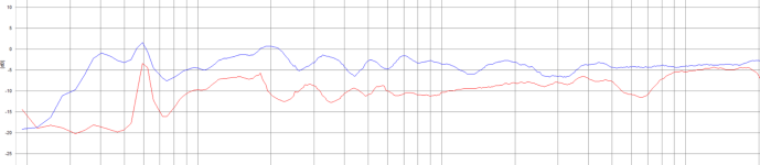

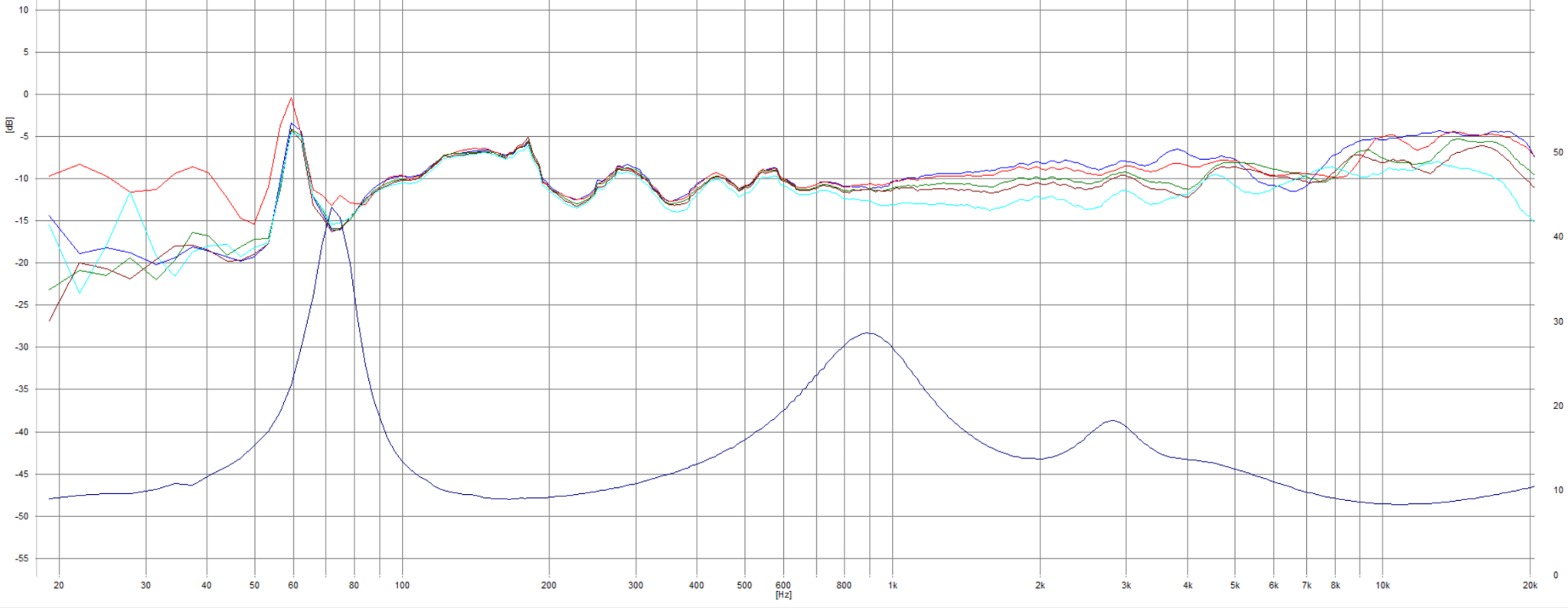

Attached is outdoor measurements along with speakers I built.. LS3/5A with off axis to 45 deg and impedance.. LS3/5A on axis and M5A 2way. M5A 2way has approx same sensitivity. Curve was raised..
Did you save any indoors charts to post?I hooked up LS3 immediately, listened and made some acoustic measurements indoors. Indoor response shaped is upward tilted toward spectrum extremes

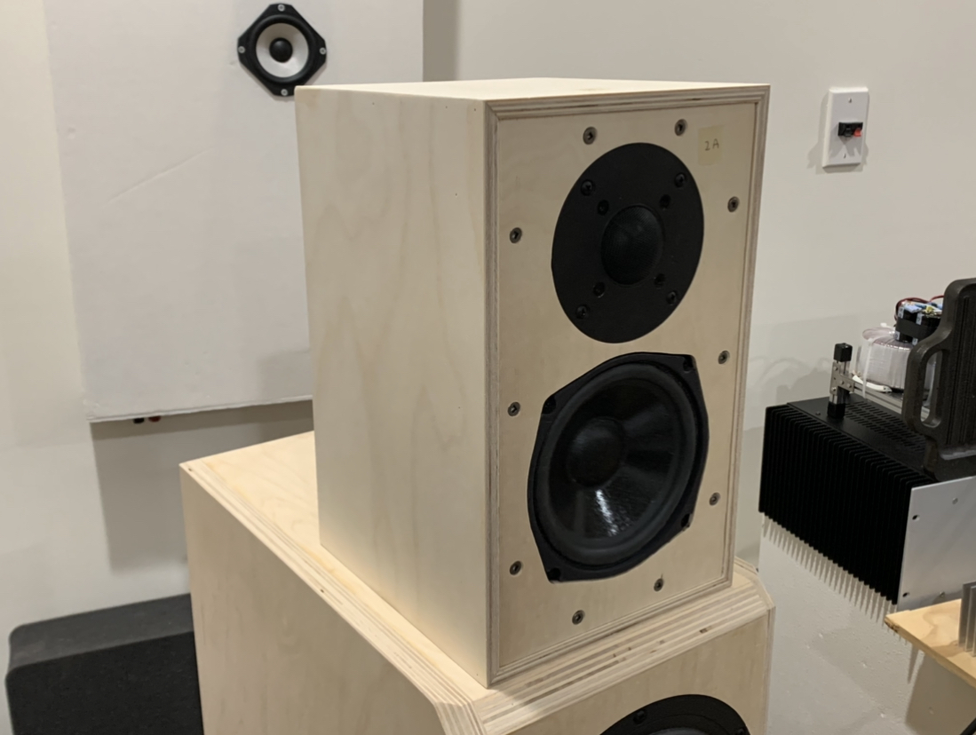

I made an homage to the LS3/5A with modern readily available drivers and my own crossover that mimics the voicing and step response. My cabinet is a tad deeper so a bit more bass.
https://www.diyaudio.com/community/threads/rst28f-and-dc130a-foamcore-homage-to-ls3-5a.359176/
Full plans and build details in thread.
I have also adapted the same drivers and baffle to a TL with bass down to 43Hz. Same XO:
If you add a 1.5in dia x 3.2in long port to the sealed box above, it should bring bass down to 67Hz. Vunce was looking into this.
I will take again this week. They were open in the program, then Microsoft updated my laptop and then poof, gone..Did you save any indoors charts to post?
The majority of licensed LS3/5A I have taken or seen measurements for after the upper bass bump they recess until about 1kHz then keep relatively level but after 5kHz they tend to pick up again. Possibly to counterbalance the trademark upper bass bump that makes them seem bigger. Else they would have sounded dull.They sound amazing and are generally accurate speakers but tilted upward. The bass bump isnt bothersome

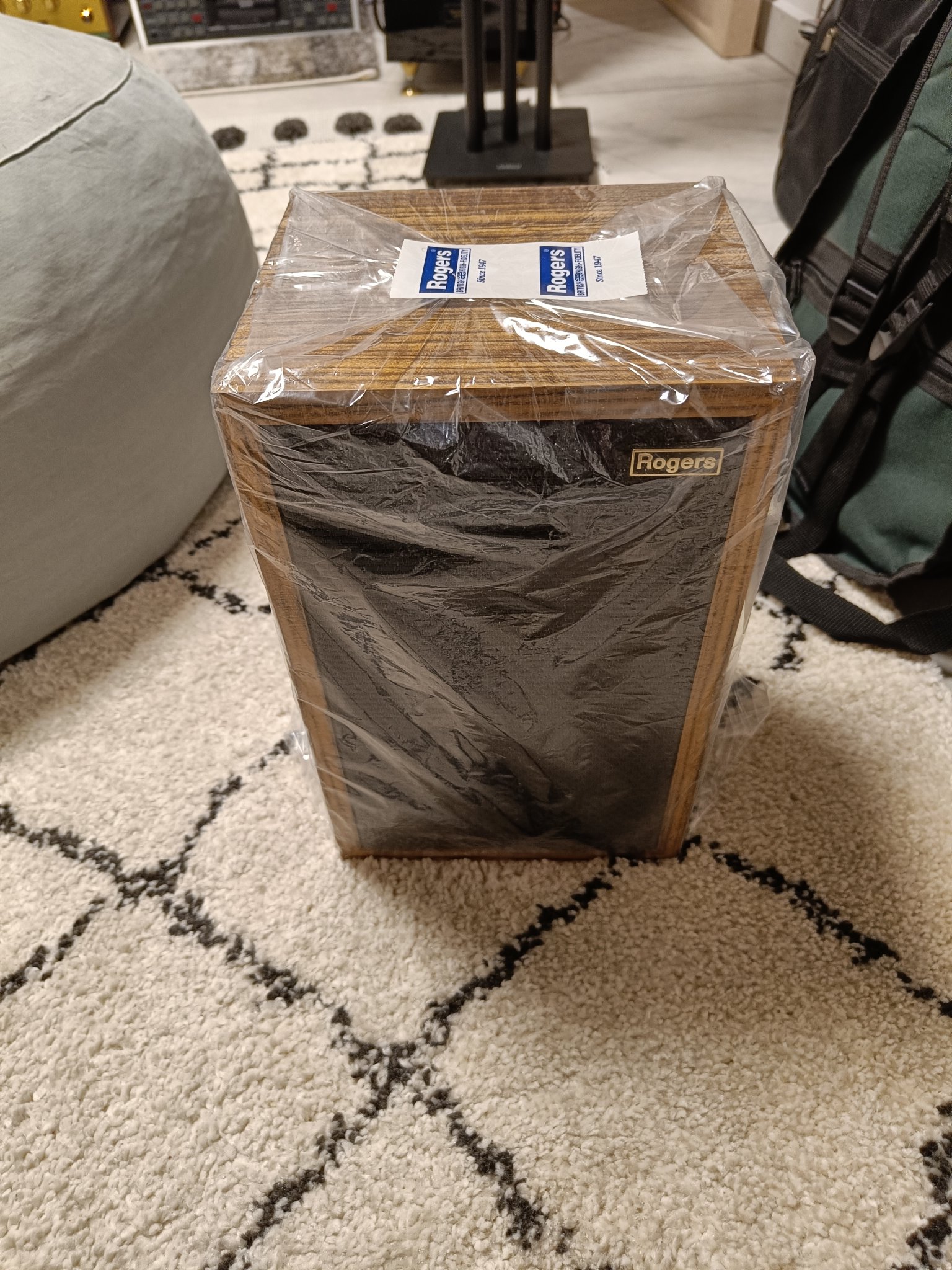

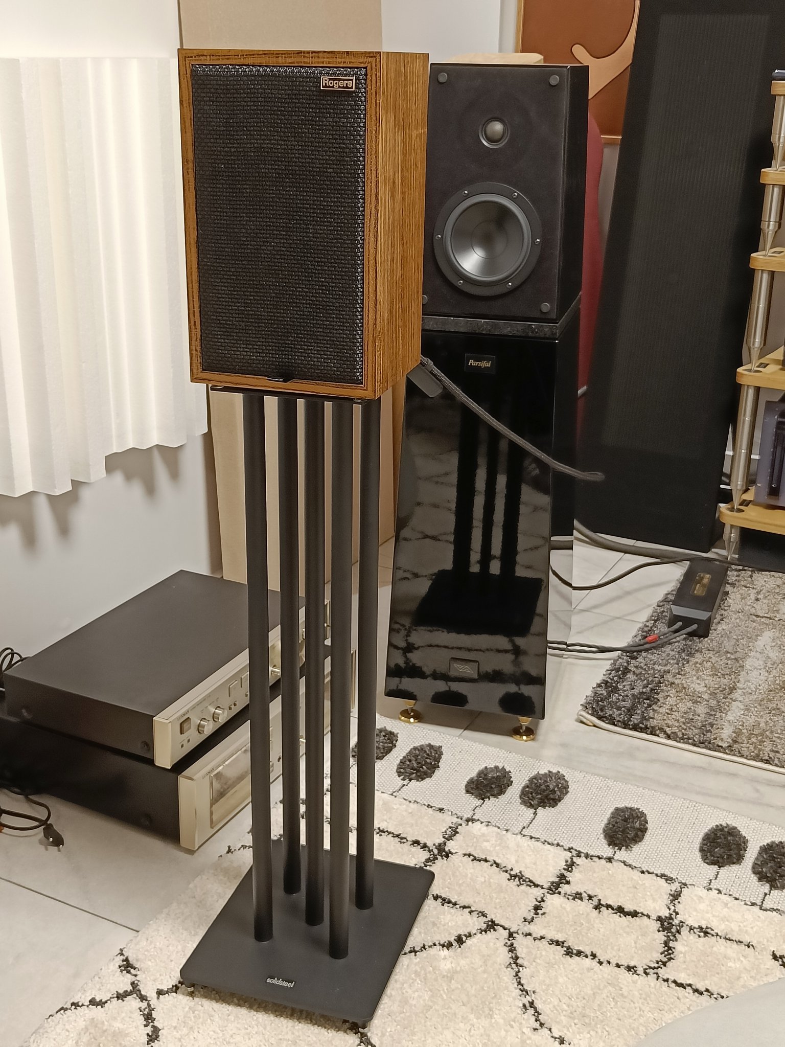

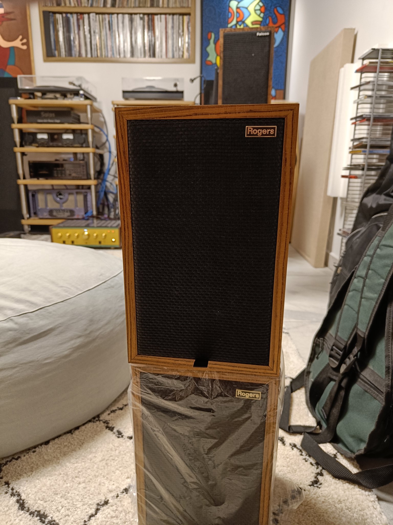

Because we will also measure the brand new Rogers SE indoors at a point and it will be interesting to see if Rogers kept their legacy FR trend or not. Don't know if that's absolutely possible with reverse engineered drivers and panzerholz baffle though. What I subjectively know is the SE sounds more even with more midrange information than the Falcon GB which in turn sounds bigger and emptier but deeper like having a more pronounced low bump and treble peak. I listened to the SE again for few hours after it had played for many days at my friend's. And we switched Rogers with Falcon back and forth.I will take again this week. They were open in the program, then Microsoft updated my laptop and then poof, gone..

By the way I forgot, measure them with the grills on next time. That's their intended configuration. The grill frame hugs the felt frame around the tweeter right up to the protruding cabinet edges helping with HF diffraction.I will take again this week. They were open in the program, then Microsoft updated my laptop and then poof, gone..
In many rooms there is a dip around 200hz. Some dB more here makes the sound more friendly.

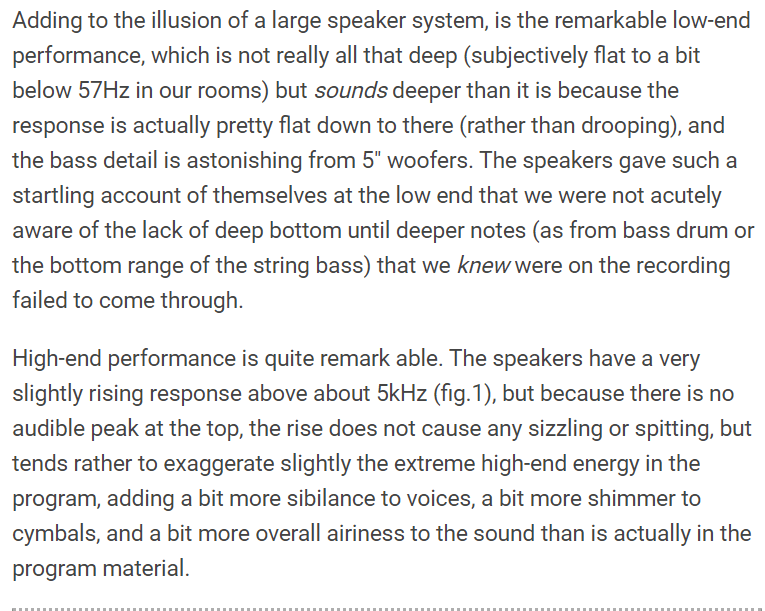

My snip is from Stereophile's review of BBC LS3/5A - https://www.stereophile.com/standloudspeakers/361/index.html
Basically my listening impressions align with everything in the 2 paragraphs, although I didn't notice problematic sibilance, but have to check that with more recordings.
The particular quote below I believe to be correct from memory. I noticed in my measurements flatness below the bass roll off. Inaccurate measurement in that region is possible for that so ?
"(subjectively flat to a bit below 57Hz in our rooms) but sounds deeper than it is because the response is actually pretty flat down to there (rather than drooping)"
