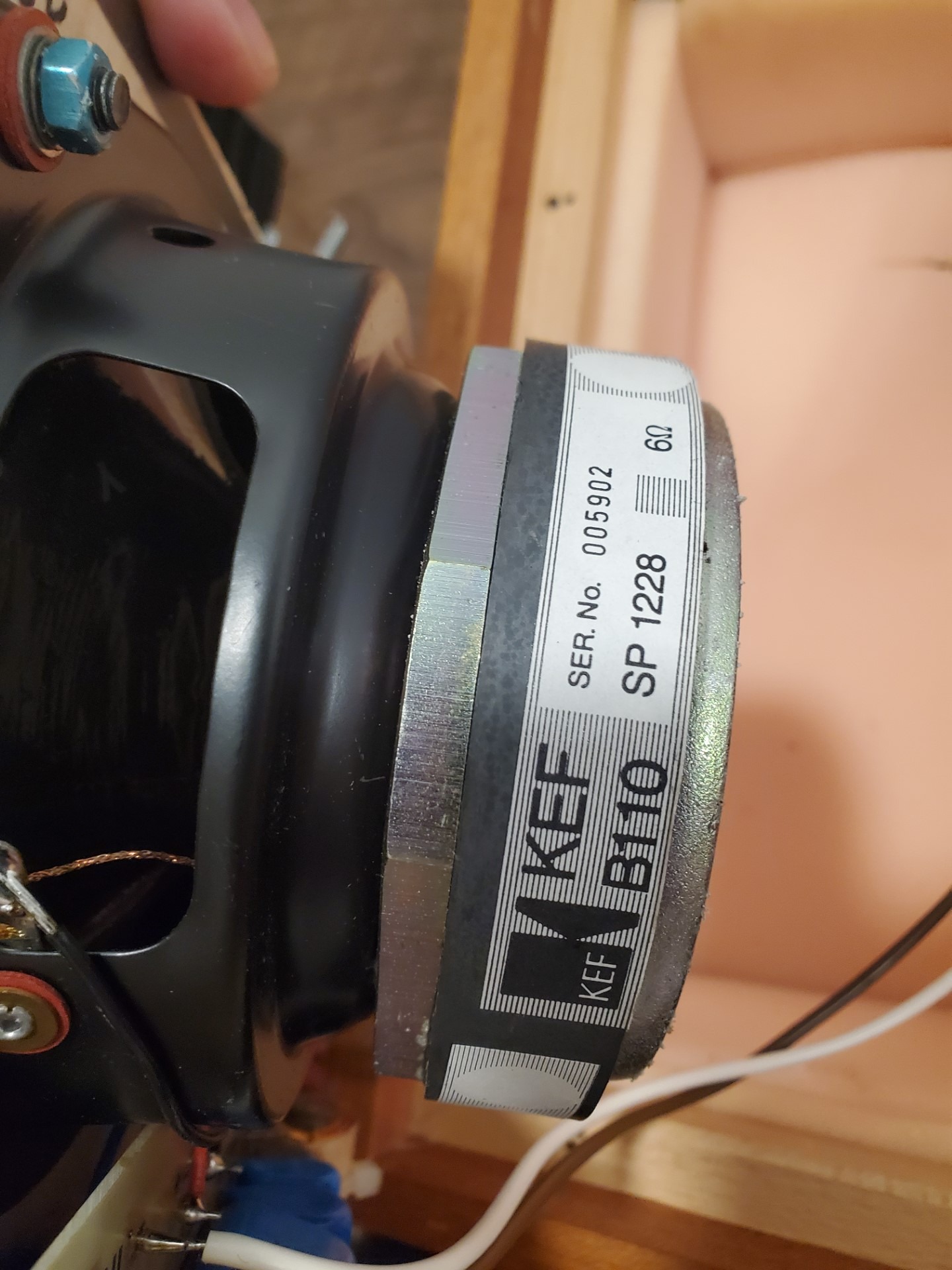

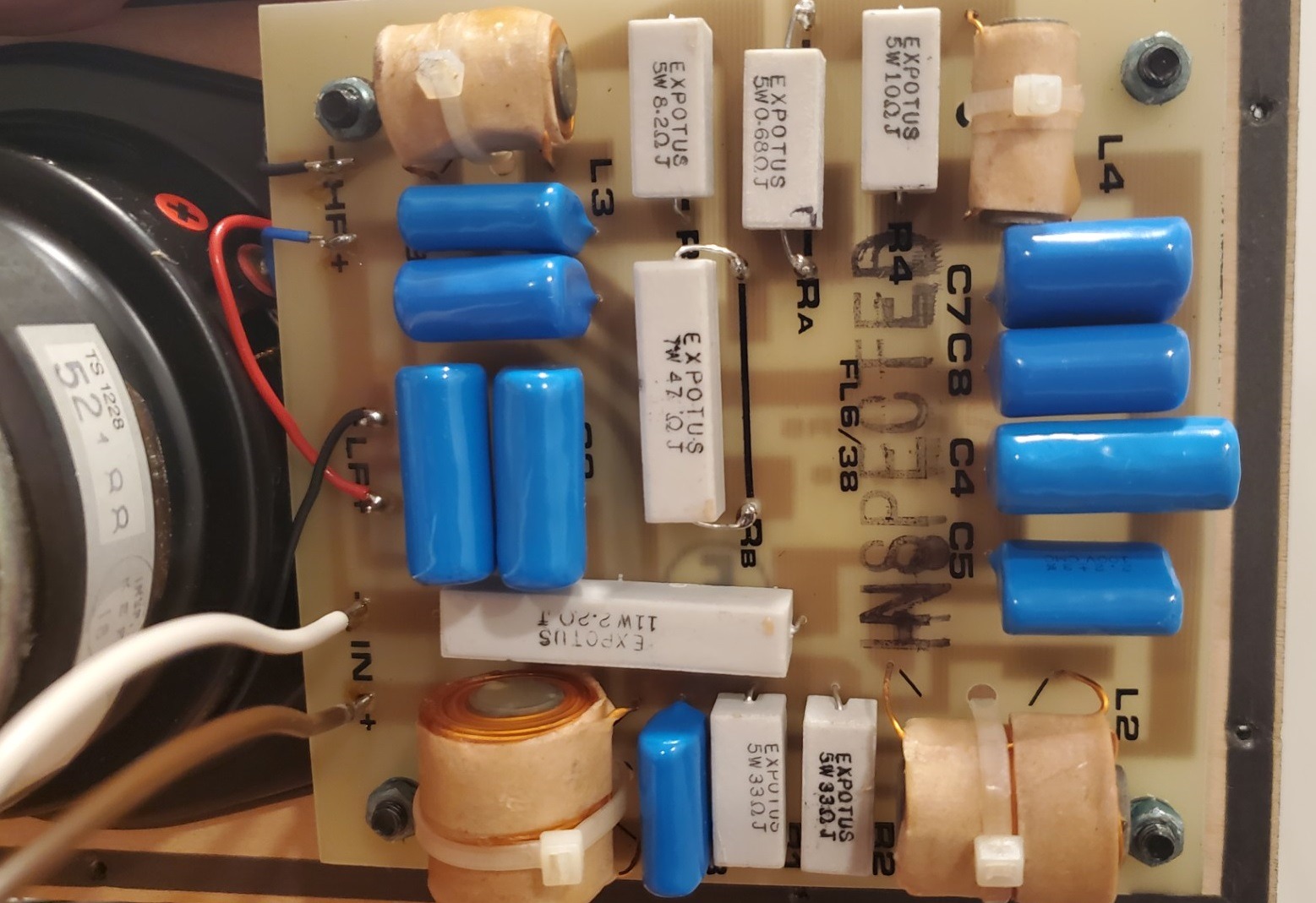

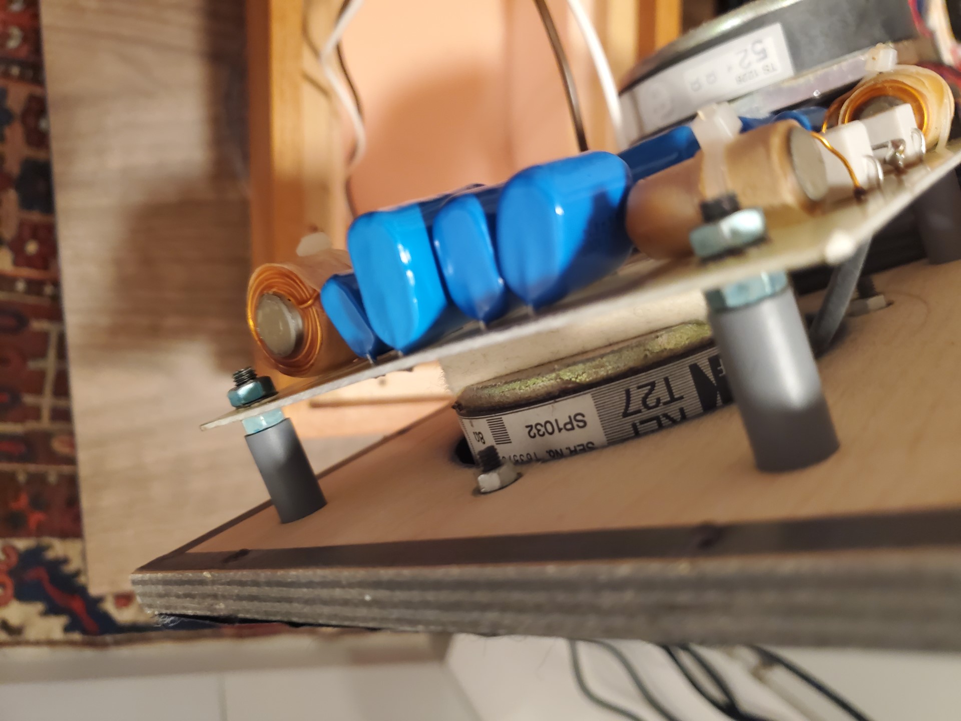

That's a Falcon crossover. Is this speaker made after 1987 or there's a chance it has been updated at a point? What year is written on the production labels at the back of the cabinets?They're in great shape inside!
"LS3/5A, FL6/38 New system using B110C - SP1228 & T27 - SP 1032
No. 101 Series Falcon component sets. Iron Dust Inductors, Polypropylene caps (Solen or ClarityCaps) and BBC designed resistive 'T' section HF attenuation."
"The B110C SP1228 - Redesign of the B110A and B with a much more consistent Bextrene cone back damped with Plastiflex PVA coating, PVC surround in a 6 ohm version used exclusively for the 1987 and later 11 ohm LS3/5a designs with a new generation LS3/5a crossover. Considered to be the most consistent to make B110 by KEF although they did eventually cease major production by the late 1990's."
I found the above info at Falcon's and in a very old Speaker Asylum post.

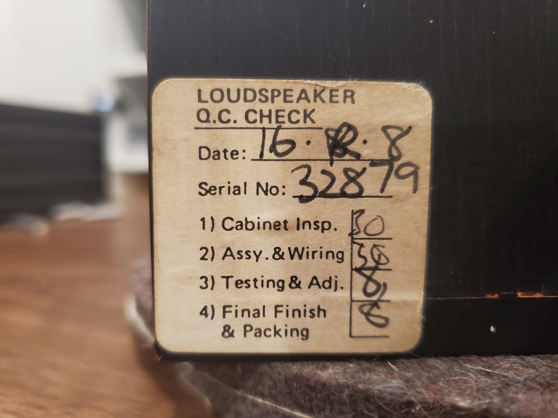

I don't know what to make of the Date on the label?
The trace side of the crossover PCB has 1987 printed on it!
I will inquire about where and when he purchased them! used or new etc..

It takes Indiana Jones to decipher that date code.I don't know what to make of the Date on the label?

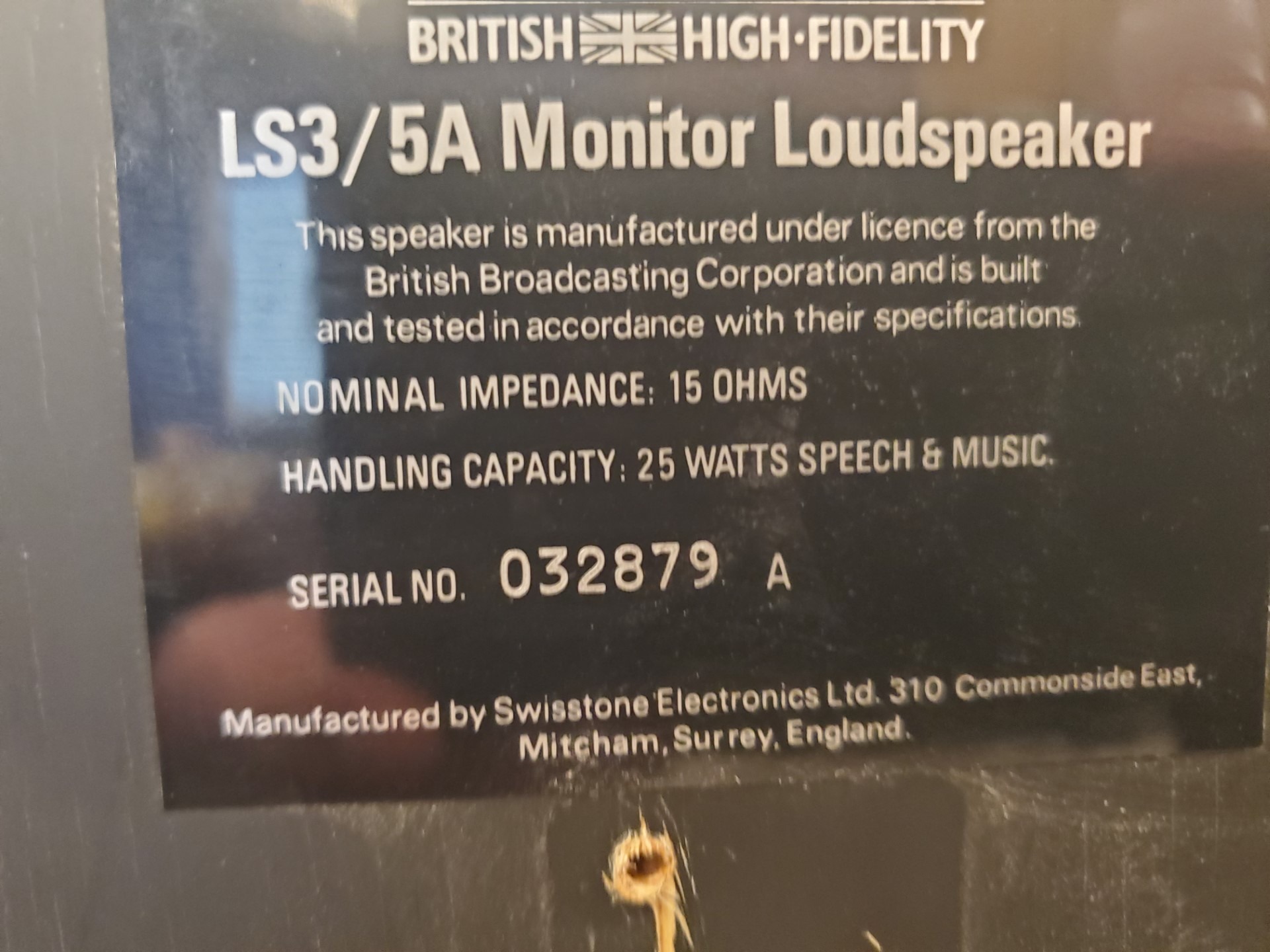

In any case with that drivers and crossover set it owes to be an 11Ω version, not 15Ω as on their black labels.
I would very strongly suggest you go find a place where you can listen to a set and decide for yourself. Unless you like listening to constant farting noises endemic in most contemporary music, you will likely miss nothing. They have wonderful sound and surprising amount of bass for such small speakers, even if not up to window shaking! They can also be augmented with a subwoofer if you feel you really miss any bass.
From the label, the cabinets were the Swisstone assembled models (a shelf-trading company bought to allow ex-Rogers employees to buy Rogers' assets from the official receiver after it went under). The speakers, given the B110 driver number (SP1228) are presumably an ista-bitsa with the later 11ohm drivers & Falcon FL6/38 crossover added -possibly somebody refreshed the damping at the same time, if the boxes didn't come with any, or they simply felt so-inclined. A lot of LS3/5a speakers have been put together in that way, recycling cabinets, drivers etc. if something went pear-shaped with the originals.
