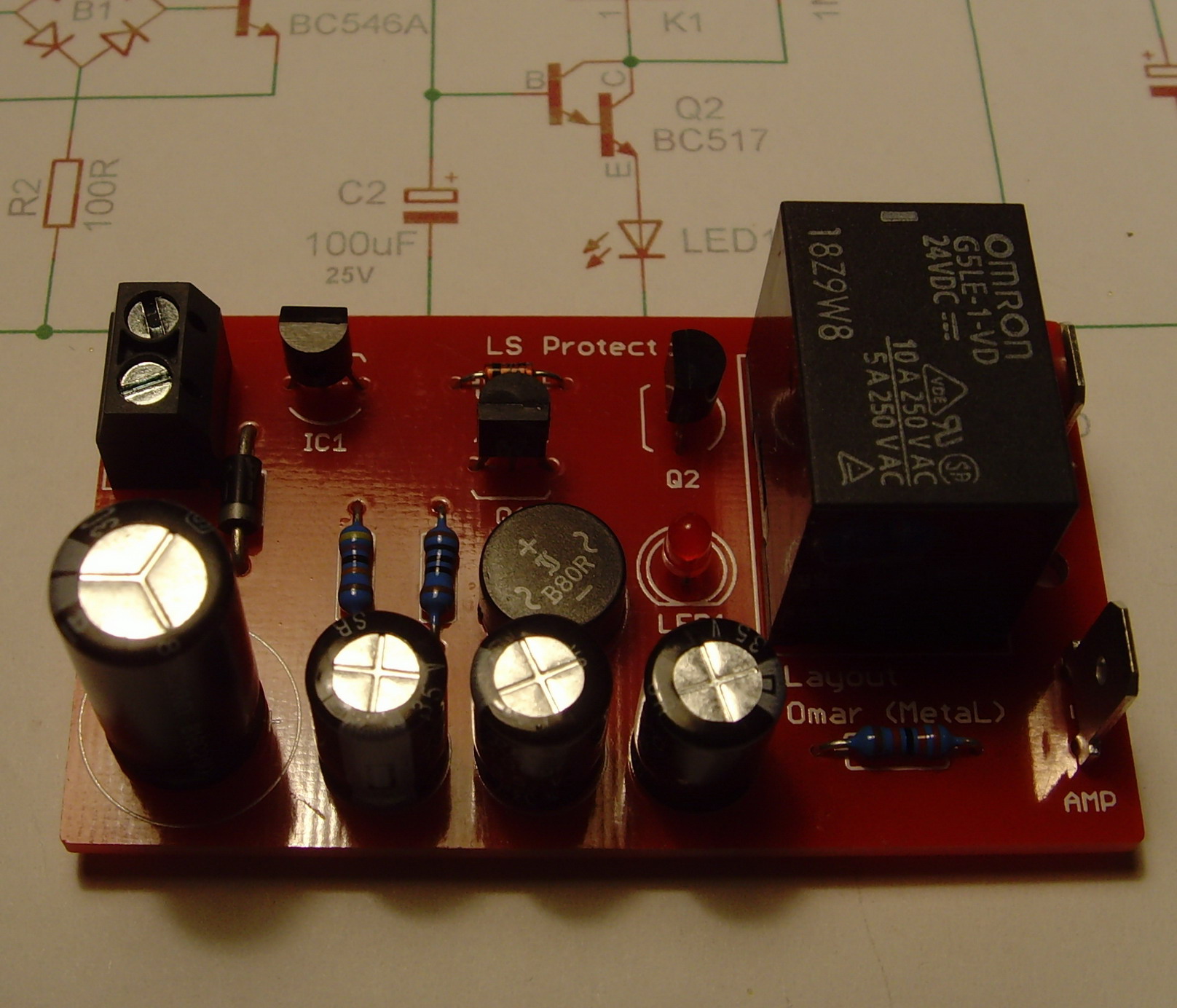

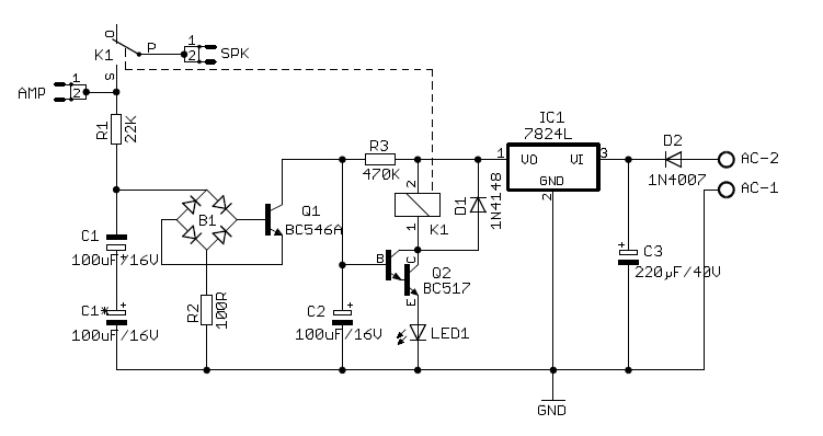

Mr. Joseph, Sir,
METAL and I designed and layouted a speaker-protection PCB a long time ago (see attatched images).
This PCB proved to be satisfactory by many German DIYers ever since.
It uses of course the Backend PSU AC voltages to power the circuit (as you recommended).
The LSProt-PCB includes a power-on delay, switches the speaker off immediately at power off and protects
the speaker against an AMP's malfunction or DC.
I wonder if we will put the LSProt-circuit on the AMP's PCB.
Best regards - Rudi

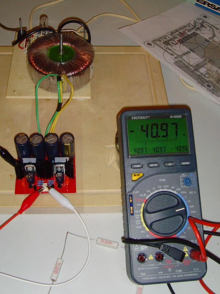

So I built a 1K8 resistor (resulting in a current of 21mA @ 39 V) and measured again.
Stable (after some time) at nearly 41V.
Mihai: is was impossible to order a transformer with 2 x 34 VAC secondaries for the shunt.
I am using a 2 x 35 VAC transformer.
Is this the reason why?
I will have a look at your shunt's schematics and try to lower the output by approx. 2V.
Best regards - Rudi

2x35V transformers should not cause any trouble. In Germany mains voltage may vary between +15% and -5% of its rated value and with 2x34V transformers the limits will be 39,1 and 32,3V.
The Zener diodes also have some tolerances.

The output voltage is regulated by the zener diode ... maybe your diode is not what should be ... 😉

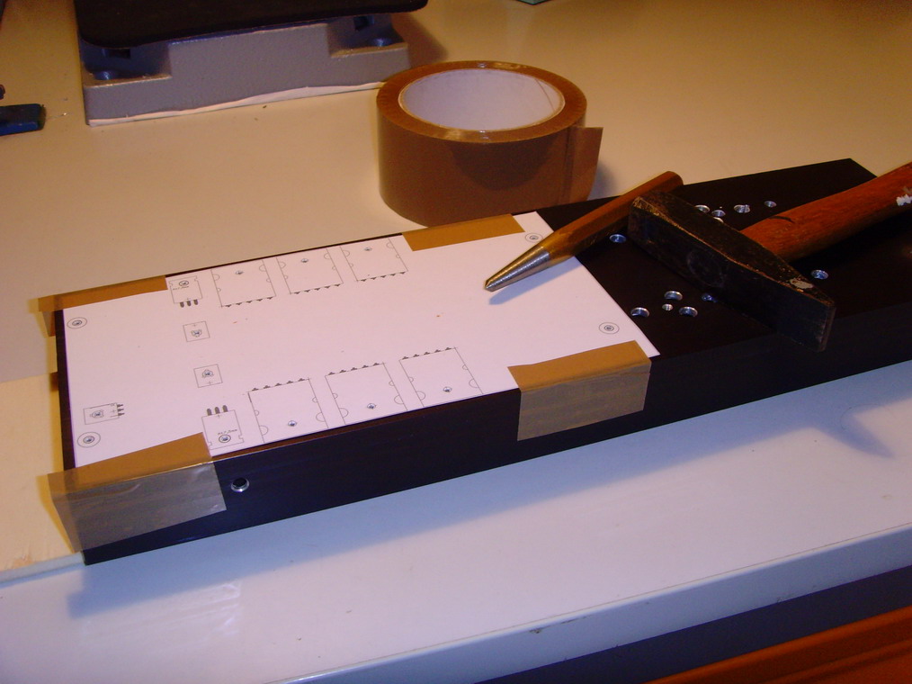

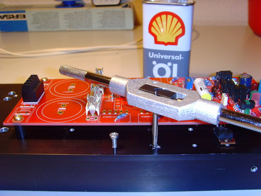

I did some small progress with the AMP tonight, continued with soldering the frontend and drilled the prototype-heatsink.
The shown heatsink will not be the one that I will finally use.
I need to get familiar how to tap (?) a heatsink. That is why I use this one.
I will try and solder the "underneath-transistors" tomorrow.
Mihai apologized for causing my confusion about the output of his shunt regulator.
He simply wrote down a wrong value for the ZENER diode in the BoM.
The ZENER should be a 37V type.
Mihai told me that my shunt (generating about 40.5V) will work without problems with his AMP as well, and I will therefore prototype
the FC-100 with the shunt I built.
But I will keep in mind to change the BoM to include a 37V type ZENER.

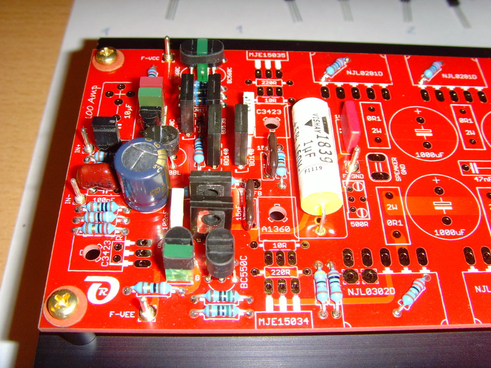

Hi ZSAudio,
I have a job and have to work hard for my income; so I do not always have the time to DIY.
I took a day off today and made some nice progress.

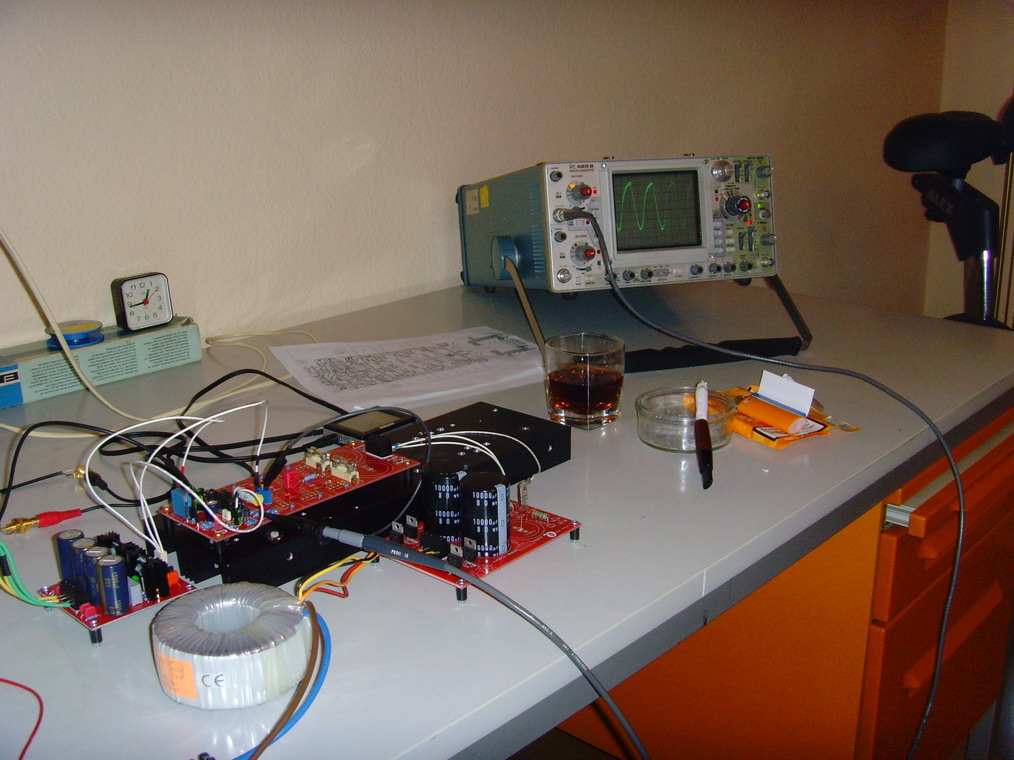

I finished the front-end yesterday night and powered the AMP on for the first time today.
Everything "works as designed"! 😀
No broken fuse, no smoke, all 5 LEDs are burning, I even see the "500 Hz sinus" that I fed to the input and measured
on the MJE15035 driver's collector on my oscilloscope.
Until now I have only had one (mechanical) issue.
The position of the MJE drivers on the heatsink is too far outside, and since I am currently using 10mm spacers,
their legs could not reach the PCB.
I will correct this on the new layout and drill-master.
I will go on now and solder the backend PSU and the output-transistors, ...
I am quite sure to get this done during the weekend.
I will keep you updated.

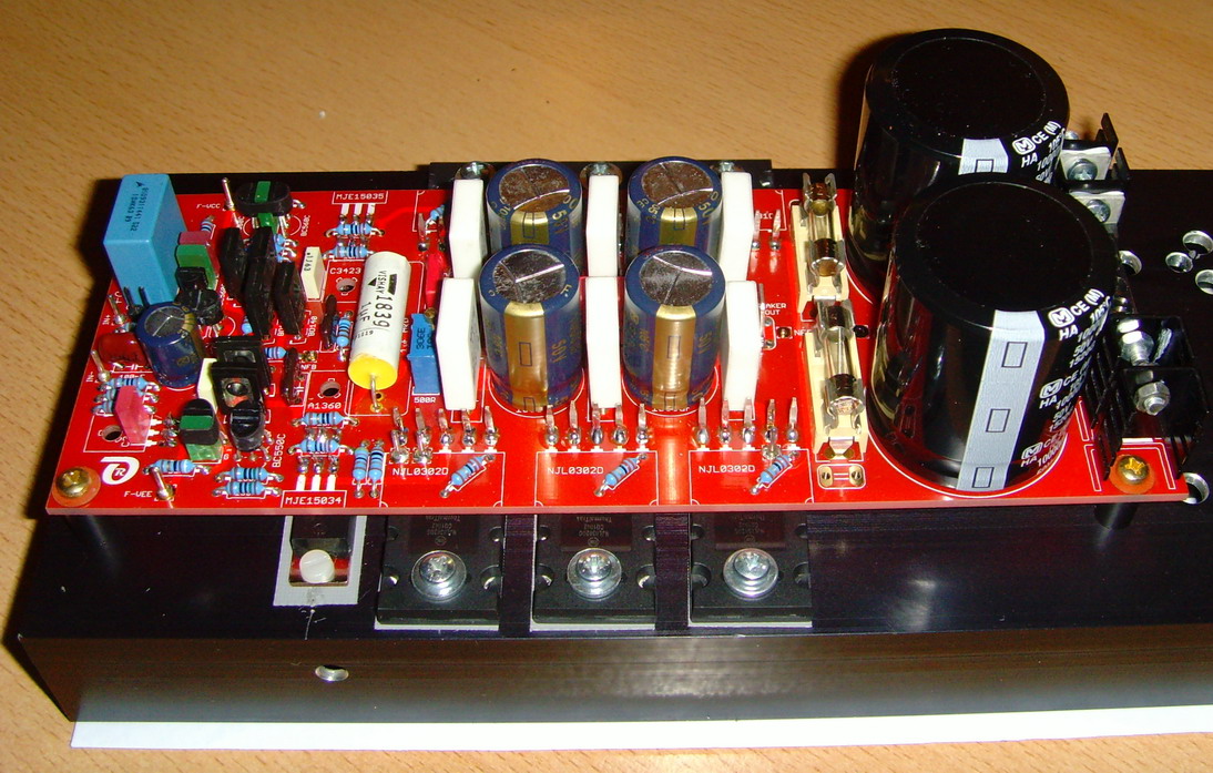

I made an extra solder-shift especially for you.
I am now done with the prototype of this AMP!
Tapping the heatsink was not a problem at all.
I found a nice video in YouTube and did it exactly as it has been described there. 😀

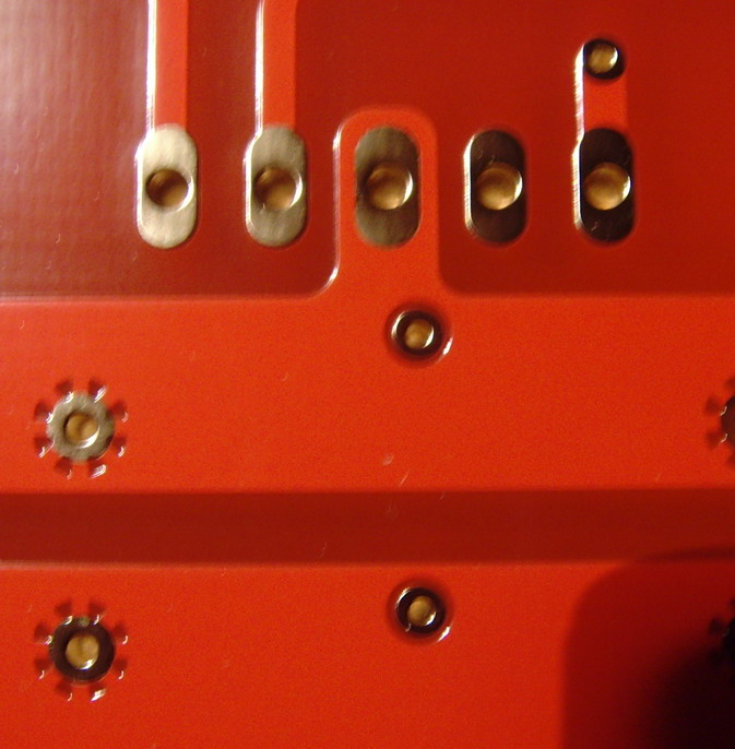

But I found another (mechanical) issue.
@ DIYers of the prototype-round:
The solder-pads of the emitter-resistors are very, very small and the isolation ring around them is very small as well.
Be very careful, when you solder the emitter resistors and measure with a DMM the resistances to the rail-voltages and GND.
An "error" like this happens, when you do the layout on a 25-inch flatscreen and zooming the layout by means of the layout software.
The solder pads and the isolation area around them looked sufficiently big in this mode. 😱
I will of course change the sizes in the layout of the forthcoming group-buy PCB.
I will check the PCB tomorrow again and will then switch power-on.
