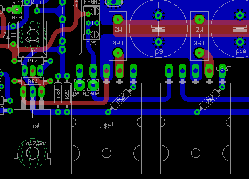

Hello Rudi,
Thank you for keeping informed us.
from Rudi:
"I made an extra solder-shift especially for you."
I'm sure all of us are very thankful for your great effort.
from Rudi:
"The solder-pads of the emitter-resistors are very, very small and the isolation ring around them is very small as well.
Be very careful, when you solder the emitter resistors and measure with a DMM the resistances to the rail-voltages and GND.
An "error" like this happens, when you do the layout on a 25-inch flatscreen and zooming the layout by means of the layout software."

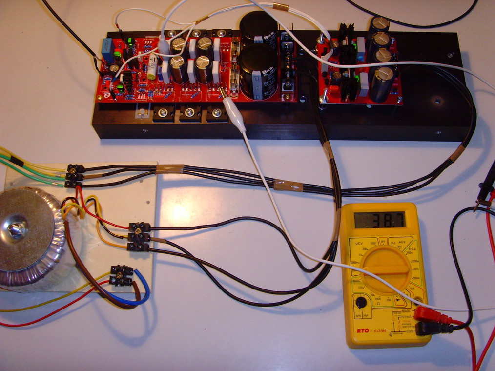

Gentlemen,
I am having a strange problem currently, which I cannot explain.
This is my build:
http://www.abload.de/img/poweron029h8a8v.jpg
a light-bulk tester (40W) connecting to the backend- (2 x 25VAC) and the frontend- (2 x 34 VAC) transformer.
As I wrote in a former post, the frontend of the FC-100 (being driven from the shunt-PCB) looked good
(all the green and red LEDs are shining luckily), and I was seeing my applied sine-wave on the MJE driver's emitter/collector.
I connected the backend-PSU today (of course I checked it beforehand), switched power on and: the frontend-LEDs are not shining anymore! 😕
and the voltage-drop over a emitter-resistor is about 60mV.😱
When I connect the backend-PSU, the frontend-shunt-regulator will be turned off ?!
I have to check the reason for this.

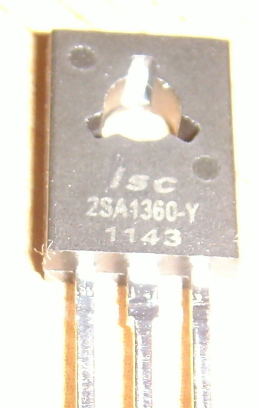

My Canadian friend suspects the used 2SA1360 / 2SC3424 (T3 and T4 are the interrfaces between frontend- and backend voltage),
and I will examine them once more very closely.
When I matched them, they looked 'honorable', having a HFe about 130 (2SA1360) and 165 (2SC3423).
I am sorry not being able to give you the "GO" for my PCB yet.
Best regards - Rudi_Ratlos 😡

Yes, I have, Neb.
The shown wire is the connection between frontend-GND and backend-GND.
I am currently powering-up the AMP from the backend-PSU only.
The light-bulk tester remains dark. Good.
I will now measure the voltages on the 2SA1360 and 2SC3423 and will report them.
Best regards - Rudi

@ZDR, Evette,
I disconnected the frontend-shunt regulator from the light-bulb tester (I left the backend PSU attached to it) and switched power on again this morning.
Things look much better now.🙂
Thank you for this advice, ZDR.
The frontend-LEDs shine happy again and the light-bulb does not shine that bright anymore.
But: there is still something wrong.
The minimum voltage drop over a emitter-resistor (the value of the trim-resistor being 0 Ohm at that time) is 48mV (see attached image).
It should be 0mV!
If I increase the trim-resistor's value, the voltage drop increases as well.
This is at least a good sign.
I will now measure the voltage drop over each integrated diode.
Any advice is welcome.
P.S. The image is shows a faulty measurement! The text above is correct.

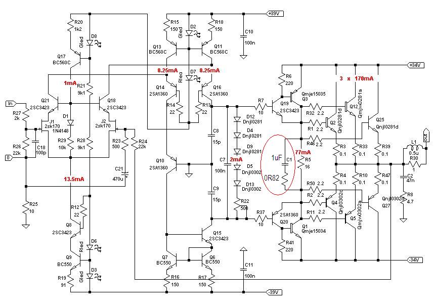

Hello Rudi,
I had the same issue in ltspice simulation when i rised the VAS current. If you have ltp current and vas current like it should be, measure the base voltages of q19 and q20. These are about 1.2v, -1.3v in simulation, the real life measurements may differ. Maybe someone who built it can help you what are the real values.
zsaudio
@ZSAUDIO,
the voltages on Q19 (2SC3423) are:
Emitter: 0.66V
Collector: 15.42V
Base: 1.26V
The voltages on Q20 (2SA1360) are:
Emitter: -0.66V
Collector: -15V
Base: -1.23V
That looks good.
P.S. I do not have the LTSpice files for the FC-100. If you have: can you please them to me?

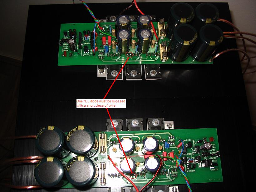

Hello Rudi,
supply voltage is a bit low (ca. 16V). Try to short one more thermal diode. Then idle current will be lower.
How big is the collector current of T15, T16? (Measure with the meter across C7.)
