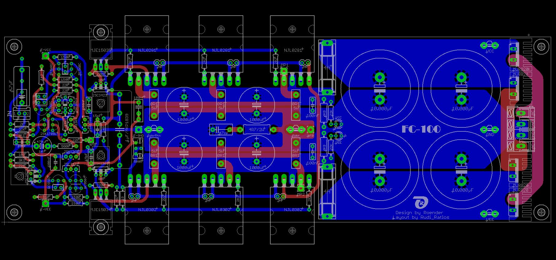

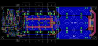

If there is some demand, I will of course order a couple of FC-100 PCBs.

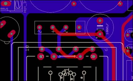

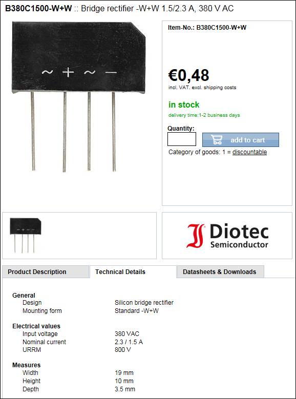

I've hit a small snag on the SPO bridge rectifier! It seems the designated part is not standard in North America and my part search skills and package nomenclature have completely failed me. Rudi and I exchanged some communications on the topic today.
Below is the PCB and the specified Diotec P/N B80C2300-1500B. Note the pinout polarity and dimensions (4x20mm silkscreen, 5mm pin pitch).
Anyone know a suitable part that'll drop in and can be ordered in the USA? 63 diy karma points to be awarded for helpful information!

Mystery solved here. Package type is 2KBB or D-37. Vishay makes a few.
