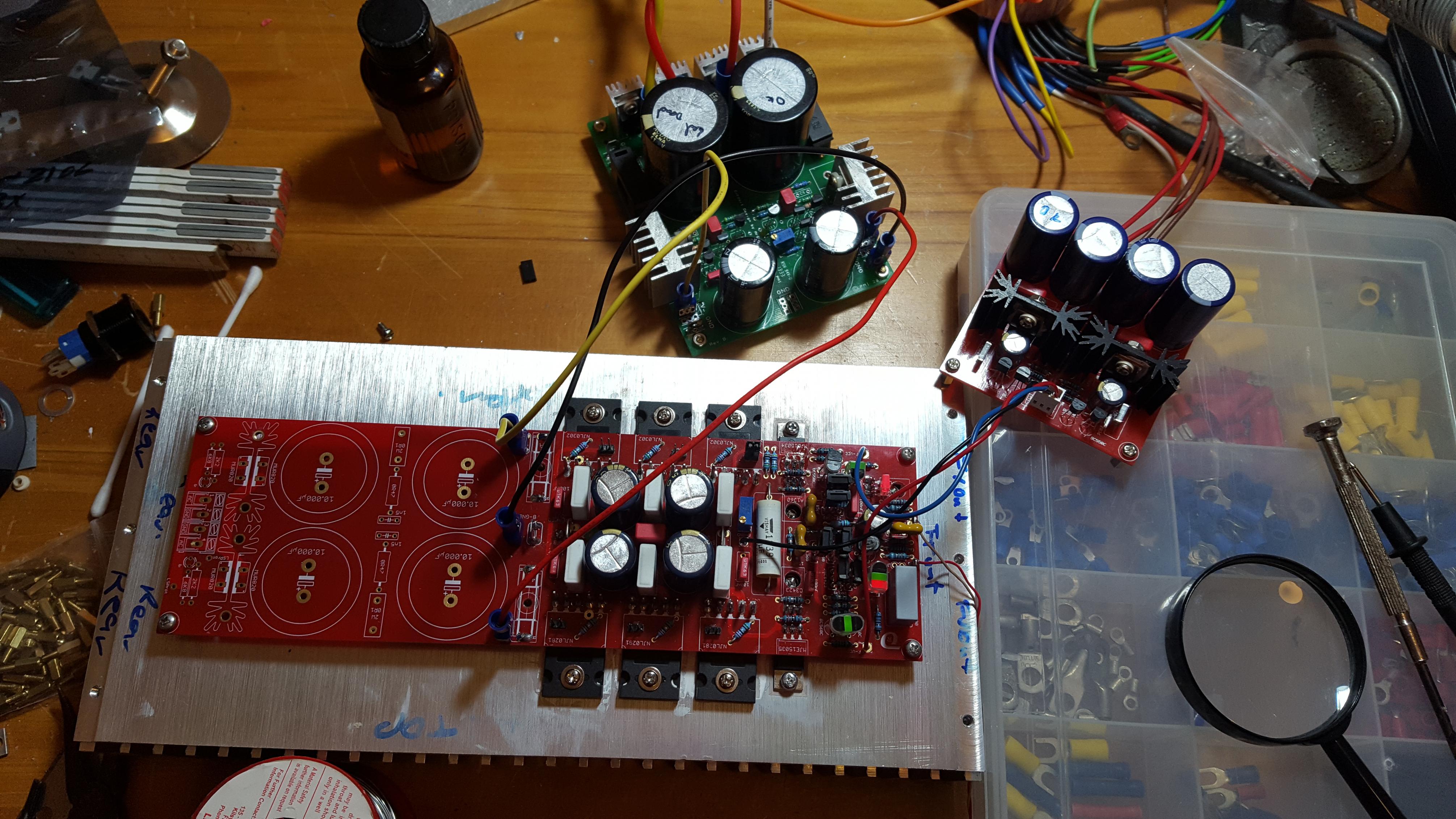

Hi Rudi, long time no see🙂 Your new group buy inspired me to finally finished this amplifier. I have just biased both channels and both fired up no problems. I was quite nervous about this amp as it seems to be a bit finicky. I triple checked every thing I did and I had no need for the Shottky diode. Bias is extremely stable once the amplifier has warmed up and the dc offset is 1.2mV and 0mV. The output transistors are your matched sets. I matched the rest myself.
I used a Mr Evil cap multiplier and I have lugs for pre reg and post, so I can decide which is better. I have only used 12000uF for each rail on the cap multipliers.
All I have to do now is finish the casework, its mostly done, but need a few more holes to mount the boards and 3 transformers.
I also need to decide if I use the L//R outputs. I probably will, but I need to make another visit to the electronics shop to get the wire and resistors. I need to figure out how to mount this on the binding post but should'nt be too hard.
This has taken 2 years, I got sidetracked and made a few HP amps and DAC, so its long overdue. I will post impressions when its finally built.

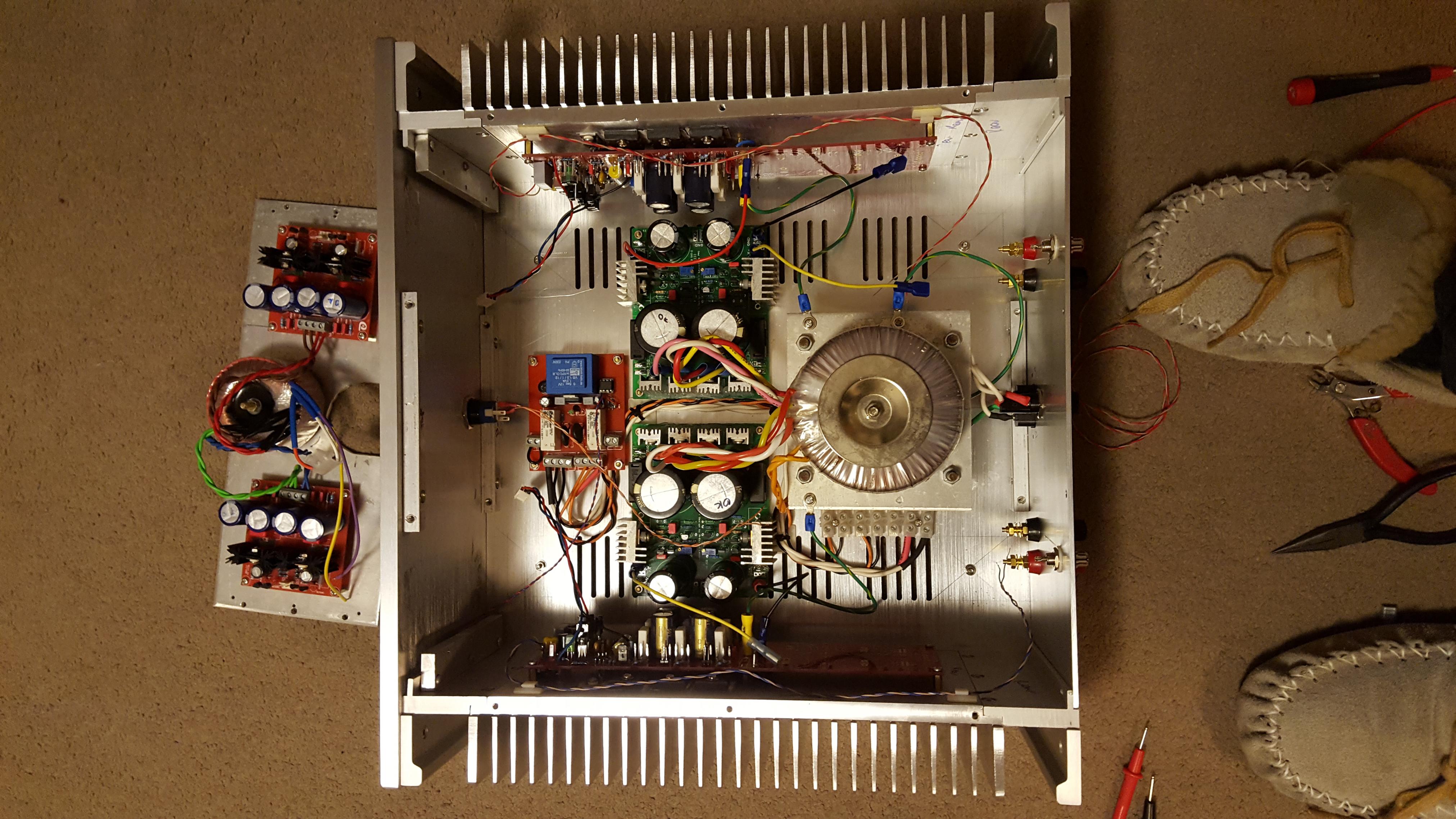

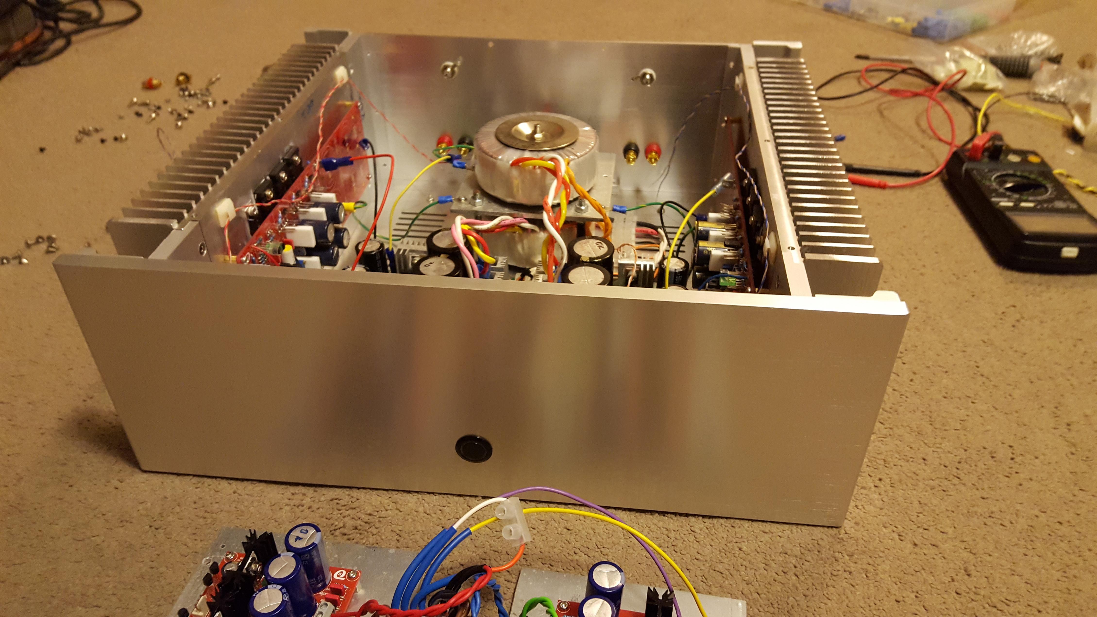

Different PSU?
Yes I used Mr Evils cap multiplier. I can bypass the cap multiplier and if it sounds better without I will build it standard. But now that I think about it, I don't want to remove the pcb from the heatsinks, tricky to get it back in.

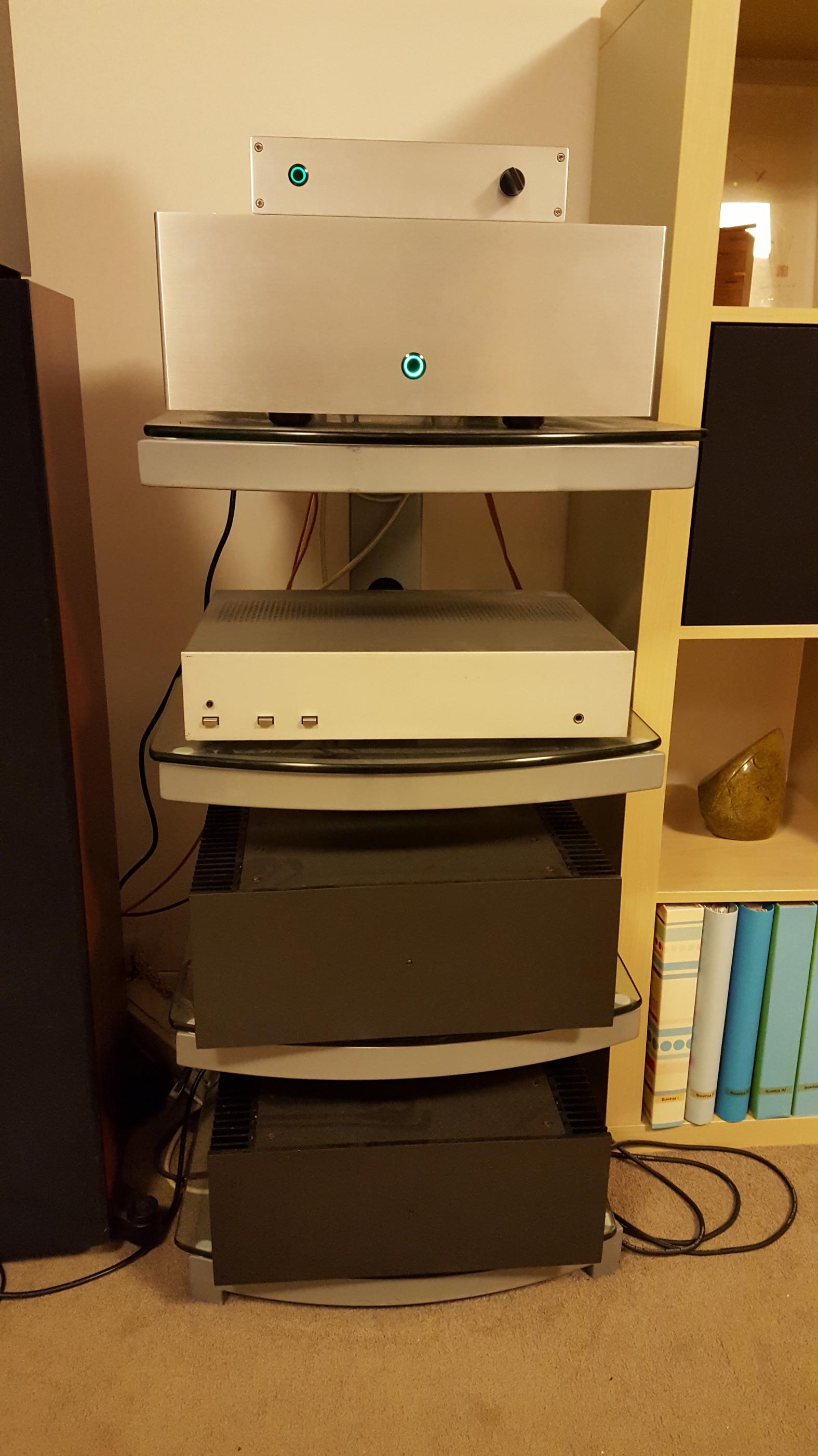

Gorgeous looking amp !
Sent from my Nexus 5 using Tapatalk
Thanks, Aliexpress, has some nice chassis.
I know but for europeans there are cheaper options like modushop
Yes, and they are a nice chassis too. The other thing about this, is the silence. You can not hear a thing with your ear near the tweeter. Its dead silent.
