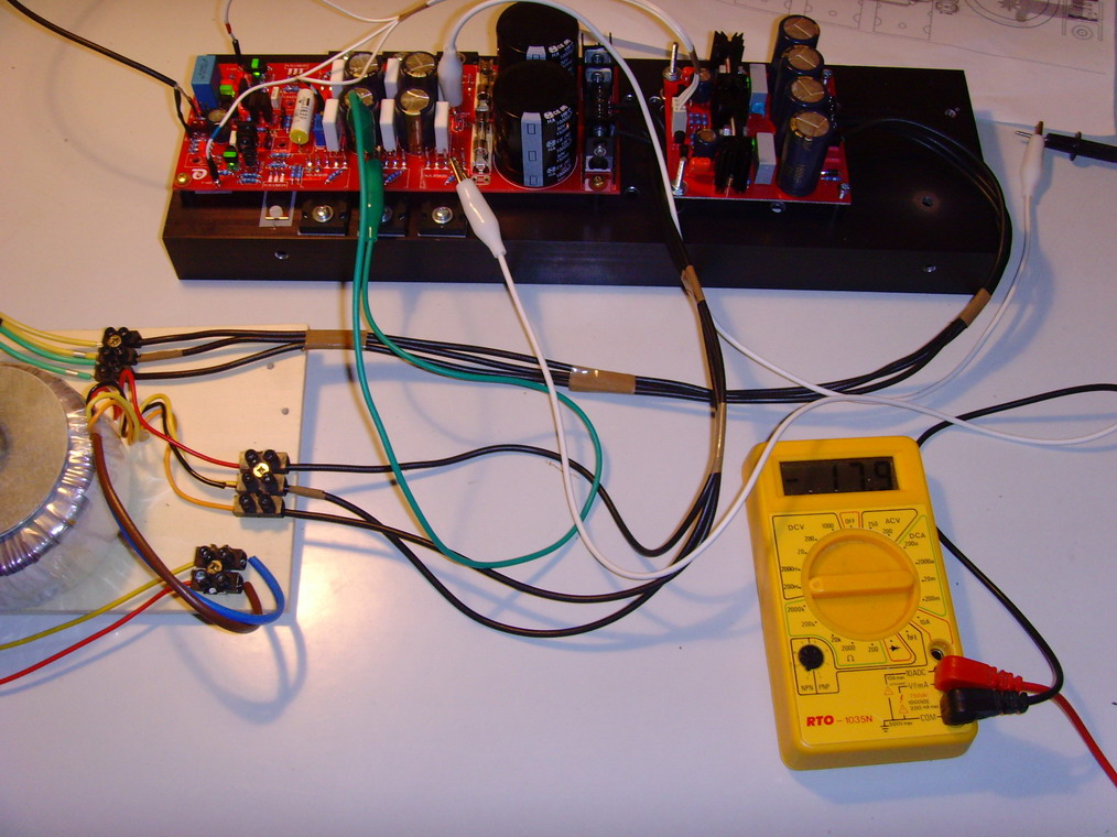

Franz,
I have shorted one internal thermal track diode.
The initial value of the voltage drop over an emitter resistor (with the trim-potentiometer being set to 0 Ohm) is now 0V,
and I can very easily adjust the voltage drop to 18mV as Mihai suggested.
And, as you said: the quiescent current flowing through the backend decreased a lot. The light-bulb is ony "glowing".

I feel quite relieved now. 🙄
I will remove the backend PSU from the light-bulb now, adjust the quiescent current once more and leave the AMP for an hour or so.
Then I will measure again and apply a sine wave, a square wave,..., and "listen" to the oscilloscope.
And then ...
But I still have to find out, why I have to short a thermal track diode to make this AMP running.
I will be back in some hours 😀.

What's your +- current draw of the frontend from your shunt psu?
Did you measure the current of the ltp and the vas?
According to the real built of the amp (by Mihai and several forum members) and to LTspice simulation the amp should work with one NJL diode bypassed.
The jfets work on about 6.1mA per device the vas about 2.16 mA per device.
If your set-up similar to this maybe your NJL's TC diodes differ. Would it be possible i do not think so but who knows.
Did you run the simulation and compare the values (voltages and currents) on every devices?

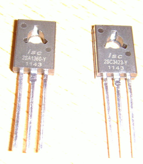

Franz,
the NJL transistors are absolutely integer and authentic.
I bought them from a DIY-friend whom I know for a long time.
In contrast to my post #198, where I measured only about +/-15 V at the collector of the 2SC / 2SA transistors,
I am now (with only 4 diodes in the string) measuring +/- 35V at the collectors.
It looks like the 2SC / 2SA transistors that I use, do not supply enough current to turn all 5 diodes on.
To replace these 2 transistors Q19 and Q20 (I use 2SA1360 and 2SC3423 throughout the build) will be a very hard job,
since these 2 transistors are mounted beneath the PCB (which is plated-through).
I have still a whole bunch of 2SA1360 and 2SC3423 at hand.
How can I make sure that these are "fakes", before I try and solder them out?
Best regards - Rudi

I have attached a photo, ZDR.
Are these fakes?

Are these fakes?
I bought them from a big, famous German online store recently.
Best regards - Rudi

The transistors aren't counterfeit, they're genuine chinese stuff. ISC is a chinese manufacturer and their process could differ from the japanese one.
Don't trow them away. Let's see if we can fix the problem as suggested above.
Hello Rudi,
Those are the chinese version (some would call it copies) of the Thosiba ones.
I do not know if those can cause any problem but i would not use them for vas.
zsaudio
zsaudio
I have used these transistors in the past and had nothing but problems with them,osc burn outs you name it I could never get them to work right. Evette
Schottky diodes have negative temperature coefficient.... Sorry
I have some 2SC2922 from ISC and they have huge leakage currents.
