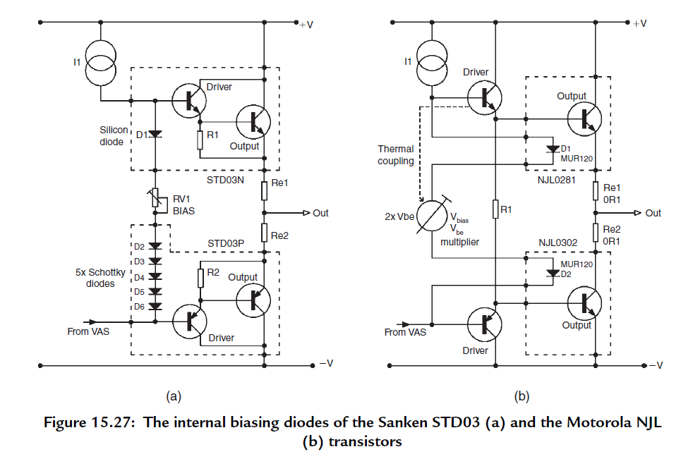

I found this interesting image (see below) in Dr. Self's book, Chapter 15: "Thermal Compensation and Thermal Dynamics".
In this chapter Dr. Self compares (amongst others) the behaviour of the internal biasing diodes of SANKEN STD03
and Motorola (OnSemi) NJL transistors.
Interesting for me to see: in case of NJL transistors Dr. Self suggests the thermal coupling to be done by using 2 internal diodes
and 2 VBe multipliers, which is in effect a 4-diode string.
Maybe that my 4-diode string is as valid and safe as the 5-diode string that Mihai implemented in his original design.
Maybe that a 5-diode string can only be achieved when the components are extremely well matched or - by chance.
I am curious about ZSAUDIO's results of his prototype build.

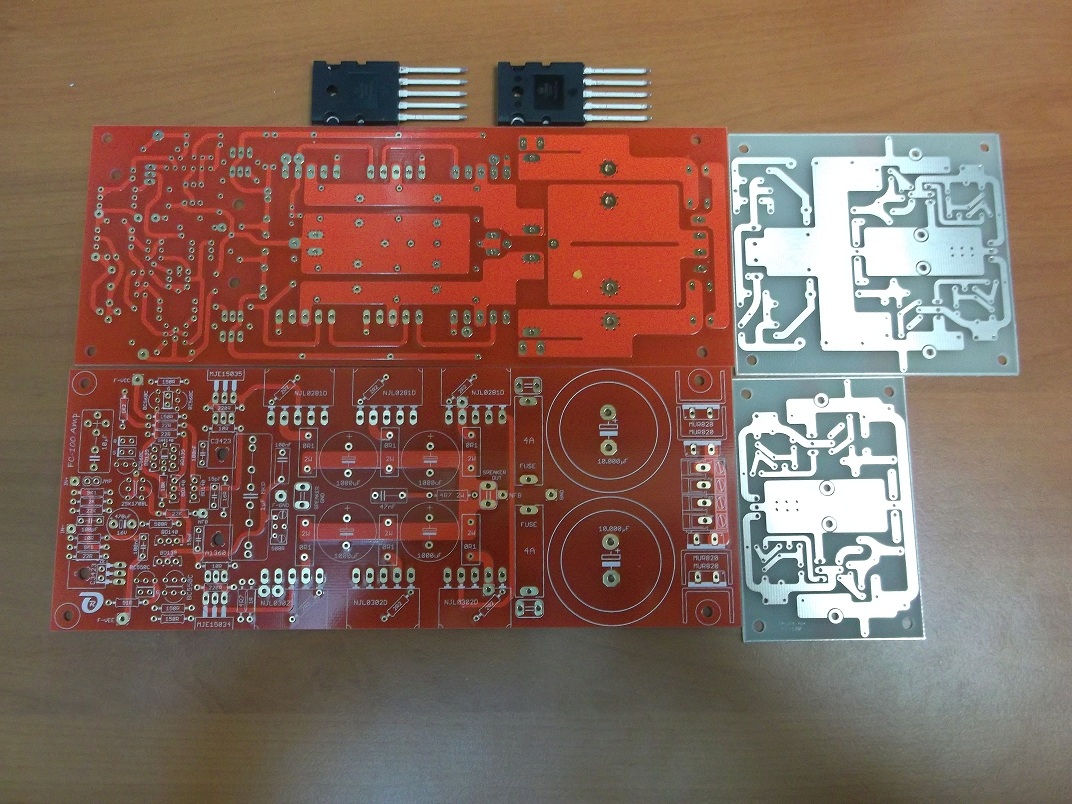

I sent him a pair of PCBs yesterday.
In the meantime I will go on and test my build under the aspect of thermal compensation.
Best regards - Rudi_Ratlos

@ZSAUDIO:
Please give me your EMail-address (by PM) so I can send you the schematics, silkscreen, drill-master, ..., of my PCBs that I sent you yesterday.
Best regards - Rudi

Hello Rudi,
i hope to get the pcb's this week and start to assemble and we'll see if i have the same issue.
I matched the NJL's and got similarly tight pairs like Mihai. I've got the groups from 25-25 pieces.
It would be good if you could do some thermal test of your amp. If my memory serves OS (Ostripper) made some test on it to use a hair-drier to warm up the heatsink and watch for Ibias change. Maybe some more experienced forum members can give us some hints how to do it in the proper way and how to deal with the results.
But i think if your amp behaves well ( sinus, square, THD, clipping and so on) and sounds good to you i would not worry about it.🙂
