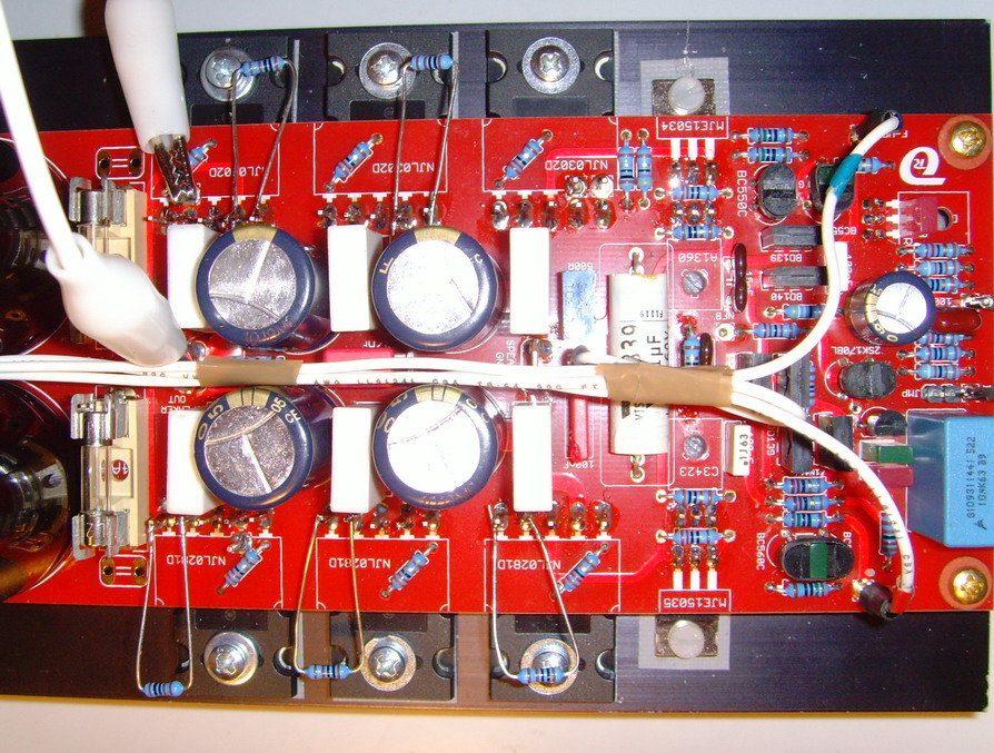

@FranzM,
with a 3K9 or 2K7: the initial value of the voltage drop across the emitter resistors (with Vr = 0 Ohm) keeps being about 40mV.
When I "bypass" the whole 5-diode string with a 1K5, the initial value is 0 Ohm and I can easily adjust the value to 18 - 21 mV.
Bes regards - Rudi

Bypassing a single diode with 510r is going too far.
If the diode Vf~400mV then 510r will bypass ~0.8mA.
That leaves just 1.5mA passing through the diode.
1k5 across all 5 diodes is going too far. That leaves just 0.6mA passing through the diodes.
Use 1k to 1k5 across each diode.
The Vre will drop as each extra resistor is added in parallel to it's diode.
The optimum Vre for 0r22 is not 18mV to 19mV.
It will likely be around 22mV to 23mV.
If the bypass resistors get the Vre down to about or just below optimum then you have proved that for your setup that 2.3mA through the diode string is too high.
Do that first.
Then seek out a final solution.

Believe it or not:
This AMP can play music.
I am being a little bit tired of soldering resistors in parallel, diodes in series, ..., I just bypassed the 5th diode,
connected a 5€ - speaker and switched power on.
And yes: the music sounds very well.
Maybe I will go on soldering and bypassing and testing and ... tomorrow.
Best regards - Rudi

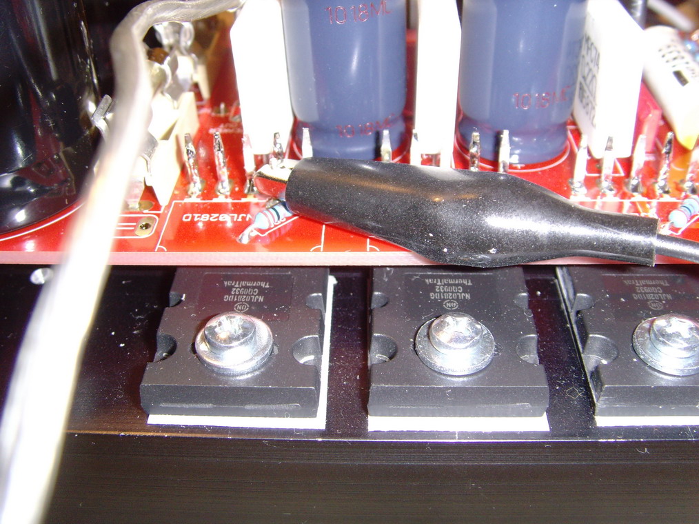

the date-code, when my NJL0281s have been produced, is CO0932.
The date-code, when my NJL0302s have been produced, is CQ1042.
I will ask OnSemi nevertheless.
Best regards - Rudi

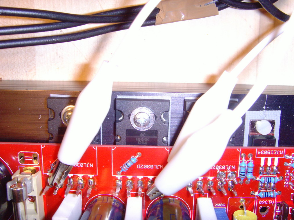

I did, what you asked me for and soldered a 1K resistor across each of the diodes.
With a trimm-resistor's value of 0 Ohm the inital voltage drop across an emitter-resistor is now 35 mV (instead of 45 mV without the additional resistors).
Best regards - Rudi_Ratlos

I measured the internal voltage drop of the NJL thermal track diodes with my DMM yesterday.
With power-off I measured the current that my DMM is inducing (0.9mA) and measured exactly 500mV dropping across each diode.
This corresponds to the datasheet.

In post #288 I wrote that after "by-passing" each of the 5 diodes with a 1K resistor the voltage that drops across an emitter resistor
decreased by 10 mV to 35 mV (instead of 45 mV without the additional resistors) with the trimm-potentiometer' value being 0 Ohm.
AndrewT. suggested to decrease the bias current from 2.3mA (that I currently have) to 1.8mA - 2mA.
Which is the best way to do this?
Best regards - Rudi

I have measured the diode's VF on "the fly".
The AMP is running since half an hour.
The voltage that drops across any diode is 500mV.
Best regards - Rudi
