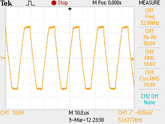

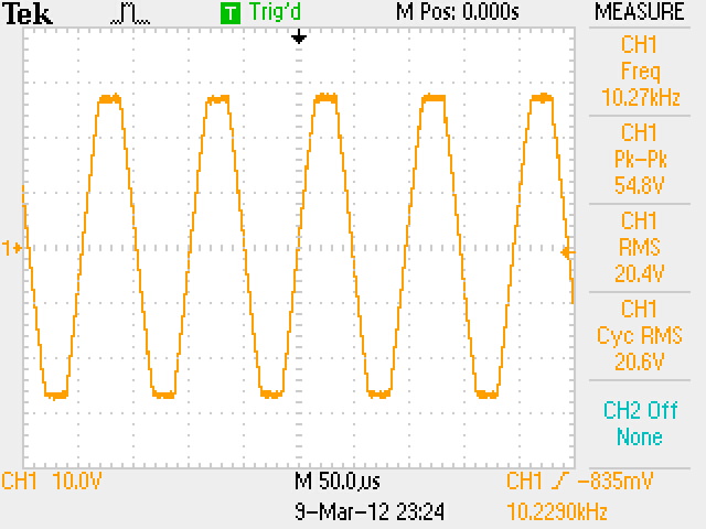

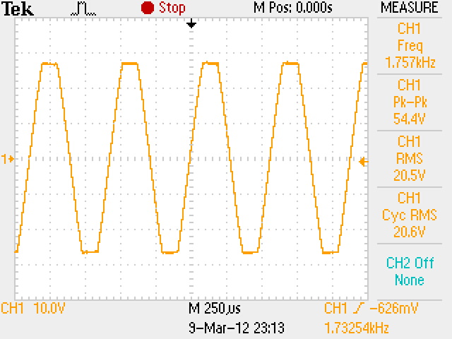

Then i drive the amp into clipping with about 1kHz sinus. The heatsink is still at 37C.
After several minutes i rise the frequency up to 10kHz temp is the same.
Later freq up to 50kHz fuses are blowing.
Swaping the fuses for bigger ones i continue the stress test. My heatsink warms up to 50C in several minutes but i have to stop because my dummy load (6R) is getting hot too hot.

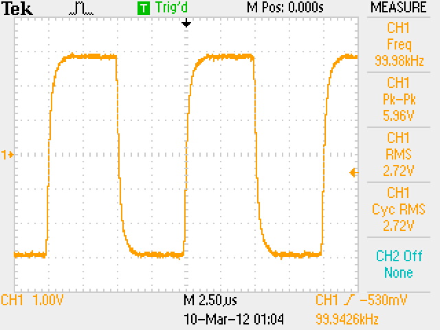

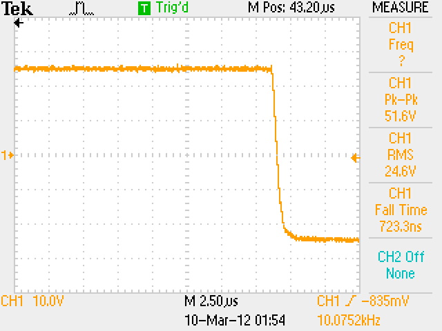

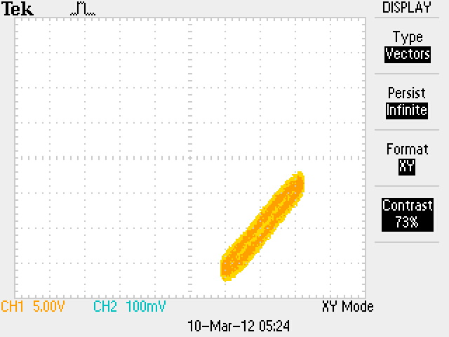

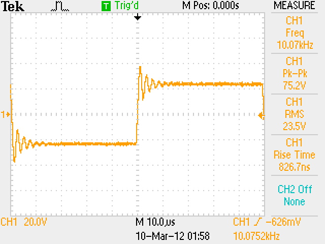

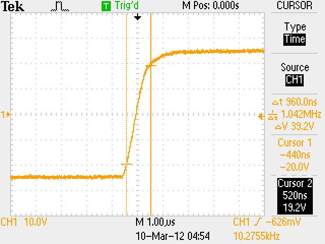

Sorry for the bad signal qualities but my signal sours is a diy signal generator the osci is a Tektronix TDS2022B 200MHz 8bit.
zsaudio
zsaudio

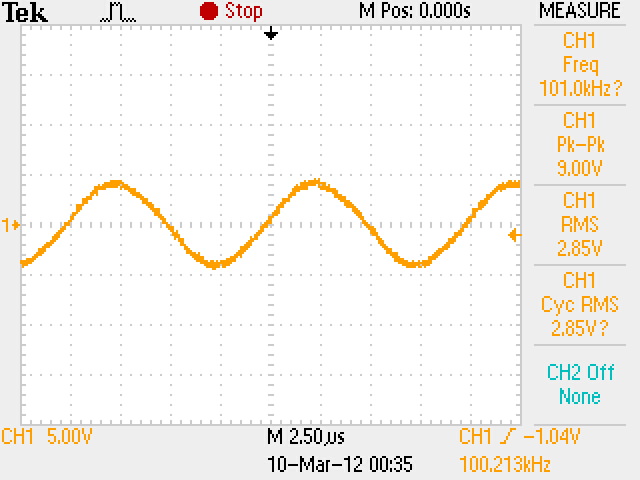

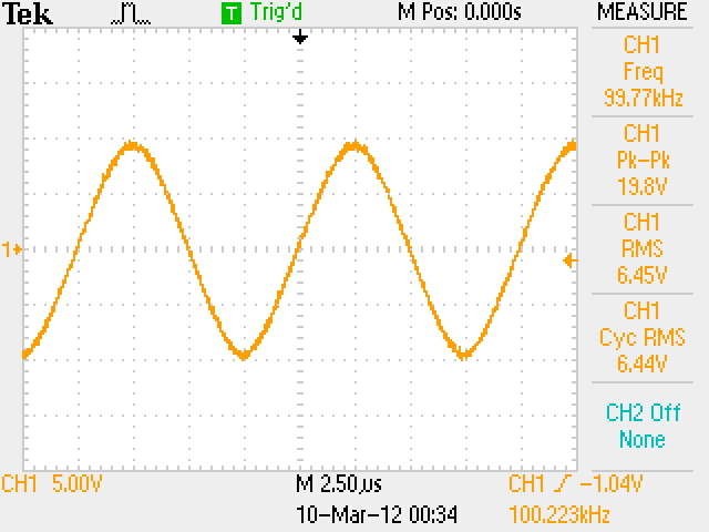

input lowpass and output coil (10 turns on 12mm diameter + 10R resistor parallel) are installed.
The previous ringing damped somehow but still ringing.
It's very hard to pass the 0.1uF load test without some ringing. Did you saw any amplifier immune to this test? 🙄
Frankly speaking all of my amps shows the same behaviour and never took care about it but some people use this test for stability. I usually drive the amp with about 100kHz sinus and load resistive and capacitive 2n2-1u and look for oscillation. Doing this test i've not observed any funny things up to 200MHz what is the BW limit of my scope.
But i do not know. I can test the amp within my limitations. So if anyone has some request about test i try to do it.

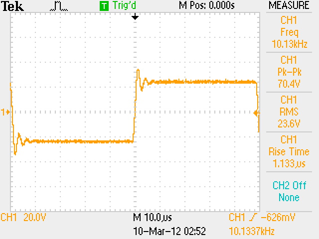

Remove the output coil but let the input LP filter in place.

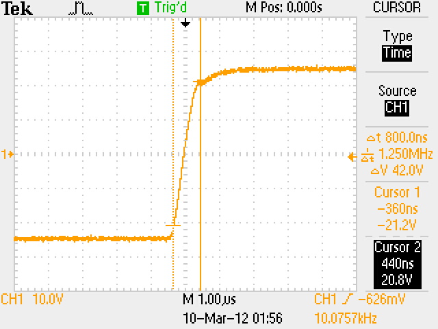

How fast is it (slew rate)?
I'm glad you like it from measuring POV but you'll like it more singing 😉
Hi Mihai,
output coil is removed now and input lowpass soldered (100pF).
http://www.diyaudio.com/forums/solid-state/51370-soundstage-class-ab-amps-2.html#post1394667
post 20 by Aksa interesting. I'll give it a try.
Best Regards,
zsaudio🙂

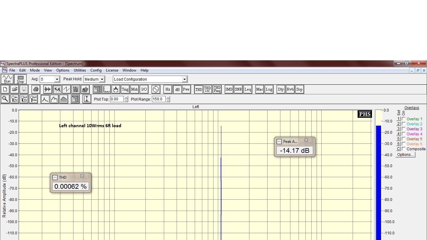

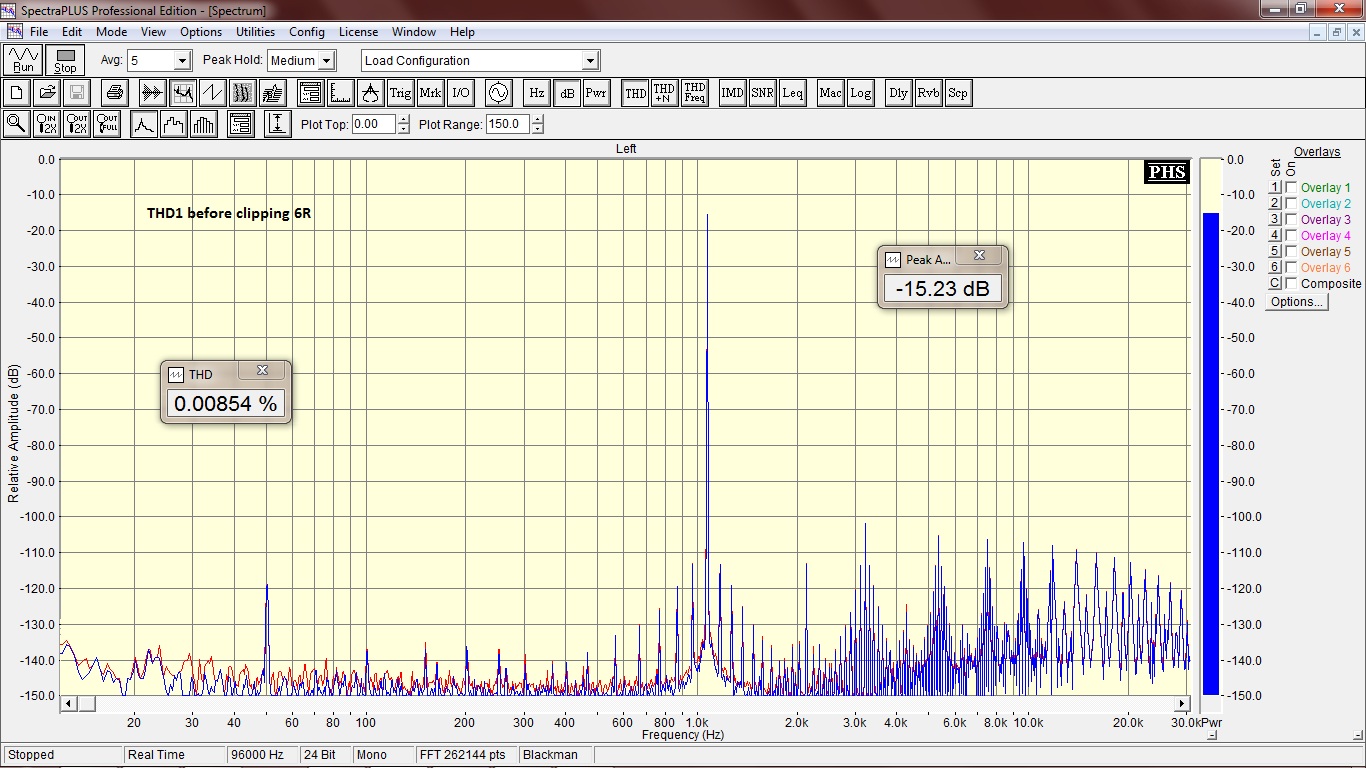

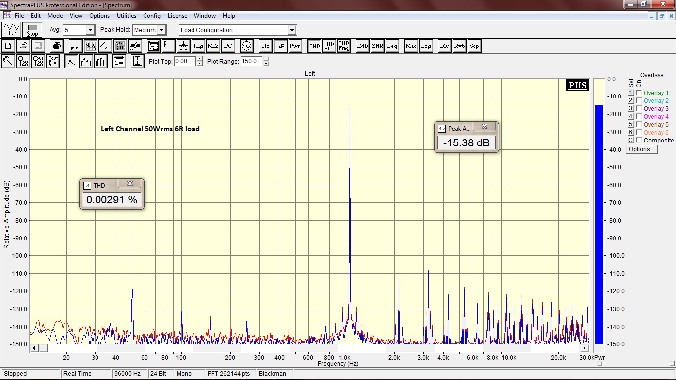

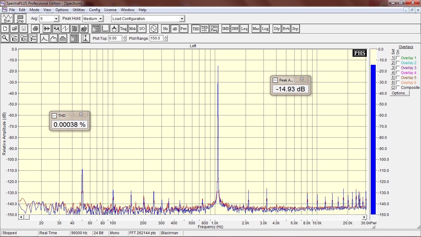

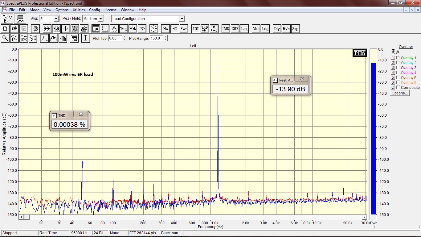

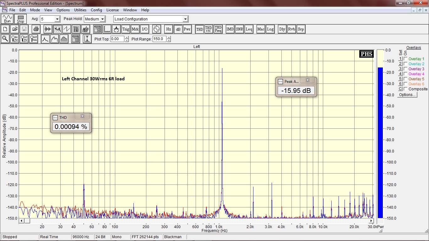

I measured the THD1. I used my diyed 1kHz ultralow THD oscillator from Linear Tech LT1115 datasheet.
My spectrumanalyzer is an EMU 0404 USB a laptop win7 x64 software is Spectraplus 5.
Sorry for the 50Hz and sideband trashes but i did not take the time to tame them.
All measurements were done for 6R resistive load.
100mW
1W
10W
30W

50W

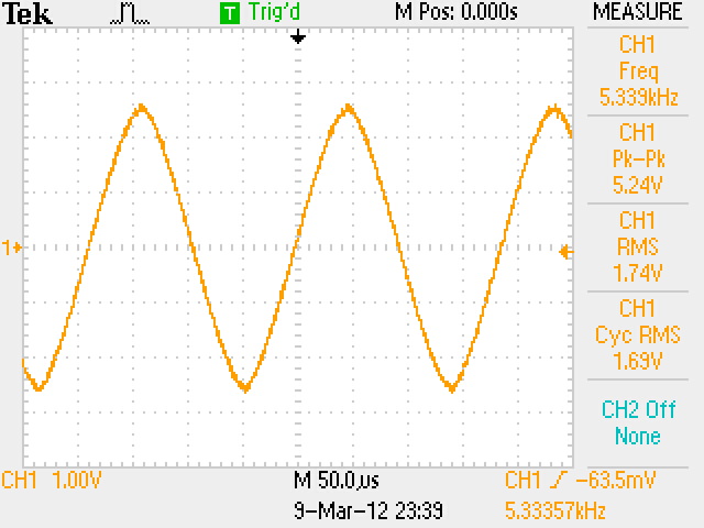

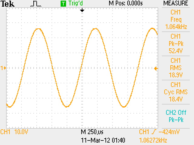

Before clipping

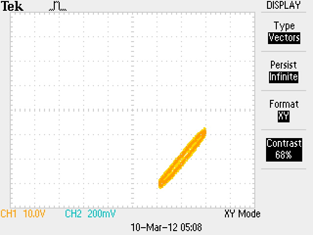

and the sinus signal on the scope.
Sorry guys for the mess signals but i thinks it's enough to show the amp's THD1 performance.
I'd measure THD20 if i could but i do not have the right equipment.
I know THD20 would be more interesting.
