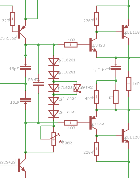

Yesterday I tortured the prototype with a 500 Hz sinus wave, being played at maximum volume of my MP3-player,
using an 8 Ohm / 100 watt resistor as the speaker's load.
Within 15 minutes the voltage that dropped across the measured emitter resistor increased to 40 mV and the voltage
that dropped across the unused 6th internal diode decreased to about 410 mV.
This is near "thermal death" and I aborted the torture.
A German DIY-friend gave me the hint to bypass one of the used internal diodes by a SCHOTTKY diode.
Compared with the internal silicon thermal track diode the BAT42 SCHOTTKY diode has a much lesser forward voltage drop
and has a negative temperature coefficient as well.
The temperature compensation now looks like on the image attached.
After bypassing one of the 5 used internal diodes by the SCHOTTKY, the initial value of the voltage that drops across
the measured emitter resistor is now 4 mV with the trimm-resistor's value preset to 0 Ohm.
I can of course adjust the value to 20-21 mV.
I will now solder the SCHOTTKY so that the diode is in close contact with the heatsink and will very carefully restart the 500 Hz torture test.
Best regards - Rudi_Ratlos

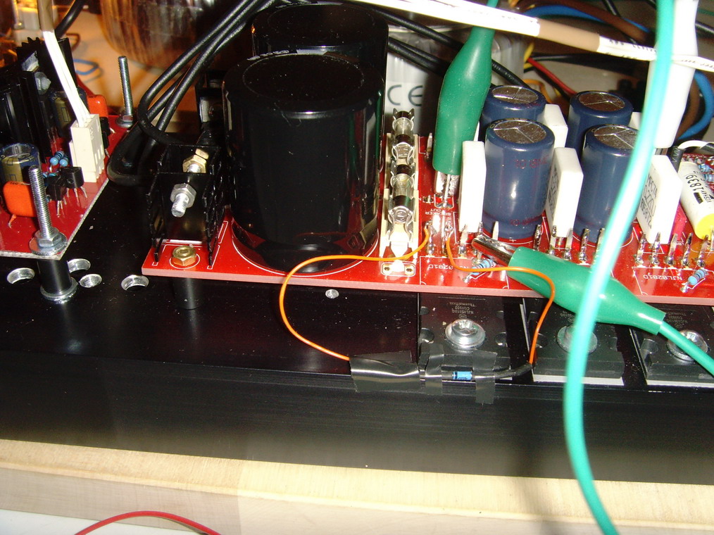

Finally I tamed the beast
I soldered the SCHOTTKY -bypass diode this morning and once more tortured the FC-100.
The temperature compensation diode string now consists of 4 internal thermal track diodes and an external SCHOTTKY diode,
which is in close contact to the heatsink.
I connected my 8 Ohm / 100 Watt resistor network to the AMP and played a 500 sine Hz wave at full volume once more.
The heatsink got very, very hot after 30 minutes.
Then I shut the sine wave input down, and the voltage that dropped across the emitter resistor that I have been measuring all the time,
dropped to 20.8 mV in the same second.
Did the additional SCHOTTKY diode tame the "thermal runaway"?
I am very sure that it does!
The 4 internal + 1 external diode string performs better than the 4-internal-diode string only that I have measured yesterday!
Allthough: the 4-internal diode string wasn't that bad either!
I will make provisions and incorporate an external SCHOTTKY diode (in a TO220 case, if it is needed at all!) on the final PCB.
In my eyes this PCB / AMP is playing "stable like a rock" and I give it a "Go".
But I will wait for ZSAUDIO's experiences, who is currently building the 2nd prototype, nevertheless.

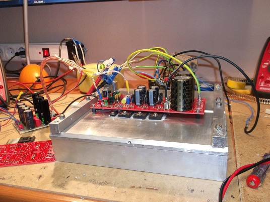

One board switched on.
I use 5 TC diodes. I can set my bias from about 6mV up to the desired 18-21mV across 0,1R Re. I did not watch for the max current.
My backend PSU voltage is +/-30V DC because i do not have any trafo with 2×25V secondaries.
Output DC offset is about 0,1-0,15 mV
I'll do more test tomorrow.

Rudi,
are you still set up with output Re=0r22?
and still with Ibias=2.3mA?
Sort these and then compare to the Roender original before you blame anything else.
Yes, Andrew,
I still use my 0R22 emitter resistors and I did not change anything to get a lower Ivas.
I measured an Ivas current of 2.3 mA some days ago.
Best regards - Rudi
Best regards - Rudi
