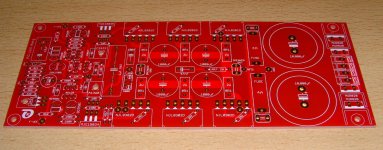

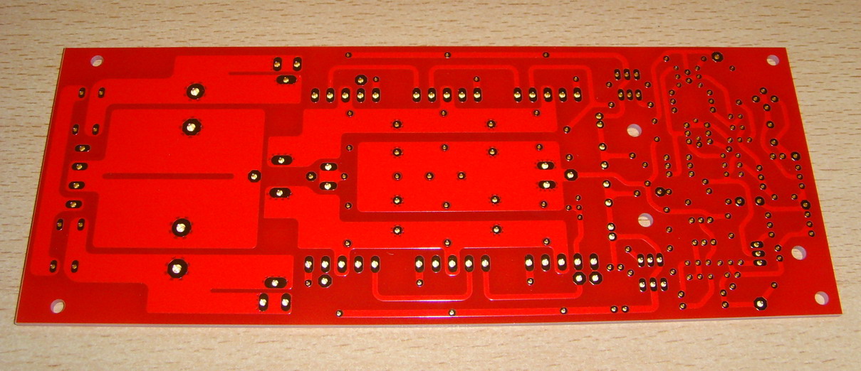

Gentlemen,
I received the PCBs of METAL's and my layout of Mihai's FC-100 AMP today.
I have ordered 10 PCBs.
The components side:
http://www.abload.de/img/joe0223ca9f.jpg
The solder side:
http://www.abload.de/img/joe027mayoc.jpg
The quality and precision of these PCBs is extraordinary and flawless.

The PCB follows exactly Mihai's schematics.
I added a DC blocking capacitor on the frontend (which can be easily de-activated by means of a jumper) and a diode-rectifier section
on the backend (that can be bypassed as well), and I am absolutely sure that I did not do any layout-error.

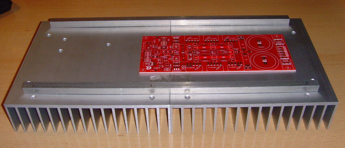

I am currently thinking about the mechanical implementation of this AMP.
I will use what I have at hands:
http://www.abload.de/img/joe031znuaz.jpg
and like to install Mihai's shunt regulator and a speaker protection PCB (I will use a TRIAC - solution this time that will burn the fuse
in case of a DC / AMP defect, so that no relay will disturb the audio signal) on the heatsink as well.
I will keep you informed about my progress.
Best regards - Rudi
